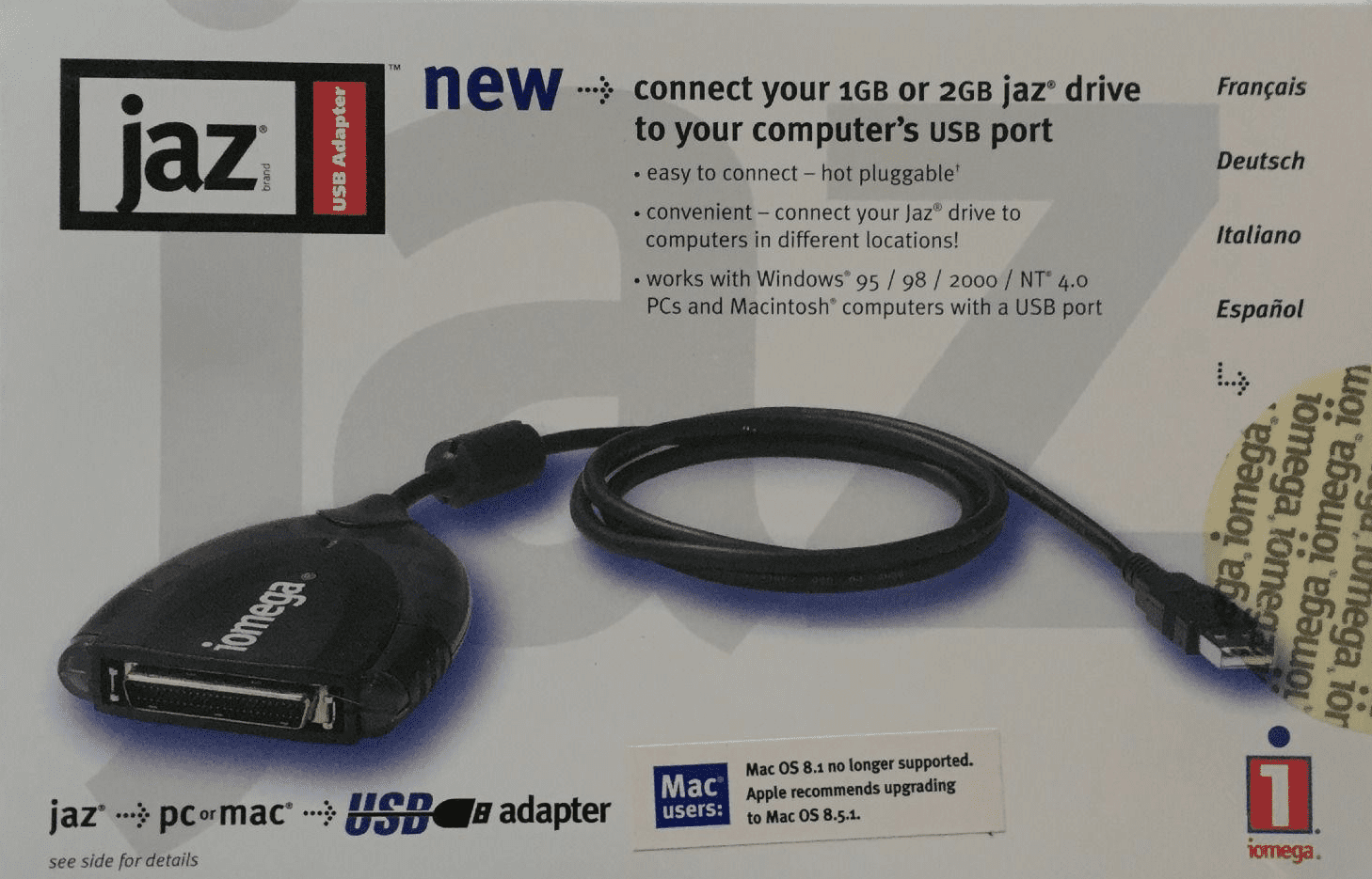

Interestingly, it appears that the Iomega Jaz USB adapter used to be supported under MacOS 8.1 and then stopped. o_O See the sticker on the box:
