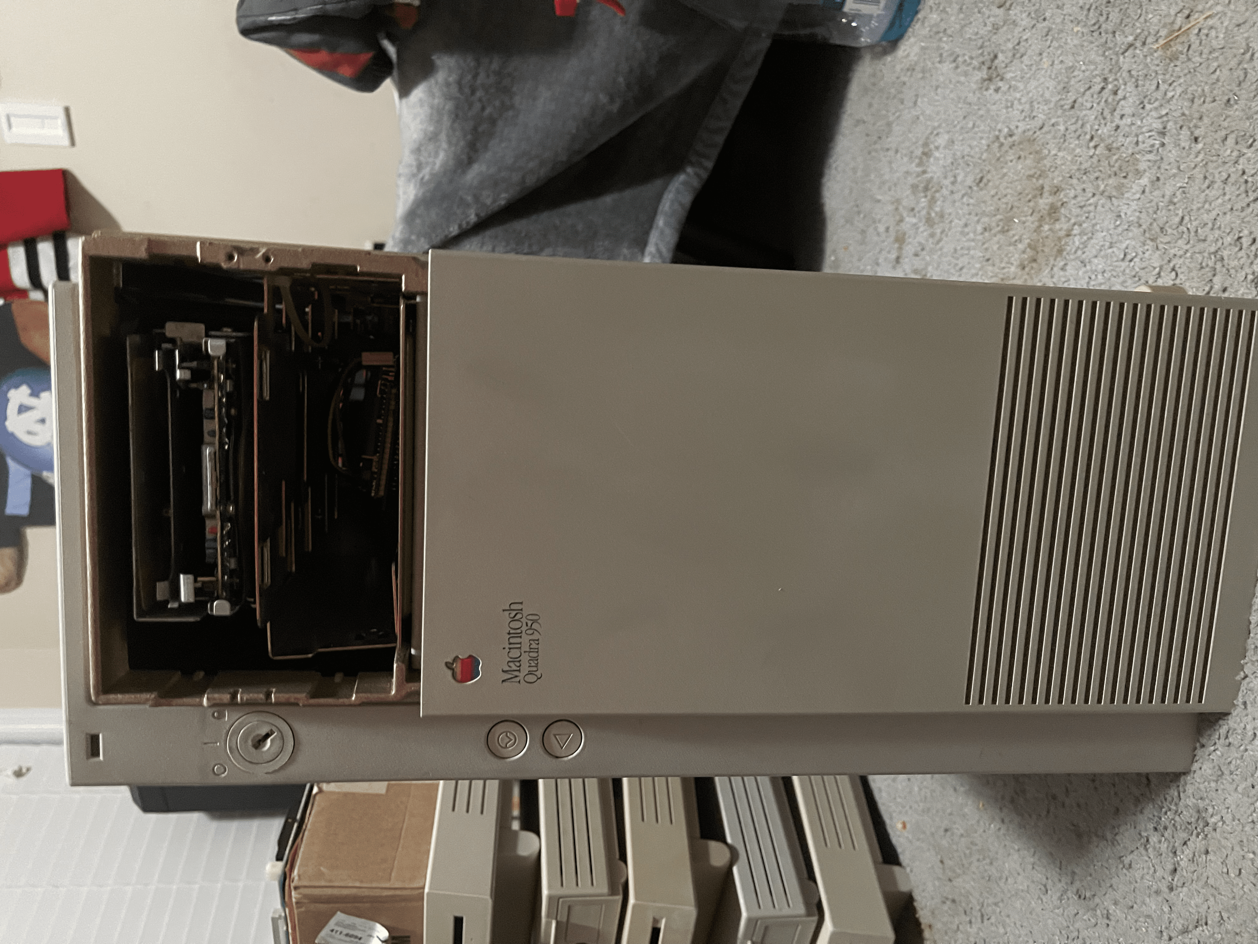

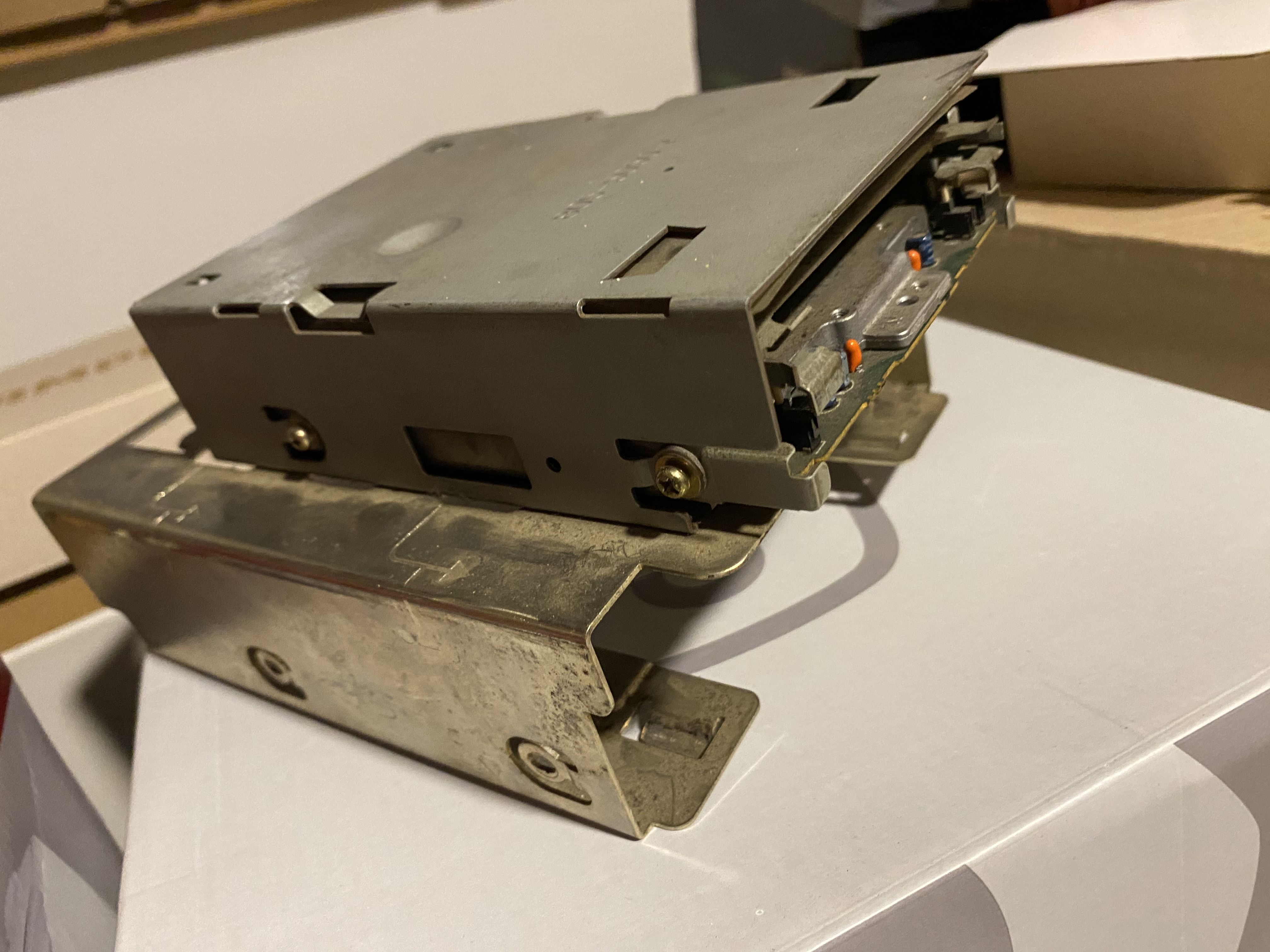

I surely will, I need to track down the Hard Drive cover bracket, that's about it.
Need a blank bezel I circled it here. And maybe a new side panel?

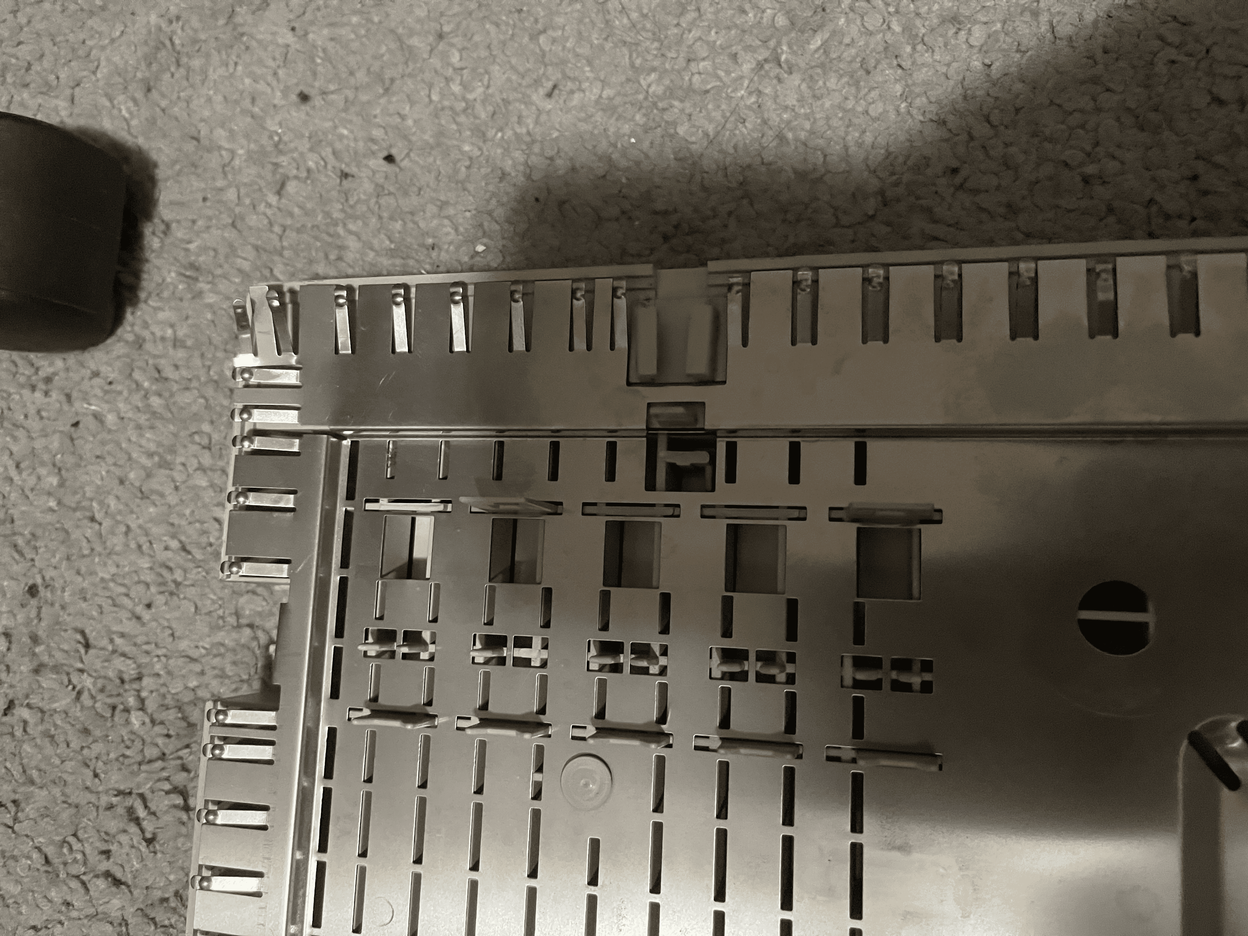

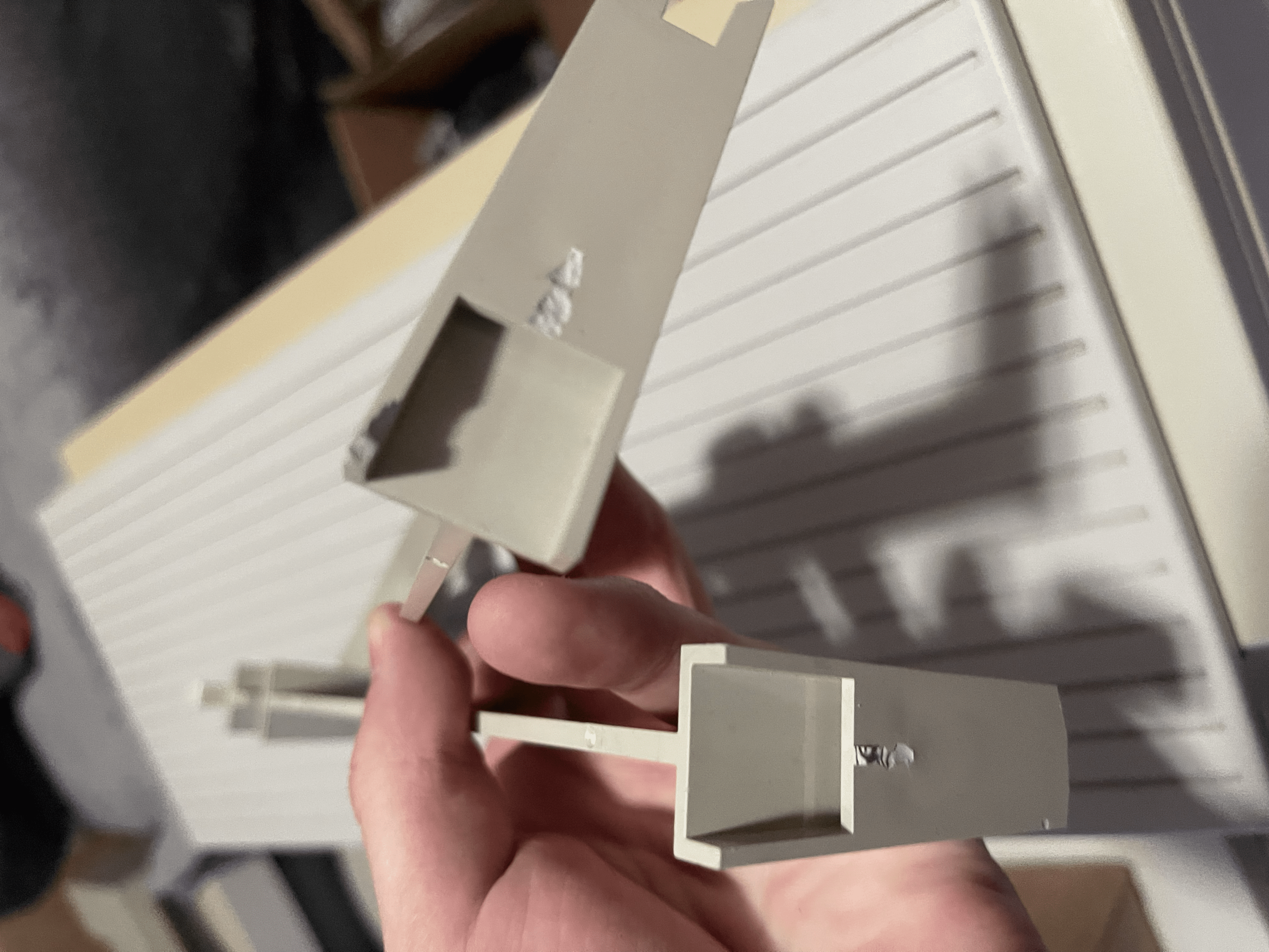

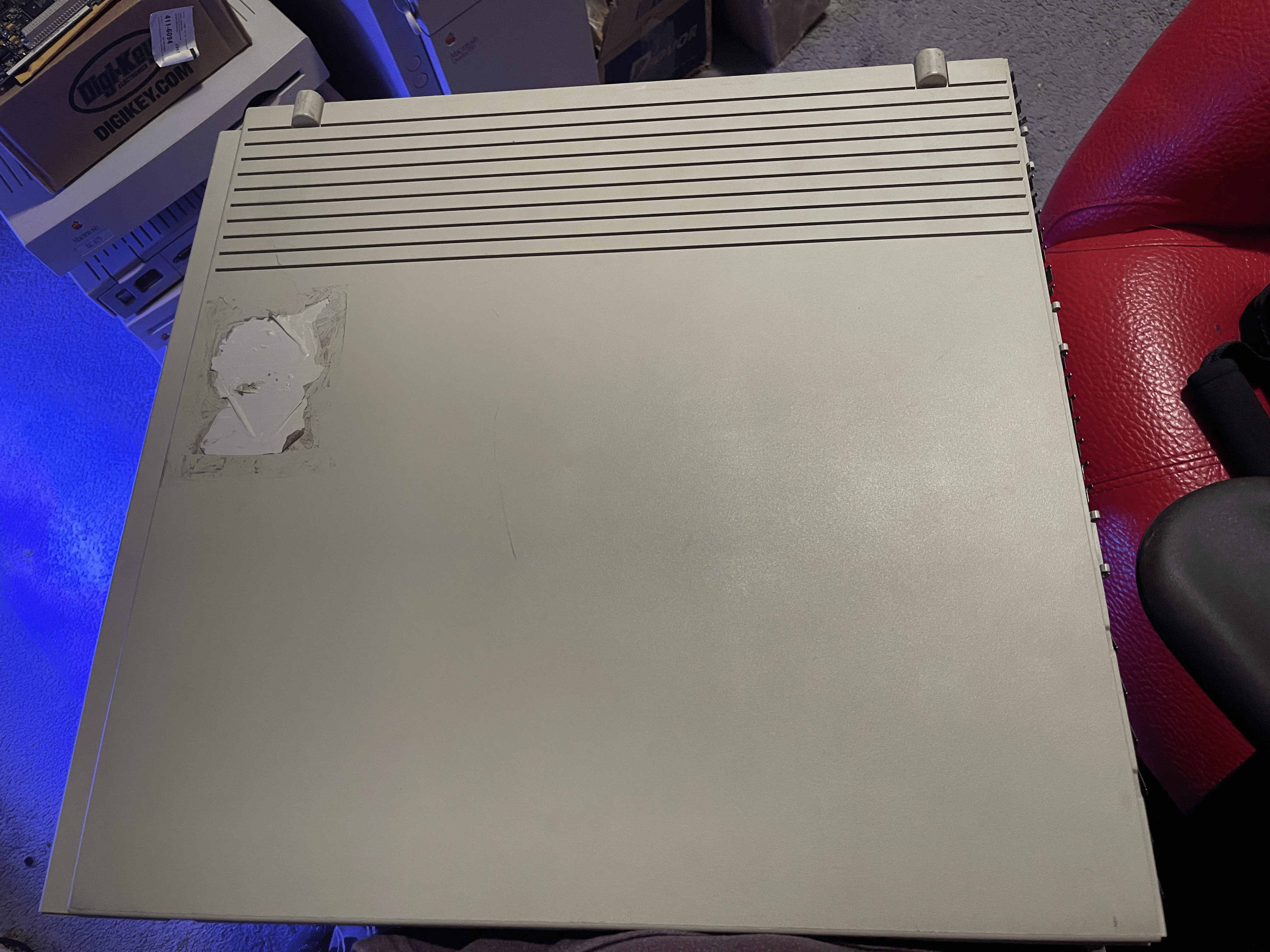

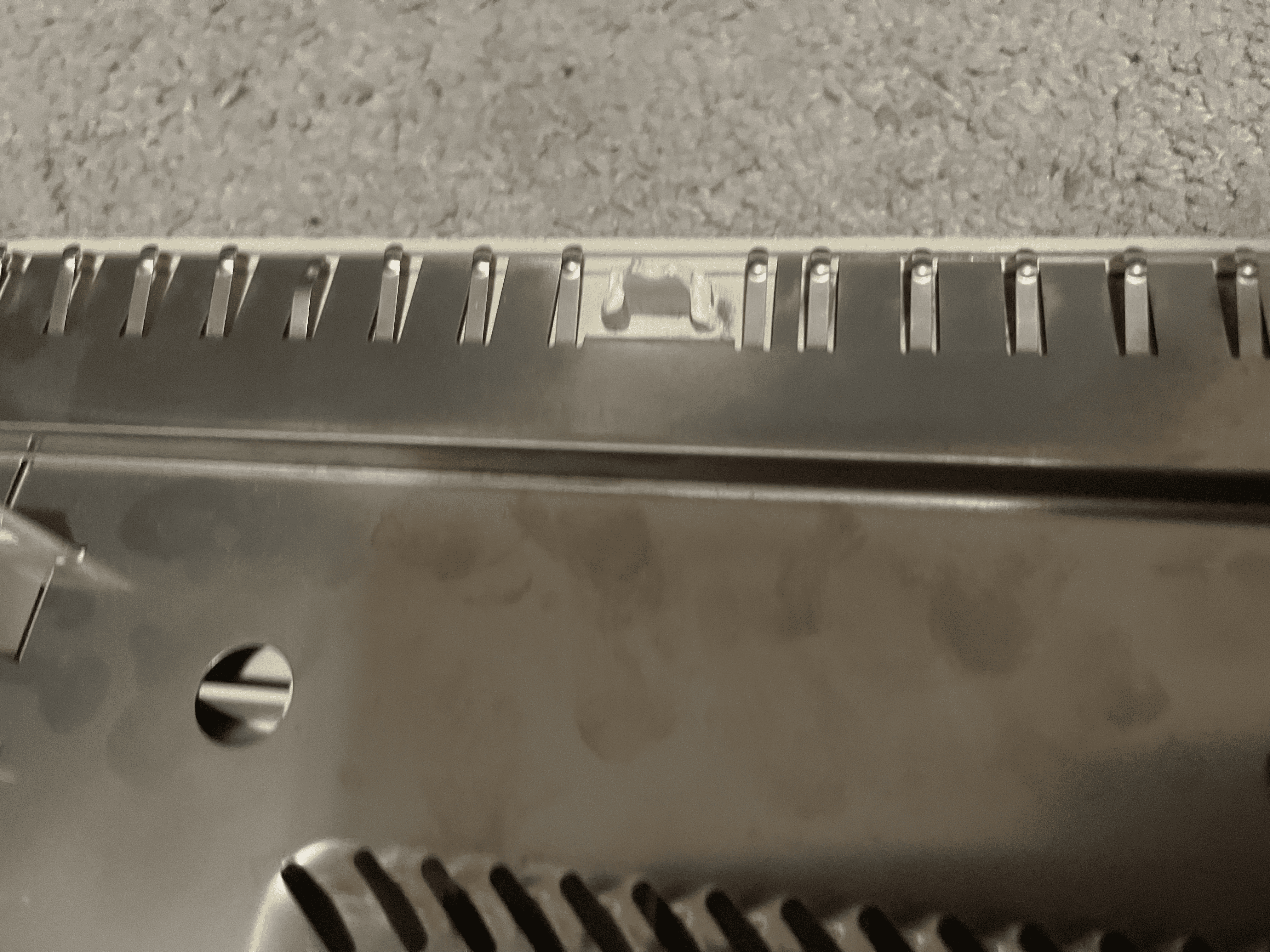

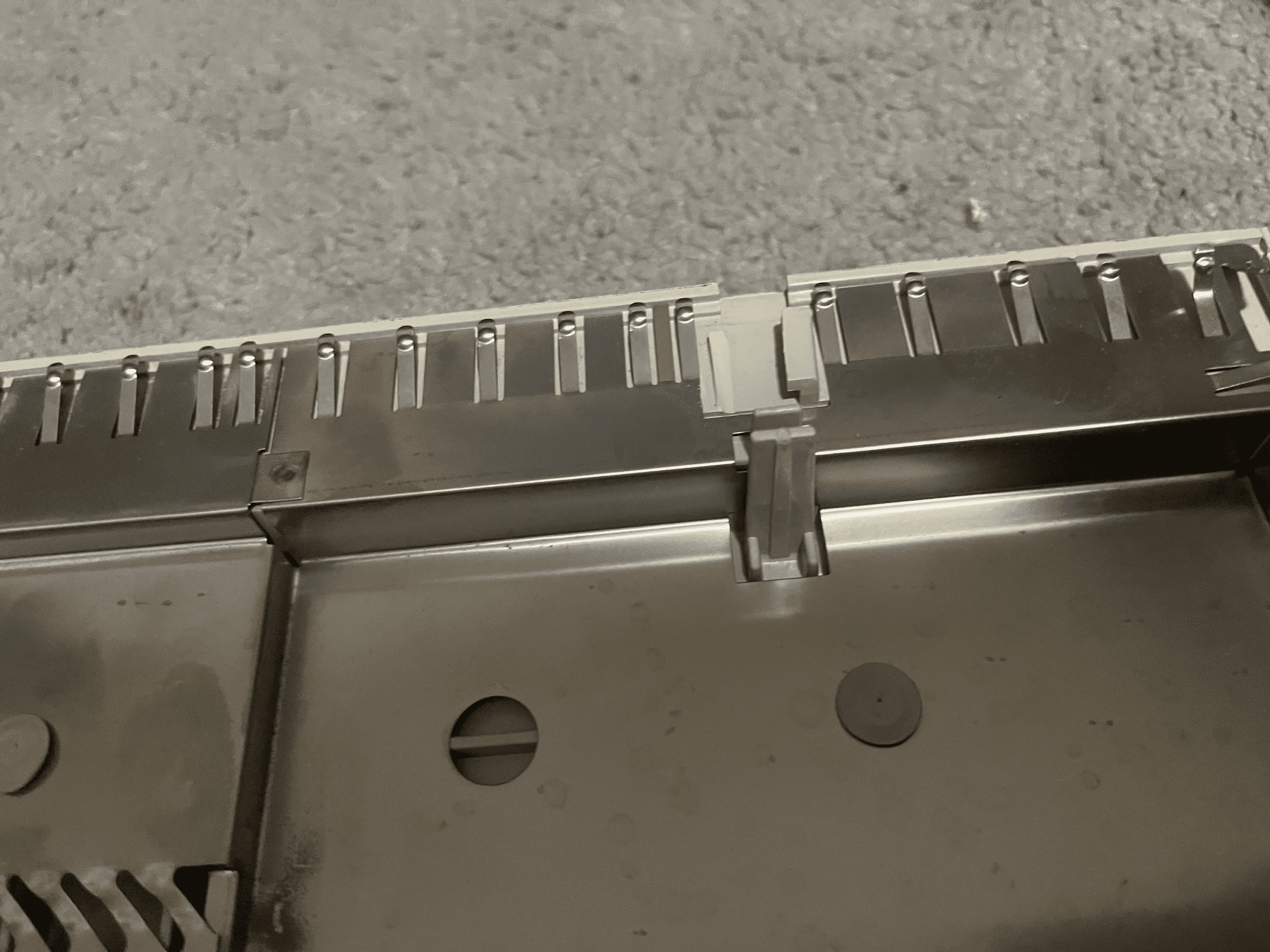

Well it arrived all in mainly one piece except the side panel seems to have suffered broken tabs, anyone know where I can find a spare side panel?

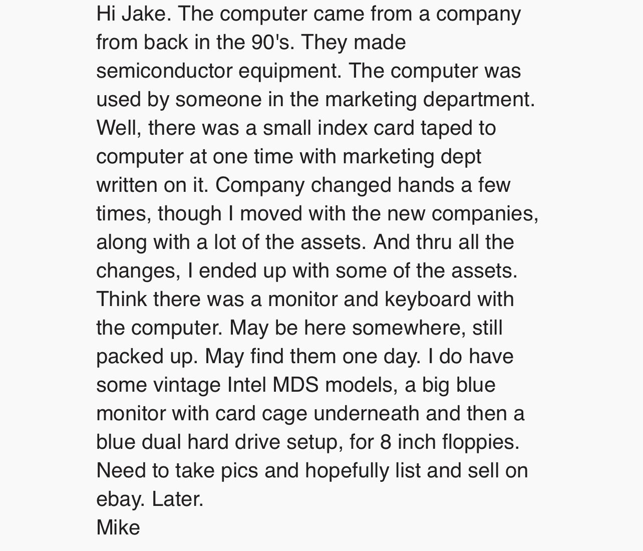

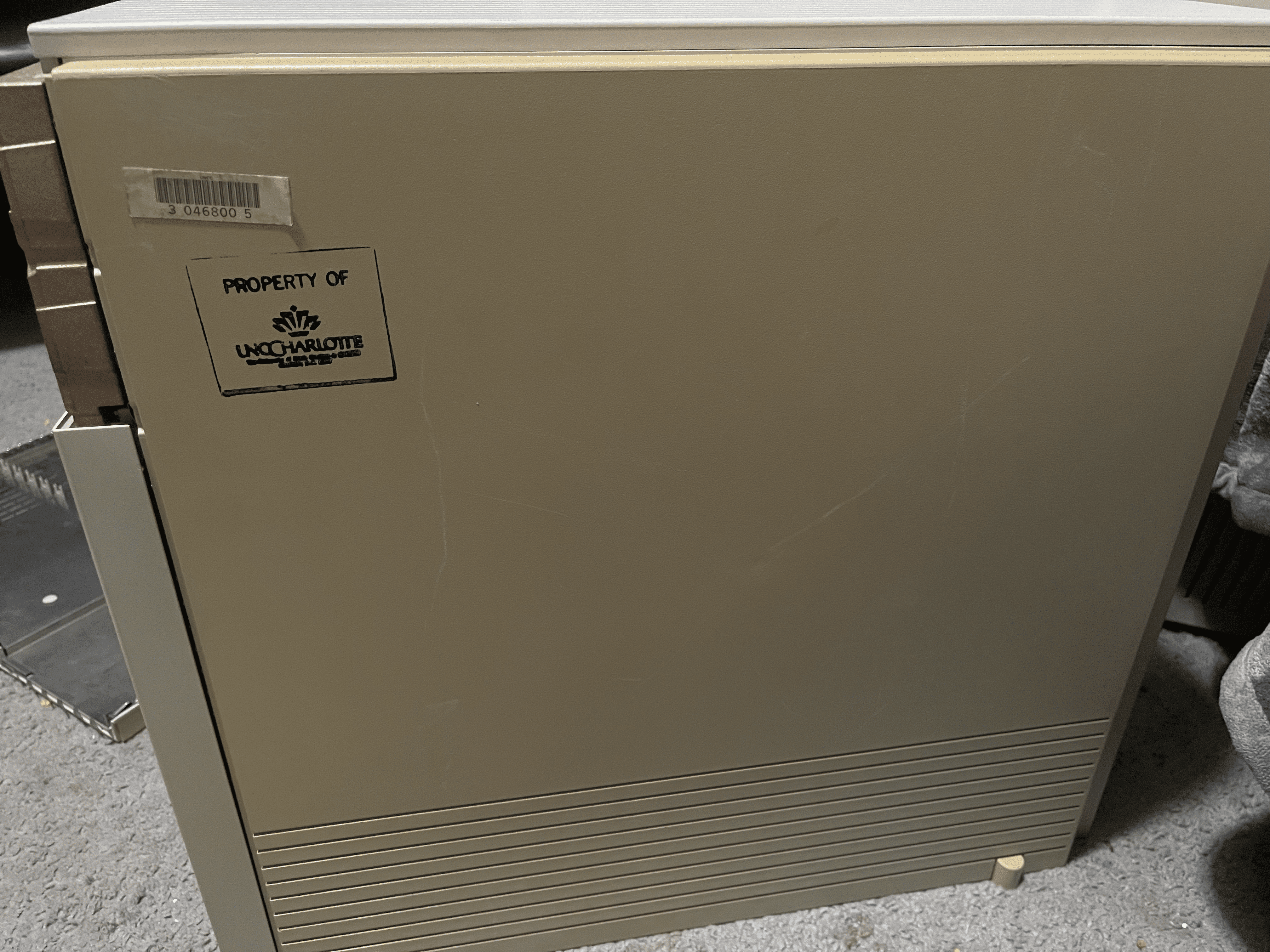

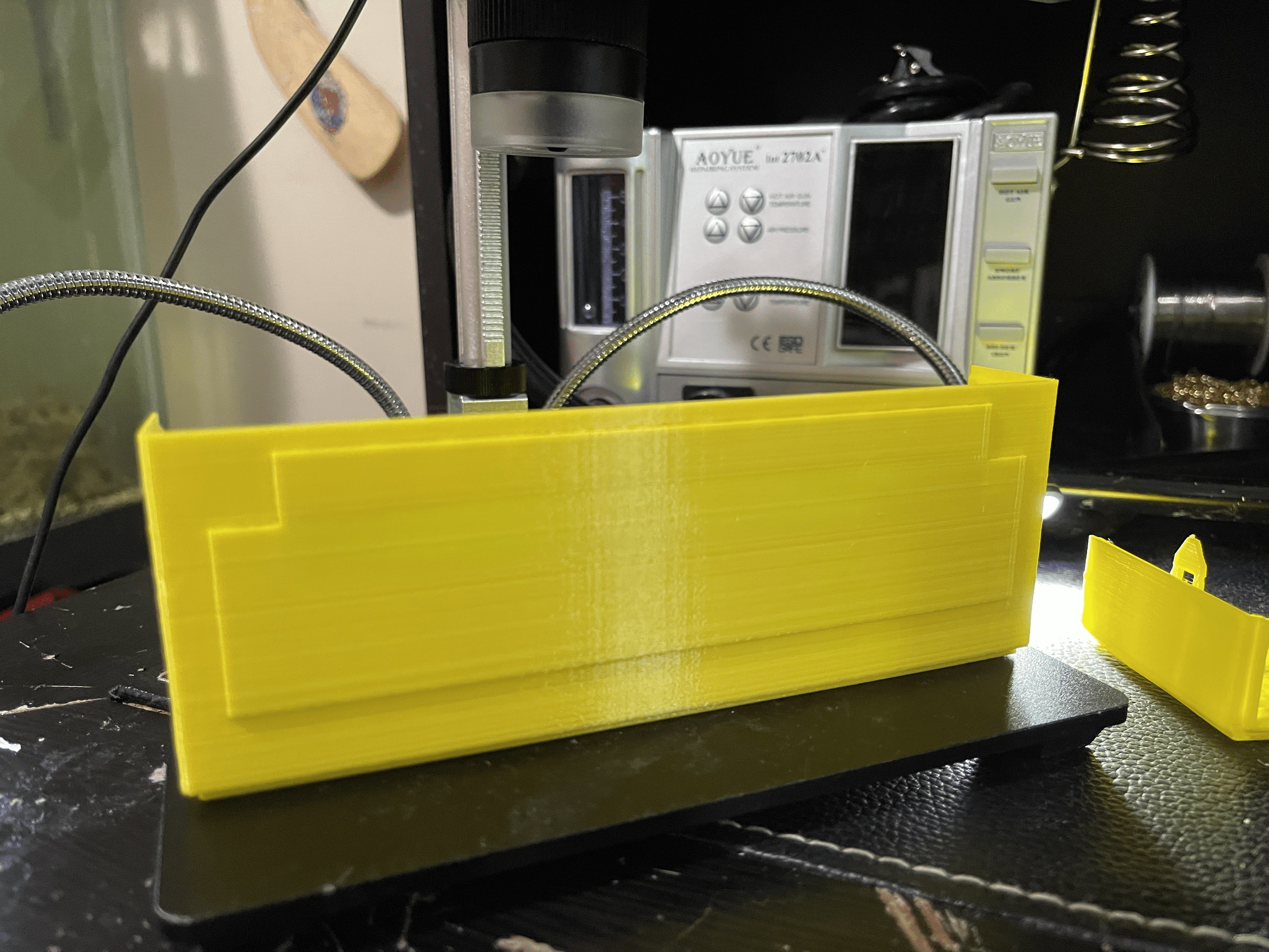

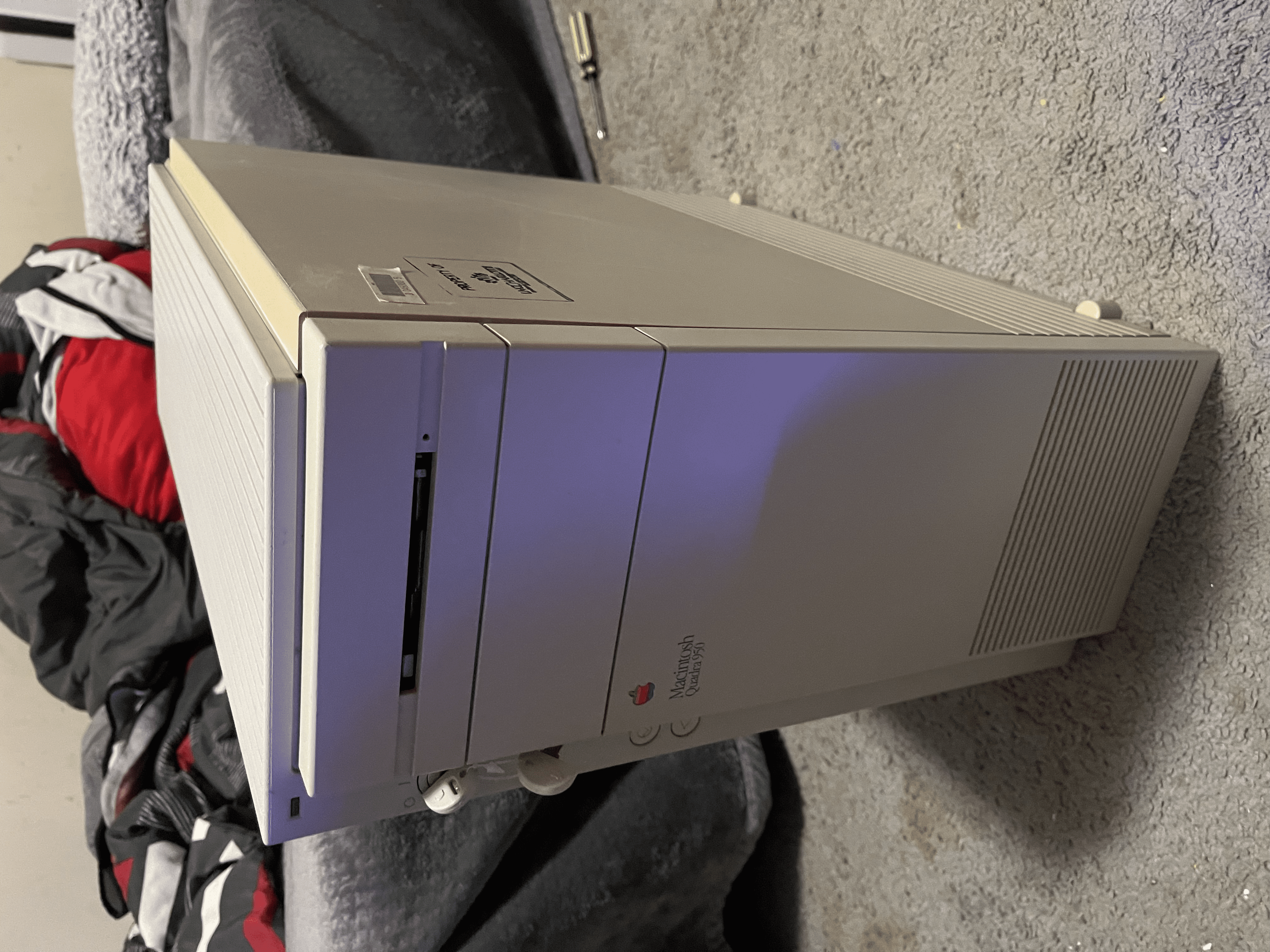

So my Quadra 950 arrived yellowed and missing the blanked out bezel. This I thought was my only issue but it later appeared that the clips and screw post on the original side panel had been broken off with a mix of shipping and age related damage. This bothered me greatly, the yellowing I knew I could fix (and while the end result below isn't perfect, I'm happy with it) but the missing bezel and damaged side panel I knew would be difficult. Thanks to @360alaska I was able to modify his existing CD-ROM bezel to make a sort of blanked out bezel with strange protruding rectangles. This was later fixed with my updated revision which is flush and posted here as well as the first revision in the 3D printing section and I've also included @360alaska's original models as well for convenience sake. Eventually through a seller somehow within four hours of me I was able to track down a new side panel and blank bezel, they weren't cheap but I figured this machine deserved to be pretty again. I then removed most of the yellowing, popped in the panels, and well the rest is history. Out of curiosity I reached out to the the seller I bought this Quadra 950 from and asked him some history about it if he knew about it, and to say the least it's been through some environments and paths (I've included a screenshot of what he told me about it below as well). Pictures are below and the machine works great.

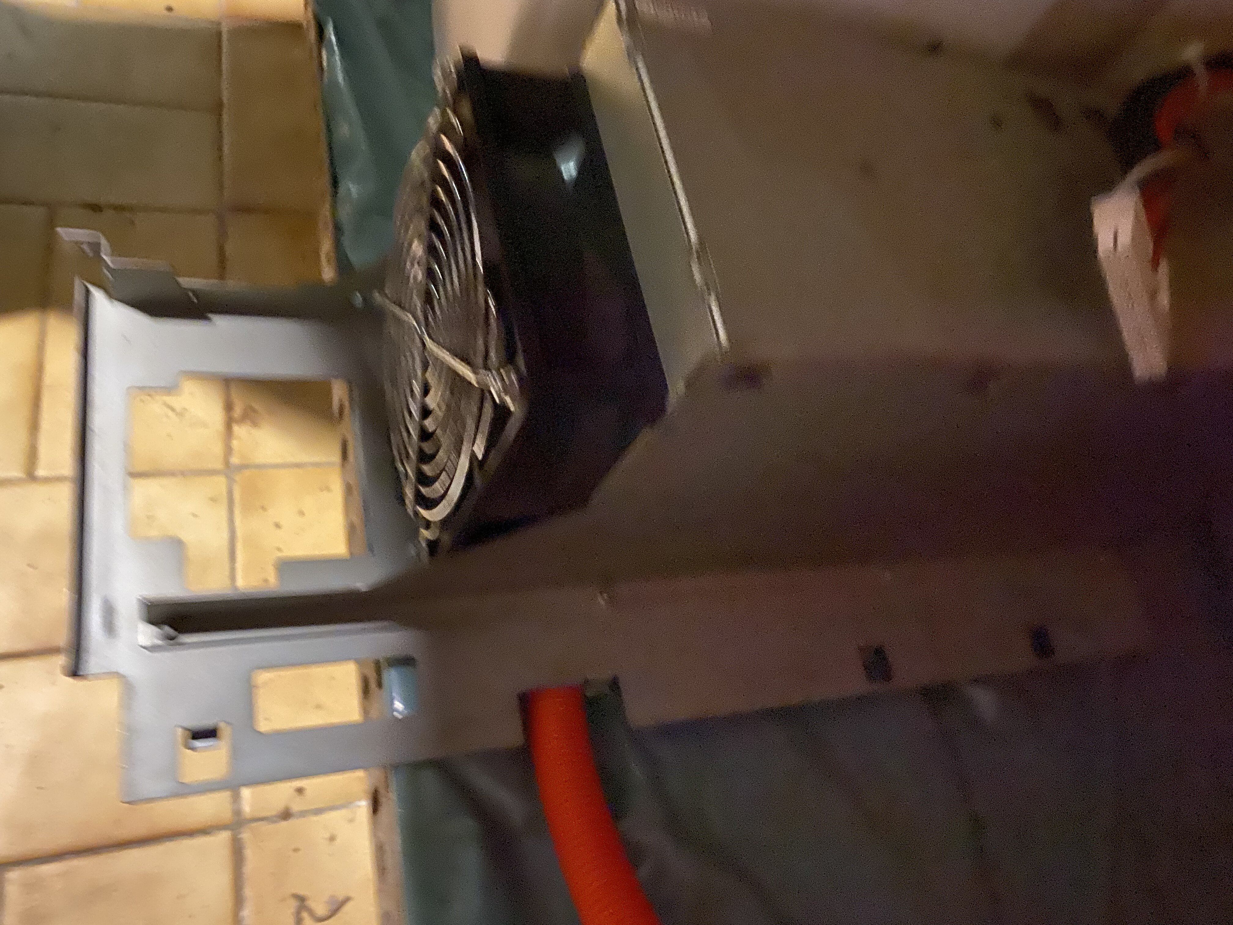

Fans in the PSU are notoriously noisy and the key switch is of very poor quality. Be careful with the switch and I highly recommend replacing the fan. Cable routing in these blows. Careful of the plastic tabs on the cover as with any vintage Mac.
These machines support NuBus standby power, even with the key switch in the off position the system is still powered. Make sure to unplug and discharge the PSU before you mess with anything inside the machine, otherwise there's a reasonable chance you damage it.
Of course, there's also the usual barrel battery inside which is prone to leakage, and the same issues with weak RAM slots that many other Macs face, although these typically have metal fingers as opposed to plastic.
There are two SCSI controllers and three SCSI connectors, two internal. EVERY device must have a unique ID, even external devices and both internal busses all share the same IDs under Mac OS 7 & 8. I am not sure if A/UX fixes this or if Mac OS 9 on the PPC 601 board makes any difference.
The PSU connector looks a lot like ATX but it absolutely is NOT. Do not be tempted to try it, you're probably going to do a bunch of damage.
