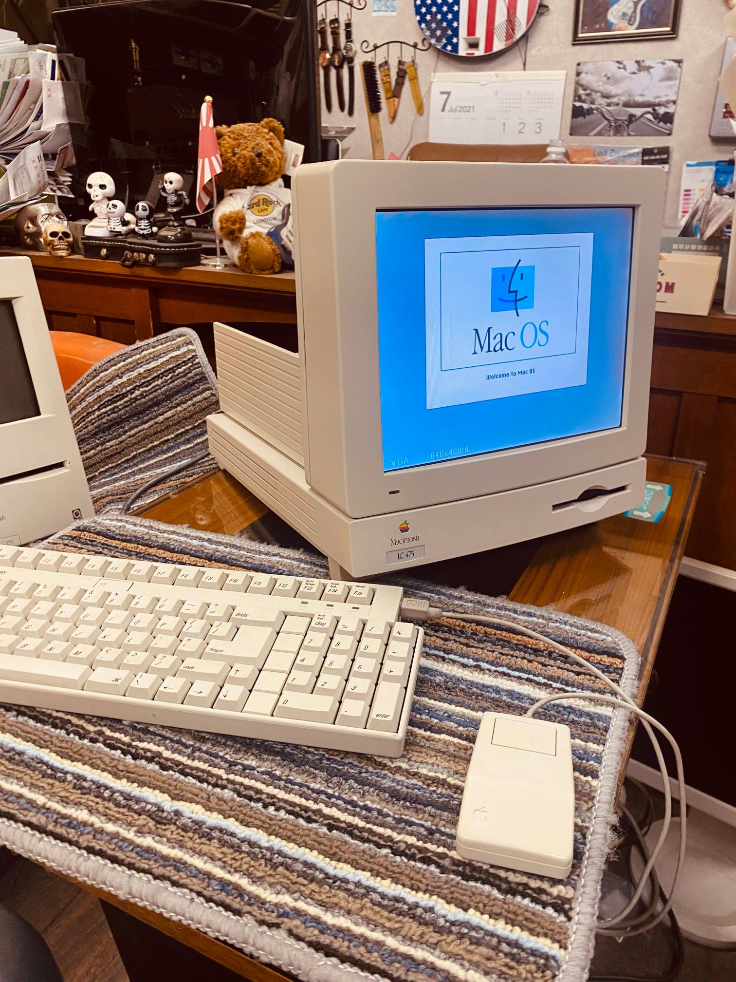

I finished setting up the LC475 the other day and I wanted a 12 ”RGB monitor that fits it.
And decided to build it. I would like to introduce it because it has become an interesting shape.

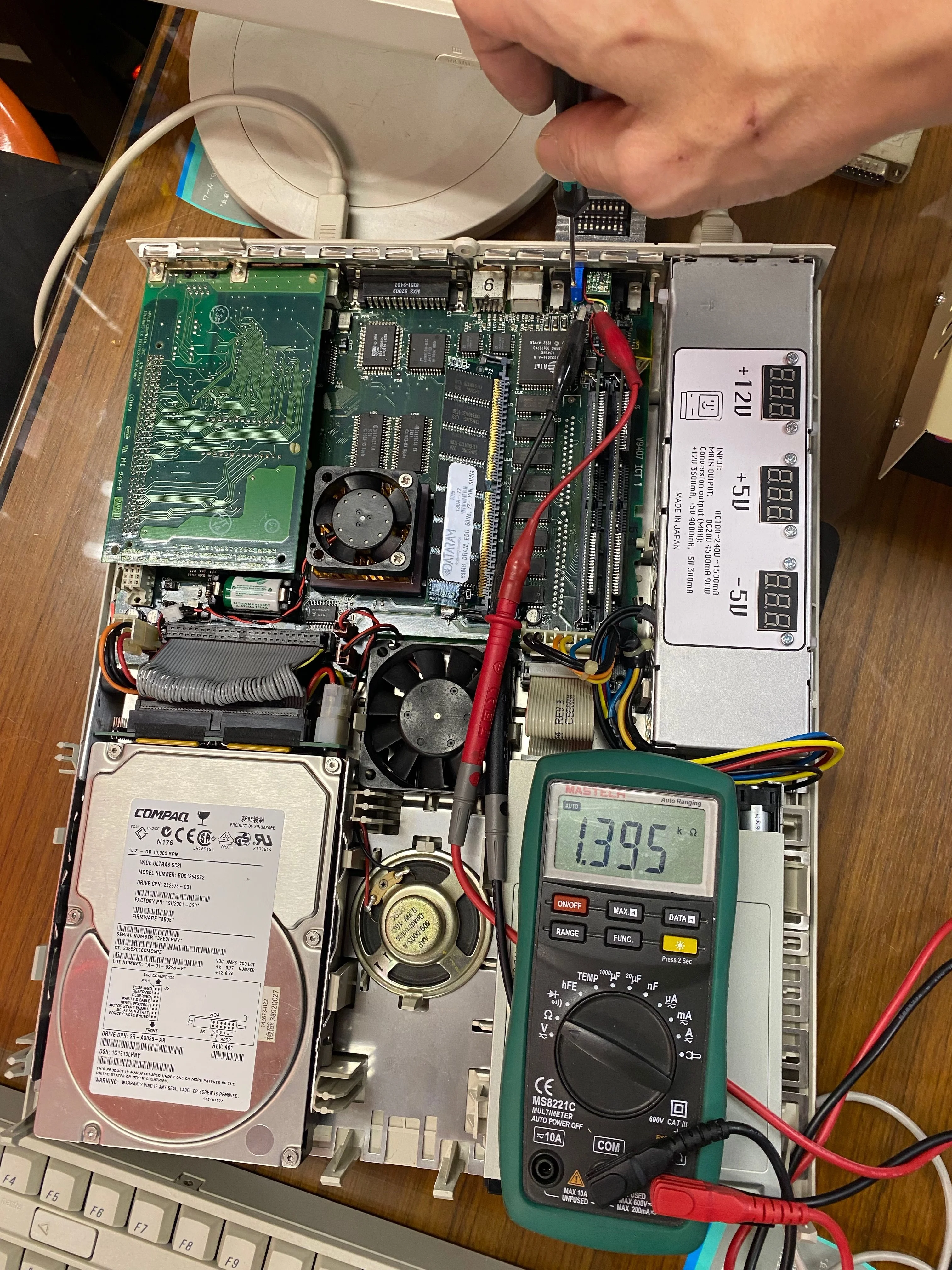

It is overclocked and operates above 42MHz. I finished this first.

Oooh - how did you get the bus speed that high? I thought 40MHz alone was too hit and miss? Have you replaced the clock generator?
Hi Kai!
As you can see from the blog (this article was featured in Call-A.P.P.L.E), I'm replacing the PLL clock driver. But supplement it.
This is originally for 12.5MHz input and 25MHz output. although this MC88916DW75 driver has 20MHz input and 40MHz output, there is a margin in the upper limit.
By exchanging this, I raised the clock that did not reach 40MHz to 42MHz or higher, and it is stable without gradually decreasing over time. However, since the serial port does not function normally above 42MHz, it is usually around 41.7MHz.

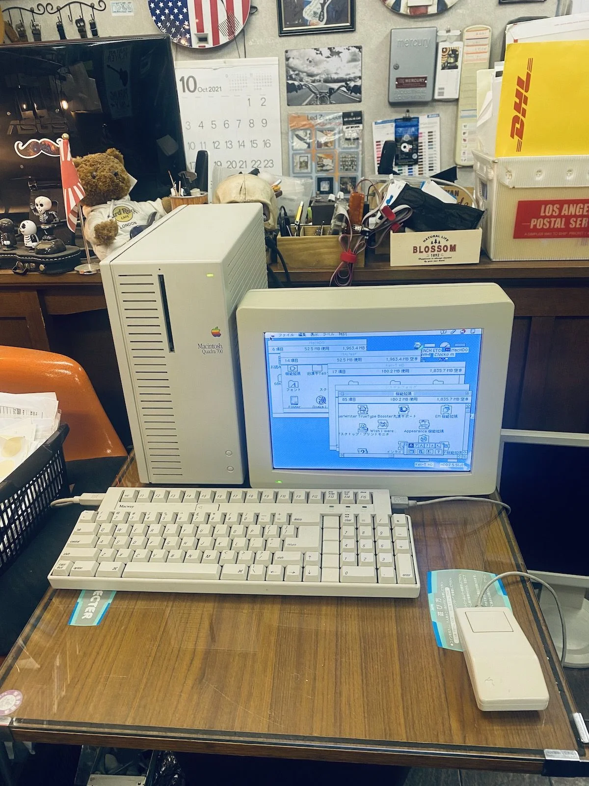

I am curious about the cool-looking ADB keyboard shown in the photos. Is that something you hacked together yourself, or was that sold at some point?
It is a Macway TP-997 in beige/white.
Usually white clicky Alps or Black linear Alps switches. Very nice keyboard
