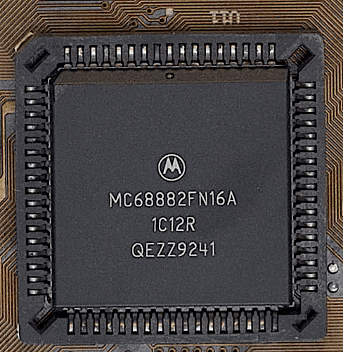

Interestingly, my FPU is only rated for 16MHz, but it overclocks to 33MHz just fine. But I've heard that the 68882 overclocks nicely like that. Very glad I didn't have to buy a new one. That FPU was actually in the stock Color Classic board, and I extracted it for the LC520, since an FPU makes more sense in the faster board.

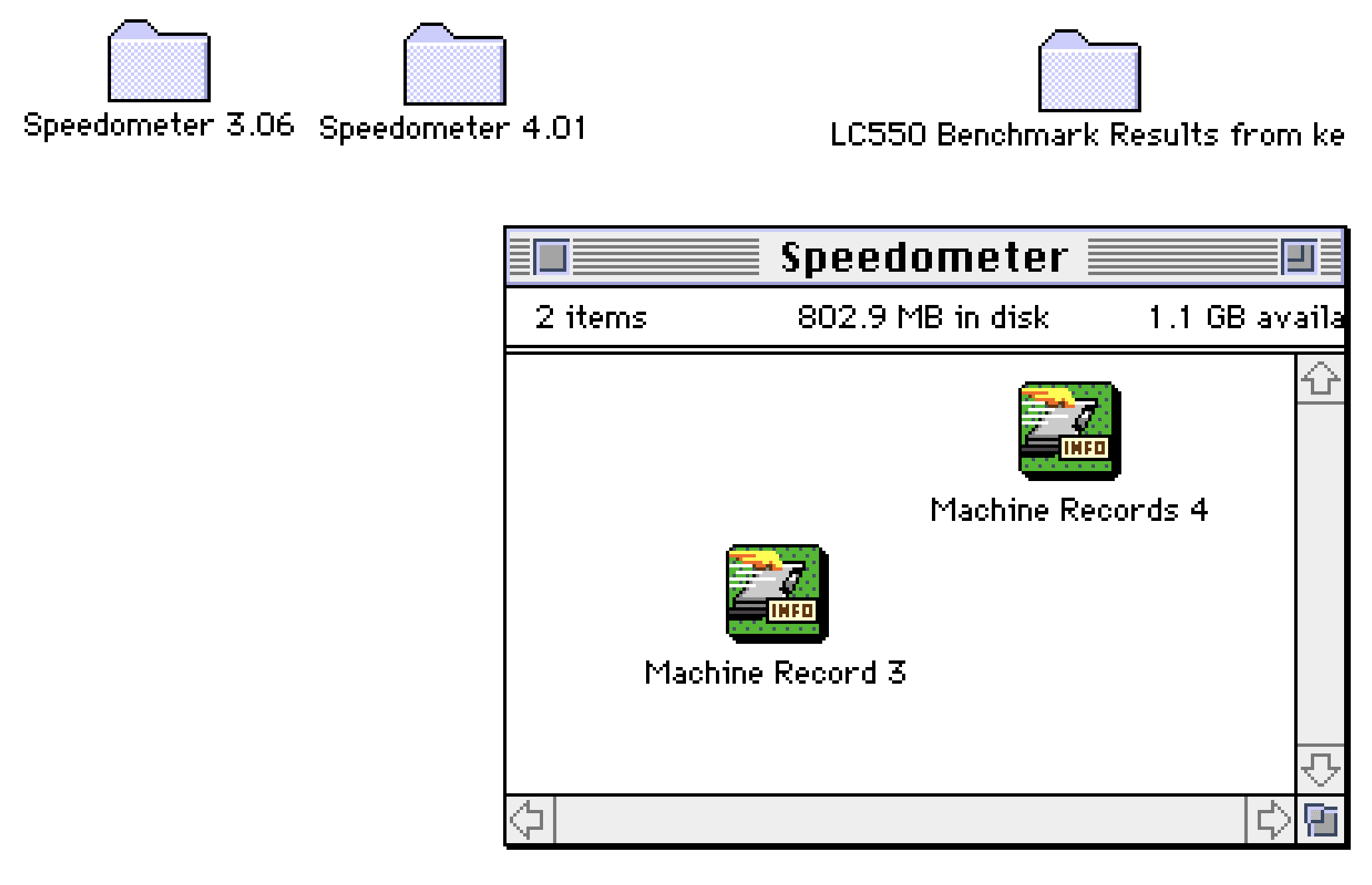

@JDW Here's a stuff-it file of test result files from benchmarks I ran on my CC with my LC 550/CC II board. I pulled them off my disk image via Infinite Mac. I skipped the disk benchmarks on MacBench because they took forever and aren't relevant to CPU performance. Plus, MacBench crashed after the first complete run and I was not about to do it again.
@kefkafloyd

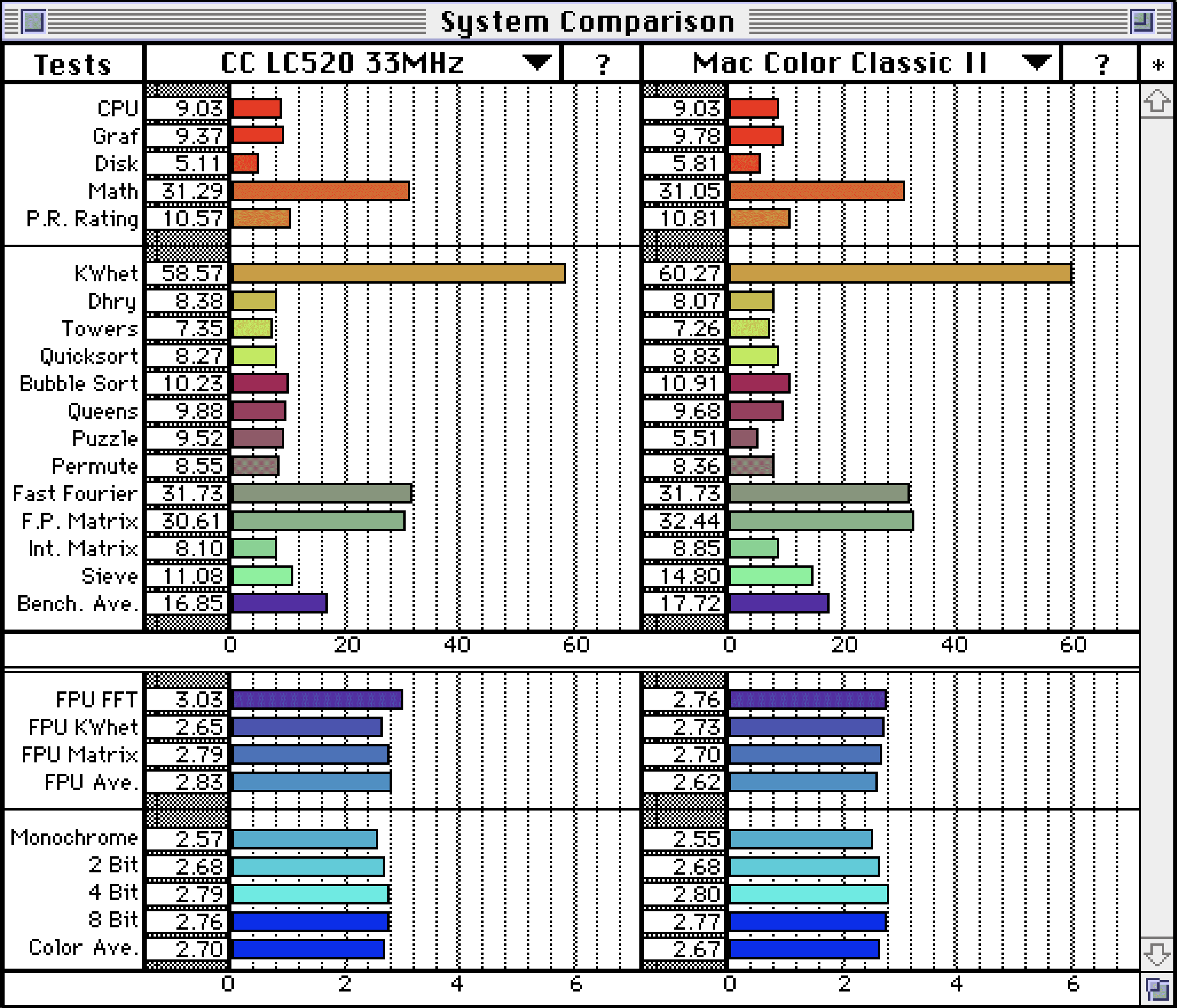

Thank you. I downloaded your file and opened the Speedometer folder and I see Records "3 & 4" but do you which specific version of each?
As you can see below, I have my own 3.06 and 4.01 folders (top left). I believe the creator of Speedometer changed this testing methodology somewhere during version 3. I can't remember if 3.06 results differed from 3.23 or if it was another version, so anyway, that's why I ask.
I went ahead and merged your "Mac Color Classic II" (LC550 board) record with my main Machine Records file for v3.06. Here's the comparison, with my overclocked and recapped LC520 board shown at left...
You're getting more "Graf" speed than my board, enough to where it doesn't seem to be regular testing error. Disk is faster too, but that is conceivable because I used a spinner drive and you might have used something else. Math results differ by what I would consider to be "normal testing error". Here are the exact percentage differences between our results:
  • Graf: 9.37 & 9.78 → 4.33% difference (testing error difference?)
  • Disk: 5.11 & 5.81 → 13.69% difference (are you using BlueSCSI?)
  • Math: 31.29 & 31.05 → 0.77% difference (definitely a testing error difference)

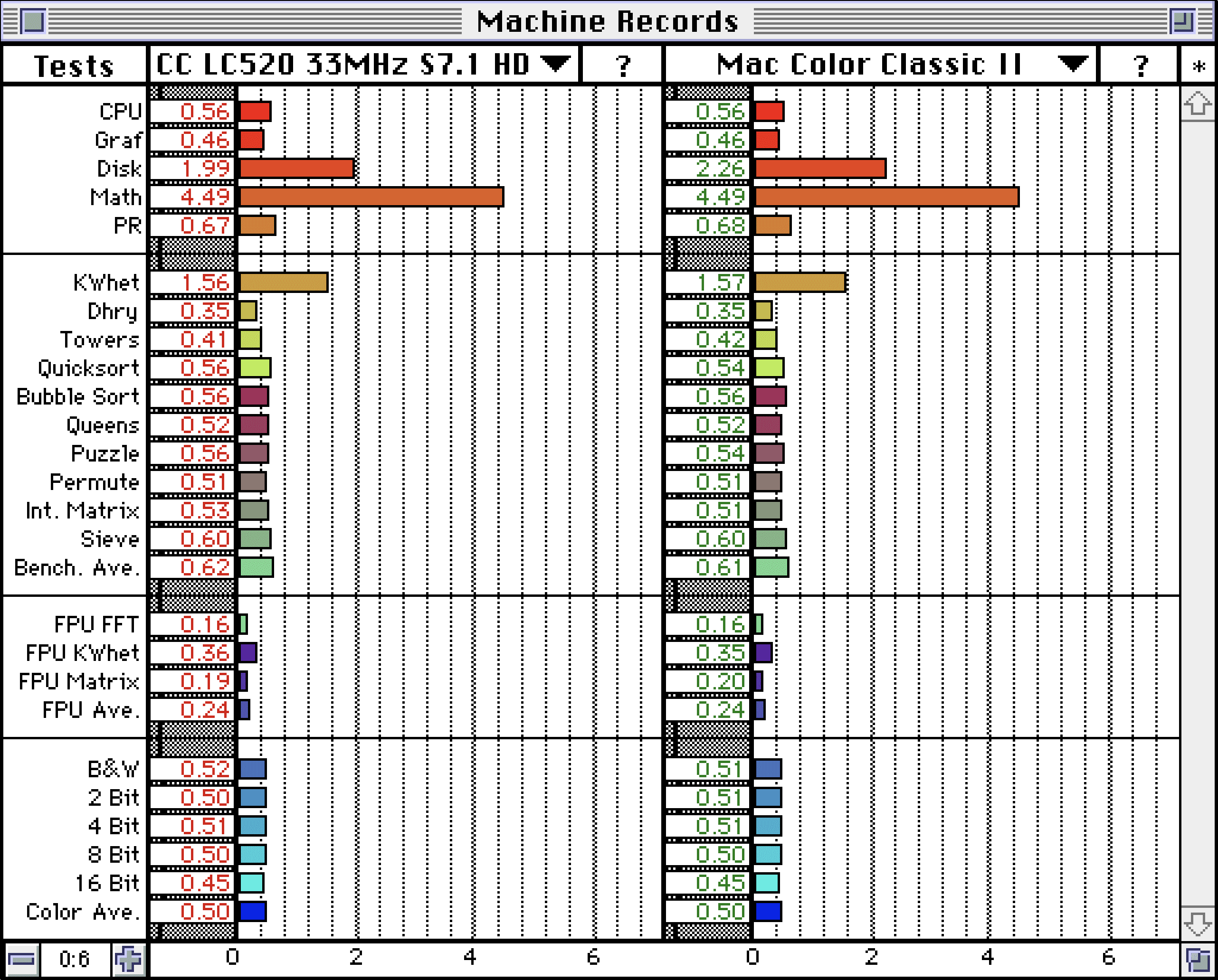

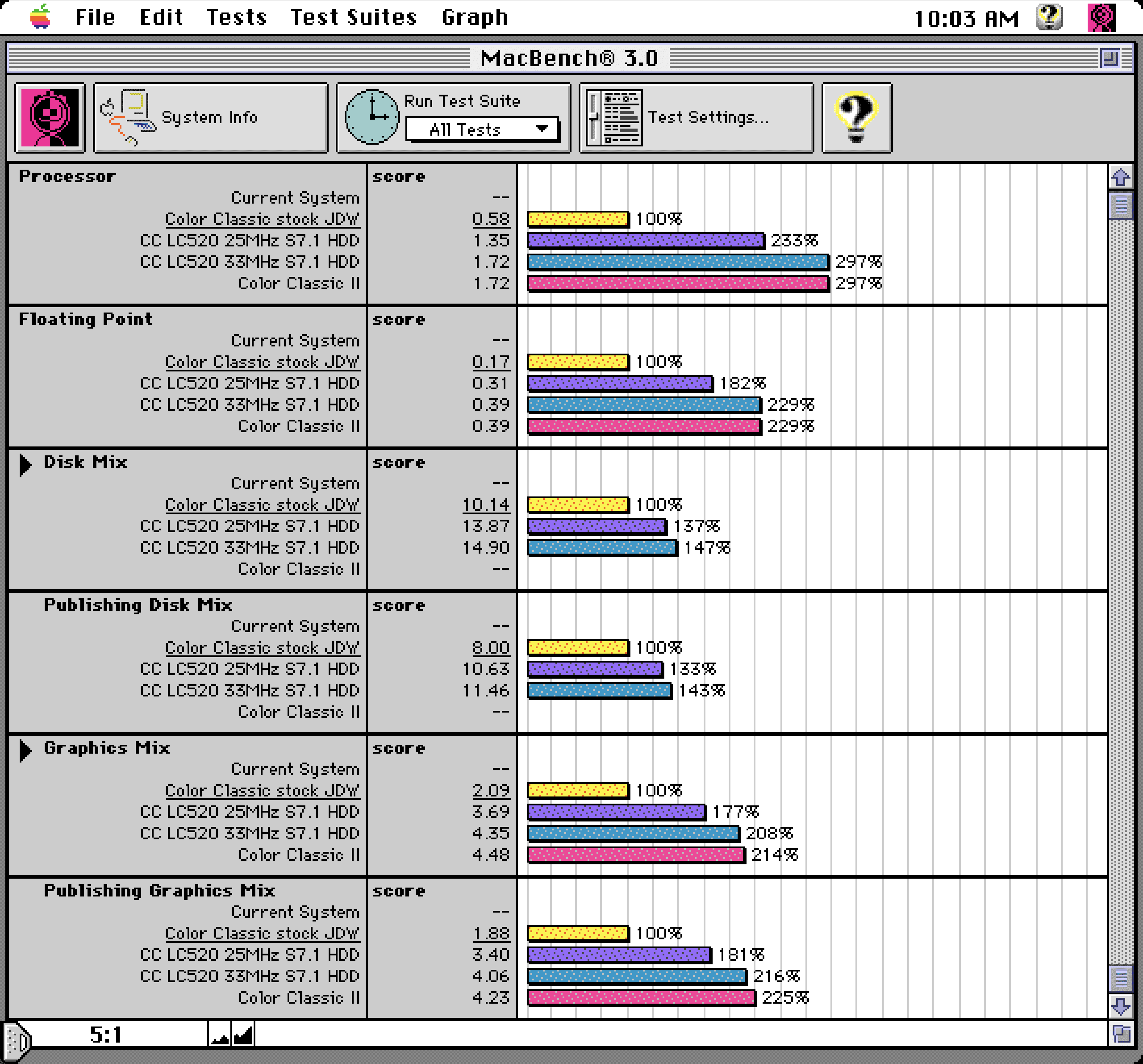

I just did the side-by-side with your Speedometer 4 benchmark results (shown at right below — I renamed your record), and my overclocked LC520 board at left. All numbers (except Disk) are clearly within "testing error" difference. So I guess this gives strong evidence that the BUS SPEED is very likely overclocked along with the CPU no my LC520 board...

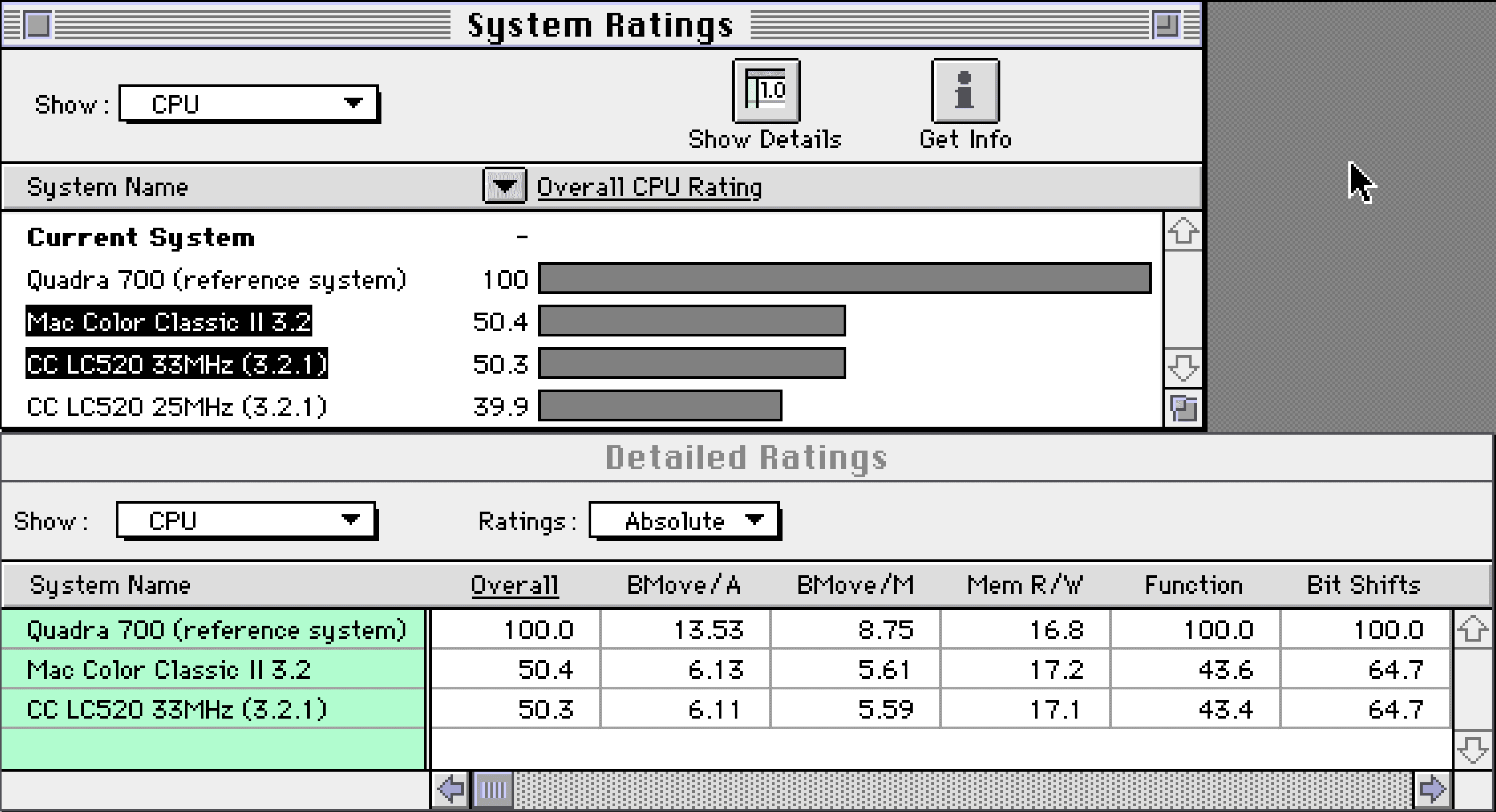

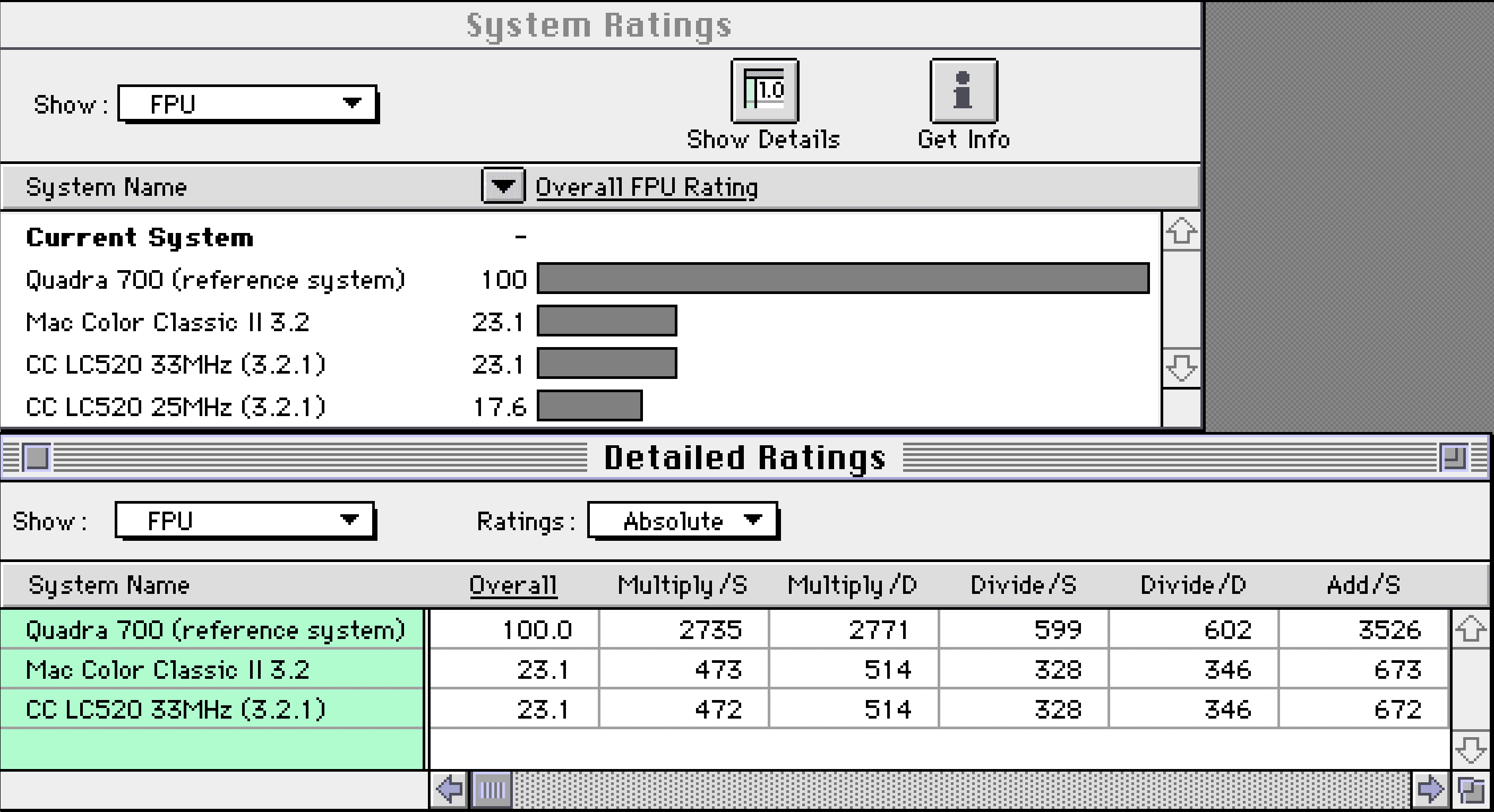

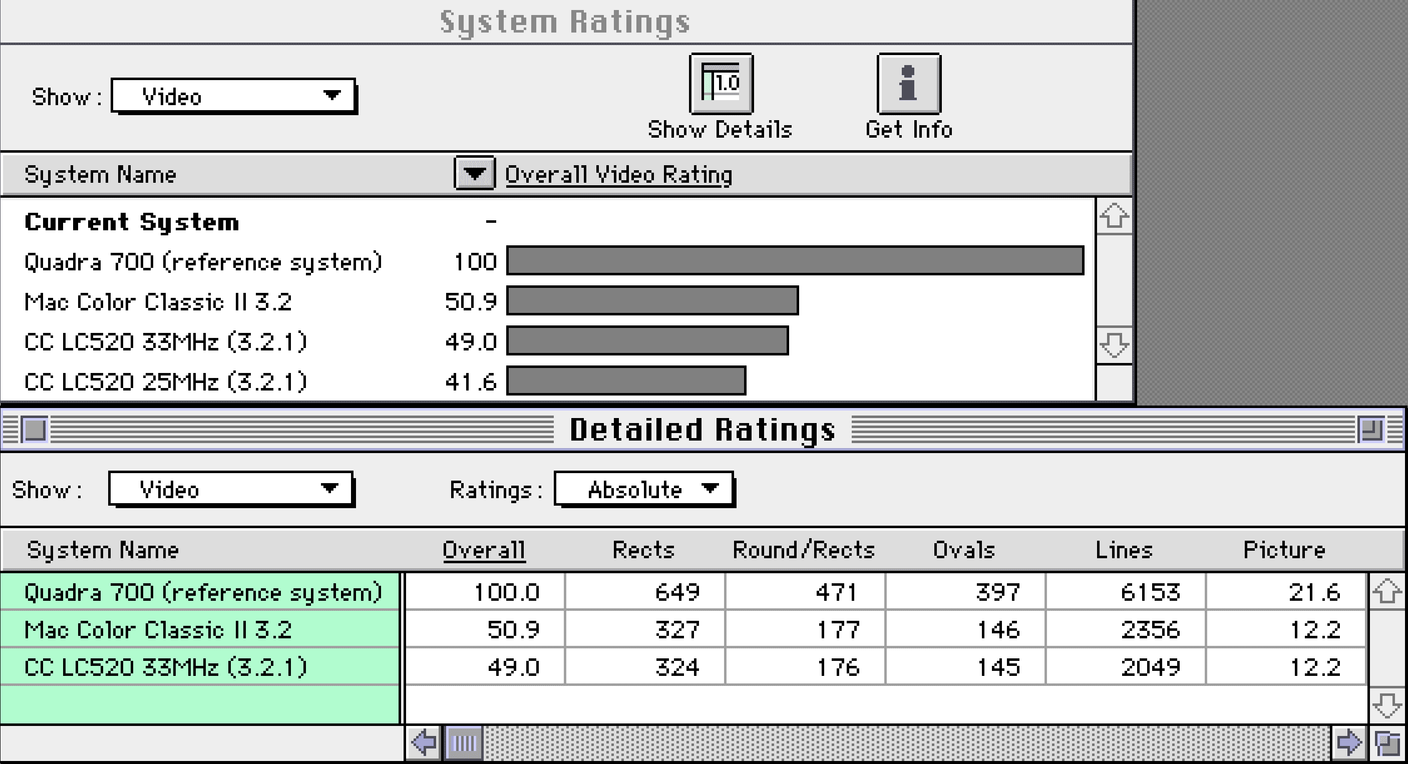

And here is the Norton System Info 3.2.1 comparisons (showing only CPU/Video/FPU because your Disk scores were missing)...
And here are the MacBench 3.0 results, showing that CPU/FPU are essentially the same for your board and mine, but your board still shows a bit higher on the Graphics...
Even so, if you consider how much lower the Graphics scores are with the 25MHz LC520 board, I don't think it can be said that the BUS SPEED is not being accelerated with the LC520 overclock to 33MHz. Your graphics scores are a bit higher in all of the benchmark apps except Speedometer 4, where they are identical. Hmmm...
Anyway, thank you very much for helping me do this speed comparison!
Sorry for not clarifying on Speedometer, the versions I used were Speedometer 3.2.3 and 4.0.2 (and I labeled them 3 and 4 as you surmised).
I also have a 33MHz FPU, your overclock on your 16MHz one matches perfectly. And yes, I was using an external BlueSCSI v2 as my host drive on the latest firmware.
Consider that my graphics scores were probably higher because I was running at the CC's native 512x384 60Hz resolution, and you're running at 640x480 at a higher refresh rate. I have the VRAM SIMM installed but 768K VRAM probably doesn't help on a 512x384 screen. I figure both of our machines have maximum standard RAM (36 MB).

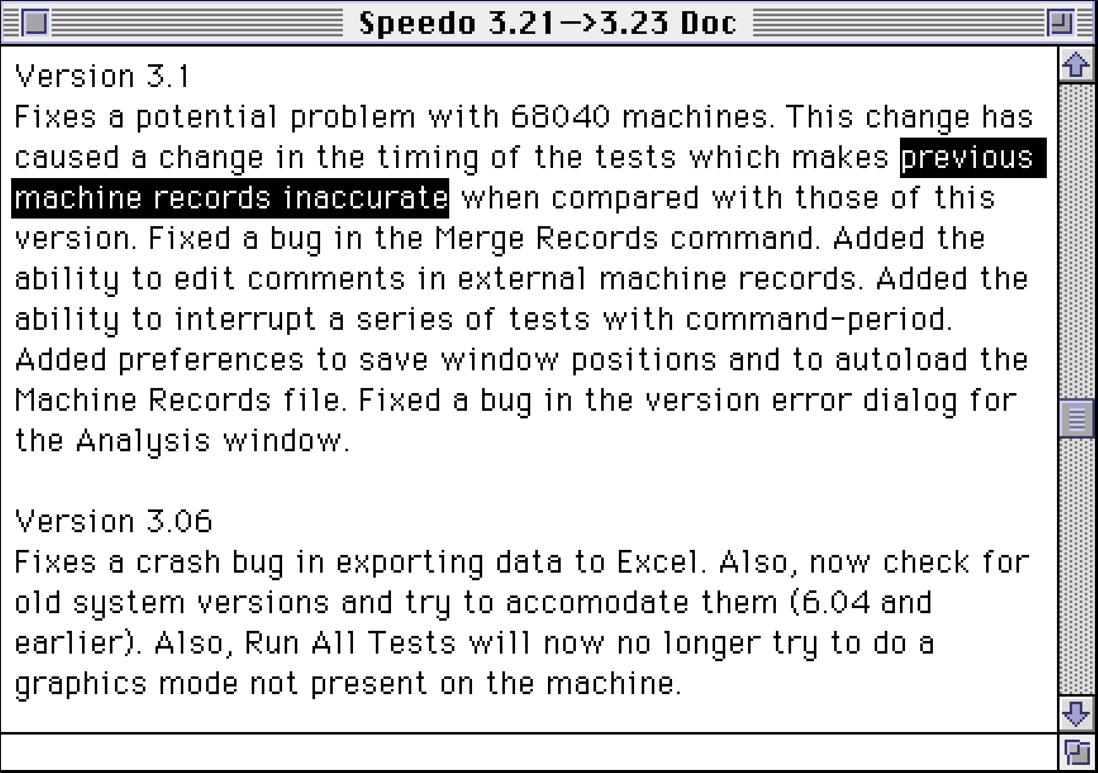

I did not use Speedometer 3.23, unfortunately. When checking the Speedometer 3 page on Macintosh Garden, it says this:
Note: Algorithm changes occurred at v3.01 and v3.1; so absolute benchmark results across those version boundaries are not strictly comparable.
That implies that the 3.06 version I used should differ from the 3.32 version you used, and yet, the results are quite "comparable," so maybe that statement on the Garden is in error. I do know versions 3 and 4 differ in their methodology. I just can't remember which 3.x versions mark the change.
Thanks also for clarification on screen resolution differences! That explains the numbers perfectly!
Thank you for your kindness, but you may not need to re-run it in v3.06.
I just downloaded v3.23 and checked its version history, which indicates the only change impacting 040 processors (not the 030 like you and I are testing)...
This also means none of us should use Speedometer versions lower than 3.1 when testing any 040 machine.

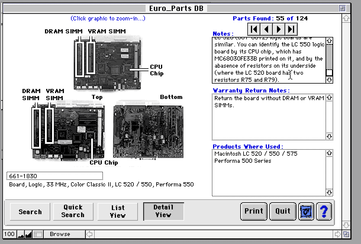

Fun thing I found while doing some research:
The Apple service parts database from the 1997 Service Source CD-ROM specifically calls out resistors R75 and R79 for identifying an LC 520 board versus a 550 board. No mention of R80 and R67. Have to wonder if R67 is also truly necessary for the overclock? Or if there's boards out there with only two resistors populated? Or if this is another case of bad documentation? I'm leaning towards bad documentation. ;)
Reactions: Nitram78
Probably bad documentation because I’ve only ever seen those three resistors, and all three, perpetually mentioned.
This is yet another case of “you have to try it to find out.“ Meaning, remove only the two resistors, but not R67, and see what happens.
