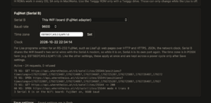

Added FujiNet support in the latest version, which can be used with Tim O'Connors FujiNet enabled apps. https://lisalist2.com/index.php?topic=884.0
So I can do things like see where the international space station is at this very moment!
Very cool! And looking forward to using this to enable more cool apps on the Lisa that could benefit from limited network capabilities.
