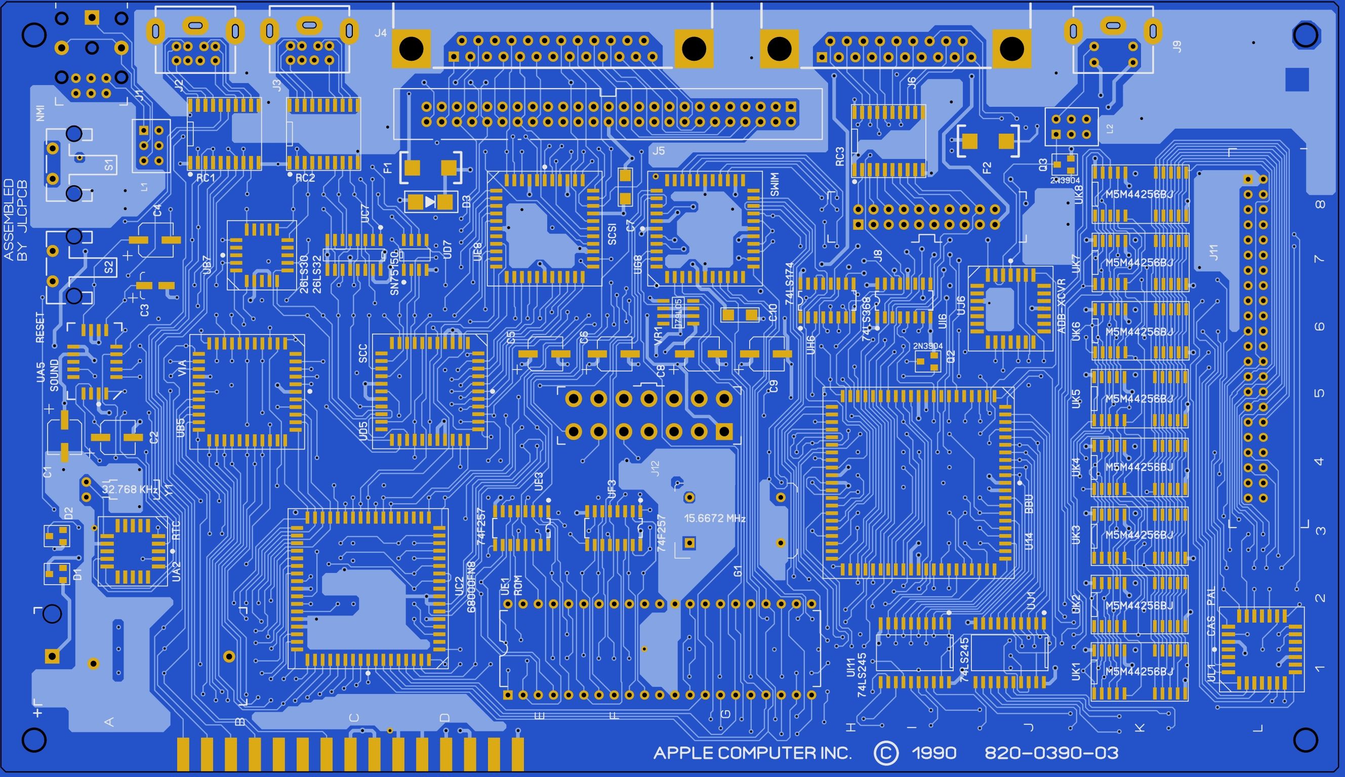

As with the Macintosh SE, many Classic's have died because of Apple's short sighted decision to add a battery to the board - and unfortunately a particularly explosive one at that! This will inevitably pop and causes a horrific amount of damage.
Thankfully, because i've done this before, with the Macintosh SE, I decided to make a near 1:1 reproduction of the board, using Sprint Layout v6.0 again.

Hi! The Classic Reloaded is not available to the wider world quite yet - although, if you're based in the UK, I can send you a near final revision board that needs a trace cutting and two tiny bodge wires adding, then it works 100% fine - it's pre-populated with most of the passives on the bottom side, barring the inductors and ferrites.
If you'd prefer to wait, I've licensed the design for commercial use, to @MacEffects :)

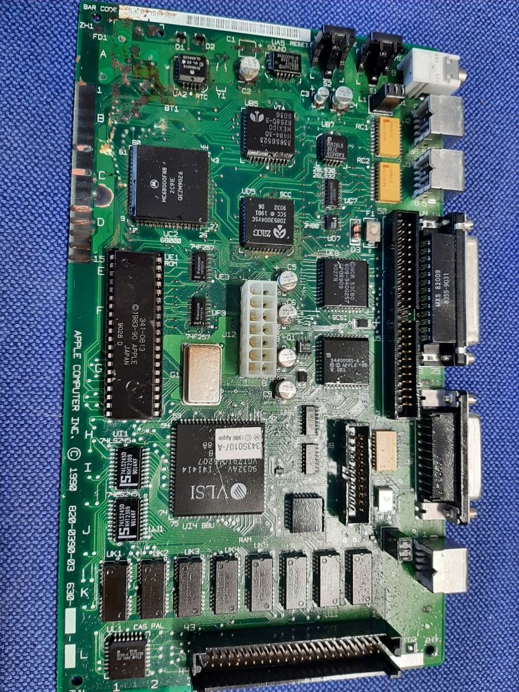

Hello, do you have a timeline of availability to USA, got a mac classic, pulled the board and the battery had destroyed the battery area, thanks
@MacEffects has the license, as with the Macintosh SE Reloaded, for board sales in the continental US - not sure of the timeline of production on their side though. If it's a while, i can do a small board run, with SMD pre-assembly done on the rear (barring the inductors)
