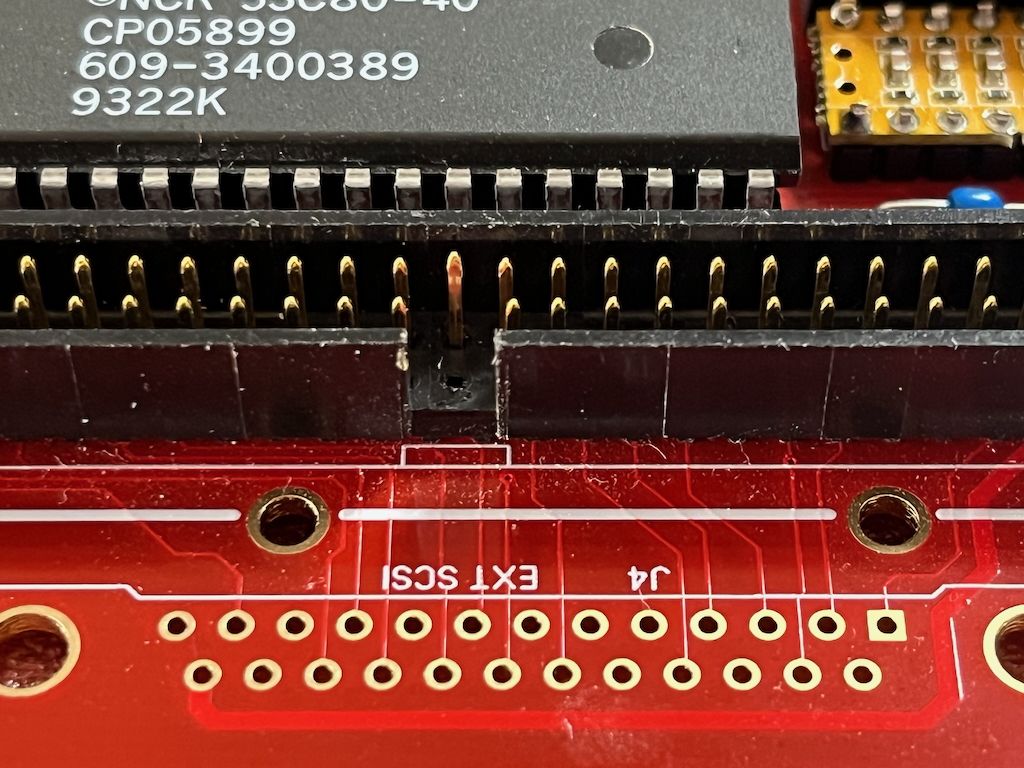

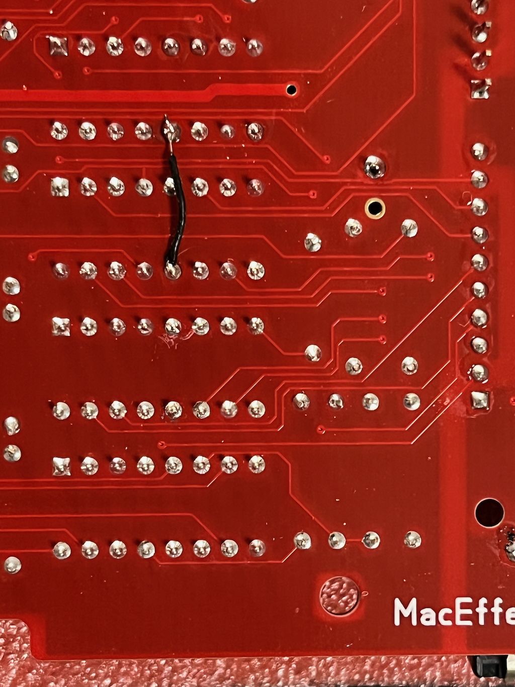

I haven't a serial cable to test my fix on the serial port. But here is the mod :
For the SCSI port, I found the simplest solution. Just remove the pin from the SCSI connector. SCSI is still working after this mod.

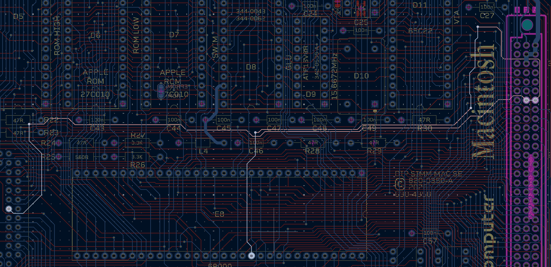

This was probably routed before most of the CAD tools were in good shape. It looks like there is a lot of cleanup that could be done now. Even this little section is a mess:
It's a relatively simple design and just moving a few traces around clears up space for further cleanup and refinement.
It is disappointing to me that these reverse engineering projects don't lead to anything new/improved. For example, it seems to me that switching to 72-pin SIMM modules/sockets would be a simple improvement that would free up board space to directly incorporate some other new stuff.
