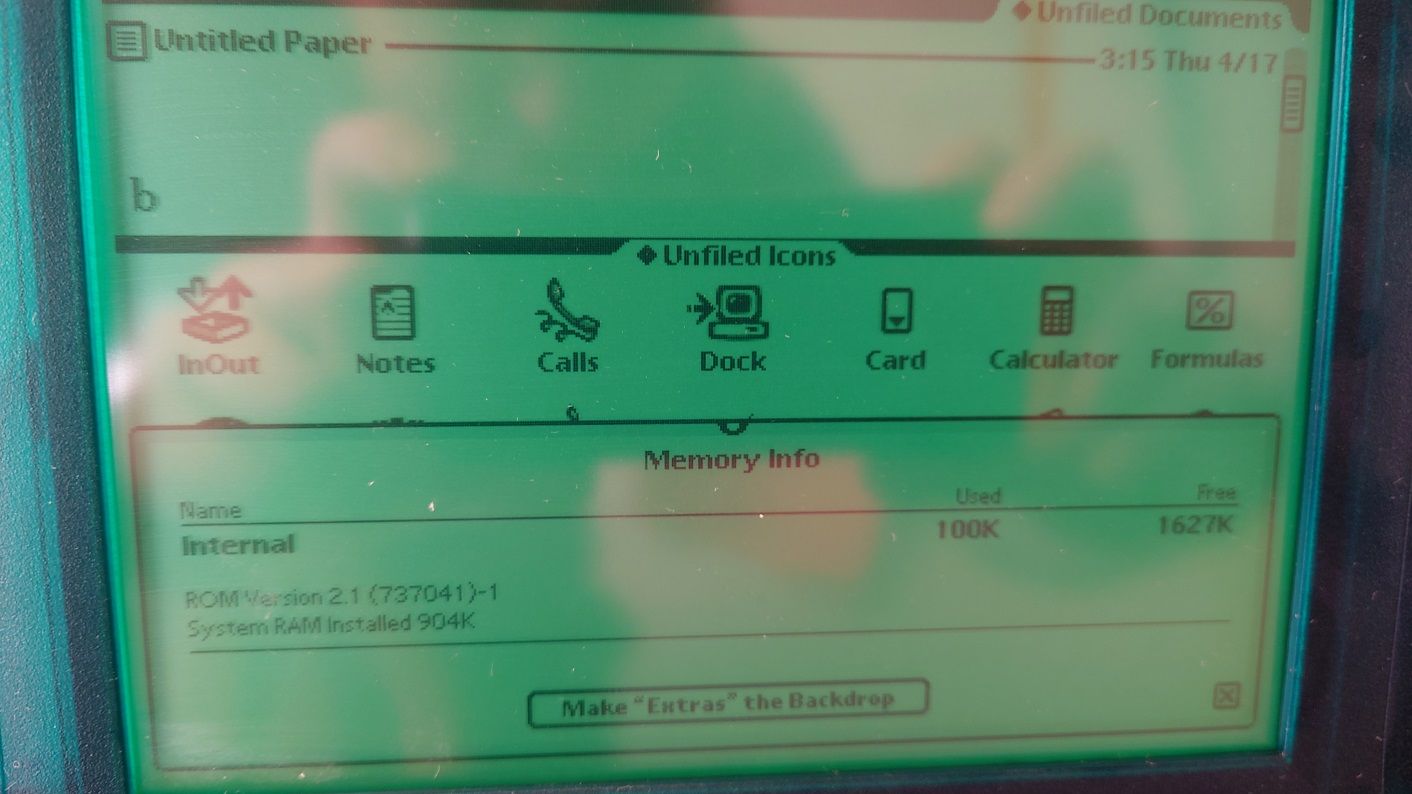

Tested the eMate display cable, and success! This eMate had a working display but wouldn't accept touch inputs. Now it does. :)

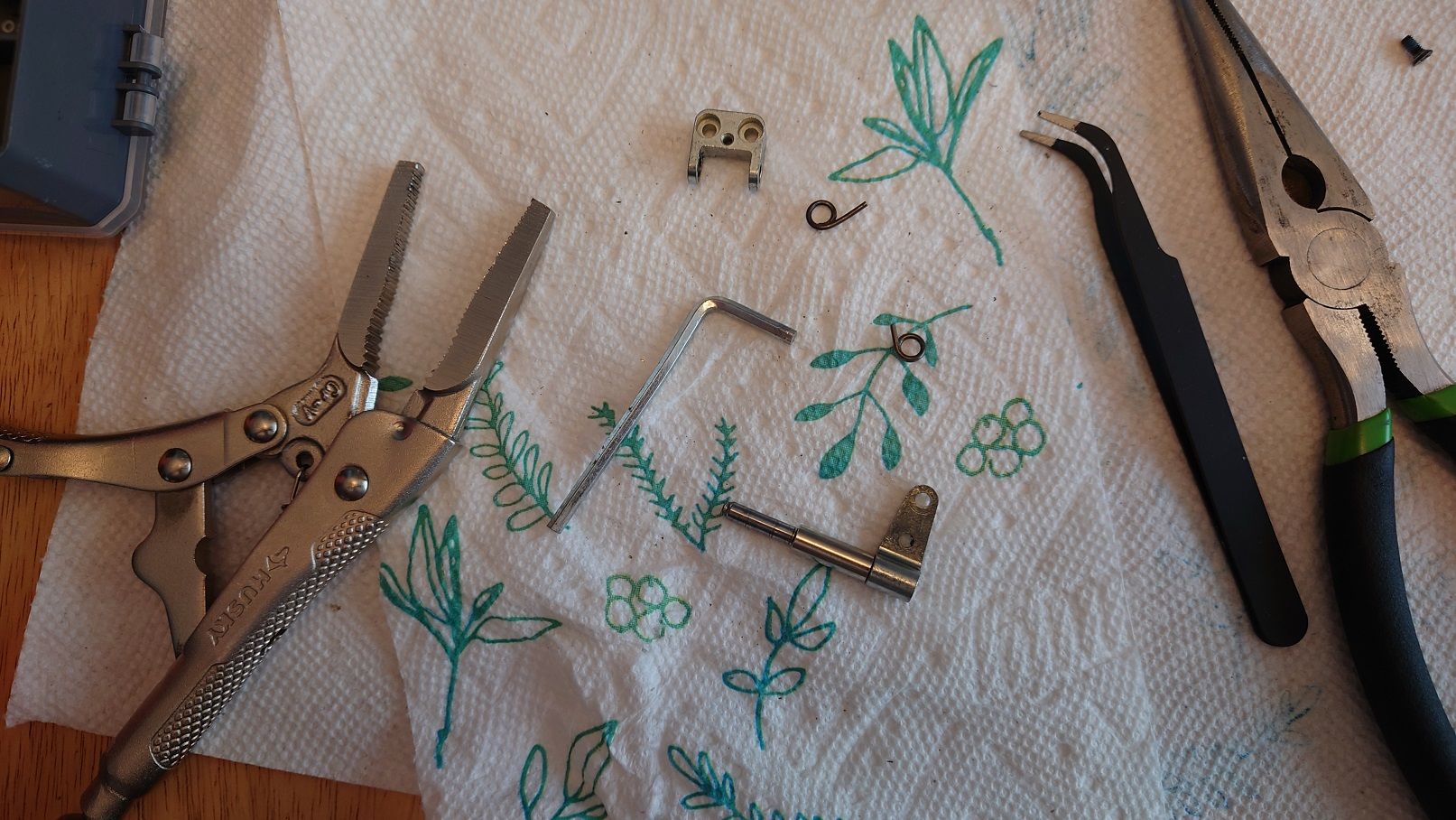

I also went through the process of fixing up the hinge so it shouldn't eat the display cable again. Fixing screen hinge tightness was pretty time consuming. If you can get the friction spring back onto the shaft of the hinge by hand, it's too loose. I had to use a set of "groove joint pliers" to squeeze the friction springs back on after the fix, that's how much force it took.
"fast orange" easily removed the old grease from the hinge, and then some synthetic brake slide lubricant was used when reassembling.

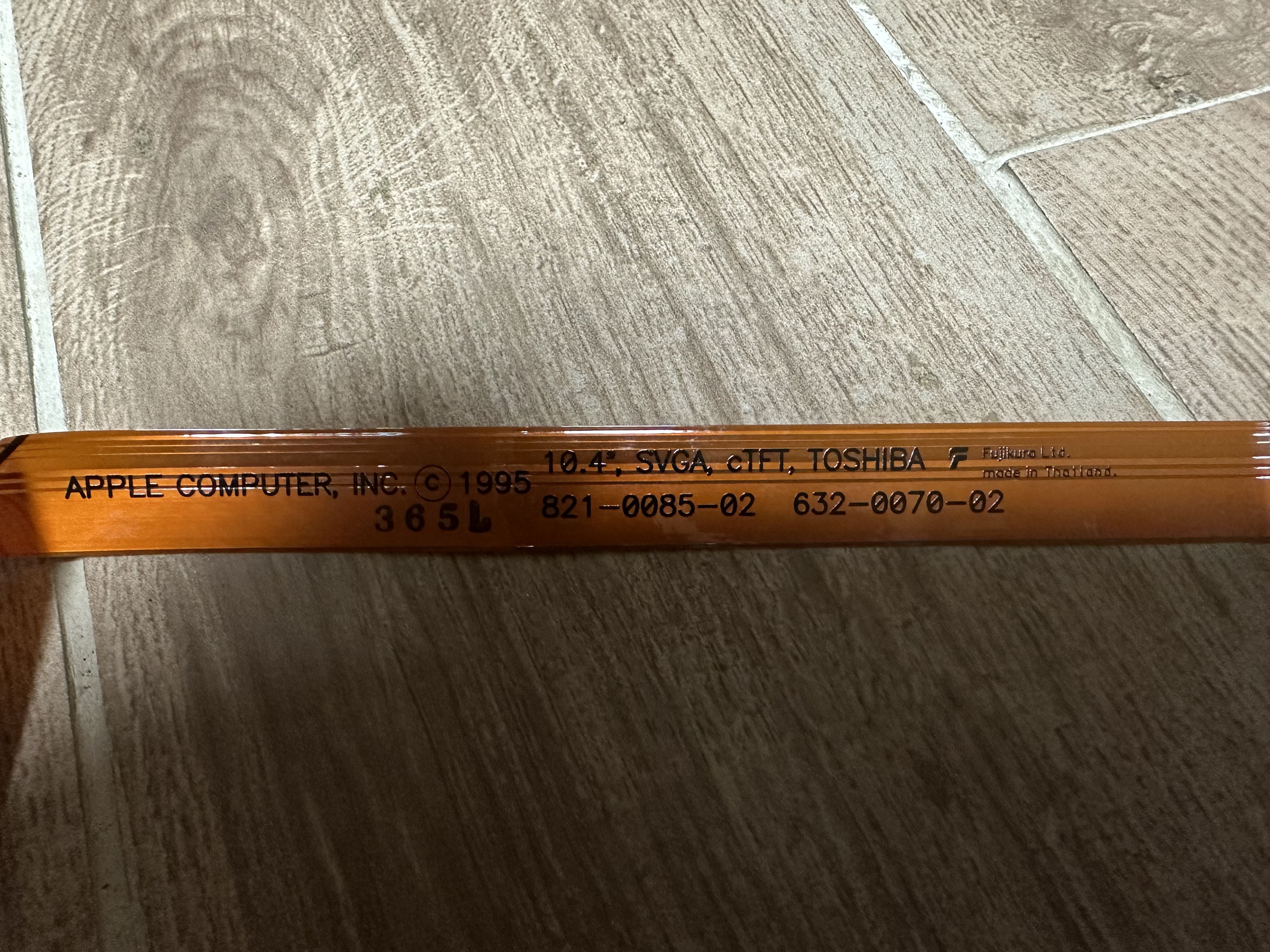

If you have an original cable that needs recreation, please post a picture of it here
I recently got around to removing the damaged cable from my 5300ce display, and it appears only 3 or 4 traces have been damaged by the tear. It would probably be fixable but I would need someone with an intact cable to do some continuity testing. It's pretty complicated as well, so I'm pretty sure recreating it would be a challenge. I can get some photos of it next week.
