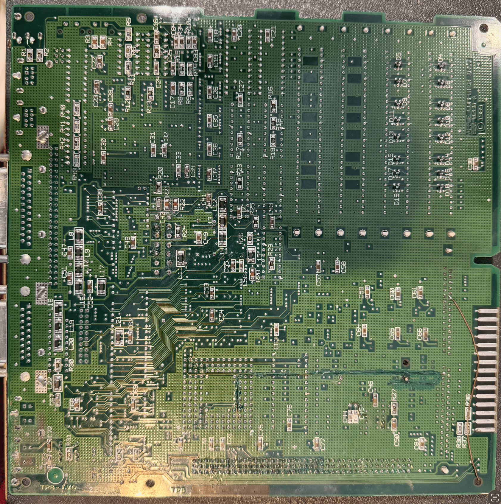

Hello,
I know I'm one of many facing troubles with Mac SE/30 repair, but I'm a bit stuck with the board I'm working on and wanted to get some suggestions from the community.
I have two SE/30 boards, both of which got battery bombed. One of them is pretty much destroyed beyond the point where I believe it is repairable (it has been useful for comparing connections and possibly as a parts/test board for soldering), but the other feels like it's painfully close to actually working. I may be delusional about that. I have found many bad connections which I have repaired using wires, and the situation has improved (going from a horizontal line on the CRT to a typical simasimac fault). I noted some damage on the RAM and especially the ROM SIMMs, and have ordered replacements for both. In the meantime, I've been continuing to chase bad connections around the board which leads me here:
I found UG12 and UI12 had been reworked poorly by the board's previous owner so I decided the best thing to do would be remove and re-install them, but discovered that soldering these chips is really difficult. I have a hot air station and all, so getting them off was okay (with some damage that had been caused previously), but getting them back on isn't too easy for me. Any suggestions or tips on working on these?
I also noticed while re-attaching UG12 that there was a short across data lines 28, 29, and 30. I believe the short is actually occurring under the CPU based on resistance readings, and by desoldering the pins of the CPU on those data lines, found the short disappeared from the pins. Therefore, I don't think the CPU is shorted internally (I figured this was unlikely anyways), but the CPU is not socketed so I'm really not sure how else to approach fixing this. Unfortunately, this leaves me not too hopeful for this board.
At this point, I'm not sure if there's any good way to try to resolve the shorts, at which point I would proceed to fix the remaining bad connections and reinstall new RAM/ROM. Beyond that, I'd consider migrating the components to a reloaded board, but getting the board and then all the parts together seems a bit daunting and I'm skeptical of whether or not I have the soldering skills for doing some of the surface mount chips. Is this the best route at this point, or is it still realistic to try to repair my current board? I could definitely use some opinions on that. The problem is, these are all the many issues with the board that I've found just in my own testing, which doesn’t even guarantee all the chips are working and there could be even more bad connections from the battery damage. I'm basically wondering if continuing down the repair rabbit hole is even worth it with this board or if there are other, better options I should be considering.
I'm attaching photos of the board in case there's anything glaringly obvious that I have missed. Unfortunately, it's a mix of my own work and the work of the previous owner, which further complicates things, and it's tough to clearly capture much in the photos. Obviously I am aware of the missing chips, all my testing and probing so far was done with them installed :)

That board looks repairable - to me, I would remove the battery holder though and look under there, if there was a leak and damage.
The secret to getting rid of bridged pins, imo, is good flux, it makes the solder cling to the legs/pads and not bridge as badly.
If you're enjoying the process of troubleshooting and repair, stick with it, that first repaired moment, or first Bong!, is exhilarating and worth the toil when you finally get it.
But if you just want a working SE/30 board, consider contacting Will Jacobs of CayMac Vintage, he stocks Reloaded boards and provides a transfer service for your old components. It's also great to watch how he does this, he makes no secret of how the transfer process is done - but it is a skillful procedure.
If after watching him perform the SE/30 Reloaded swaps, you don't feel up to the task, contact him about his SE/30 Reloaded service. He's mentioned in his videos that sometimes he forgets to update his website, so it says the SE/30 Reloaded service is Sold Out, but he just forgets to update his site - make sure to contact him in such a case.
It took me about a year to walk away and come back and fix my SE/30 board, it was the Simasima Repair Guide that finally got me through it.
The CPU diagram also helped me in the end, find the missing D0 trace to the ROM slot - in my case - https://wiki.retrotechcollection.com/Macintosh_SE/30_Troubleshooting

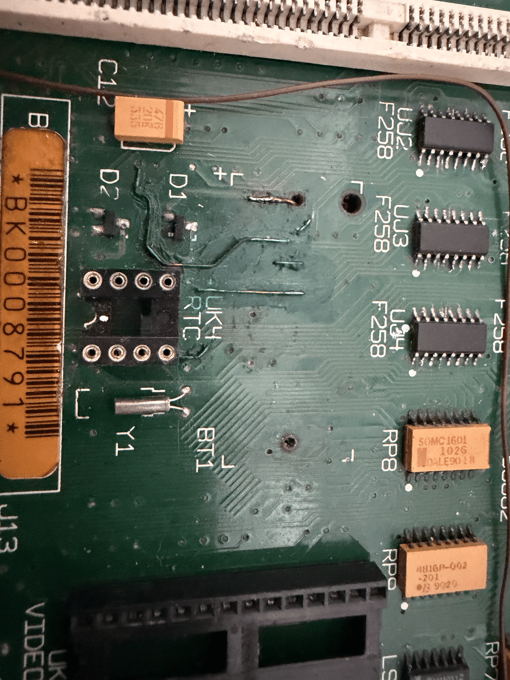

Also, checking under the battery holder was a good call, it is a bit of a mess down there. It seems like the necessary bodges there were done already but I'll have to take some more time going through that (photo attached).

Sounds like a good idea to send the worst SE/30 board out to be Reloaded and do the work yourself on the board shown above, I think that one is repairable, especially after seeing what's under the battery holder.
If the CPU was never removed from the board, there shouldn't be anything under there to bridge the pins; some leaked electrolyte can be flushed out from under there if that's necessary.

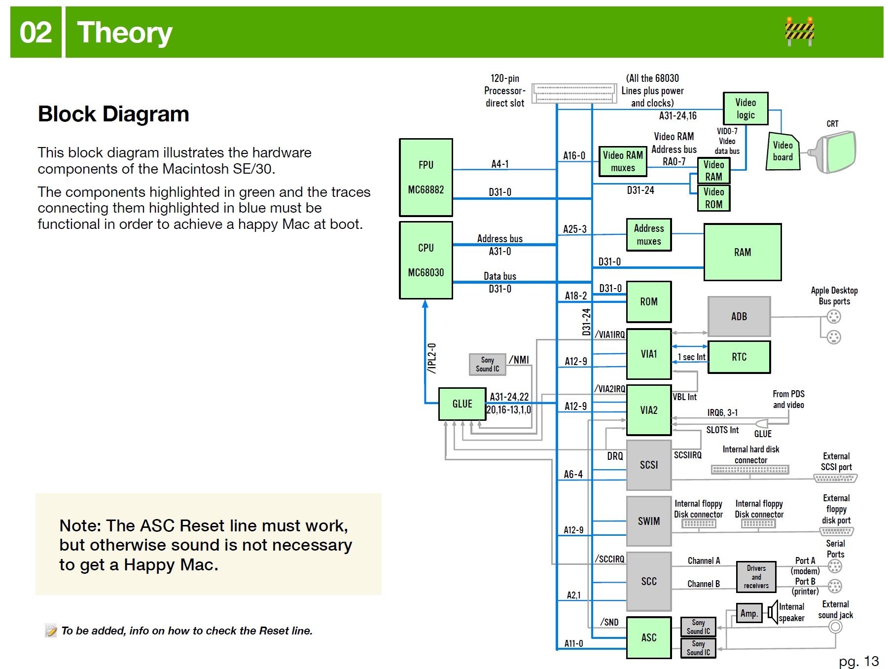

This page in the Simasima Repair Guide lists the bare minimum chips that are necessary to boot, in the Green Boxes:

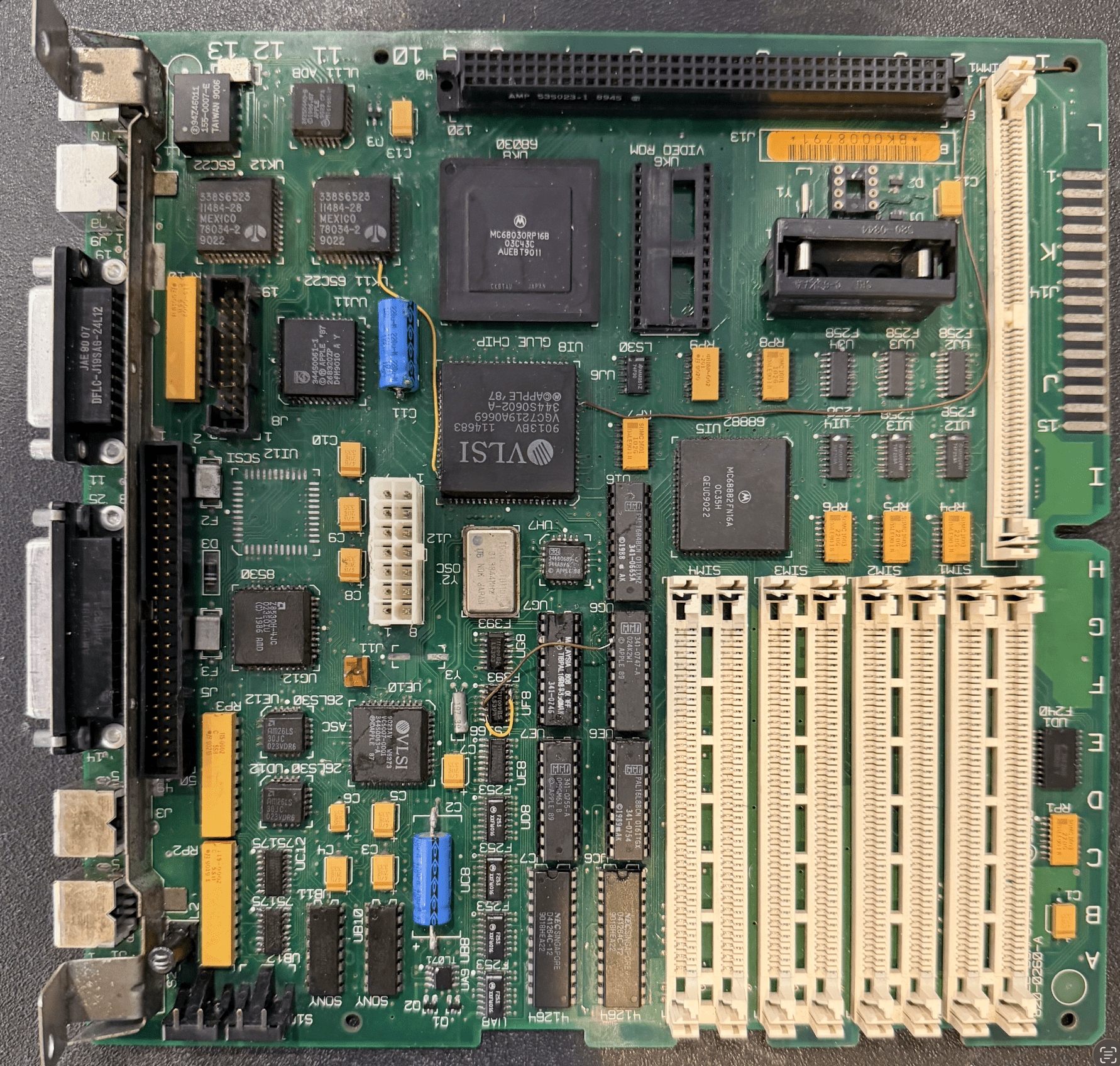

Where are you finding that your Data Lines are bridged, what location exactly?
Yeah those schematics have been pretty helpful, and that diagram you sent is useful as well.
The short is reading close to 0 ohms between the pins for data lines 28, 29 and 30 at the CPU (interestingly all in a line in the diagram attached), which is why I suspected it was around here. It reads closer to 0.8 ohms at UG12 where I originally noticed the short. I tried flushing out under the CPU using some alcohol, as well as scrubbing with a brush under there but that didn't help at all. I also removed UG12 again to make sure that had nothing to do with it, since it seems it's not necessary to boot the machine, but that had no effect.

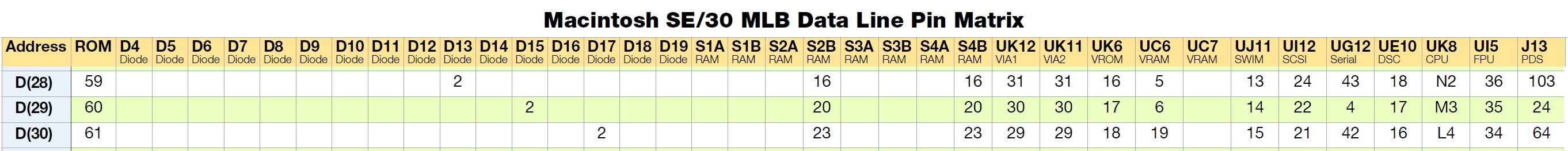

Could it be possible that the short is not actually at the CPU, but somewhere else that D28, 29 and 30 meet?
The Data Pin Matrix lists a few places where those Data lines are closely located to each other on the legs of chips, might be worth checking in these locations for a bridge, or errant blob of solder:
Yeah you were right, not sure why I jumped to the conclusion that it was at the CPU honestly, in fact the problem was quite obvious if I had just looked.
The previous owner I guess had desoldered the VIA chips and had put them back on with bridges and missing connections all over them. The short was in fact between pins 29, 30 and 31 of VIA2. That has been fixed now.

Have you already toned out all of the Data lines from UE10 and the CPU to the ROM slot?
Yeah I did that and there was one missing connection but fixing that didn't change anything. The video problem seems to have gotten worse, and from what I can tell it comes in and out when i manipulate the board around where the glue chip is. I've triple checked it for bad connections but really don't see any around there. I'm sure it's somewhere so I will have to keep looking, I know the video circuit is nearby so I will look around there.
