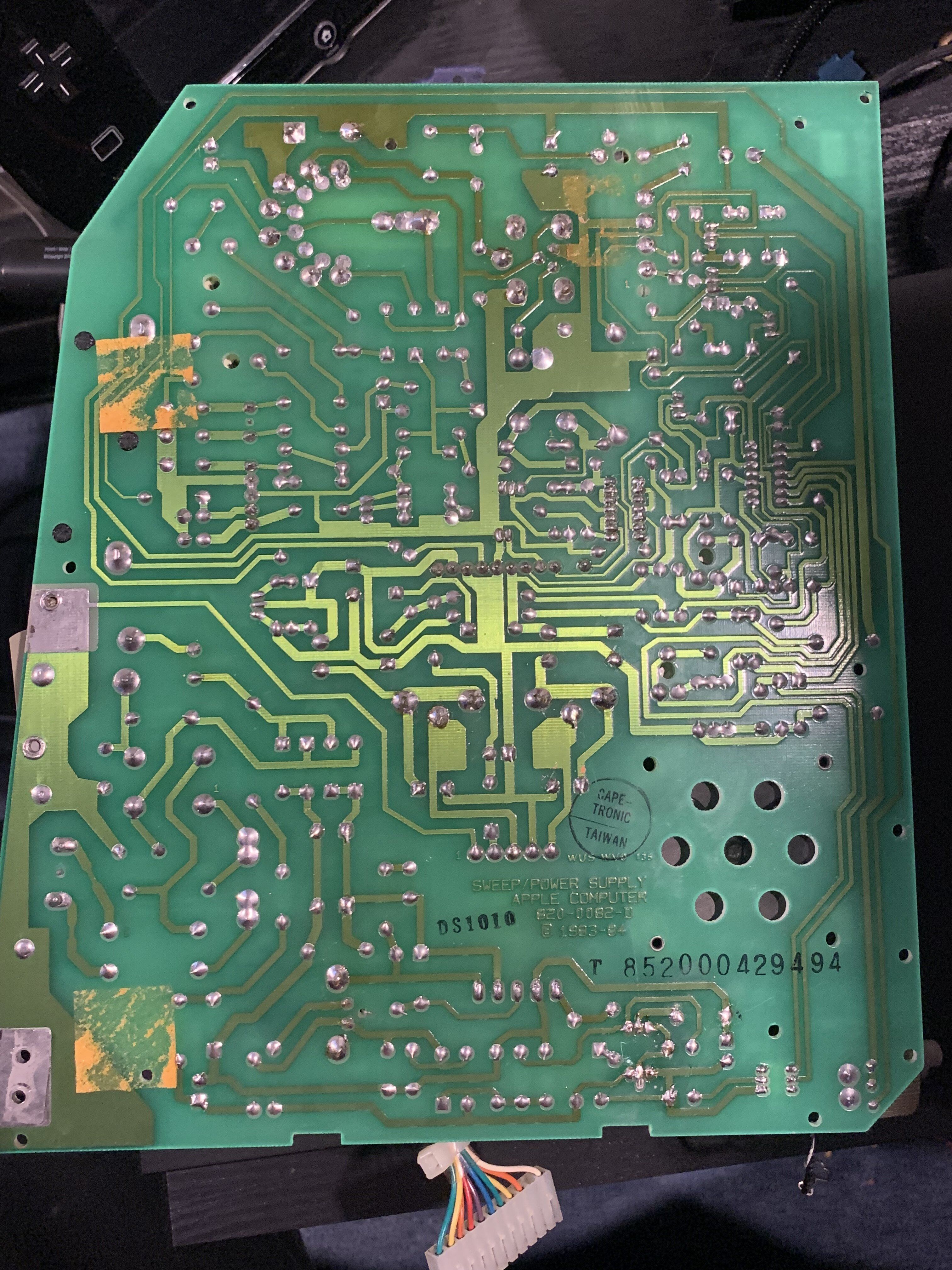

Need help on how to assess this M0001 analog board.
For context; almost a year ago now this board stop working with a loud pop and accidentally turning it on without being connected to the motherboard fried some components (r45, r60, q9E, q10), which i replaced. Once everything was soldered i reassemble the computer, plug it in… absolutely nothing. Swapped in a good fuse but that didn’t change anything so the fault is something else. Attached some pics to show what it looks like currently. I know someone who could check connections with the multimeter but whats a good place to start?

In the photo it looks like you may have a solder bridge on Q10. Also some solder balls to remove
