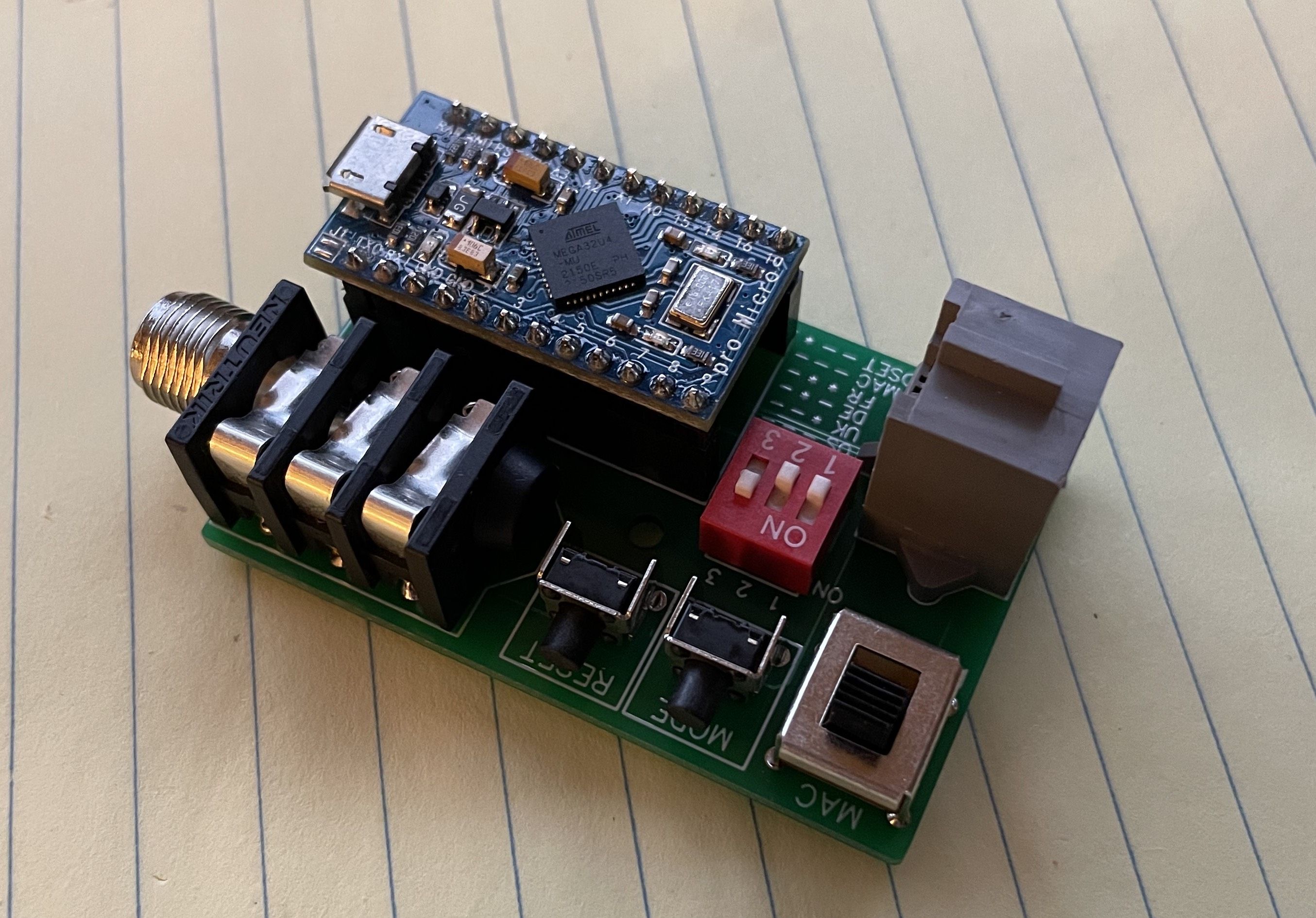

Welp, this is it - the last major project on my plate to be completed before my wife and I have our first kid in about a month. Born - sorry for the pun - out of my refusal to spend (checks eBay)... a car payment on a second Lisa keyboard, I wanted to make something highly compact that could take what I felt was the aesthetic descendant of the Lisa's keyboard and let me use it with a Lisa. GitHub repo is here.
On its face, this project is fairly simple: allow a user to connect an M0110A or M0110 + M0120 (US or international for any/all) to a Lisa. Below the surface, though, I've taken advantage of some prior work by others to make this as straightforward as possible and added some additional features that I think are a decent value-add. First, while the hardware design is original, the implementation of Mac and Lisa keyboard protocol handling is (largely) not. This adapter uses a modified version of RebeccaRGB's LisaKeys libraries to handle two important functions:

Aside from the basic adapter and serial input functions, this unit will also allow you to connect both Mac and Lisa keyboards (at the same time, if desired) to the adapter and test them for functionality. Just make sure the adapter is connected in the same fashion as for using the serial mode and press the MODE button twice (from powering on - press MODE once if you were already in serial mode). You'll see the words "Keyboard Test Mode" appear in your serial console when you have successfully entered this mode.
The last thing I added, which is entirely ancillary, is the ability to user either original Mac keyboard cables or unmodified, off-the-shelf telephone handset cables. If you've ever tried to use a handset cable with an M0110 and a Mac 128/512/Plus then you know they don't play nice. This is due to the Mac cables being straight-through cables and handset cables being, essentially, crossover cables. Don't have any Mac cables lying around? Just toggle the DPDT switch from MAC to HANDSET and flip DIP switch 3 to ON and you're good to go. Is this largely pointless? Sure! Did I think it was neat? Yep. Will it actually help anyone? Meh.
Aside from the PCB, this is all off-the-shelf and made to be as small and cheap as possible while still having some neat features beyond just being a keyboard adapter. The per-unit cost breaks down as follows, for a total of $17.48:
  • $8.21 for everything but the Arduino Pro Micro and PCB from Mouser
  • $5.40 for the Pro Micro from Micro Center
  • $0.72 per PCB from JLCPCB ($3.87 per PCB if you include shipping)

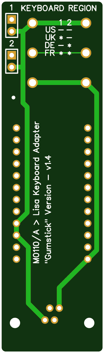

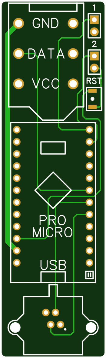

When it comes to a much smaller and slightly more cost-reduced version, here's what I call "the gumstick":
I sincerely try to avoid using SMD components, mostly to make sure anyone can assemble what I toss out there regardless of soldering skill, but this time I decided to make a slight compromise. The reset button is an SMD tact switch, but the pads are pretty decently sized and it has a stress-relief pin to keep it in place while soldering; so long as you put that on first, it should be doable for just about anyone. I tried to pick one that both met space constraints and looked easy enough to solder down, so hopefully that turns out okay. The whole PCB is about 75mm x 22mm (~3" x ~7/8") and is pretty much just an MCU, ports, and region jumpers. Approximate per-unit cost is about $2.00 less than the larger one, so it's not a huge savings, but it's super-compact - about as small as one of these can get. Here's the BOM from Mouser if anyone's interested in this ludicrously sized little gizmo, lol. I'm probably not ordering any of these right this second, as I prefer to try to consolidate JLCPCB orders into a single batch due to shipping costs; I should be placing one more order prior to baby showing up, so if anyone is interested, let me know!
