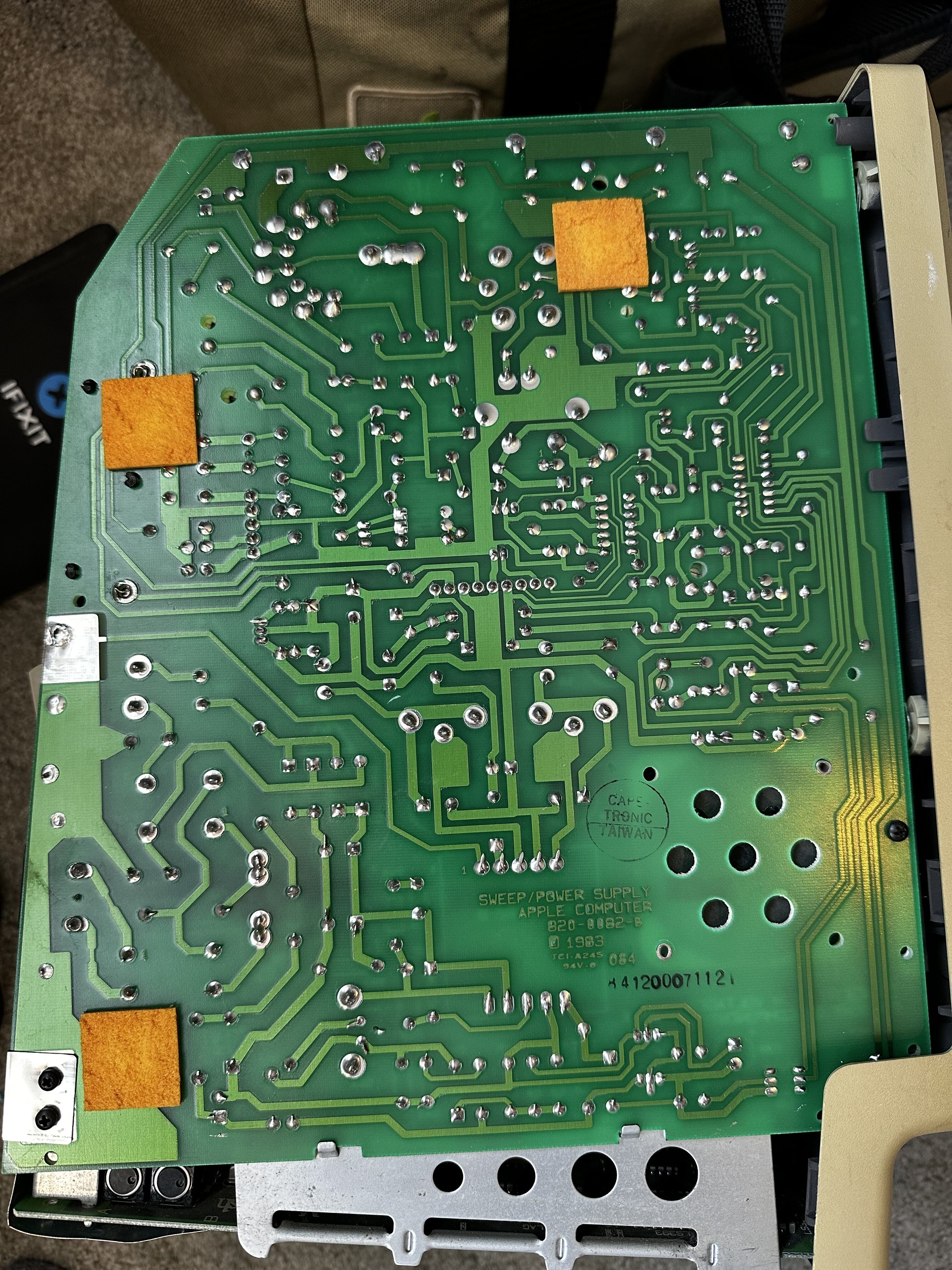

I recently acquired a 128k to finish off my compact collection. It has some obvious power issues - screen wobbles and moves with the floppy drive access.
I opened it up today and the board has the number 820-0082-B 1983 on it - looking at Console5 and the internet in general I don't see any cap guides or kits out there (of course I just put a mouser order in yesterday)
Is there a guide/kit out there or will I be making one in this thread? :)
pretty sure that's the part number for the bare circuit board. you need the number on the other side of the Analog Board, forward edge near the top, 630-0102- , the Assembly part number. it's hard to see with the board installed.
BUT, Console5 only has the one kit (well 2, 1 US & 1 international) for 128k thru Plus (and read the notes):
https://console5.com/store/macintosh-128k-512k-plus-analog-pcb-cap-kit-630-0102-661-0462.html
with this as it's wiki:
https://wiki.console5.com/wiki/Mac_Analog_Board:_630-0102
Mac Analog Board: 630-0102​
Cap List​
Purchase these parts as a kit
C1 3.9uF 25v NP (may be 3.3uF / 50v on later revisions)
C2 4700uF 16v
C3 220uF 16v
C5 47uF 10v
C6 22uF 50v
C9 10uF 160v
C11 33uF 16v
C13 33uF 16v
C14 22uF 50v
C24 2200uF 10v
C25 1000uF 16v
C26 1000uF 16v
C29 2200uF 10v
C30 220uF 16v
C31 1000uF 16v
C35 100uF 200v
C36 100uF 200v
C38 0.1uF 275v RIFA / Metallized Paper
C39 470uF 10v
C43 470uF 10v
also helpful info here:
https://tinkerdifferent.com/resourc...-logic-board-p-n-630-01010-capacitor-list.24/
this is the Logic Board kit:
https://console5.com/store/macintos...xial-electrolytic-main-logic-pcb-cap-kit.html

Yep! Just ordered the kit. Been so long since I opened it up and it looked like a part number i just assumed. Thanks!
