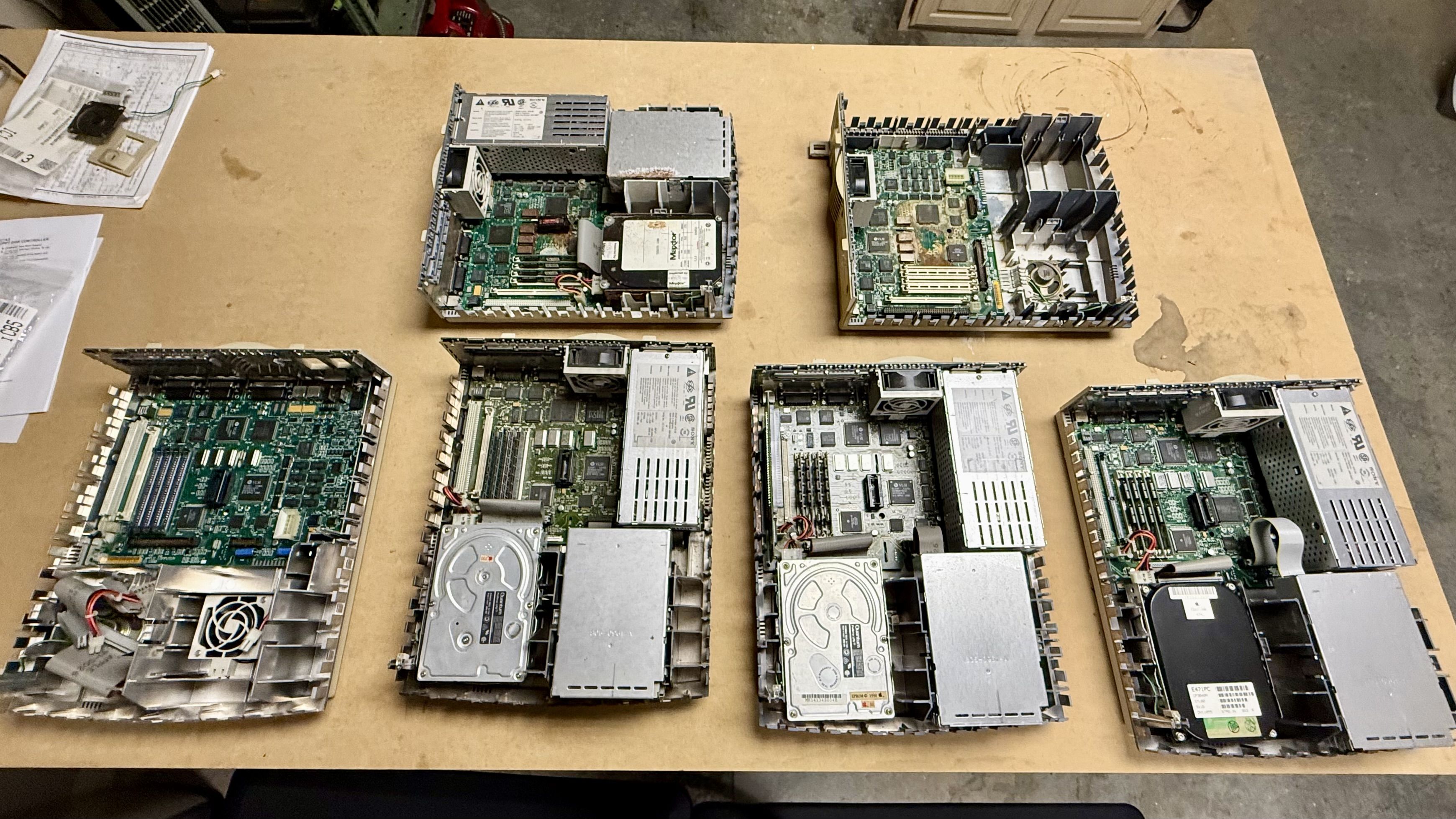

To keep things straight, I'm labeling them A through G, using the phonetic alphabet. That makes Alpha the first Mac IIsi I restored back in 2021 (not in the picture above). It will be pressed into service when necessary for testing. Bravo will be another system I partially restored back in 2021. Looking at my old work caused a bit of cringe, but the cap replacement looks passable. However, I attempted some fancy bodge work which I now suspect is unnecessary. So that's where I'm starting.
Beginning with Bravo:
This is the sister to Alpha, which was successfully restored in early 2021. I acquired both from a Texas seller who said he picked them up at Computer Reset. I started off repairing both, but when this unit didn't work after the cap replacement, I set it aside.

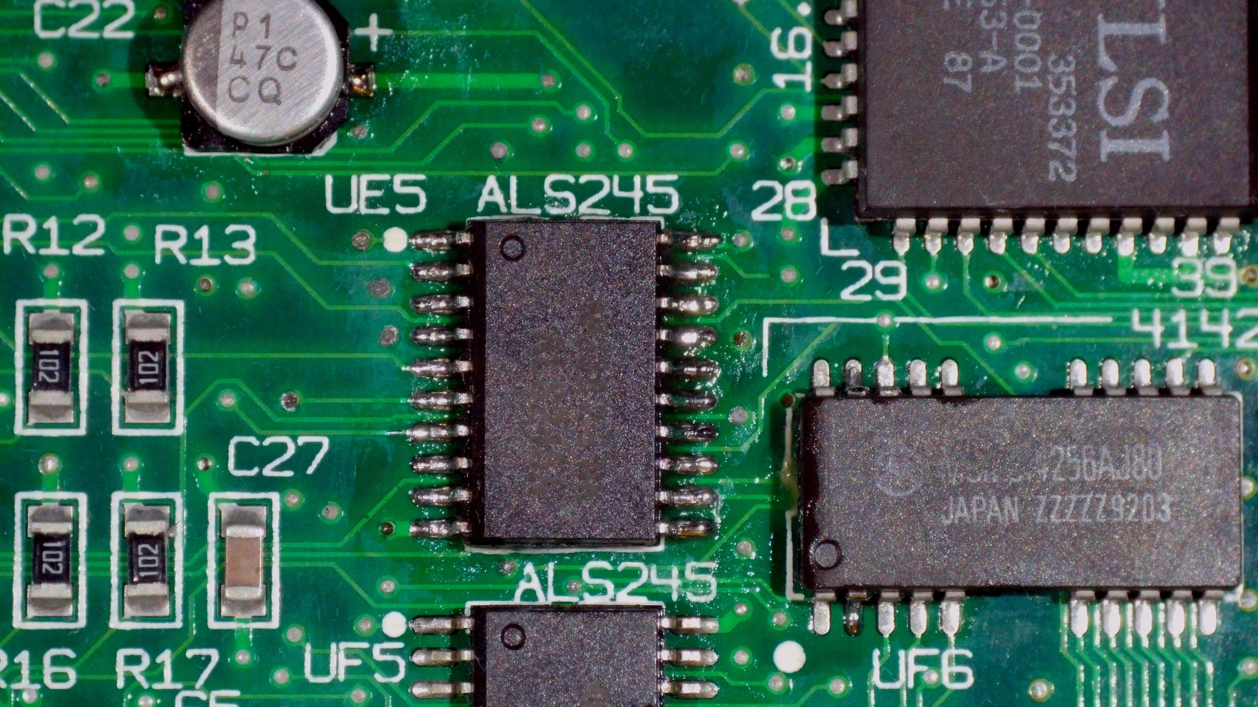

It seems I lifted a pad on C10 back in 2021, but that was an easy fix as the via is adjacent. I vaguely recall the system booting to a gray screen, and at some point, I somehow zeroed in on the RAM bus transceivers. Both UE5 and UH5 were quite corroded. This is where I got cute, and ran some fancy bodges when I couldn't restore connectivity to the nearby DRAM. But when things didn't go well, I again set the computer aside.

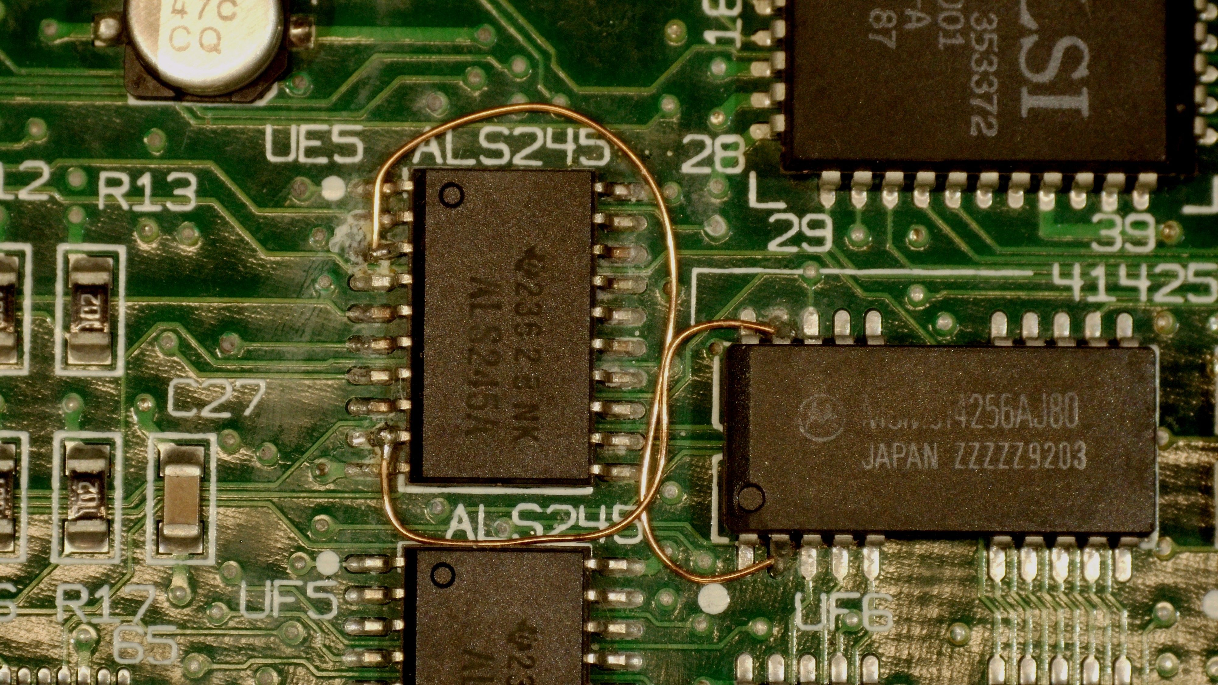

So, this time I started with removing my bodges and removing UE5. (I lacked the courage to remove surface mount ICs in my earlier repair attempts.) The chip and its pads were disgusting. After lots of flux and heat, I was finally able to get new solder on the pads. I then discovered the bad trace from pin 3 to a via located under the chip. Once I fixed the trace, that bodge became unnecessary. I'm glad, because I also realized I ran my earlier bodge to the wrong DRAM! Pin 3 of UE5 should be connected to pin 2 of UF7, not UF6. Cleaning the pads restored connectivity from pin 9 to UF6 pin 19, making that bodge unnecessary.

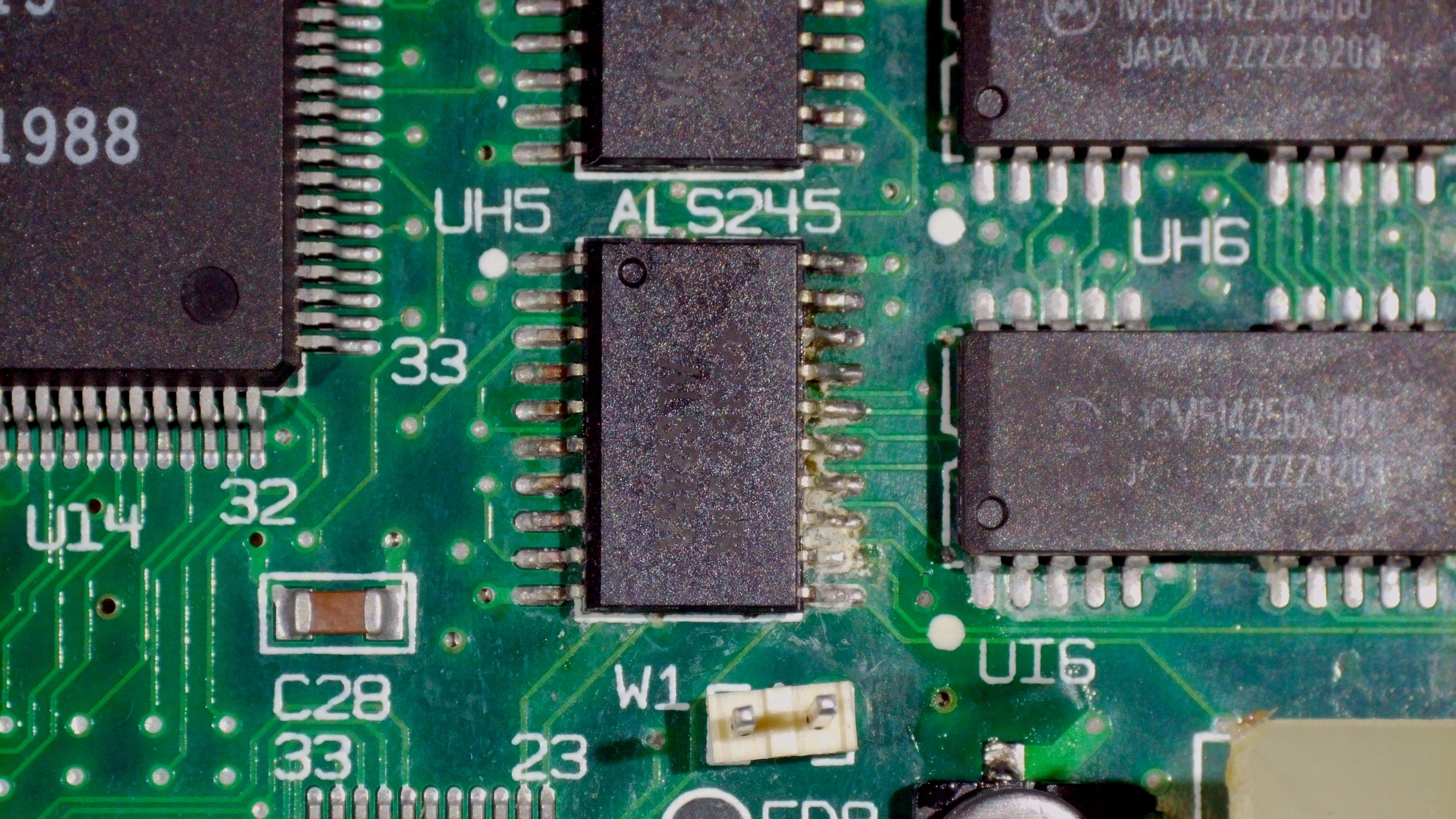

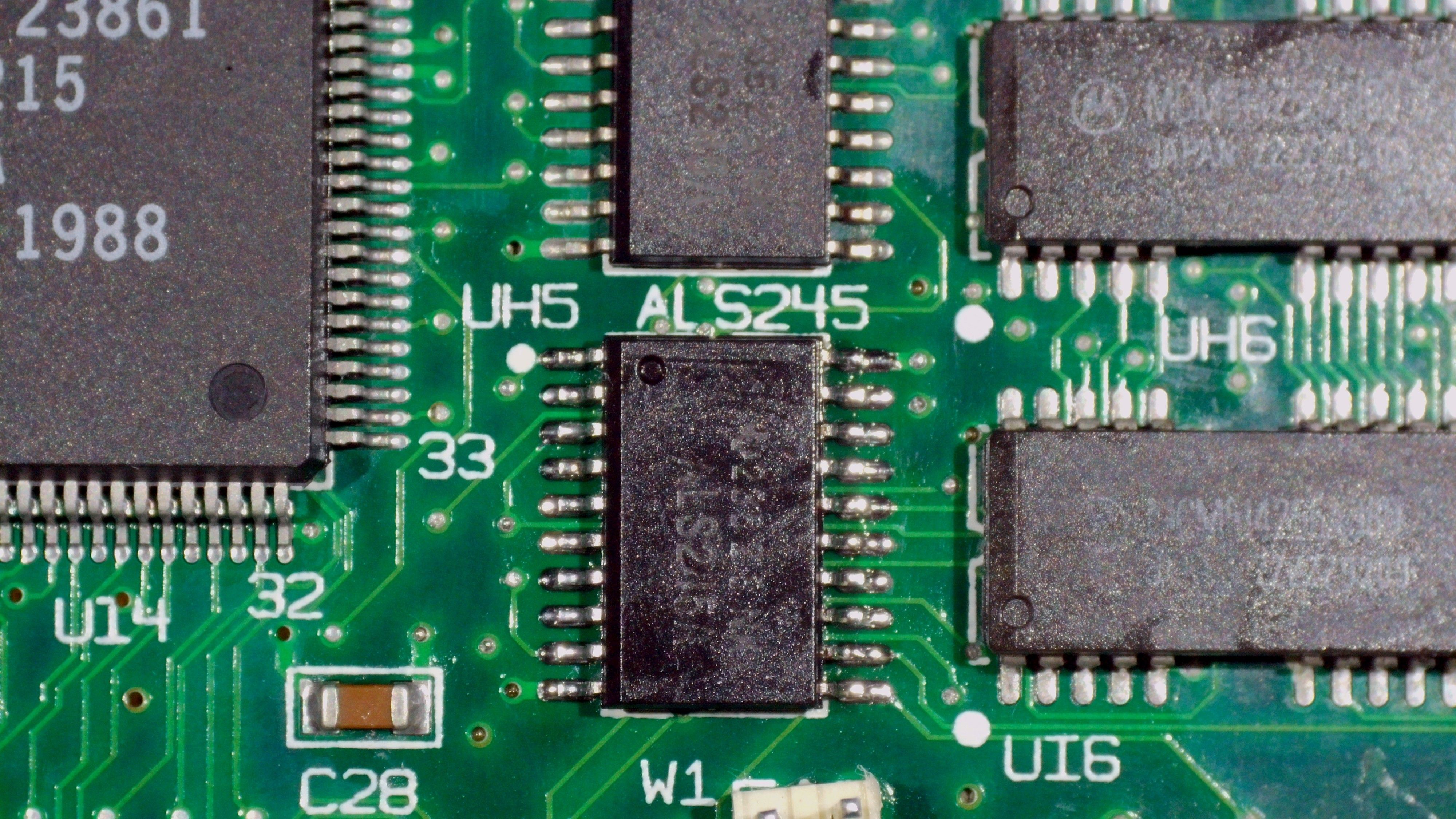

I then worked on UH5. I found three pins were no longer connected to their pads due to corrosion. After removing the IC and applying lots of flux, heat, and working it over with fresh solder, I finally got the pads and chip legs clean. I then reattached the UH5 and carefully checked all connections. It looked good, so I prepped the system for testing.
I was happy to see it spring to life! After running a full suite of MacTest Pro diagnostics, it looked to be good to go. However, I noticed the absence of sound. I plugged in some headphones and could hear. Though it wasn't great sound, and the volume slider didn't seem to change anything.

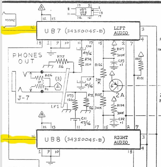

I went through and tested all connections from the Sony sound chips (UB7 and UB8) to the speaker. It was tricky to trace all the way across the board, but I eventually confirmed connectivity. When I probed the speaker with an oscilloscope, I saw noise, but no identifiable signal. I probed the output pin (11) on UB7 and UB8 and saw a lot of noise, but I could also make out a faint square wave poking through when I generated a beep sound. Something was causing noise and a weak signal. While the signal was apparently decent enough to make the headphones work, once the signal traveled across the board, passing through a number of resistors and capacitors, there was not enough for the op amp to pick up for the speaker.
I eventually traced every line in the sound circuitry. Once I was sure everything was connected, I probed each line with the oscilloscope and measured the results. I then pulled out unit Alpha (my working IIsi), and did the same. Everything matched, until I got to UB7 and UB8. It was soon obvious that I was missing about half the voltage on shared pins 12, 13 (getting about 4V instead of 8V) and shared pin 17 only had about 3V instead of 5V. It was then that I realized that pin 16 was connected to something. I say this as if it's a revelation because the BOMARC schematics don't show what either pin 16 is connected to. I was ignoring pin 16, and then realized the drawings did show a line that went off the page and onto a page I don't have! Probing Alpha's pin 16, I could see it is a clock signal humming at 22.5KHz and 5.5V. However, on Bravo, pin 16 is providing 22.5KHz, but at only 2.5V, and the resulting amplitude is much lower.
I could see that the trace for pin 16 hits a via to the other side of the board where it contacts R85. That resistor is reading a correct 33.3k Ohms. Then it hits another via and disappers.
  • Does anyone know what pin 16 on UB7 and UB8 goes to?
  • Does anyone have the missing page from the BOMARC schematics?
  • Can anyone point me in the right direction for the datasheet to the Sony sound chips?

Good to see you restoring Macs again! Where on earth did you get six IIsi's from?
Well, they sort of grew over time.
I got my first from a retired couple who sold me all their old Macs when they downsized. Unfortunately, this is one of the battery bombed units. I then went on the hunt for a replacement, and I ended up getting two because the seller was slow to ship the one I ordered so he graciously sent along another. Finally, I got four more (for a total of seven) from someone who had picked them up, years ago along with some IIci, from an auction. I was interested in their collection of IIci, but the IIsi were part of the package.
I'm not looking for any more!

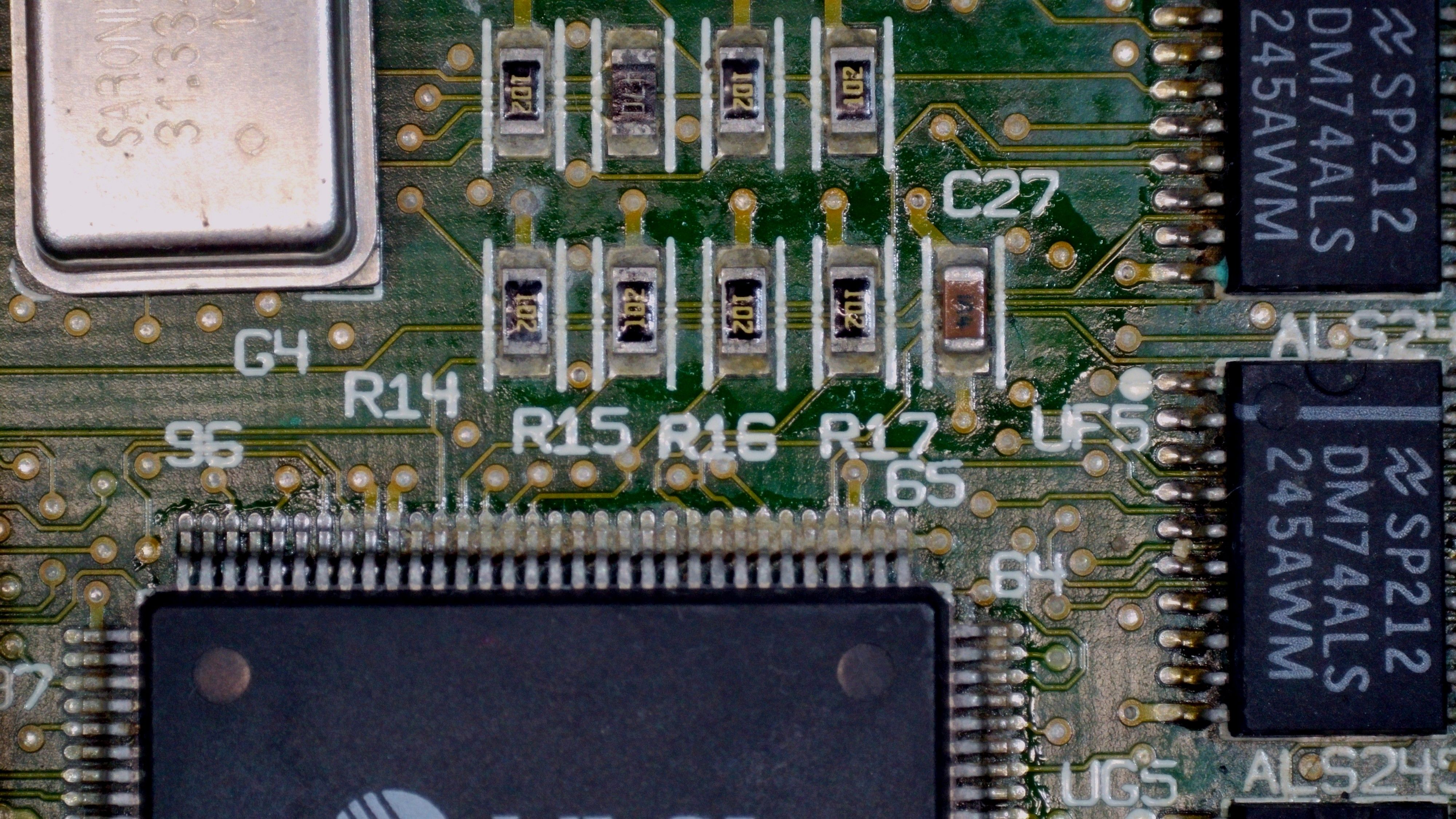

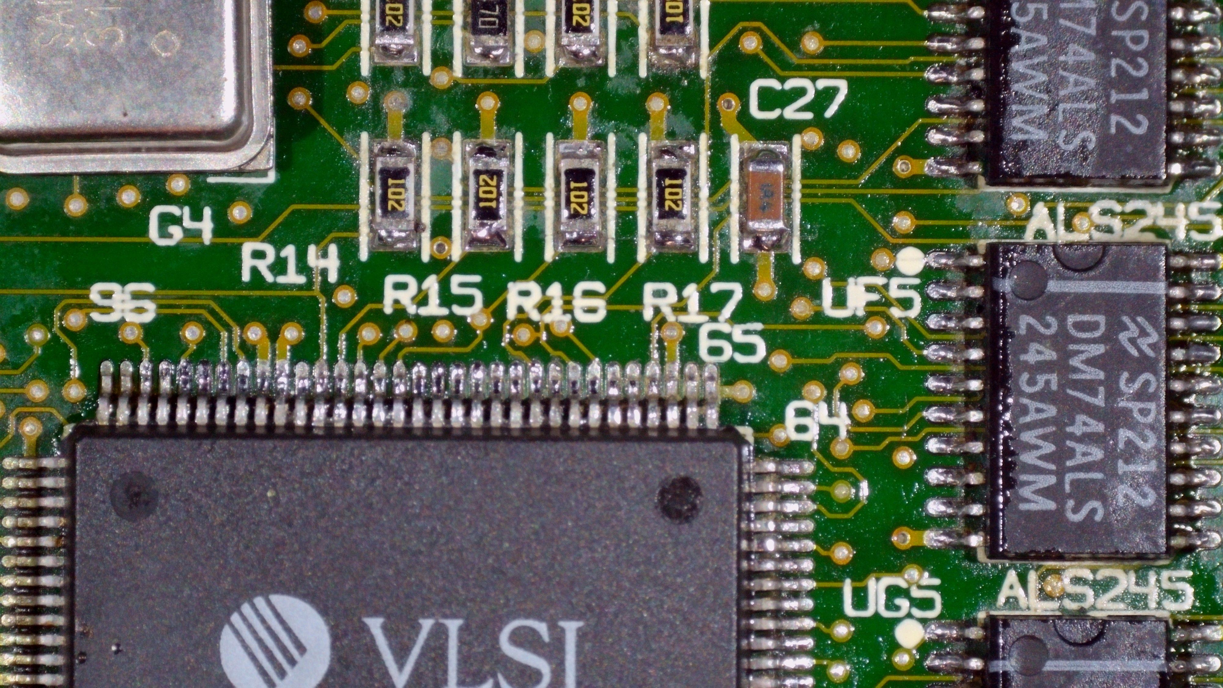

Some of the pins, especially around the Memory Decode Unit (pins 50-80) and UJ5 ROM IC looked bad. Actually, all the resistors and ICs nearby were not great. Once I hit the pins with flux and heat, I was greeted with a strong smell--not the fishy smell, but urine. This makes me think the board was suffering not from leaking electrolyte but rodent pee. This IIsi came from the same lot as a IIci that was destroyed by serving as a mouse house. While this system was dirty, it was not that dirty. So the mouse must have just passed through, and settled in the more spacious IIci.
I checked the SIMMs in my Retro Chip Test Pro, and they came back good. And after I thoroughly cleaned the MDU, ROM, and nearby components, I tested again with the original SIMMs, and everything is fine.

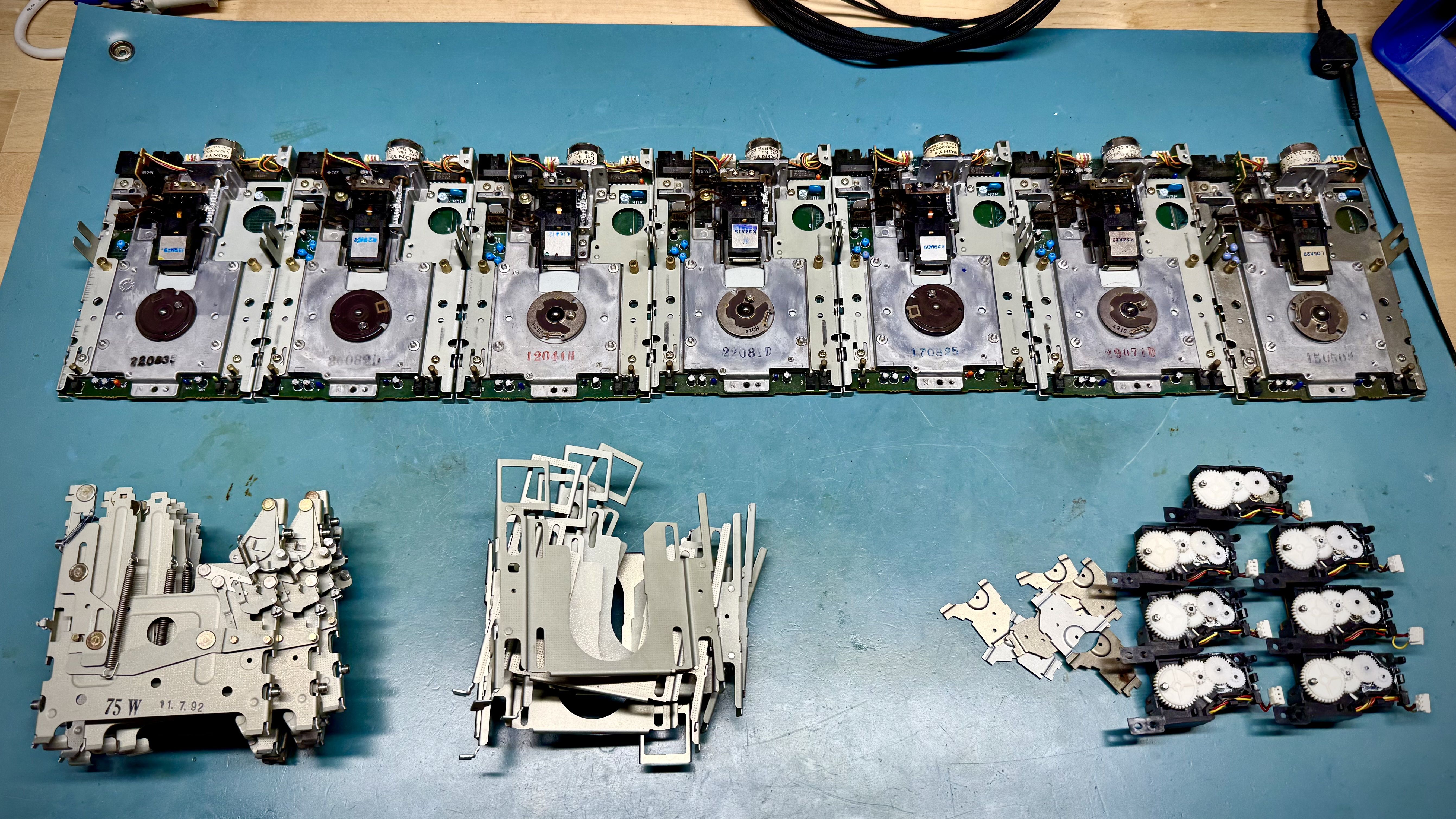

Tonight was floppy night​

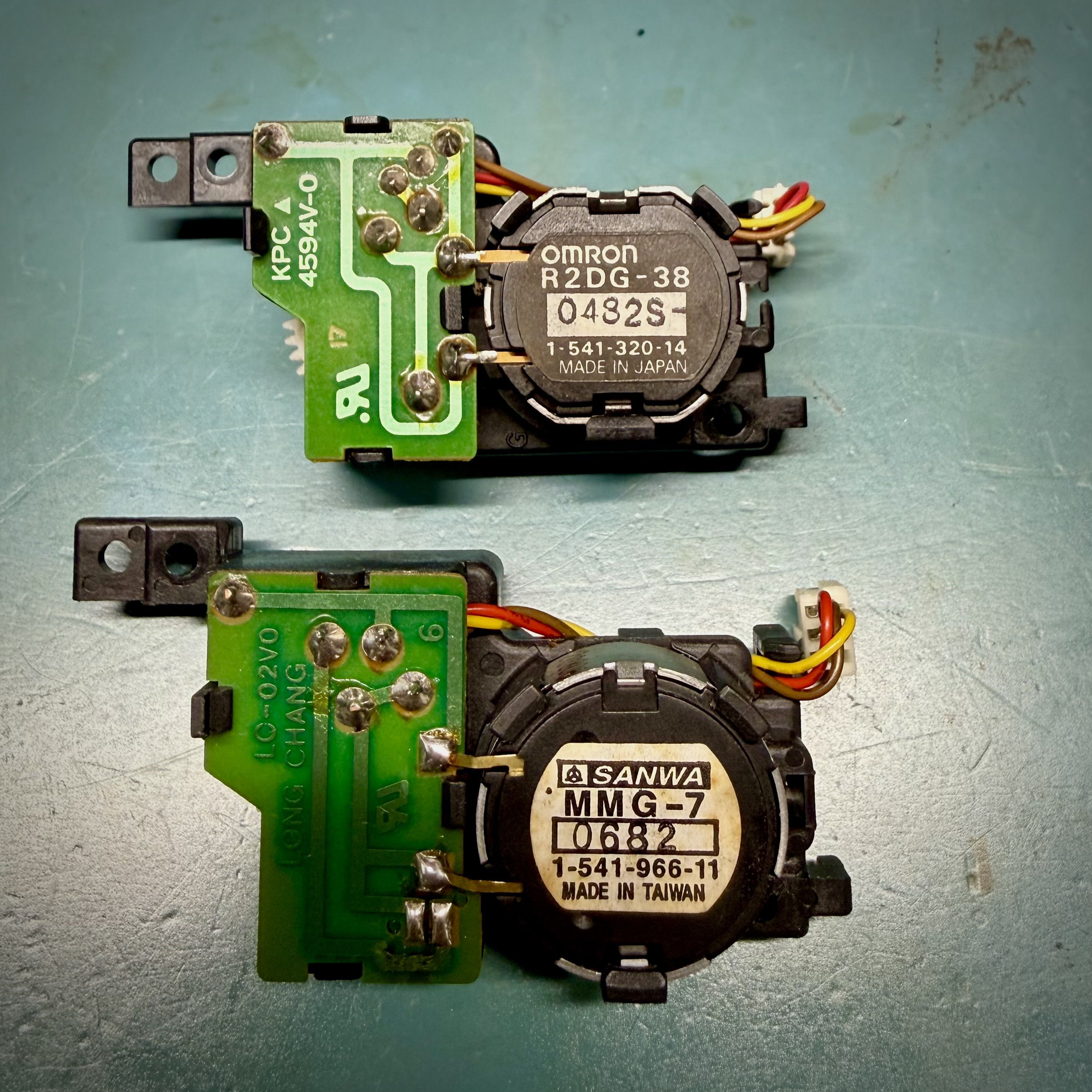

I worked on all seven floppy drives, following @Branchus excellent restoration tutorial. It was like spending an evening with the Bob Ross of vintage Mac repairs. 🙂
I nearly stumbled on the eject gears. While disassembling the eject mechanisms, I noticed that two of the seven had a different kind of metal covering the gear box and the problematic gear inside was white, not cheesy yellow. That prompted me to flip them over to see that two were made by Sanwa and the rest Omron.
In the back of my brain, something was telling me that mattered. I vaguely remembered buying two sets of gears at some point in the past. Sure enough, my past self was smart and ordered replacement gears for both the common Omron and the less common Sanwa eject mechanisms. Even though the existing Sanwa gears looked okay, I replaced them anyway since I had the parts, but I kept the original gears just in case.
In the end, four of the seven drives passed testing.
Two of the drives came from the battery bombed systems, so I knew all seven was a long shot, but I hope to get at least one more working from the parts of the three non-working drives so I have five floppies to go with my five functioning logic boards.

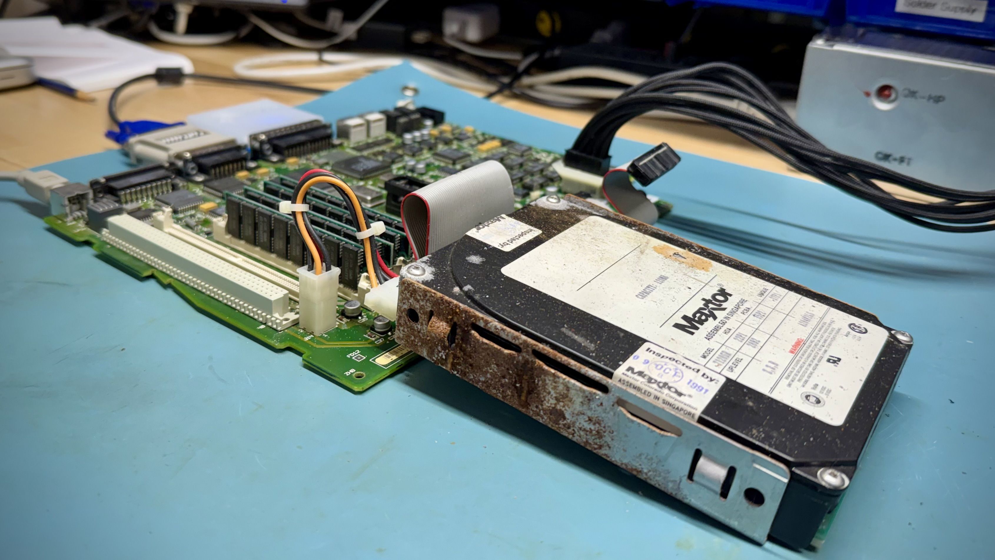

Tonight, I plugged in seven hard drives from the Mac IIsi to see if anything was salvageable.
There were three Quantum LPS drives (two of which were 80MB and one was 230MB), a Quantum ELS of unknown size, a 40MB Conner drive, a 120MB Maxtor, and finally a 200MB Maxtor drive.
In the end, one of the 80MB Quantum drives, the Maxtor 120MB, and Maxtor 200MB drives were accessible.
I attempted to access the drives by plugging them into one of the Mac IIsi, and booting from my external BlueSCSI. For the operable drives, I copied their files over to the BlueSCSI. I then created an appropriately sized HDA images using Disc Jockey and opened my BlueSCSI image in Basilisk to copy the files over to the new HDA images for archiving.
  • The Maxtor 120MB was the most interesting. This was apparently used by the news department at WUSF in the 1990s. WUSF is a public radio station broadcasting from the campus of the University of South Florida in the Tampa Bay area. Most of the files were written in WordPerfect, though oddly, WordPerfect was no longer installed on the drive. There were hundreds, maybe thousands, of news scripts from the mid to late 1990s and a few other journalism files. The shocking thing is this drive came from a battery bombed IIsi. The drive cage is rusted and the drive looks pretty bad; I never expected it to work!
  • The Quantum 80MB was moderately interesting. It looked to be from a well loved system with great applications, such as Adobe Illustrator 5.5, Photoshop 2.5, Claris CAD, and other drawing programs. There were a few games and a copy of Netscape Navigator 3.0. The bookmarks revealed that the user was likely Japanese and enjoyed mid '90s chat rooms. All the personal files had been removed.
  • The Maxtor 200MB was boring. It was a wiped drive with an install of System 7.5.

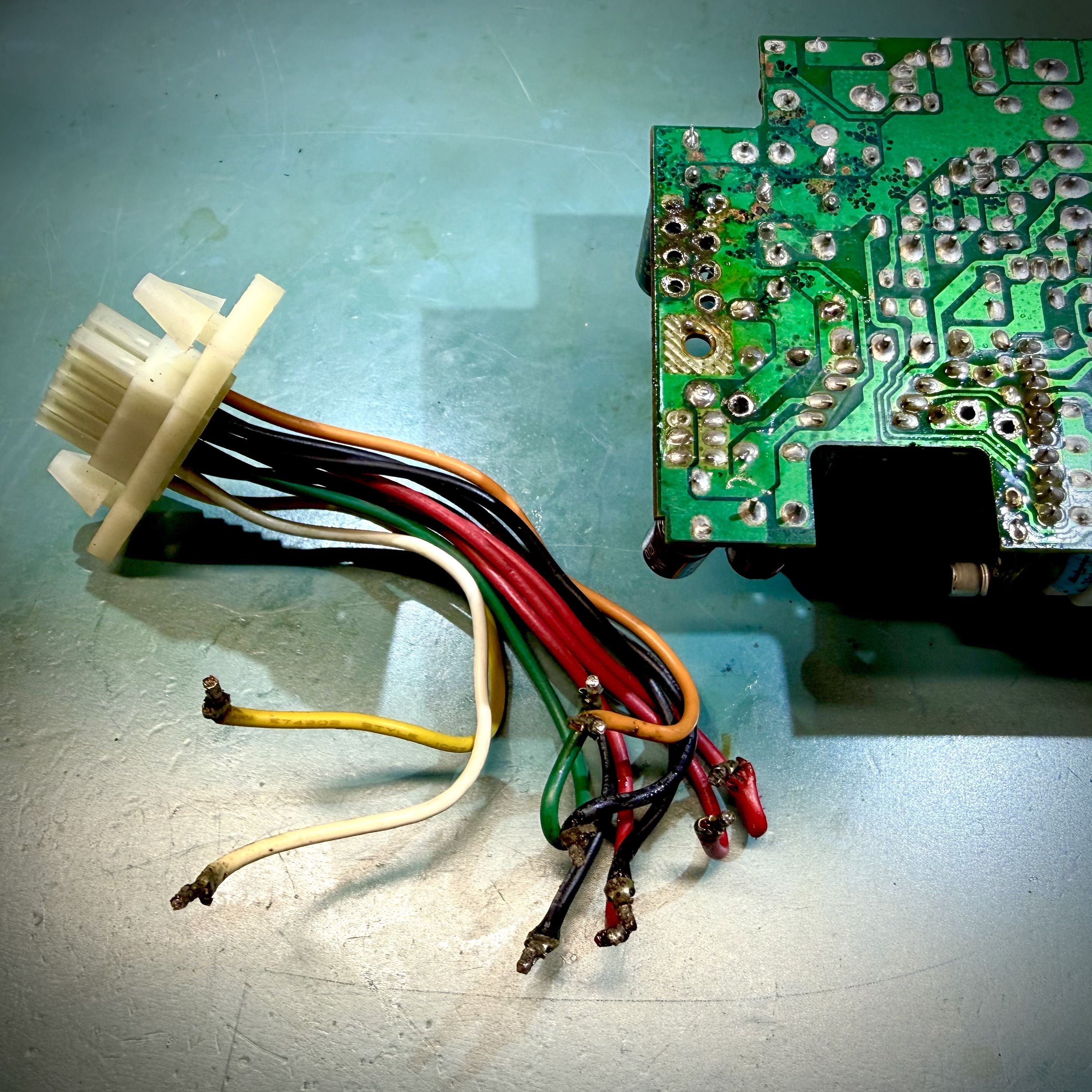

So, I downloaded the gerbers and accompanying files for JLCPCB to make the boards and place the tiny R1, R2, and D1 on the board before they shipped it to me. I then ordered the AC/DC converter, PicoATX, 2N4401 transistor, 24-pin ATX connector, along with the standoffs, nuts, and screws. There is really not much to it.

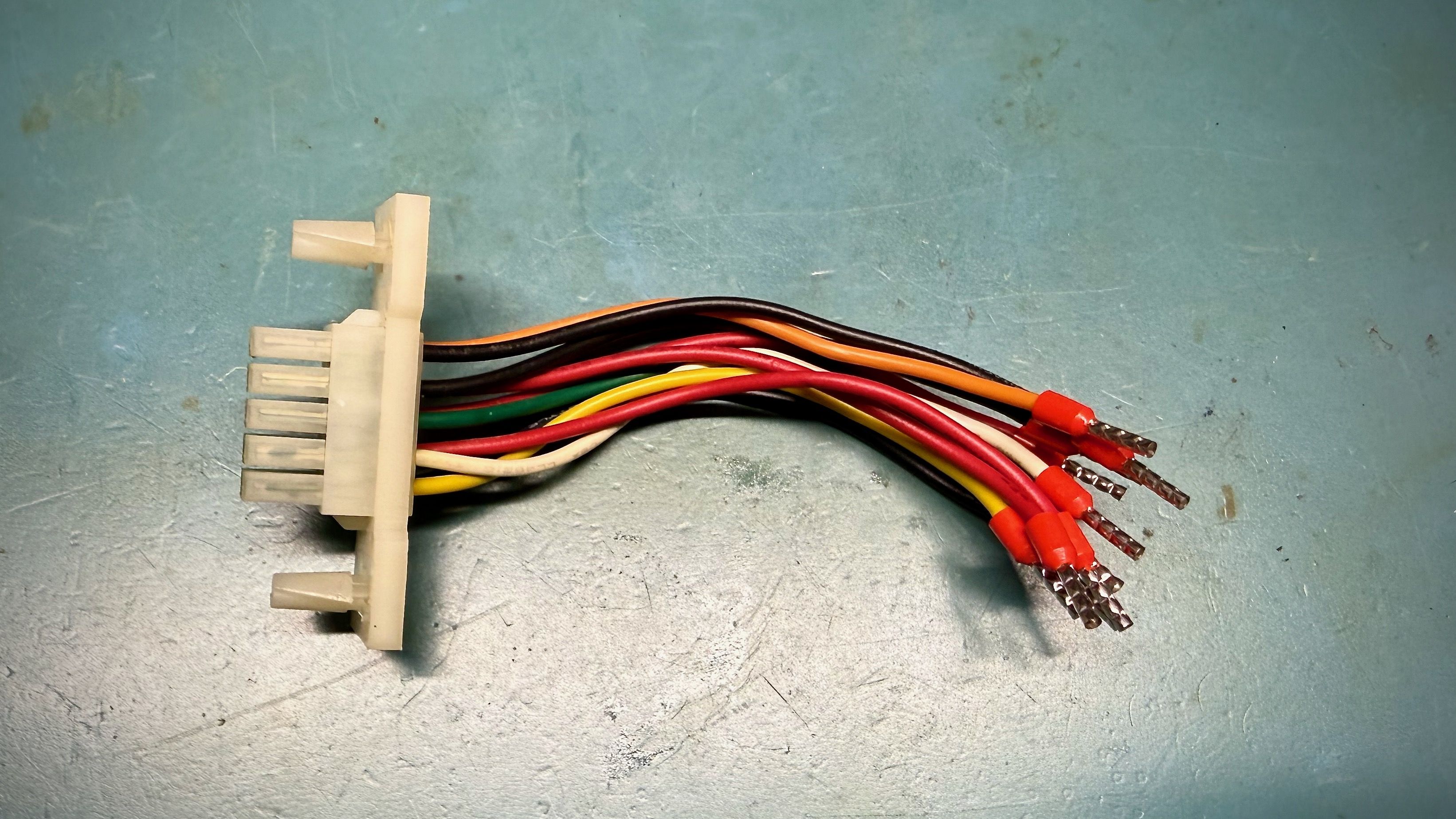

You need to harvest the power connector from an existing IIsi PSU. This proved to be challenging due to the corrosion on the pins, combined with the beefy metal caps placed on the ends of the wires. After some a good amount of flux and heat, they loosed up enough to push out of the old PCB.
I then considered how to connect the new old wires to the new PCB. I realized that some of wire caps I painstaking removed from the old board were disgusting from corrosion and unless I got every last bit of solder off of them, they would not fit in the new PCB. So I ended up cutting them off and crimping new 18AWG ferrule connectors to each end. (Therefore, I could have just cut the wires off at the top of the old end caps and avoided the desoldering hassle.)
Now, this is where I made a dumb mistake. For no other reason than I can be dull-witted, I crimped the plastic sheath end of the ferrule connector, not the metal end. While that held the connector onto the cable, it did not form a good bond. Thought it took me awhile to figure out my mistake.
Not aware of this problem yet, I continued with the build and easily soldered on the connector and transistor, and I mounted the AC/DC converter on its standoffs. One wrinkle was the PicoATX I purchased had its input power wires on the wrong side. So, I desolder the black and red wires power input wires and switched them onto the other side. I then cut the barrel connector and crimped on 20WG ferrule ends (also incorrectly). I then set about soldering the old connector onto the new PCB. It was more fiddly than I would have liked, but it worked.

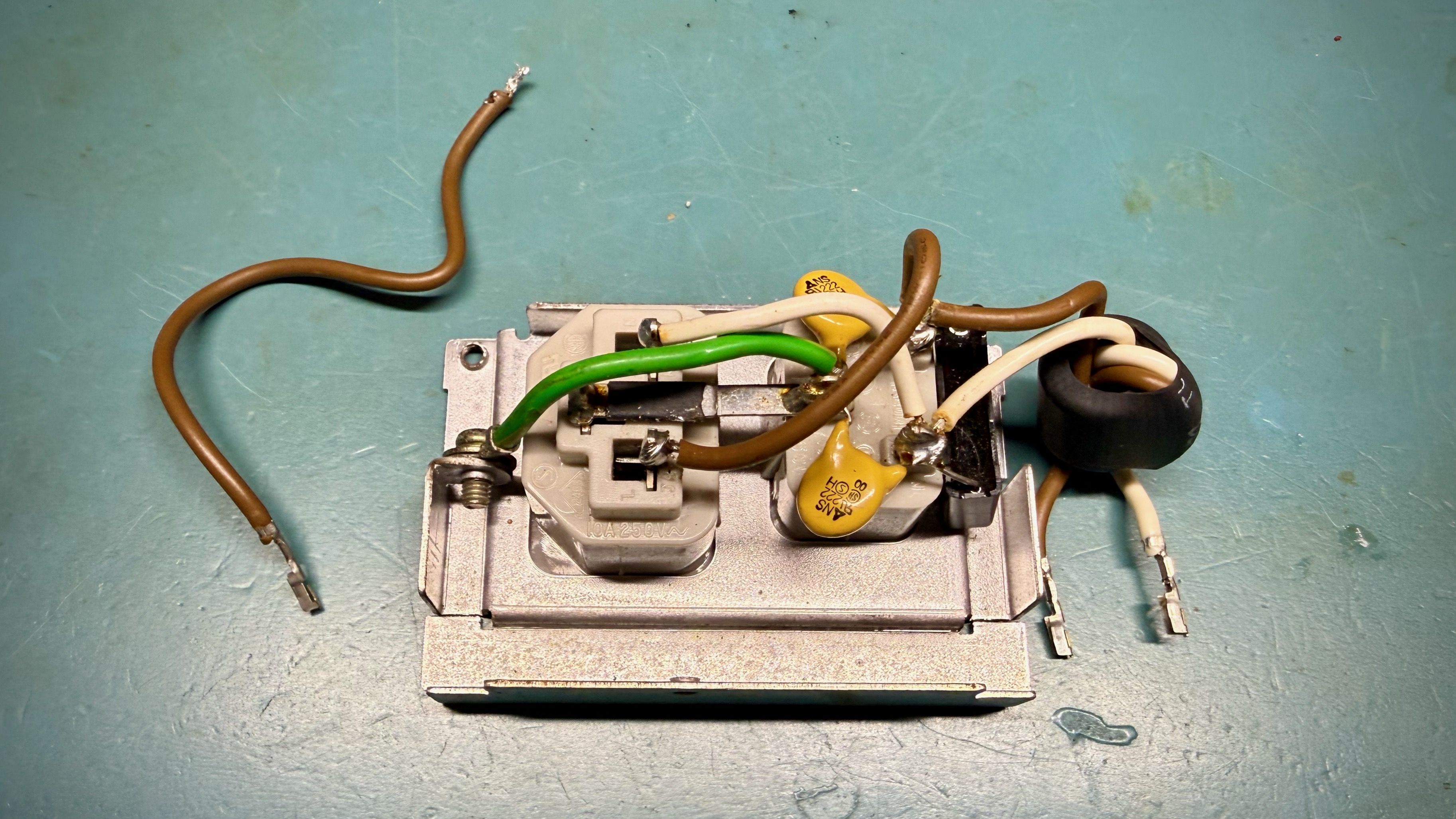

I then rewired the AC input so the output plug was tied directly to the input plug since the new PCB lacks the ability to switch power on for the output jack when the computer powers up. I then de-pinned the leads going to the AC input so I could cut it and insert the ends directly into the AC/DC converter.
I eagerly put it back in the IIsi's original metal PSU enclosure and hit the power switch... and nothing happened.
Curiously, the same thing happened to both Colin and Bruce in their videos. And for both, the problem was the transistor (foreshadowing).
I started poking around and the white wire just fell out of its ferruled end! This is important, because the white wire carries the signal that tells to PSU to turn on. Then I realized my dumb mistake, and had to desolder the connector from the PCB and cut off the incorrectly attached ends from each of the wires. I then reinstalled the ferrule ends correctly, I also did the same with the wires going from the PicoATX to the AC/DC converter.

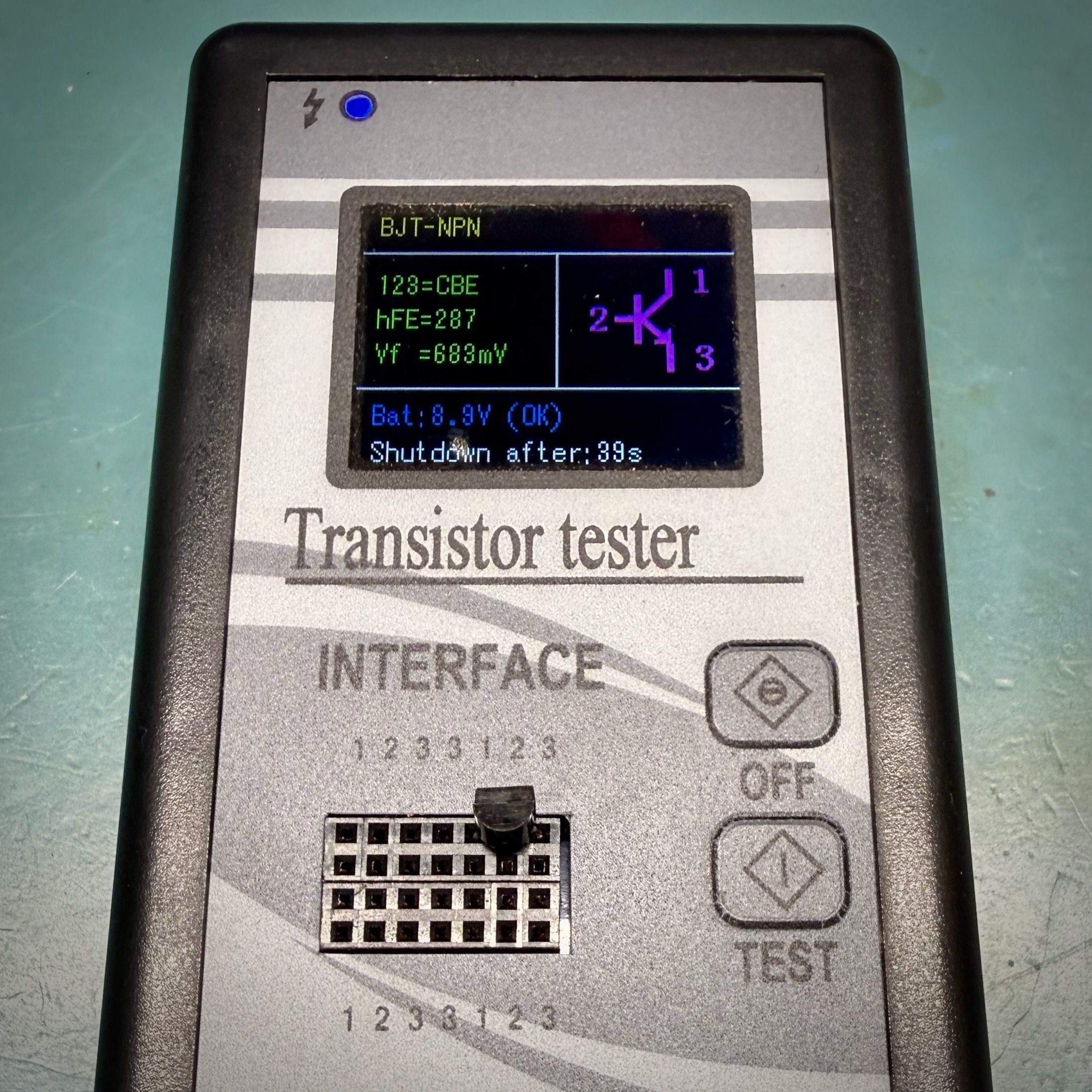

So, since the transistor was a problem for both Colin and Bruce, I turned to give it attention. Colin may have originally had a different transistor on his, but Bruce had a 2N4401 installed, which tested good, but swapped it for another he had in his stash, and everything worked.
I ordered plenty from Mouser for this project. So I pulled out another and got the same result. Nothing.
I then broke out the oscilloscope. What I saw was a steady 5V coming through for standby power, and the power on signal on the PicoATX was around 4.6V. When I press the power switch on the IIsi, the signal dips down to 4.3V for second or two, then moves back to 4.6V. It should be dropping down to ground for that second or two, not dipping slightly.
As I understand it, the Macintosh keeps the power on signal low until startup, and then it pulls it high. ATX power supplies expect the opposite. They expect the signal to go low on start up. The transistor at Q1 serves as an inverter, converting the Mac's signaling to something the PicoATX can handle. In my case, it doesn't seem to be pulling it low enough.
I checked the signal coming in from the Mac IIsi connector and running to R2. As expected, the signal is low until I press the switch, then it moves to 3.7V for a second. On the other side of R2, it knocks that momentary signal down to 0.5V. That signal makes it to base of Q1, but on the leg connected to the PicoATX, which runs at 4.6V, it only dips down 4.3V, as previously mentioned.
I checked R2, and realized another possible mistake. Caymac's parts list says that R2 should be a 10K resistor, but when I look up the assigned part number listed in the BOM on JLCPCB's parts library, I'm told that is a 15K resistor. So, it was possible R2 was knocking down the signal beyond what would trigger 2N4401 transistor.
However, before I went too far down that rabbit trail, I fired up ChatGPT for assistance. It had me checking the base, emitter, and collector legs of Q1. It was saying the emitter should be grounded, but my 2N4401 had the collector grounded. I uploaded the datasheet from for the transistors I bought from Mouser, and ChatGPT was very insistent that I had the transistor installed backwards.
I decided to give it a try, and it worked! The transistors I bought must be wired opposite of the one Caymac used when preparing the silkscreen.

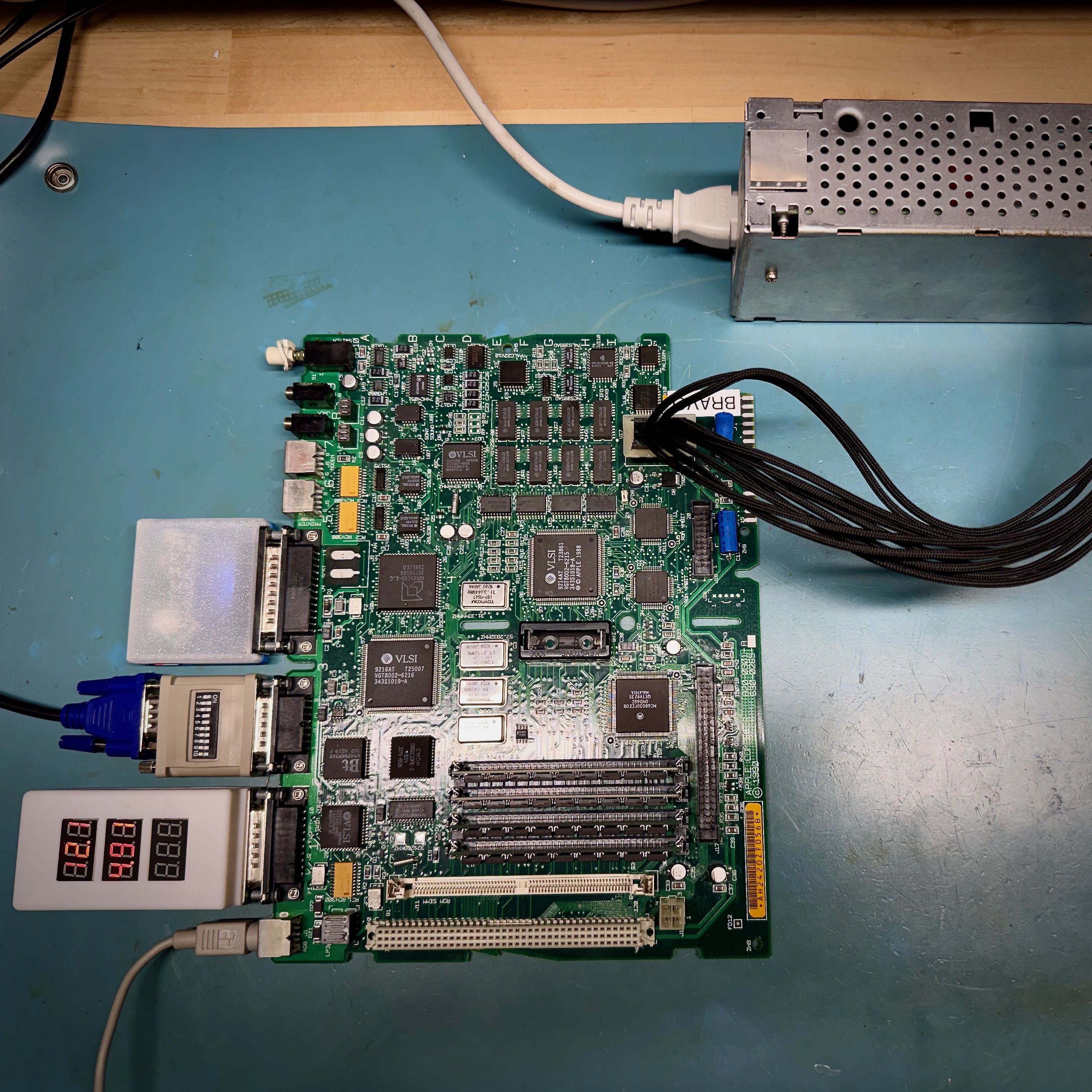

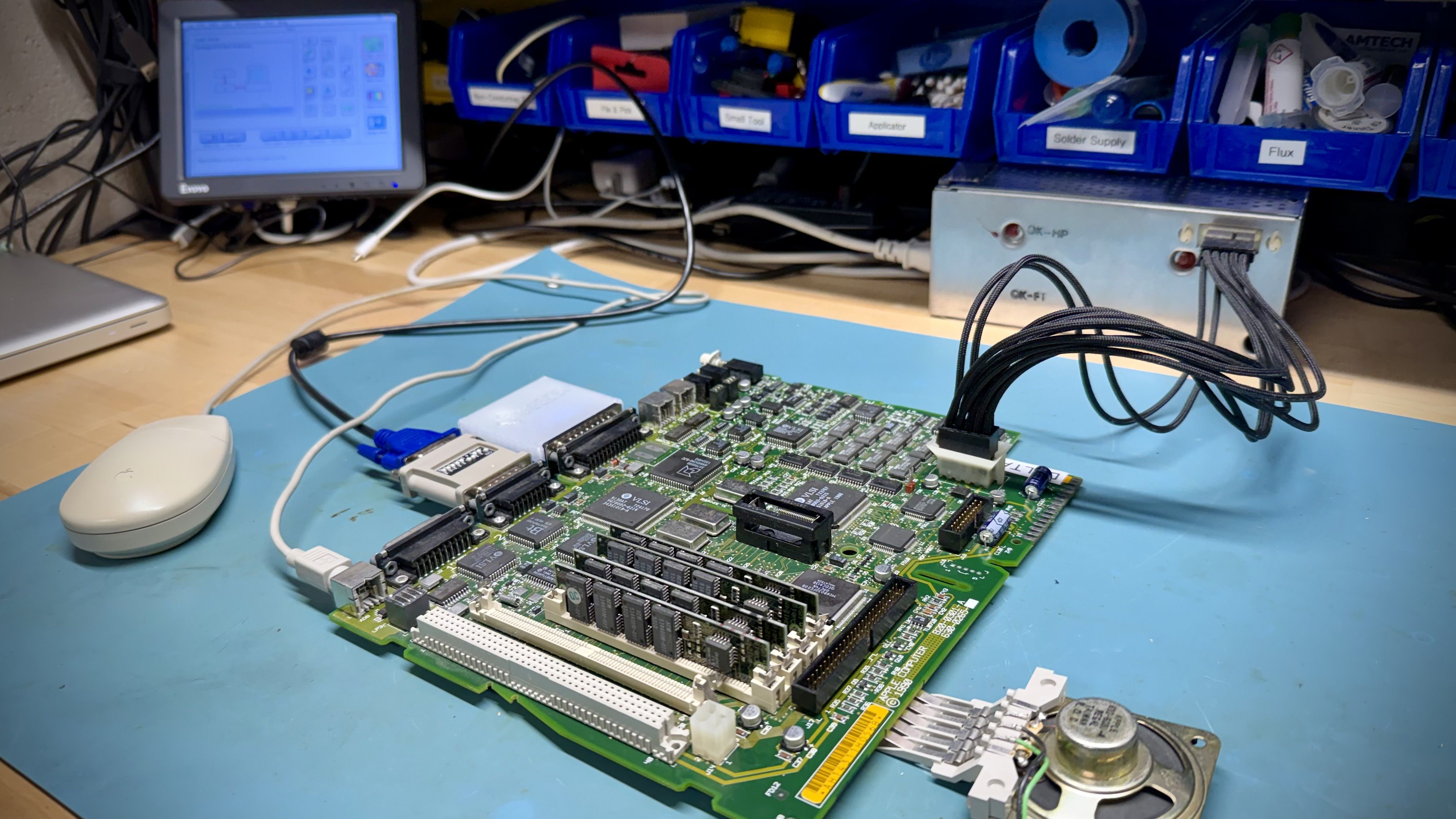

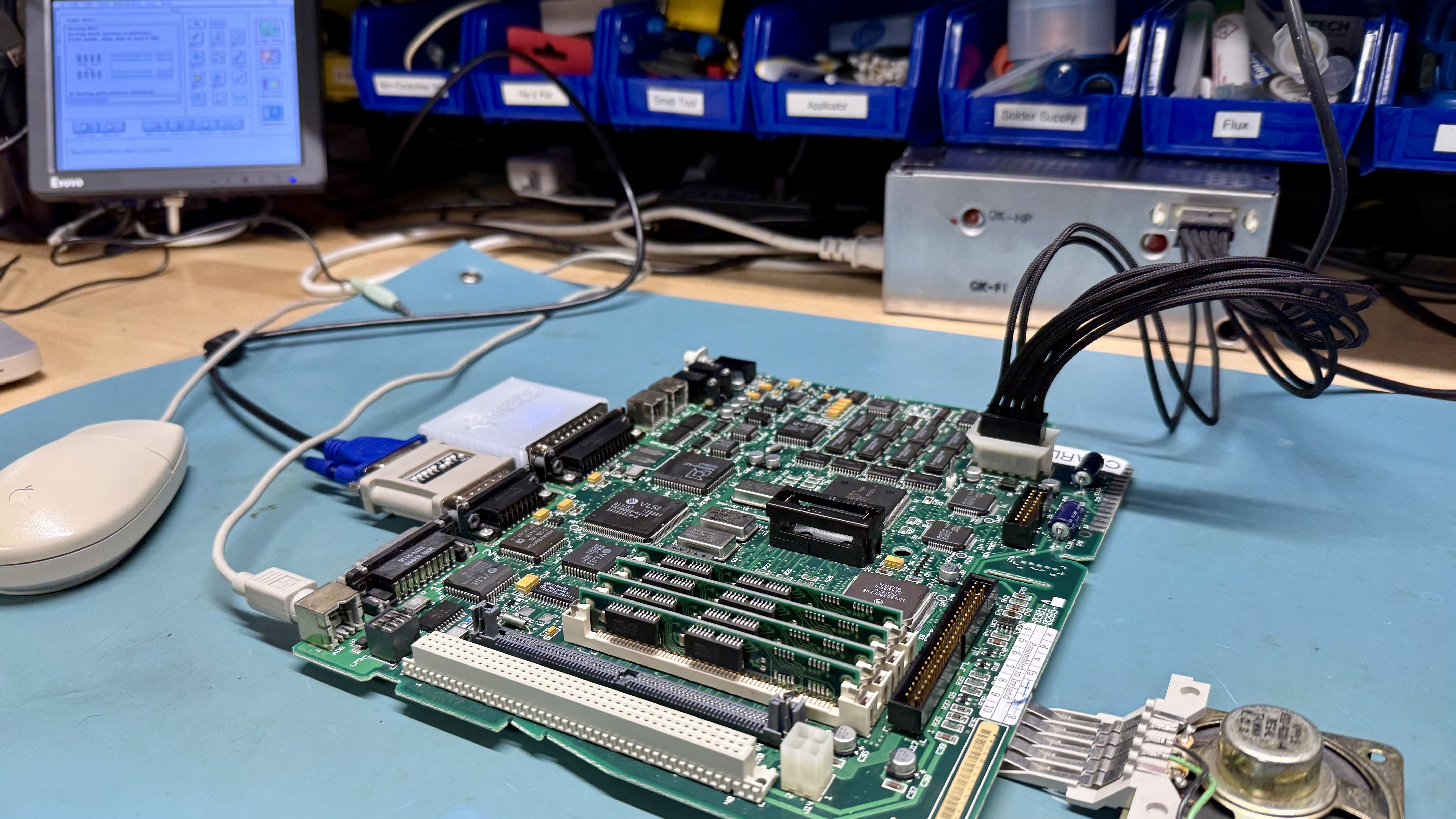

I tested each of the five functional boards with my snazzy TechStep built by @max1zzz. It confirmed that Delta and Echo are working perfectly. Charlie tested fine, but it would not shut down with the new Power-Up-IIusi PSU (it works properly with the Magnetek PSU) . It was the only system with that problem, though I think one other restarted instead of shut down once, but then shutdown. The Alpha system also tested fine, but I know the speaker is distorted due to something I did when testing the audio circuit.
The TechStep reported that Bravo failed the serial test and had low amplification with the audio. The audio did not surprise me, but the serial failure was new. The combination of problems with serial communication and audio likely means I should check the -12V rails.
Aside from that, I need to try to get one additional floppy drive working, clean the cases, and obviously build four more replacemnet PSUs.

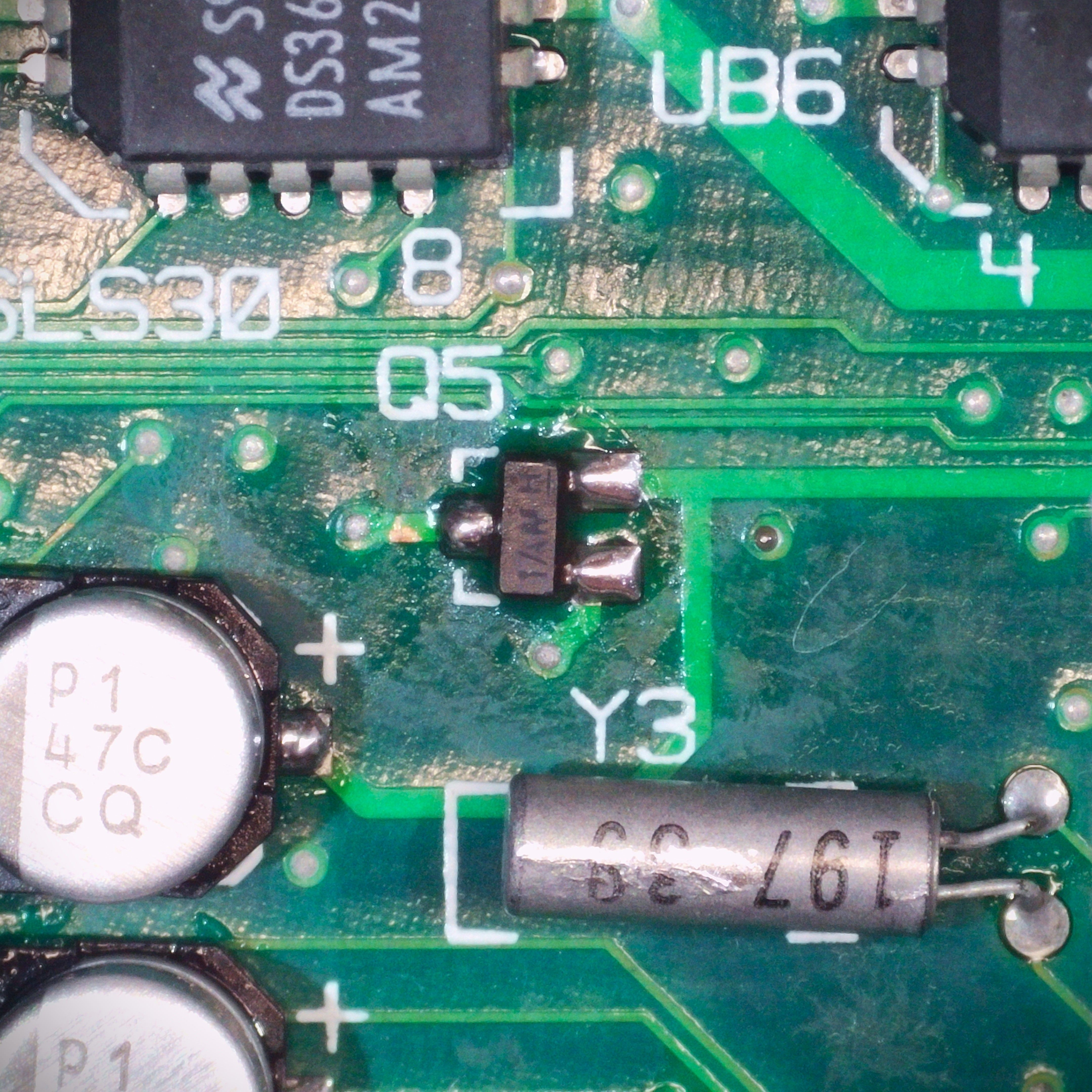

Bravo finally has a voice. I went back to consider the odd oscilloscope readings I saw earlier, and I started at the beginning with the power going into the Sony sound ICs. Both were getting 4V. At first I wasn't sure what voltage they should be receiving, but I knew 4V seemed off. I grabbed one of the working logic boards and saw that pins 12 and 13 on the Sony ICs should be getting 11V. So I followed the circuit back until I got to Q5, a transistor that was fed with 12V. I eventually removed Q5 and found the 4V was still on the circuit. I assume the voltage was either phantom power back feeding through the IC or coming from some other source.
I replaced Q5 with a MMBT3906 which should do the job. However, I got the same result. The transistors were too small to fit in my component tester, so I fiddled around for awhile. Eventually, out of desperation, I questioned whether the orientation of my MMBT3906 did not have base, emitter, and collector on the right pins. Luckily, I was able to scavenge a replacement transistor from the battery-bombed Foxtrot, and all is well. The replacement transistor provided the Sony ICs with 11.4V, and the audio circuit finally started producing clear sounds. However, the speaker still didn't work.
I probed the speaker's amplification circuit near the bottom of the board and got inconsistent results. At one point, I could faintly hear sounds from the speaker if I put my ear against it. Then, all the sounds stopped. I eventually figured out that pins 6 and 7 on the TL071 at UK3 were not making good contact with their pads. While they didn't look terrible, clearly enough corrosion had gotten in them to be a problem.
I attacked them with flux and heat, and it took quite awhile to get them to take fresh solder. Just as I was about to give up and remove the chip, the solder started to flow. Now, with pin 7 solidly connected to +12V and pin 6 providing consistent output, I was finally blessed with a beautiful bong when I started it up. I suspect the reason I was getting very low volume from the speaker for a bit was because pin 6 was connecting for the moment, but pin 7 was not, so the chip was missing 12V for amplification.
