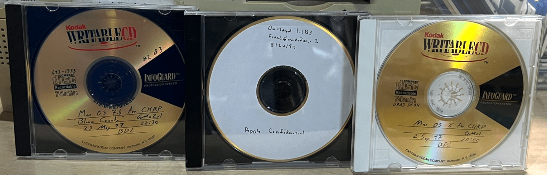

Some info about these three CDs:
  • Mac OS 7.6 is dated May 23, 1997.
    • It includes a System Enabler 356 for CHRP systems, it does not have a Mac OS ROM in the System Folder.
    • The Read Me file mentions CHRP and some compatibility notes to be aware of, etc.
    • The label on the disc says "#2 of 3" and mentions "SCSI", perhaps IDE drives were unsupported on this disc.
  • The disc "Outland"1.1B3 (Mac OS 8) is dated August 20, 1997.
    • It includes a Mac OS ROM in the System Folder.

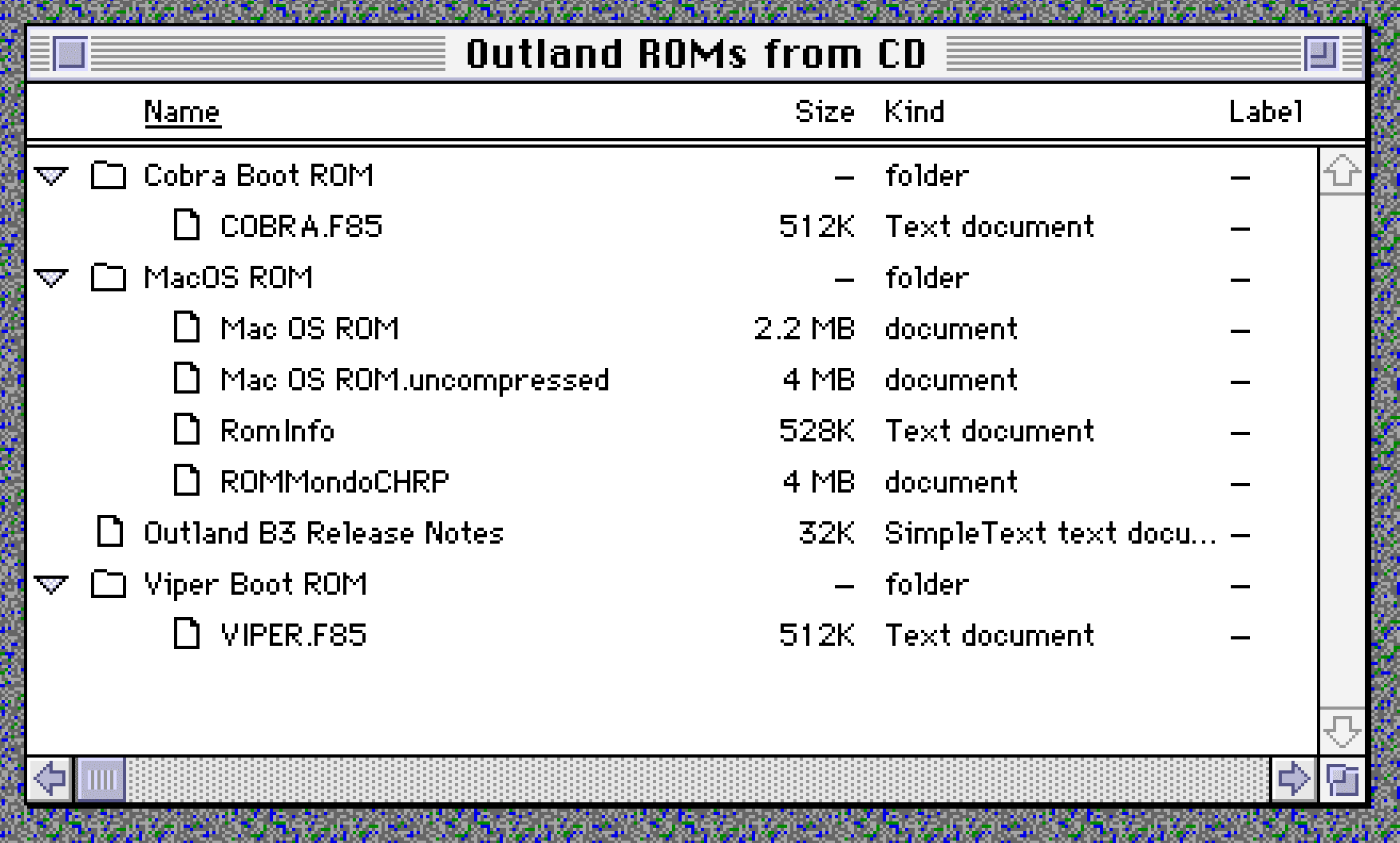

    • The "CHRP Extras" folder contains various drivers, a notable Release Notes doc (attached to this post for easy exploration), Motorola Cobra & Viper ROMs, a "MondoCHRP" ROM and other utilities.
  • Mac OS 8 for CHRP is dated September 2, 1997.
    • Has a Mac OS Licensing extension, a Read Me, and a Tech Note PDF about modifying the name and graphics used in the "About this Computer" window.

The Outland disc has some interesting ROMs on it, especially for the pre-release Motorola CHRP systems:

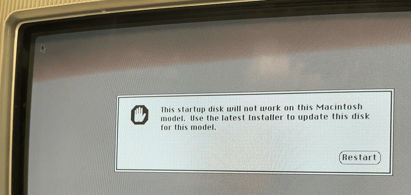

I was curious to see if System 7.6 would boot on a beige G3 (as the lowest supported Mac OS is 8.1), but it gives me an error that the OS isn't compatible. However, some clever folks on the MLA posted success booting via an emulator (set as an iMac G3) and an iMac G3 (Rev C).

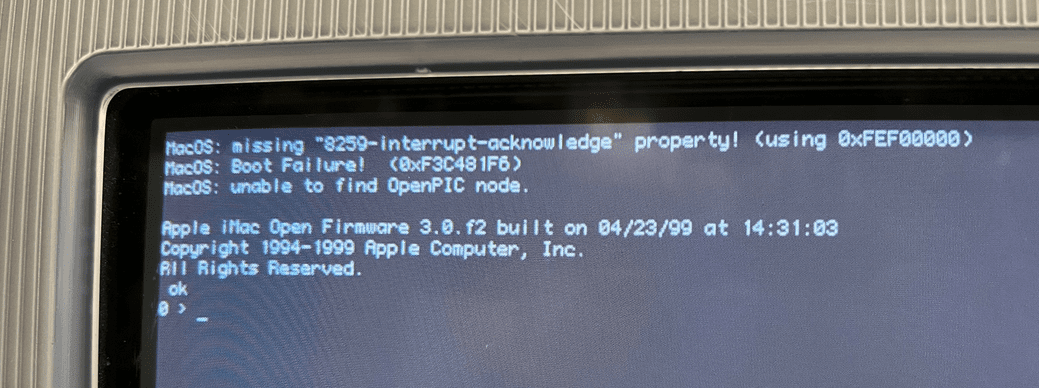

Sadly with my iMac (Rev A), I don't get as far. If I copy over a pre-installed 7.6 CHRP HD/System Folder to the iMac's HD (using a SATA/IDE + SSD), and copy a Mac OS ROM (from the iMac 8.1 restore CD, ROM version 1.6 - or an 8.1 installed system folder, ROM v1.1), I get the classic "This startup disk won't work with your computer. Perhaps it's my hardware configuration.
Rairri (via Mastodon) clued me in that the hard drive must be Mac OS Standard / HFS (not HFS+) but that didn't seem to make a difference on my side. Maybe it's to do with my SSD/SATA adapter. On my set up only the 1st partition of the hard drive is bootable. Although Mac OS 8.1 happily boots from an HFS disk using this set up on the iMac.
Either Mac OS 8 CHRP discs fail to boot on the iMac G3, with an error, no doubt related to the hardware it expects.

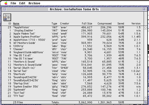

Often the System Folders on installer CDs are crippled so they don't work from hard disks. Have you tried just installing it, and making sure the system enabler is in there? Perhaps try adding an iMac age appropriate 'Mac OS ROM' to the system folder for open firmware to find.

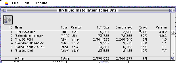

Out of curiosity I had a look in the CHRP install tome on the latest 8.0 CD. This is the contents :
Hear is a similar Tome from the Mac OS 7.6 CD :

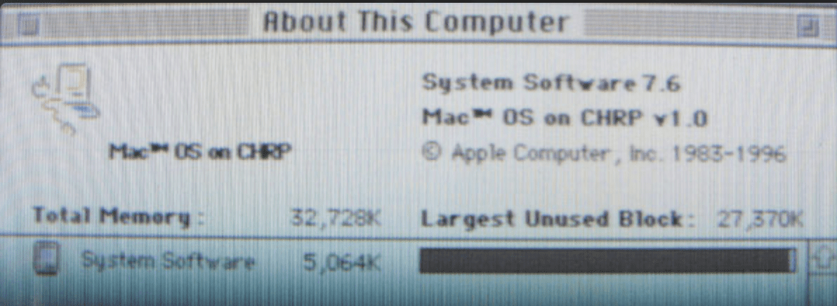

Well, this is old hat now, given the CHRP enablers have been out for at least a week, but I managed nevertheless to get it booted on a Firewire PowerBook G3 (AKA Pismo). It's kind of weird, but the core OS seems to work stably enough (7.6's version of Open Transport seems to be broken, though, as it kept triggering an unimplemented trap. I wonder if either installing a newer version or copying the extensions from 8.1 or newer would work?) I also applied the HFS+ patches, so I can access the Mac OS 9/X partition.
I'm going to try this on my Tangerine iBook next, and then from there, who knows.

Also, I found some old 2007 photos of a StarMax prototype that shows a screenshot of "Mac OS on CHRP" here:
I'd love to hear if others have tried on other macs ie. PowerBook G3 Wallstreet or Tibook/AluBooks G4s etc
