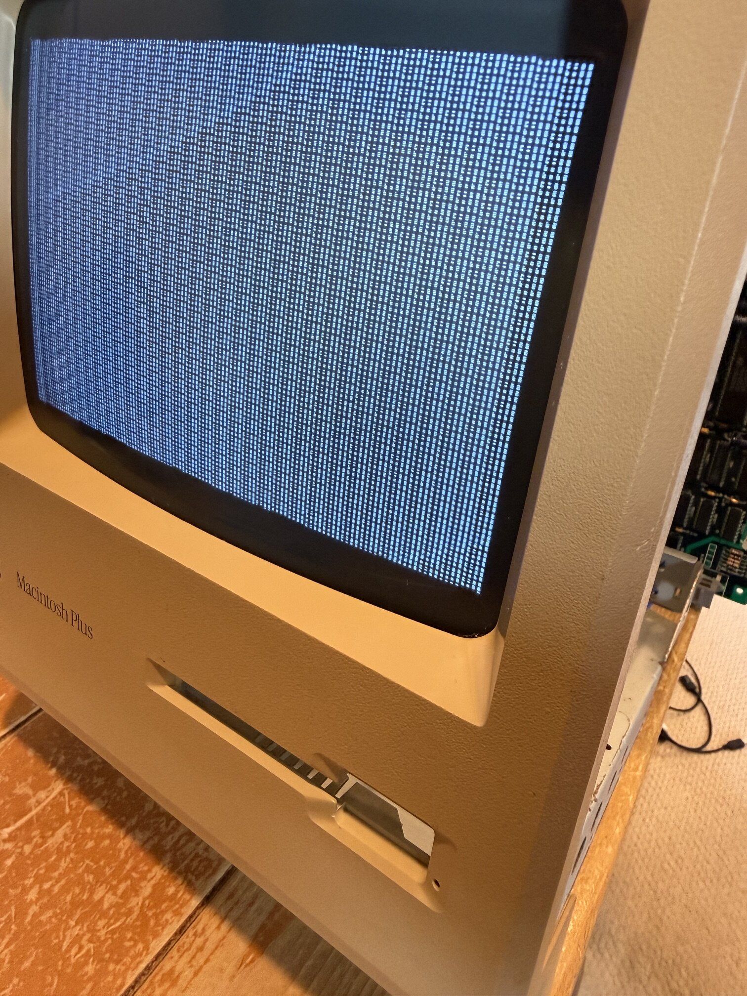

Hi all — long post, but I think it's worth the detail since I haven't found anyone documenting quite this deep on this specific symptom. Looking for ideas on where to go next, and hoping the methodology here is useful to someone else down the line too.
The board and the symptom​
820-0174-A Mac Plus logic board. Connected to a known-good analog board. On power-up:
  • No startup bong
  • Display shows a stable, structured, pulsating pattern of vertical lines — not random noise, not a checkerboard, no Sad Mac
  • HSYNC and VSYNC both present and correct on the scope
  • Symptom is completely unaffected by RAM configuration — tested 4×256K, 2×1MB, 4×1MB, and 2.5MB (1MB+256K) configurations. Zero change in the video pattern in any case, including with RAM fully removed.
Reasoning from that last point: since the display never even attempts a RAM-test checkerboard pattern, the CPU appears to never get far enough into ROM code to reach that stage. That points to something upstream of RAM entirely — most likely the CPU never successfully completing a valid bus cycle.

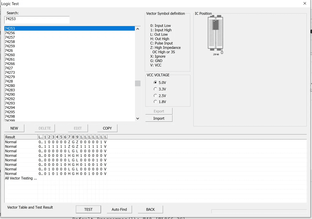

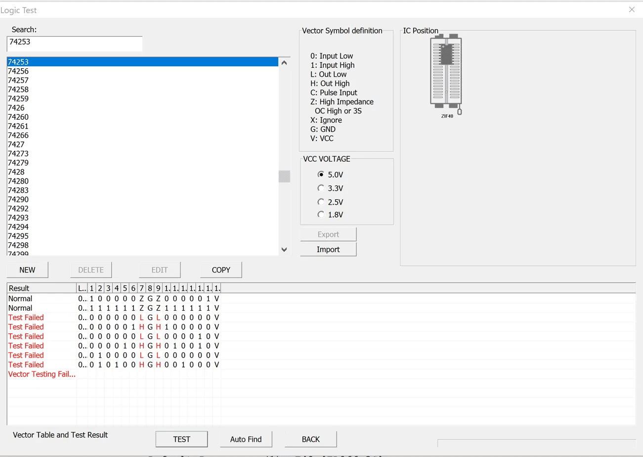

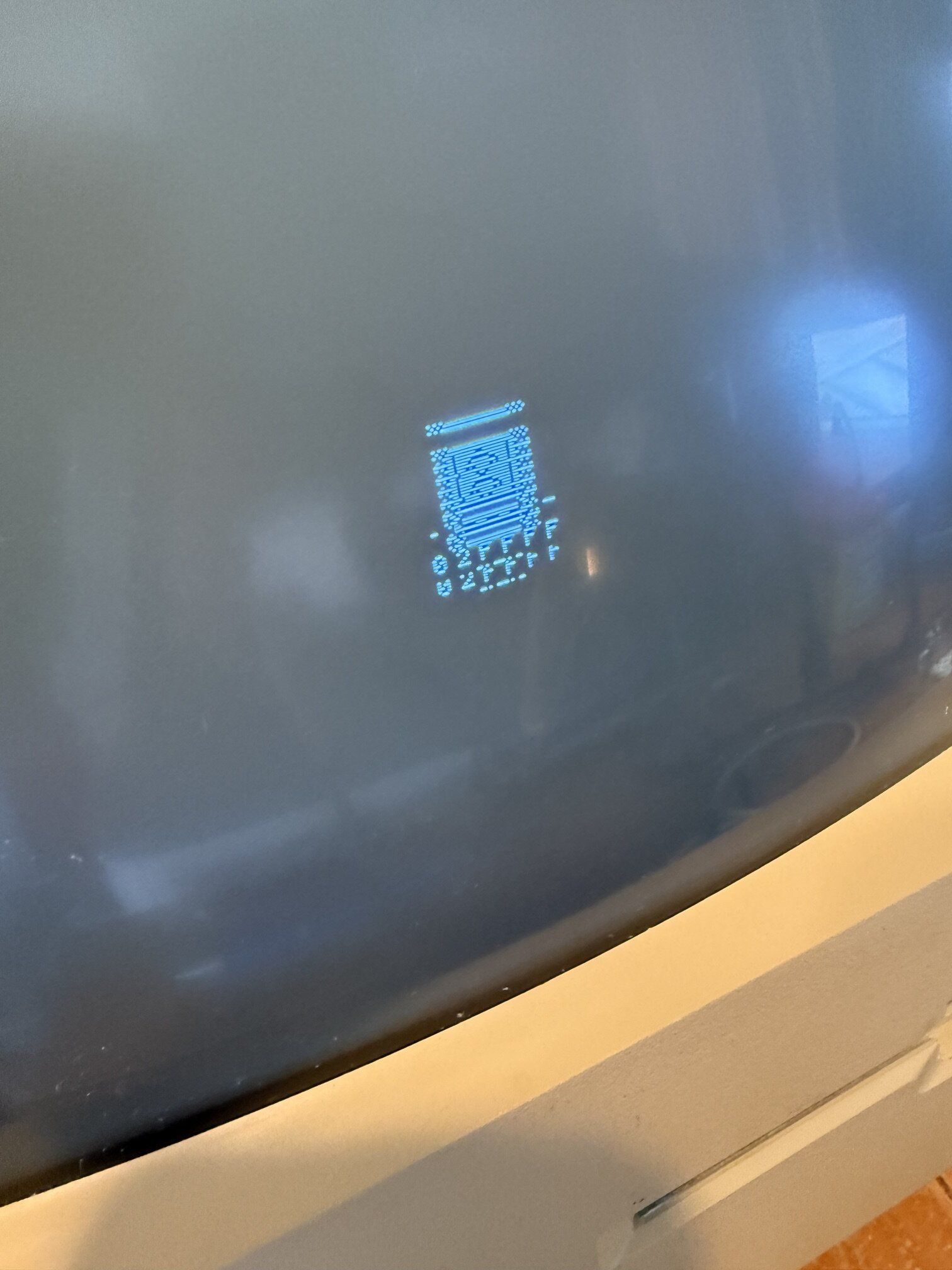

Update: Mac Plus 820-0174-A — pulsating vertical lines, no bong
Located and replaced a faulty 74F253 mux (confirmed via DMM — polarity-dependent leak — and corroborated on a T48). Replaced all four 74F253s as a set, along with all nearby 0.1µF (C104) decoupling capacitors.
Condition improved: the pulsating vertical-line garbage is gone. Now getting a Sad Mac with code 02FFFF — no chime yet.
Per the standard decode table, Class 02 = RAM bus subtest, sub-code FFFF = all 16 RAM positions failing simultaneously, which points to a shared address/control line rather than an individual RAM chip.

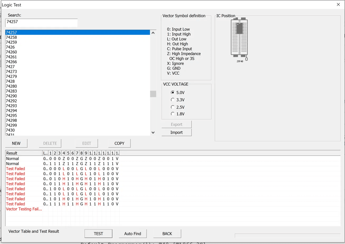

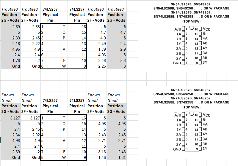

I continue to struggle to clear the 02FFFF error. I've replaced all four 74F253s. I also pulled the 74LS257 at U2F — it tested clean on the T48 with no errors — but swapped in a new one anyway as a precaution. No change to the symptom. There's no smoking gun yet. I've begun checking traces and haven't found any problems so far.
Below are voltages at each pin location on the two 74LS257s (positions 2F and 2G) for the troubled board (no bong, shows 02FFFF and a ghosted Sad Mac icon) versus a known-good Plus board that bongs and fully boots. Worth noting the known-good board is fully running while the troubled board is halted at Sad Mac, so some of this may reflect that state difference rather than a hardware fault — flagging that so it doesn't mislead anyone.
Additional ideas welcomed.
Thanks,
litriSE

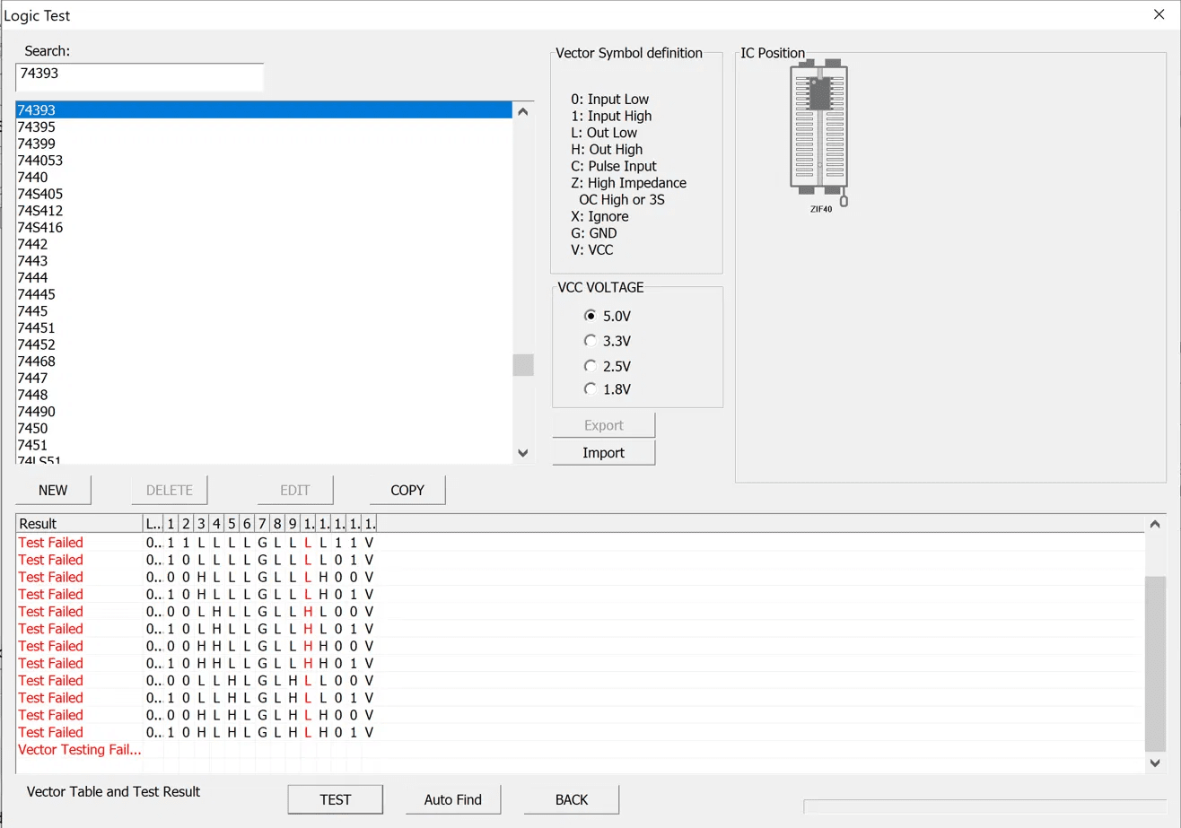

I pull the last three remaining chips in the jellybean section - 74LS257 U2G, 74LS393 U1F, 74LS393 U1G. The 74LS257 in U2G was bad and the 74LS393 in U1G was bad. All the chips in the jellybean section have been replaced with tested known good.
I still get the 02FFFF error, sad mac, and no chime.
I will continue to work through the traces, but I have not found any thing at this point. All continuity checks.
