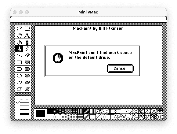

Hey guys. I am trying to get Mac Paint to run off of the Rominator I I installed on my Mac Plus. 1.0 complained that it didn't have enough memory. I decided to try MacPaint 1.3. That seems to launch but I get the message "MacPaint can't ind work space on the deault drive". Not sure what this means. Is the problem that there isn't enough space on the ROM drive or that it's not writable? Any work arounds? I guess I can run it off my floppy emu but I really wanted it to load with the Rominator.

I think it's because in normal cases, you shouldn't be able to write to the ROM on the Macintosh, and the ROM drive in the ROMinator is mapped to ROM space, and thus, it can't be written to. I suggest using a floppy emu or a SCSI drive to run MacPaint on, but do not attempt to save to the ROMinator
Confirmed, Mac paint requires the ability to make scratch files on the disk it launched from. The Rominator rom disk basically acts like a locked disk. preventing any writes to it. To test this out I put a mac paint disk image in mini vmac that was locked.
