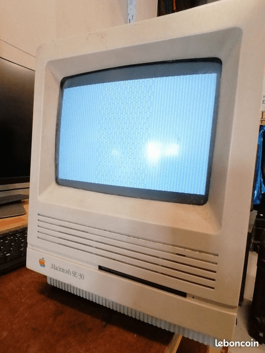

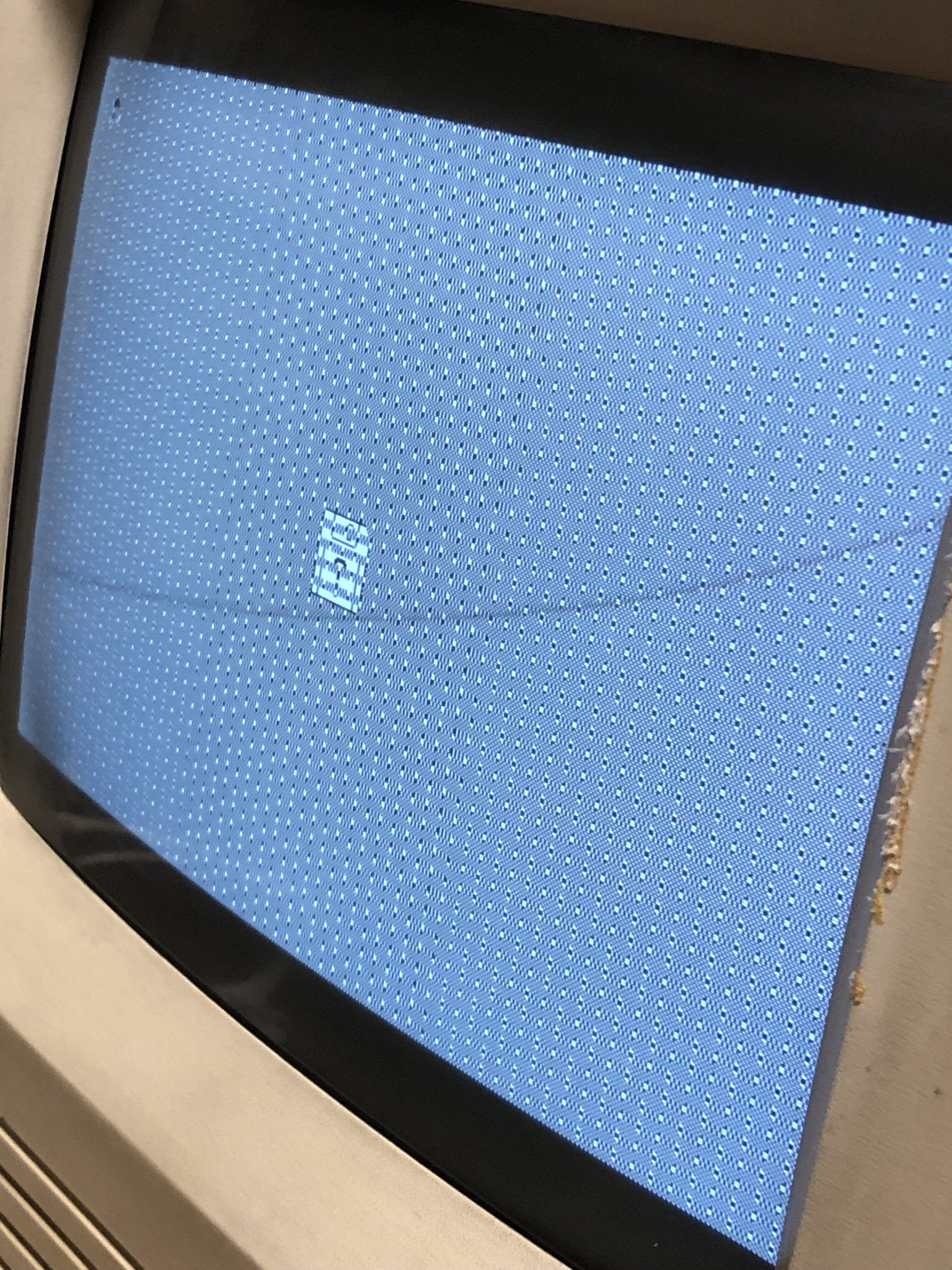

I've just get a Macintosh SE/30 with a CRT problem, hoping it can be fixed.
Is there a dedicated resource, blog, Youtube, that could help fix such a problem ?
This is the problem (image).

Your CRT seems fine, this seems to be a problem known as "Simasimac" (Google for it). Sometimes is related to the RAM, so my first try would be to remove all the SIMMs and test it with known working RAM. If not, just install what you have again, maybe trying to fill only one bank of memory.
But it can also (quite likely) mean that your logic board needs recapping.
Good luck!
Pedro
@pat665 -I second the recapping. In my experience, that-unfortunately- is usually the problem, or part of it anyways. But recapping the board will give you some great experience with a soldering iron!
lots of people on this board have xp with soldering. and youtube videos to show you how. So you are in the right place! welcome to the board!
Be sure to post back with updates and questions. Would love to see that computer working.
Also have a look at your ROM SIMM. sometimes it needs to be reseated or pressured to make contact properly. 100% SE/30s need to be recapped but sometimes no ROM can show this.

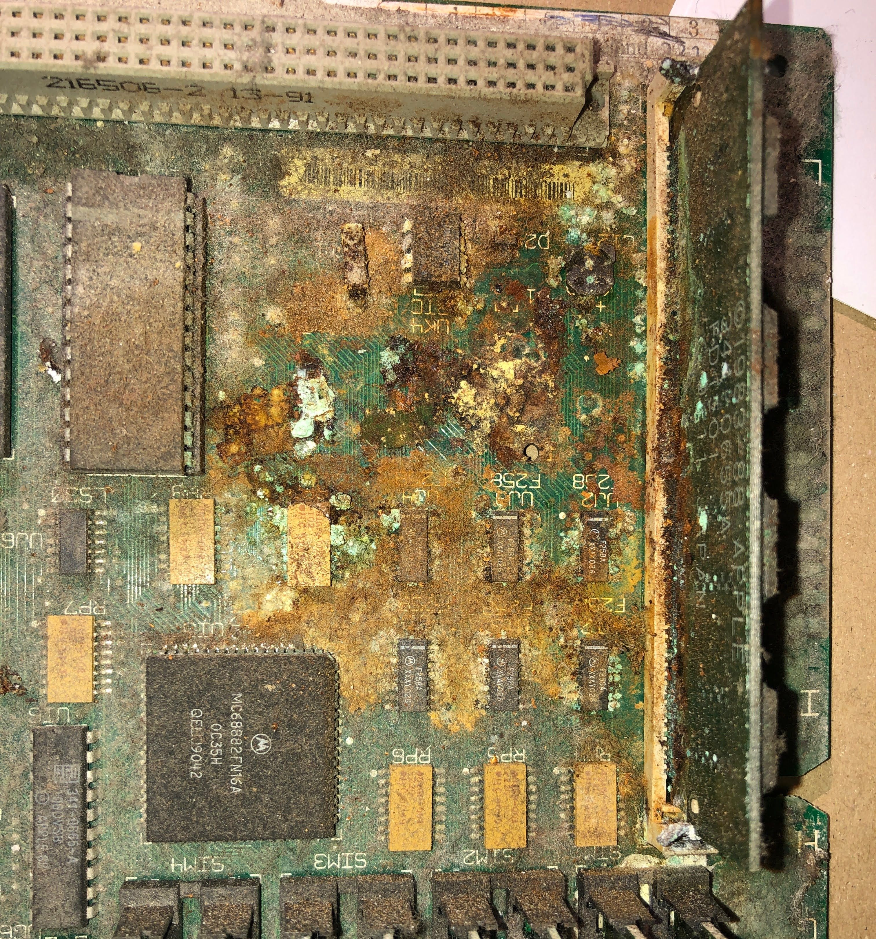

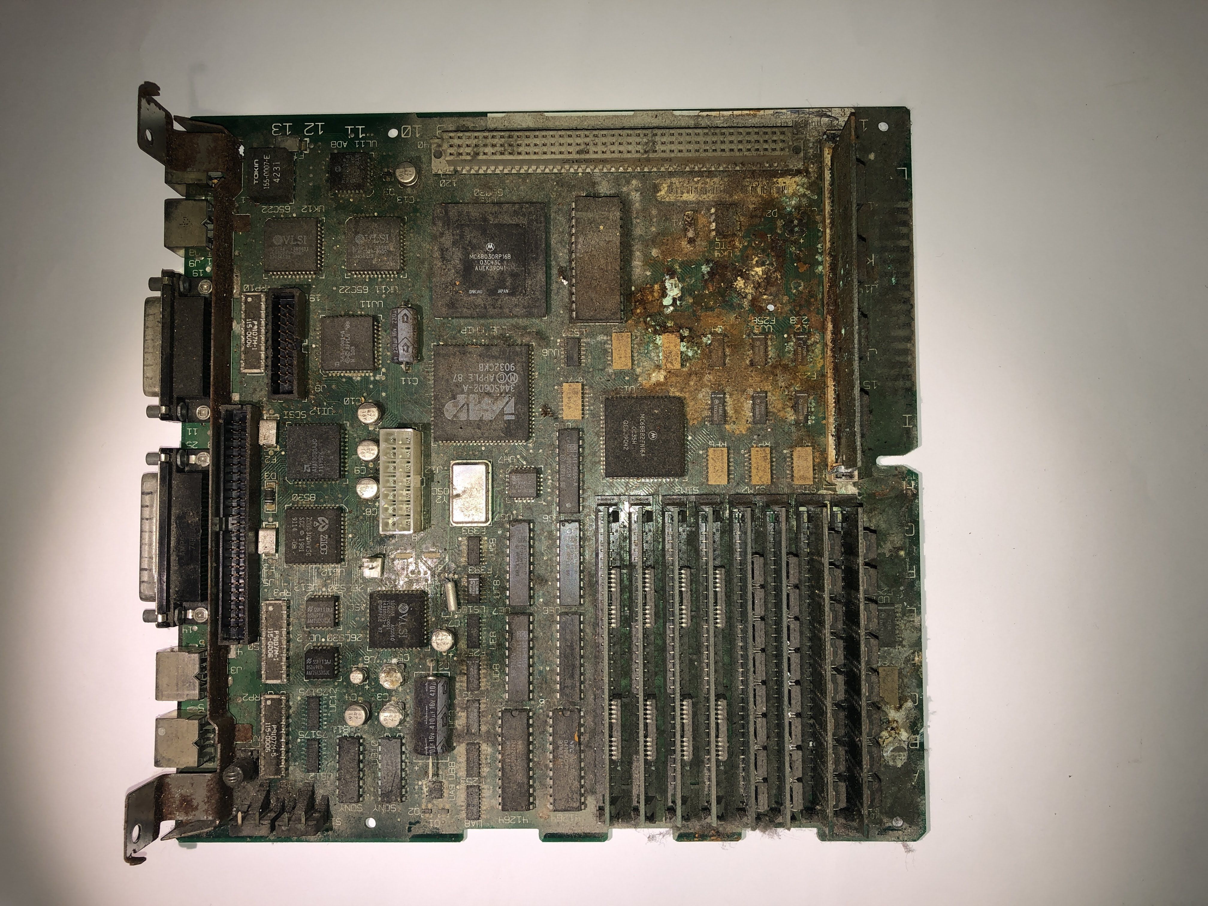

The beast has been opened and fixing it will be more than a recap. The battery leaked and corroded many things.
This part seems very very bad.
I don't think I have the skills to repair it.
At this point, my priority would be to stop the corrosion, cleaning the motherboard to prevent further damages. Eventually I will come back to it when I will have more free time.
Any advice on that ?
Merci à tous pour vos conseils
Patrick
Ouch. My opinion, a repair attempt on that is not going to end well. The capacitor damage alone looks bad, without even looking at the battery nightmare. Unless you are looking for an intense personal challenge, I'd lift the proprietary chips for use on other repairs or perhaps on a recreation board.

I also think you have a good enough board to migrate the working parts. Try and clean it up as best you can, the RTC looks like it might be saveable.
Ugg, looks like your board had the dreaded Maxell battery explosion! Like others have said the first thing to do is give the board a good cleaning. For something like this, I would use denatured alcohol (available at any hardware store) and a toothbrush.
Then check your traces. As long as they are intact (or only a few of them are damaged) you should be able to repair the board, although it will be a slow process! Looks like you'll be doing a recap and replacing some chips.

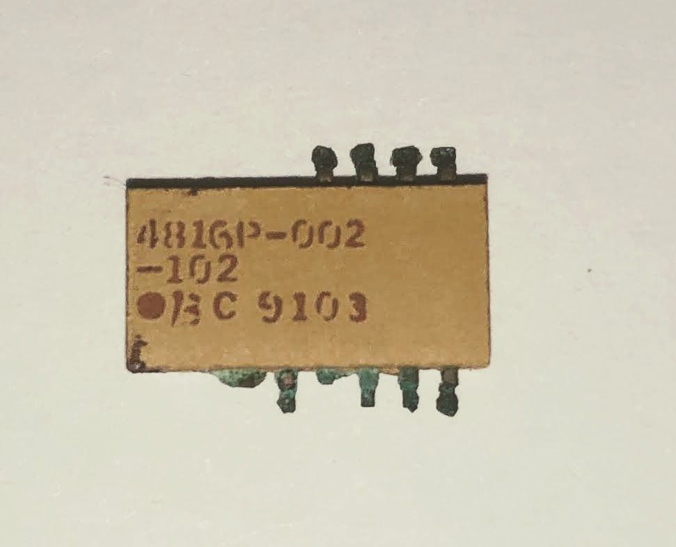

I had finally some free time to clean the board as best as I could. I've used WD40 to deal with the rust, then soap and brush and a couple of hours in vinegar. During the process this little piece detached. I don't know its purpose and if it's replaceable.
There are still some spots of rust covering the traces. They resists the brushing. I'm looking for a way to dissolve them. I'm afraid any mechanical attempt to remove them will damage the traces. Same with the RAM bank.

Ooof. That's a lot of damage, it might take a lot to patch that, especially the via damage by UJ3 - you might find it easier to migrate the parts to a new Bolle SE/30 board.
The part that fell off is a 200ohm Resistor network, iirc used for pullups. The rom simm socket is, to my eye, too damaged to salvage. However, you can still get these.
You'll need at least some 74F258's as well.
I recommend if you want to patch it, ultrasonic cleaning is about the only way forwards, but I'd still give it a scrub with a toothbrush and some more vinegar.
