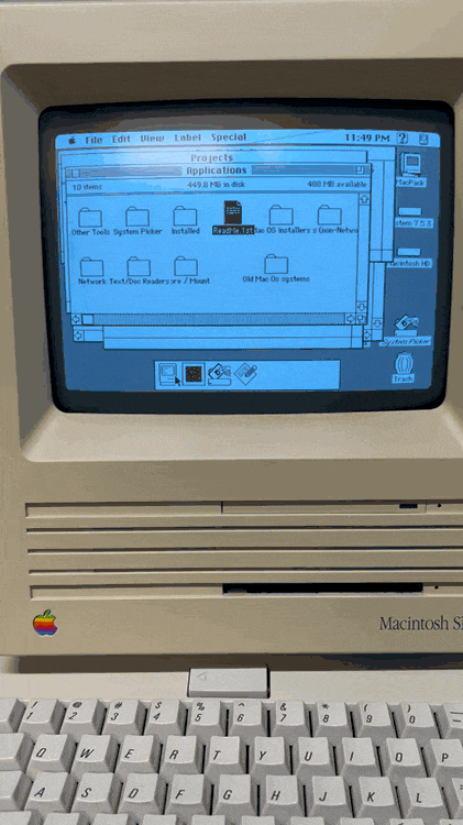

Currently this is what it looks like (the gif is latest and includes blinking, the movie didn't have the blinking but is higher quality).

Ok got this done! ((recored with mouse click indicators)). I used the Inside Macintosh sectino in ToolBox Essentials that explained it all pretty well and aligned with your recollection.
