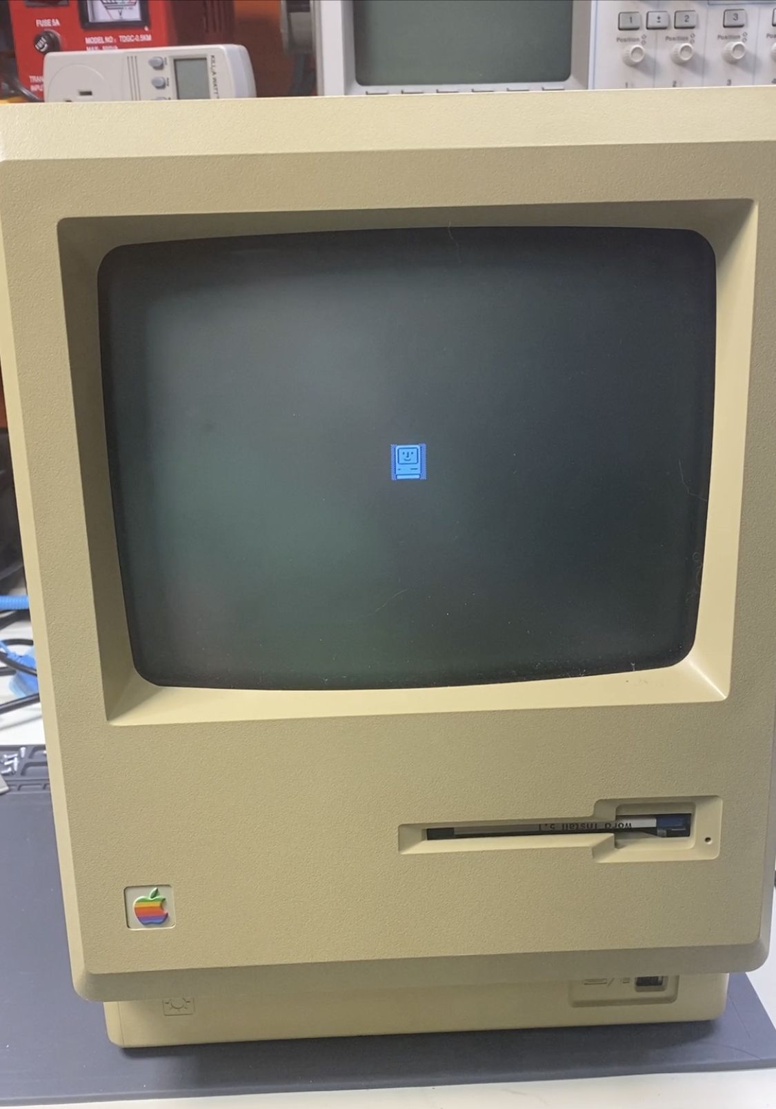

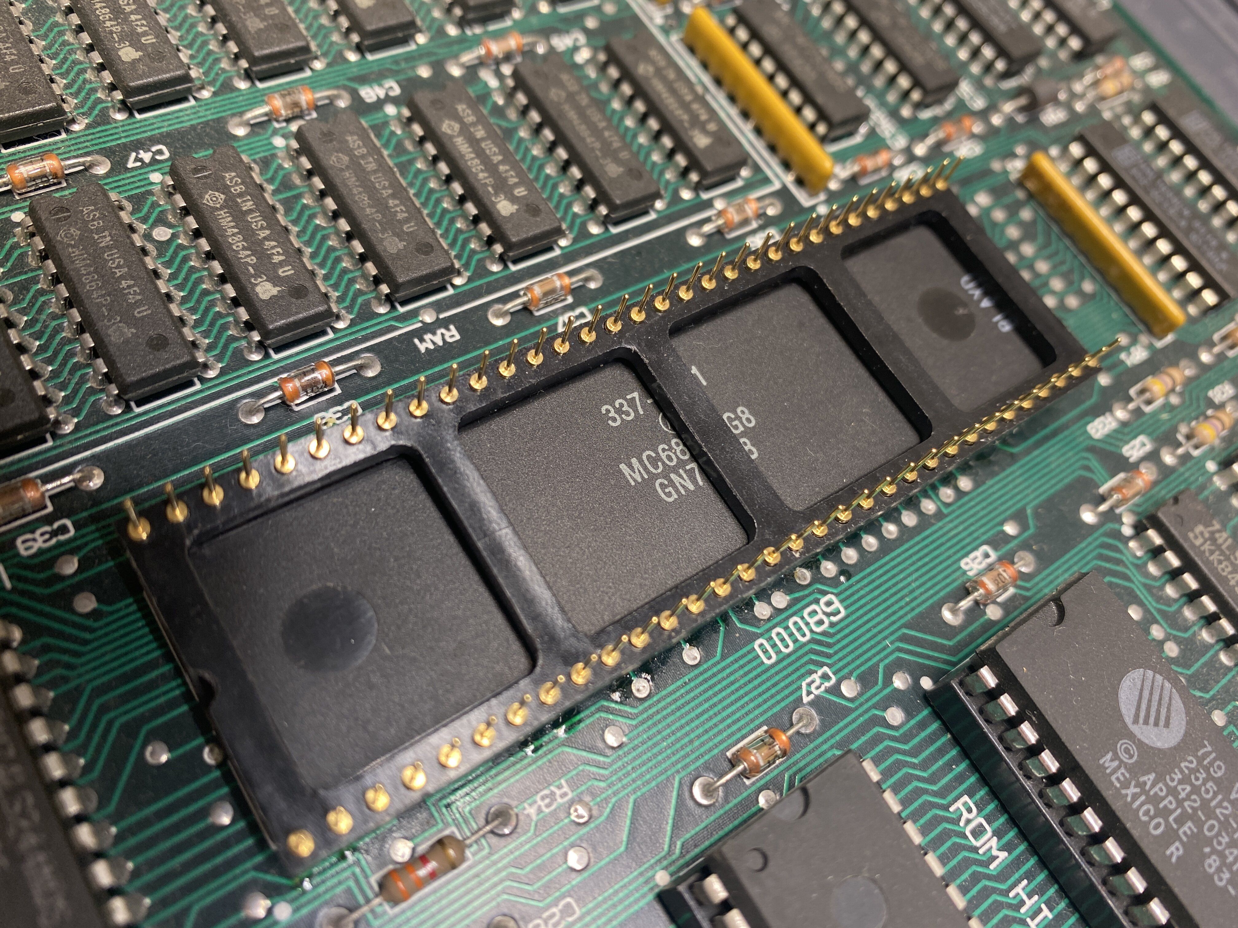

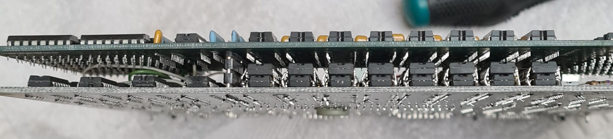

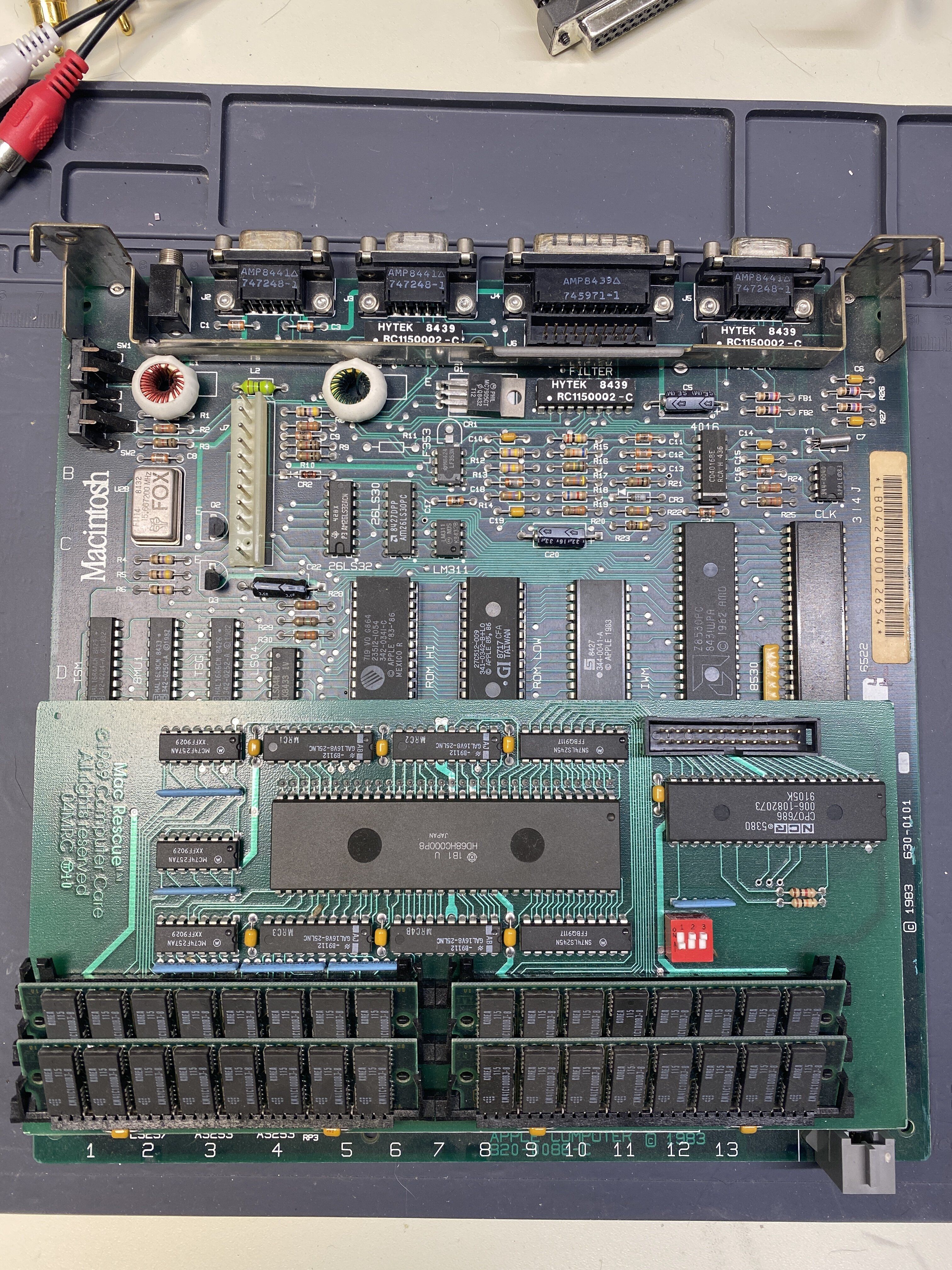

I was recently given a Macintosh 128k by an old friend and it’s definitely not a normal one. The first clue it was special was a DB25 connector on the back that looked like a SCSI connector. Opening up revealed that it has a Mac Rescue expansion board with SCSI, populated with 4MB of RAM. The expansion board is plugged into a socket that has been soldered onto the sides of the Mac’s original 68000 CPU, and then the expansion has its own 68000. It looks like the ROMs have been upgraded as well, probably to support the extra RAM and SCSI.
Unfortunately the machine is pretty flaky - I’ve only gotten it to boot once. Otherwise it starts booting with a Happy Mac in the middle of a black screen and stops after reading the floppy drive for a while.
Any hints for how to troubleshoot this? What would a happy Mac on a black background mean? I’m willing to try prying the expansion off to see if it’s the culprit, but the way it’s attached worries me that I’ll do damage if I try to remove it.

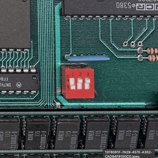

maybe try booting with no expansion RAM and the. Half of the RAM - and switch the sticks for the other half. You may need to change jumper settings to support none / half ram.

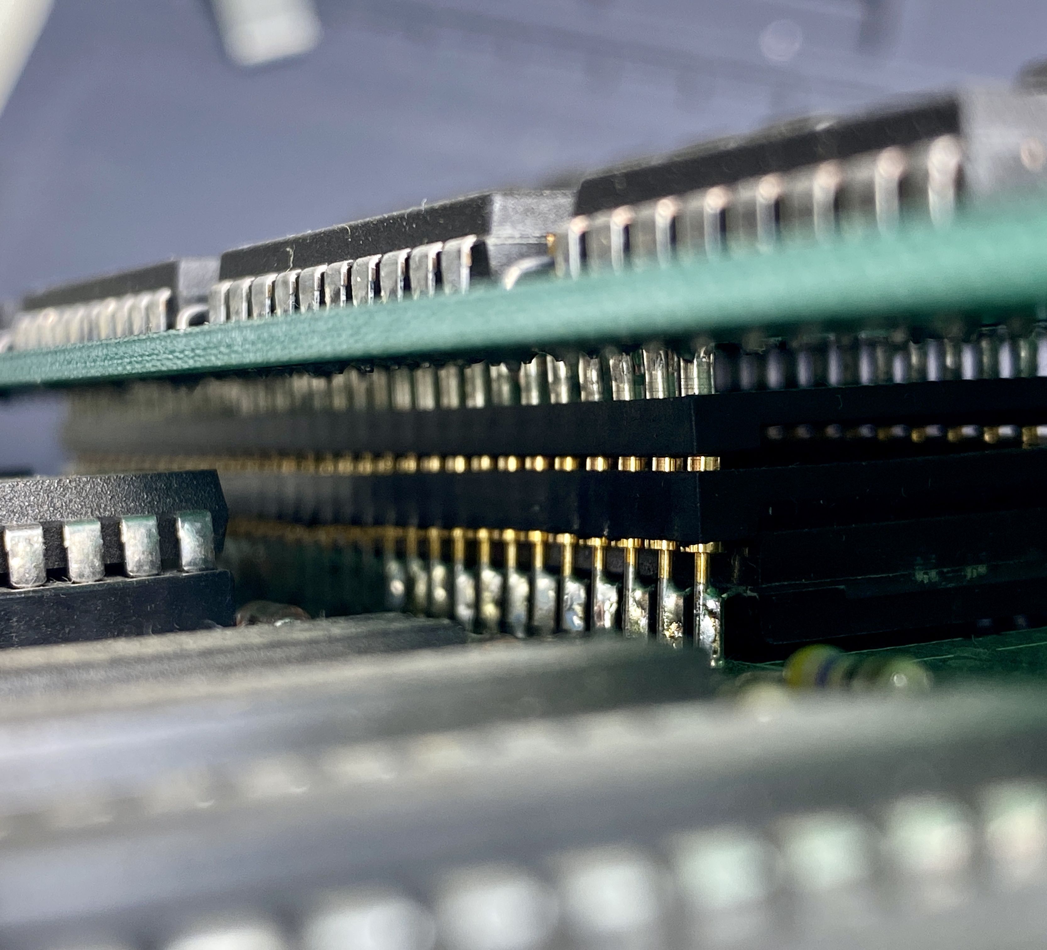

So I went ahead and took out the SIMMs and while I didn’t see any corrosion, I cleaned the contacts with a fiberglass brush and applied some contact cleaner to the sockets. And guess what, it now boots perfectly reliably, at least from floppy! So all it took was some light cleaning.

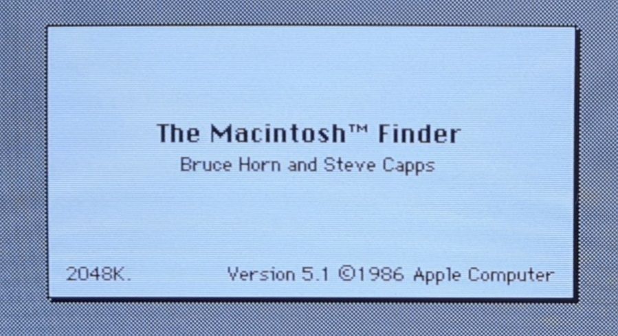

As for why is has its own 68000 instead of using the original, my theory after looking closely at the board is that it allows this board to more cleanly intercept the address and data lines to allow for expanded RAM. Other RAM expansions that I've seen for the 128k involve varying levels of modification to the original board, while this one just snaps on. I'm curious how it effectively disables the Mac's original 68000.

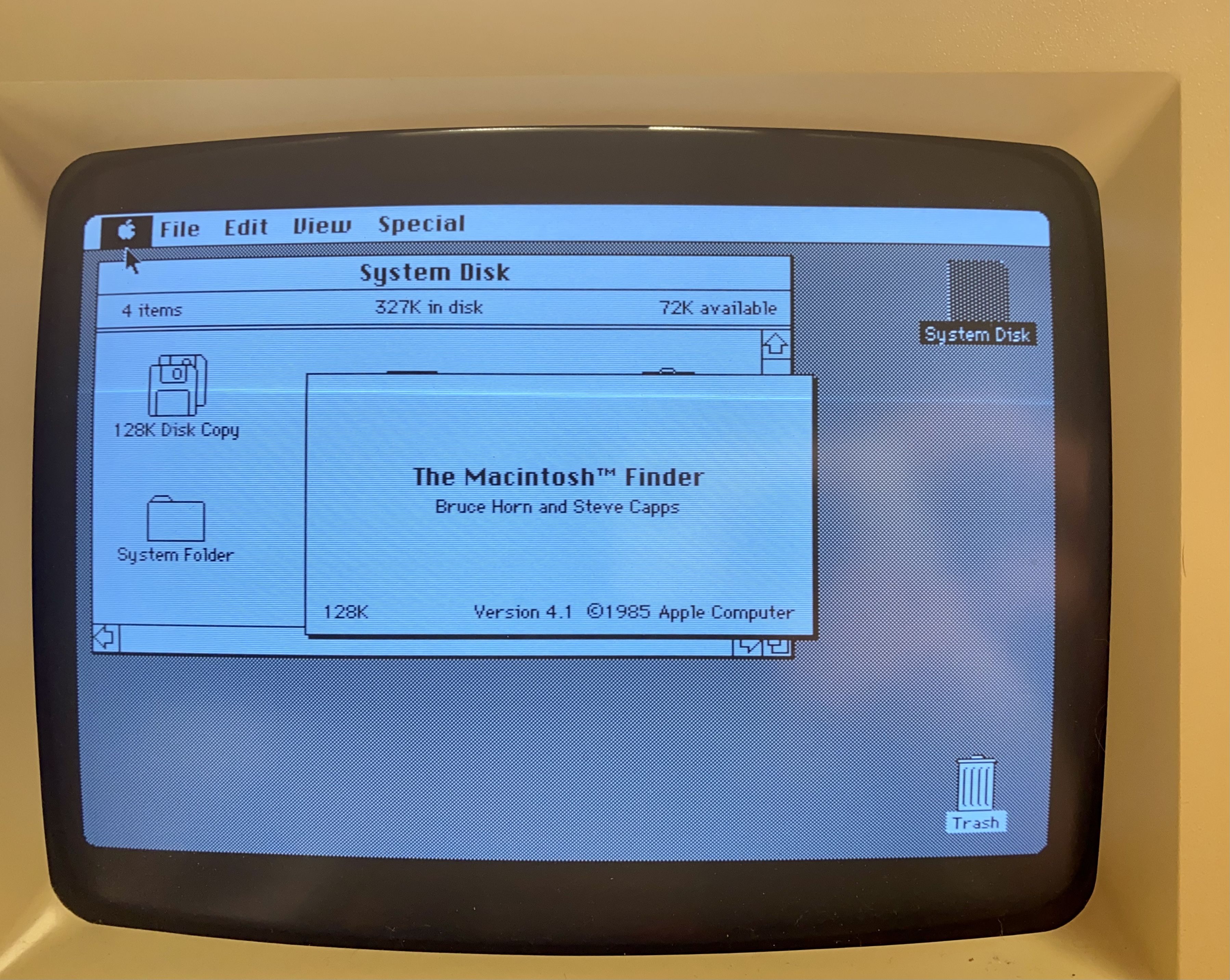

So I’m pretty sure the NCR 5380 SCSI chip on this Mac Rescue expansion is bad so I’ll be replacing it. Since I have to take the Mac Rescue off of its socket anyway, it’s interesting to verify that this is really a cleanly reversible expansion. With it removed, the Mac fired right up with 128K of ram. It’s probably been been 30 years since the original 68000 had been used on this machine instead of the one on the Mac Rescue! The date codes on its chips point to it being made in early-mid 1991.

I noticed in the picture that you posted of your Mac Rescue upgrade board from Computer Care that the DIP switches are as follows:
1 - OFF 2 - ON 3 - ON
Joe of Joe's Computer Museum discussed that back in 2015. Although the Mac Rescue may have been a bit different on his Mac 512k, he learned that when the Mac Rescue board has 4 MB of RAM, all three DIP switches should be on. :geek:
Have you tried that? :) 🤞
