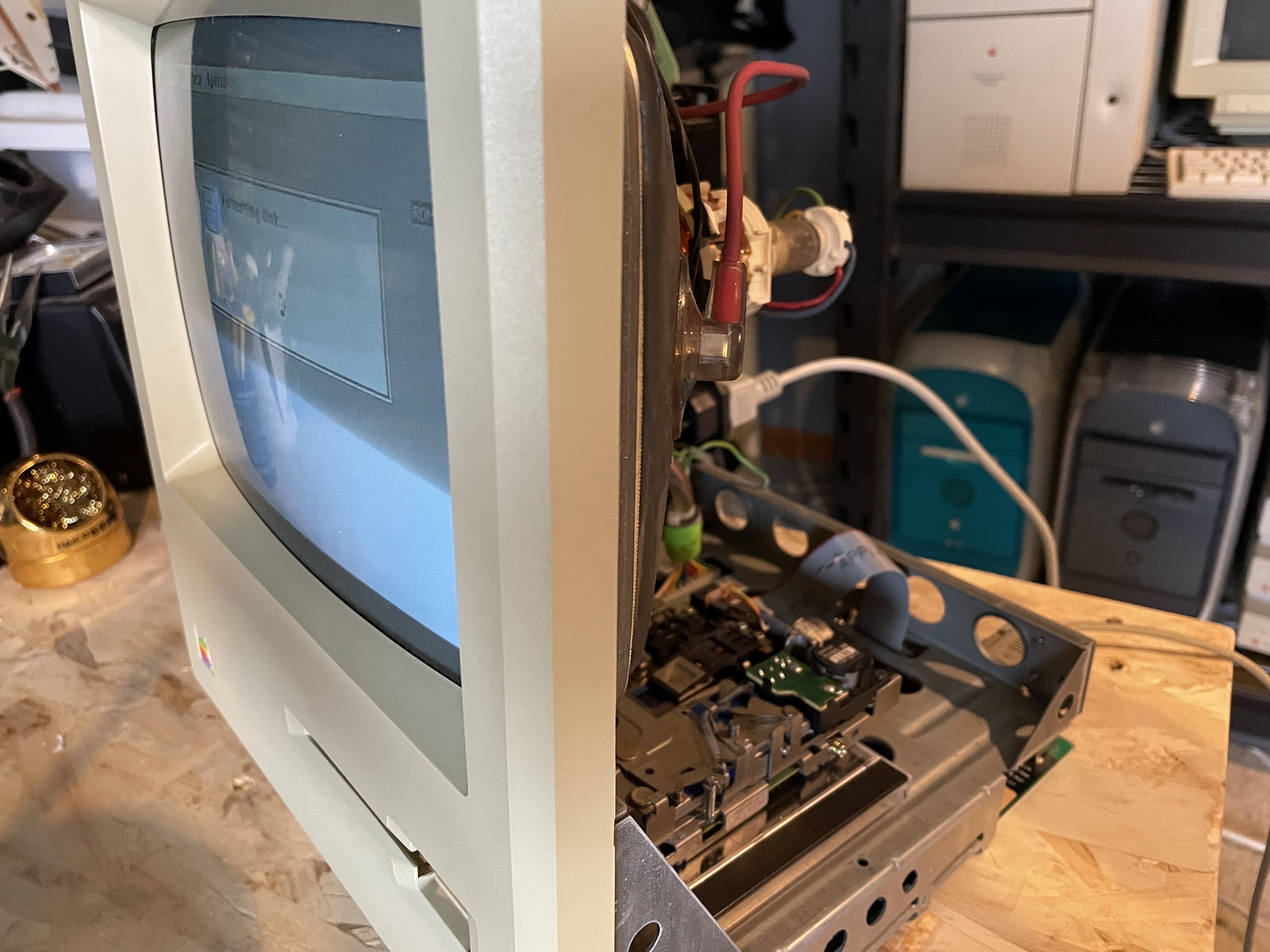

Floppy
Not sure where to start here. If I move the head from it's starting position and insert a disk it does move itself back to the start position. Do other floppy drives work in the 512k? I could likely find an 800k around here in a working condition, just not sure if it's compatible.
Here's a video of the current floppy behavior with a known good disk.
While I wait for some guidance on the floppy I'll start the ROMinator install!

Pretty sure an 800K drive in there will look and work as a 400K drive - it will only write data to the one side of the disk.
It might not physically line up with the slot, though; it's been a while and I can't remember...
they are but you will only have 400k. HOWEVER, after you install Kay's mod it will turn your 512k into a 512ke . which means it can use the full 800k if you have that drive. (at that point you have the ROM of a plus)
so without mod: drive treated as 400k even if its 800k. with mod, treated as 800k.

Same thing with the later Sony MP-F75W FDHD drives. A stock 512 will consider it a 400K drive. A 512Ke will think it's an 800K drive.
If the 400K drive uses a zero track sensor like the later drives, it might be worth trying to adjust it and see if that causes it to read a known good 400K floppy.
-J

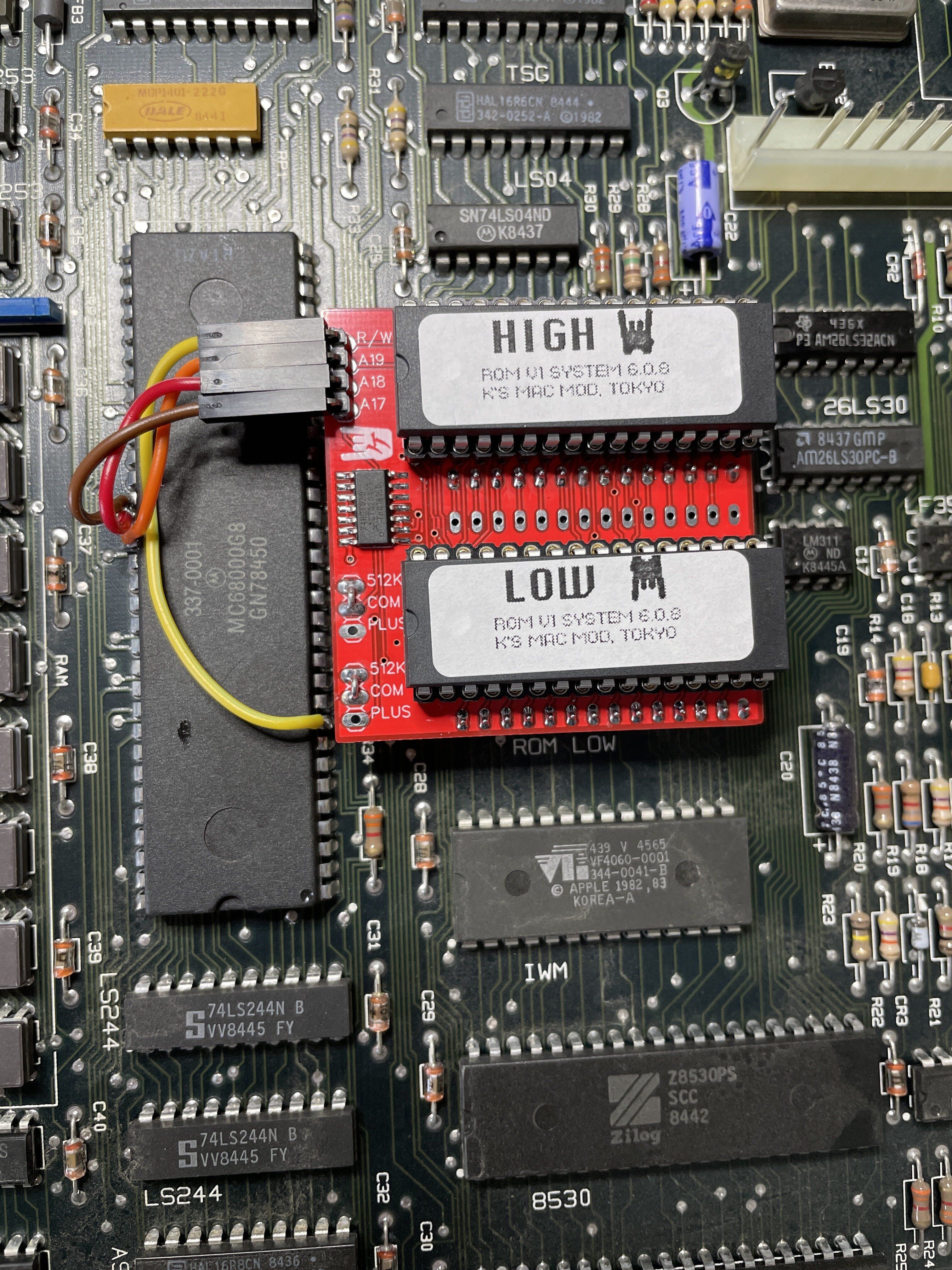

Well I got the ROMinator installed but no sound now. Can start right up into the ROMs embedded OS but no chime nor sound from games or the system control panel.

i had the same problem. check your bodge. i think it might be the brown wire. or maybe the red wire? (its not the yellow one)
sorry i forget exactly WHICH one it was. but it was one of those 3 on that one side that caused audio problems on mine.
maybe i just don't know how to do this. but i had a hell of a time to sodder the wires onto the pins and get a good connection without bridging. ( i did eventually. but man there gotta be a better way)
oh... then agree its not the mod.
i'm the OP on that thread. and i have not been able to fix it. Note that i did NOT have sound on the head phone jack. but that could be because the Jack itself was rusted.
let me know if you fix it. because i haven't figured out why no sound on my 128k.

Phew, luckily some detoxit and working the headphone jack a few times brought back sound. Just bad timing I guess. Now to put everything back to gether and find a floppy drive for it.

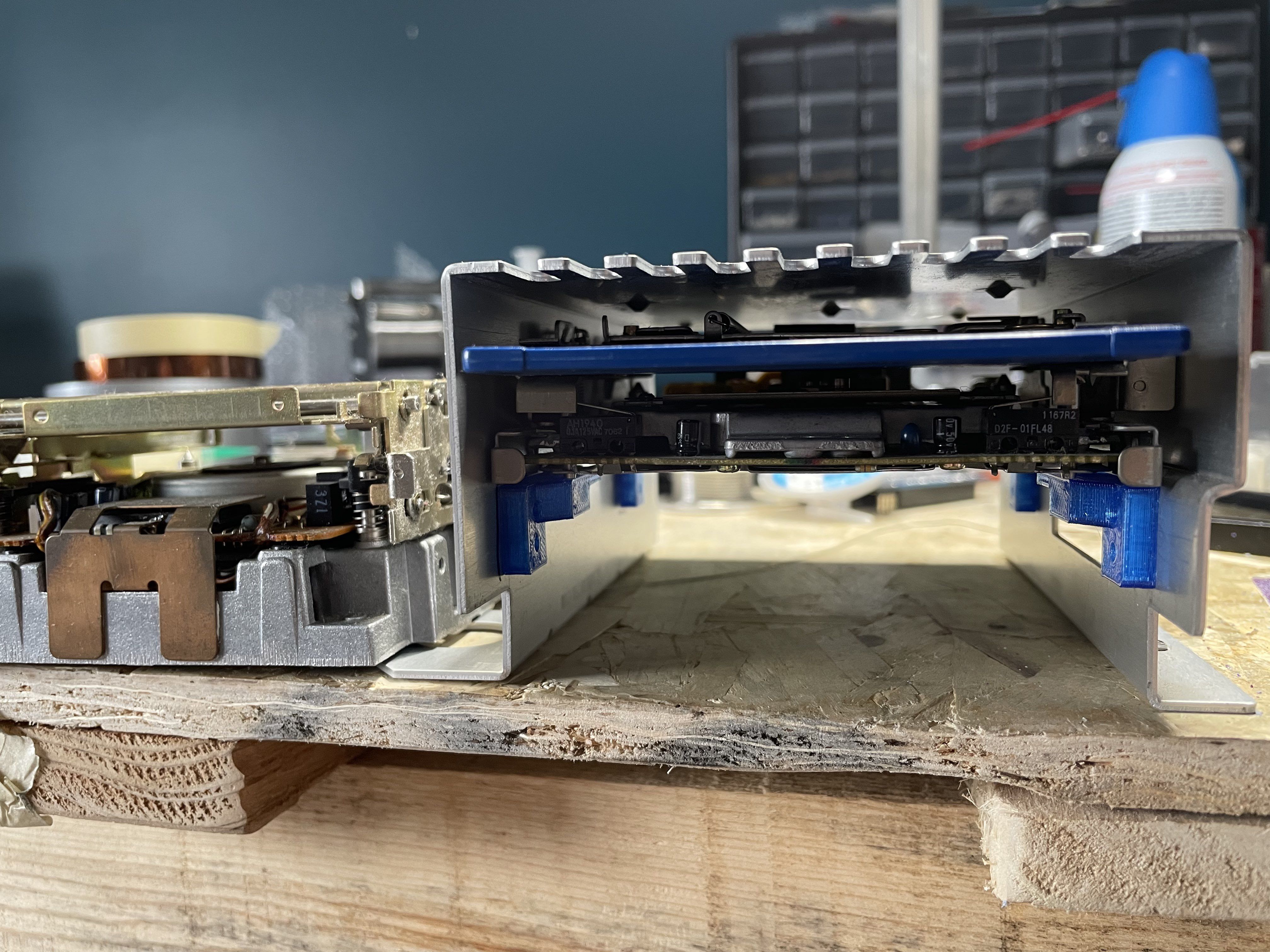

I've made some mounts to properly mount the 800k disk in the 400k housing/ I'll share the files when I get everything together, but it's pretty simple - only took 2 prints to get right :)
Hopefully then I can wrap up this months long project!

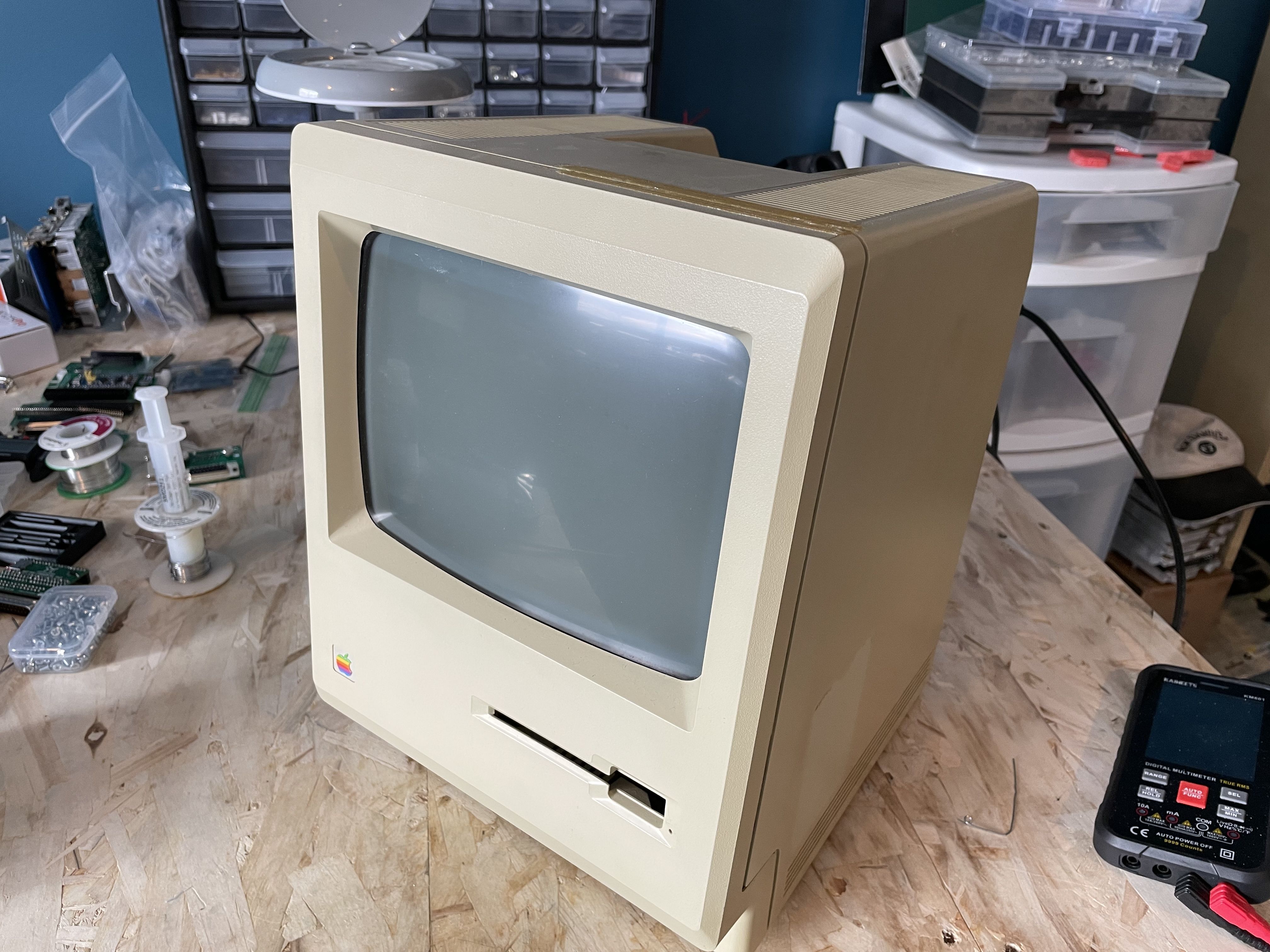

So... after all that - the 400k drive is good - it was the cable that was bad that came with it! on a whim as I was putting it all back together I thought I'd give the 400k drive one more shot (after knowing it failed just days ago) with my modded cable - Formatted a disk right away. Gah!
Now buttoned up with the original 400k drive working & Rominator.
