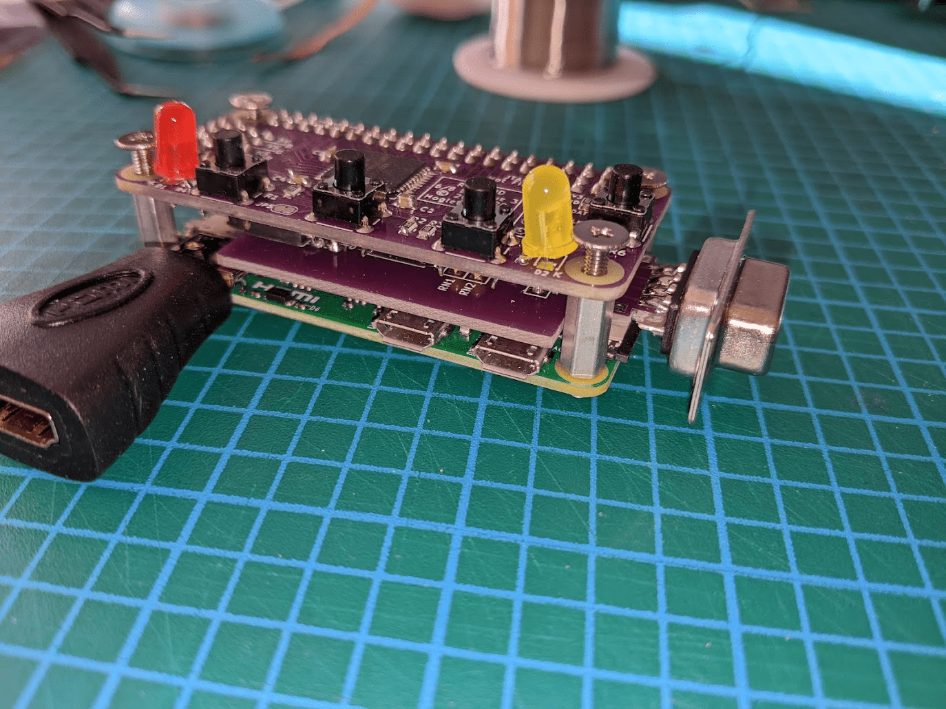

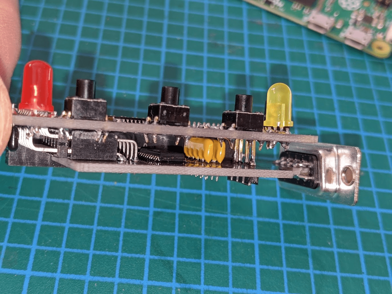

-got the gerbers (I used the 8/6 bit board + PC TTL extender so I went with a DB9 CGA/EGA style female connector on the extender board)
-ordered the PCBs from JLCPCB
-ordered the parts from mouser.ca including the Xilinx CPLD which is why this project works, the pi alone wouldn't be able to drive this fast enough - wasn't an exact match but was slightly better rated for temperature or something minor
-was extremely lucky to find a Pi Zero in a store in my province; overpriced, but better than nothing

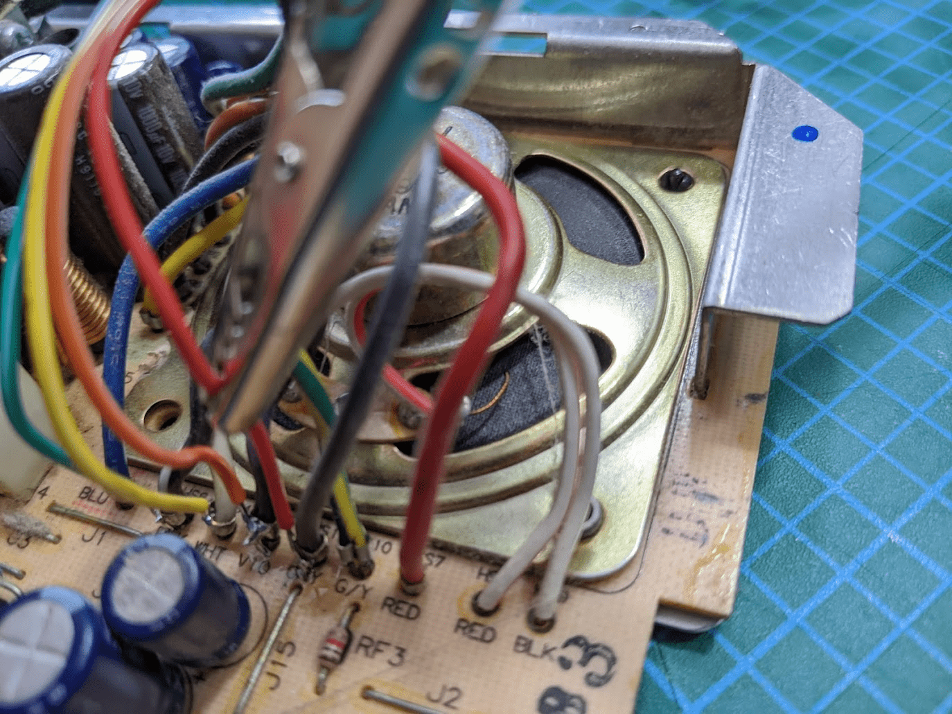

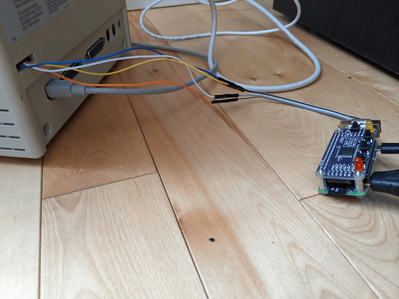

Next step was to add a set of 4 wires directly on the crimp casing of the video wires that go directly on the analog board: BLK, WHT, VIO and GRY
I don't have millions of cabling options on hand, so I had to make do with a series of dupont connector wires (4 sets long of 4 of them to be able to fish them out the security hole, I'm ashamed to admit):

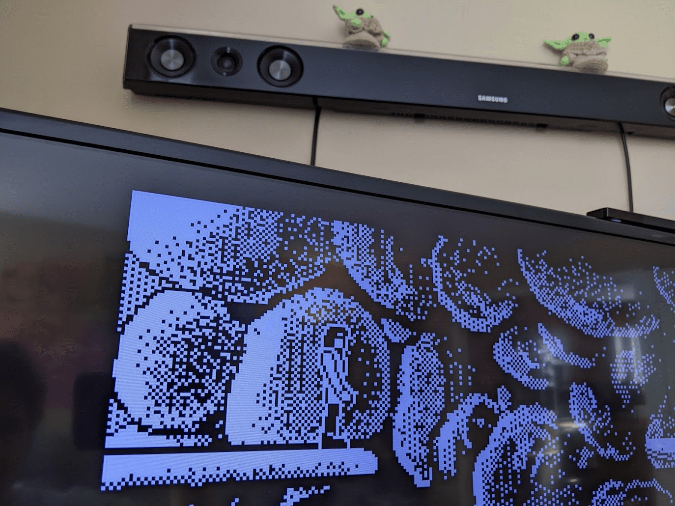

Gameplay footage:
After doing all this, bad news: the already slightly unstable video signal for my Classic has gotten noticeably worse. I can tamper this problem a bit by lowering the brightness of the CRT screen, but it's still there. The analog board will definitely need a recap in the near future.
A stark reminder that CRTs are on borrowed time in a long term perspective, and the RGB2HDMI is a super tool to have as a backup option!
