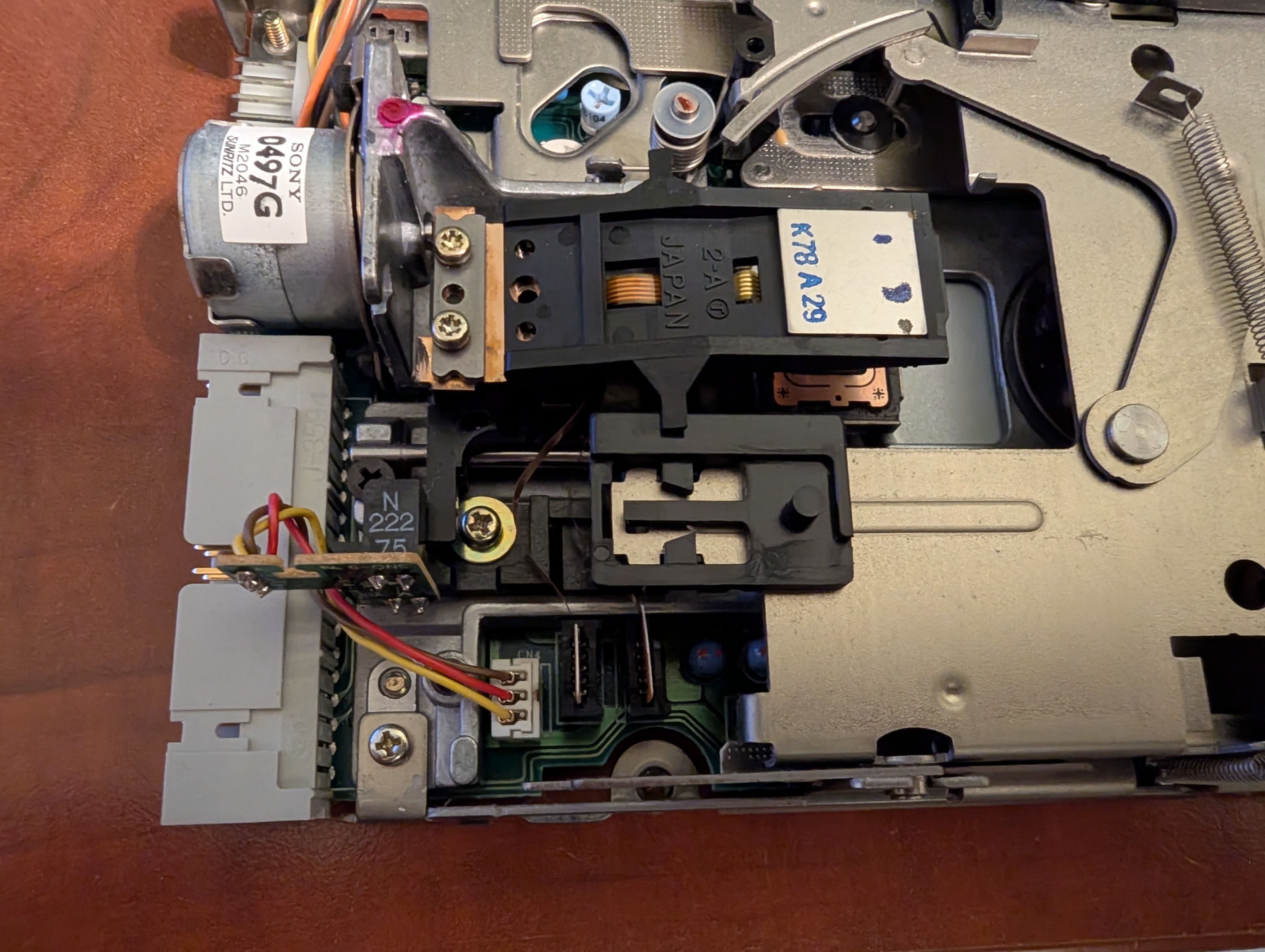

I just received the lot of MP-F73W-01D disc drives from ebay, and can confirm the drive heads look identical to the ones in the much, much rarer Apple-specific auto-inject drives (MP-F75W-01G)🎉
It's going to be a few weeks until I have the time to try swapping a pair into my MP-F75W-01G, but i'm pretty confident just looking at them this feels like a viable source for replacement heads on the auto-inject drives.
