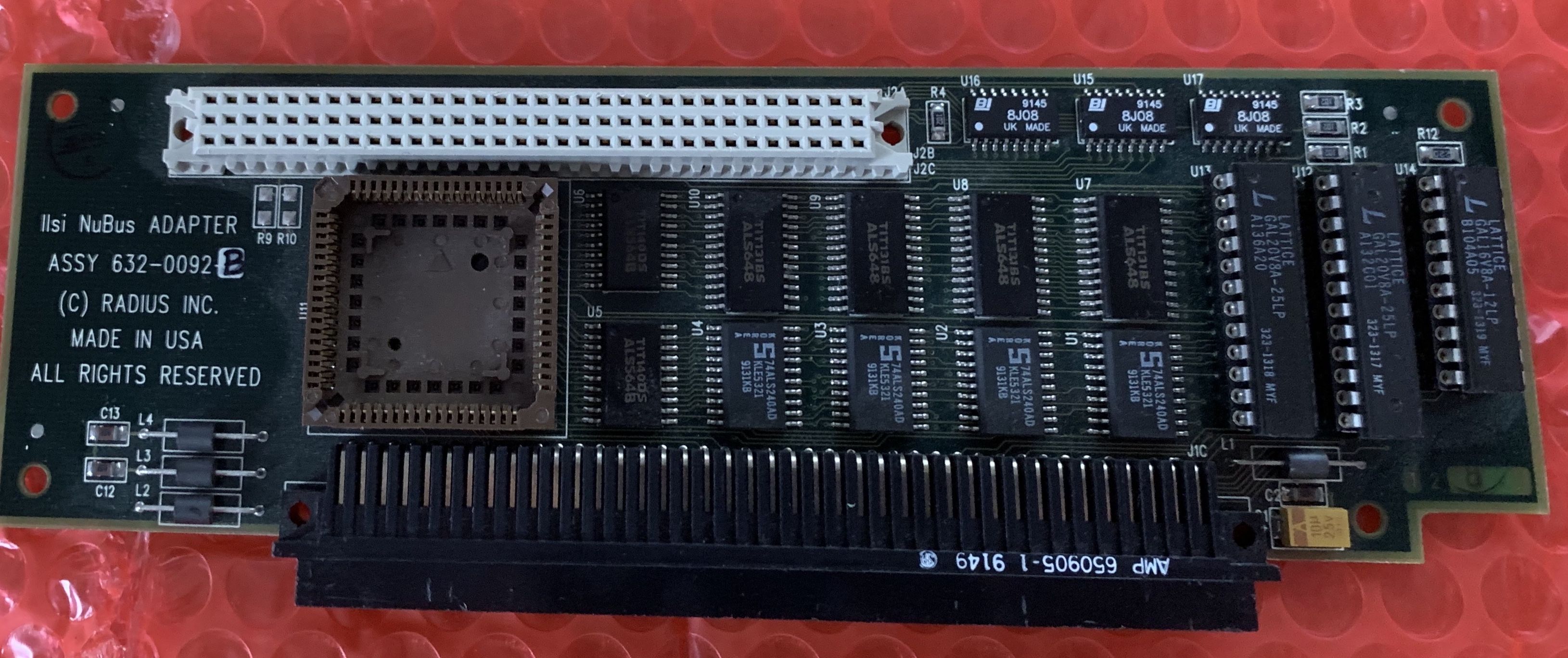

The Radius IIsi NuBus Adapter and DuoDock II NuBus implementations would be what makes me think that a goodly portion of the Rev.A HALs might be excised from its NuBus chipset:
If NuBus MUX can be identified and eliminated from the Rev.A NuBus schematic, then the NuBus controller might be treated as a Black Box. If the three GALs on the Radisu IIsi NuBus Adapter can be read that would give us a leg up. They control but a single NuBus Slot keyed off the NuBus line present on the 030 PDS, but should give us a good handle on what's going down inside that Black Box in the Rev.A implementation I think?
@Bolle can those three Radius GALs be read?

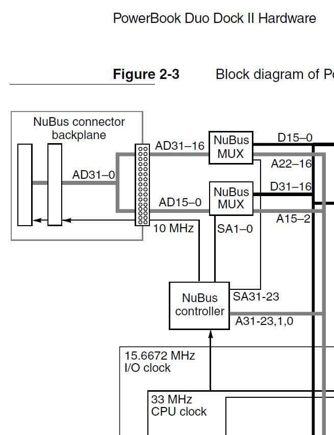

DuoDock NuBus I've always figured was a standard TI Controller/MUX twins implementation. Thinking again would be that they're re-badged, stock parts from the TI Catalog?
Need to identify the four MUX/transceivers on the Dock II board, methinks they're standard parts that became available. In that case they'd be less expensive, have a smaller footprint and provide for much simplified routing as compared to the standard TI pair on the DuoDock board?

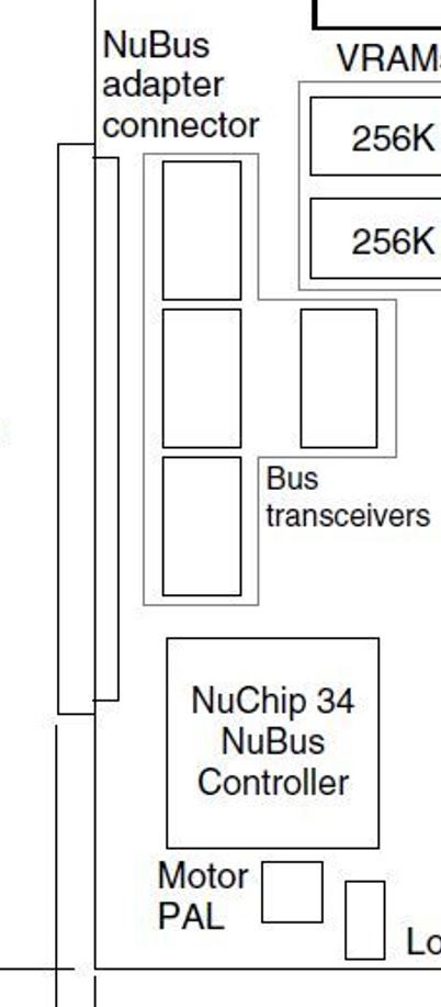

NuBus Controller
The NuChip 34 controls the interface with the optional NuBus cards. It is similar to the
NuChip 30, but with modifications that enable it to run at 33 MHz. NuBus cards occupy slot and super-slot segments C and D of the PowerBook Duo computer’s I/O space. (The flat panel video display occupies the address space normally occupied by NuBus slot 6. External expansion video and most I/O appear in the address space normally occupied by NuBus slot E.) Table 14-11 shows the I/O space for the NuBus cards.

If that's simple enough, such might be implemented on a rework of the Radius NuBus adapter for IIsi that "just works" just about fine at 8MHz in the SE/30? I've no need for the CoPro for an SE/30 version and doing a IIsi version with PDS passthru should work if using the SMT Ti SN74BCT2420 - Nubus Bus Transceivers @Kai Robinson found on either or both sides of a IIsi/SE/30 combo form factor hybrid?
I may be able to get that one figured out from Rev.A schematic development for comparison to the available Bomarc Rev.B schematic?

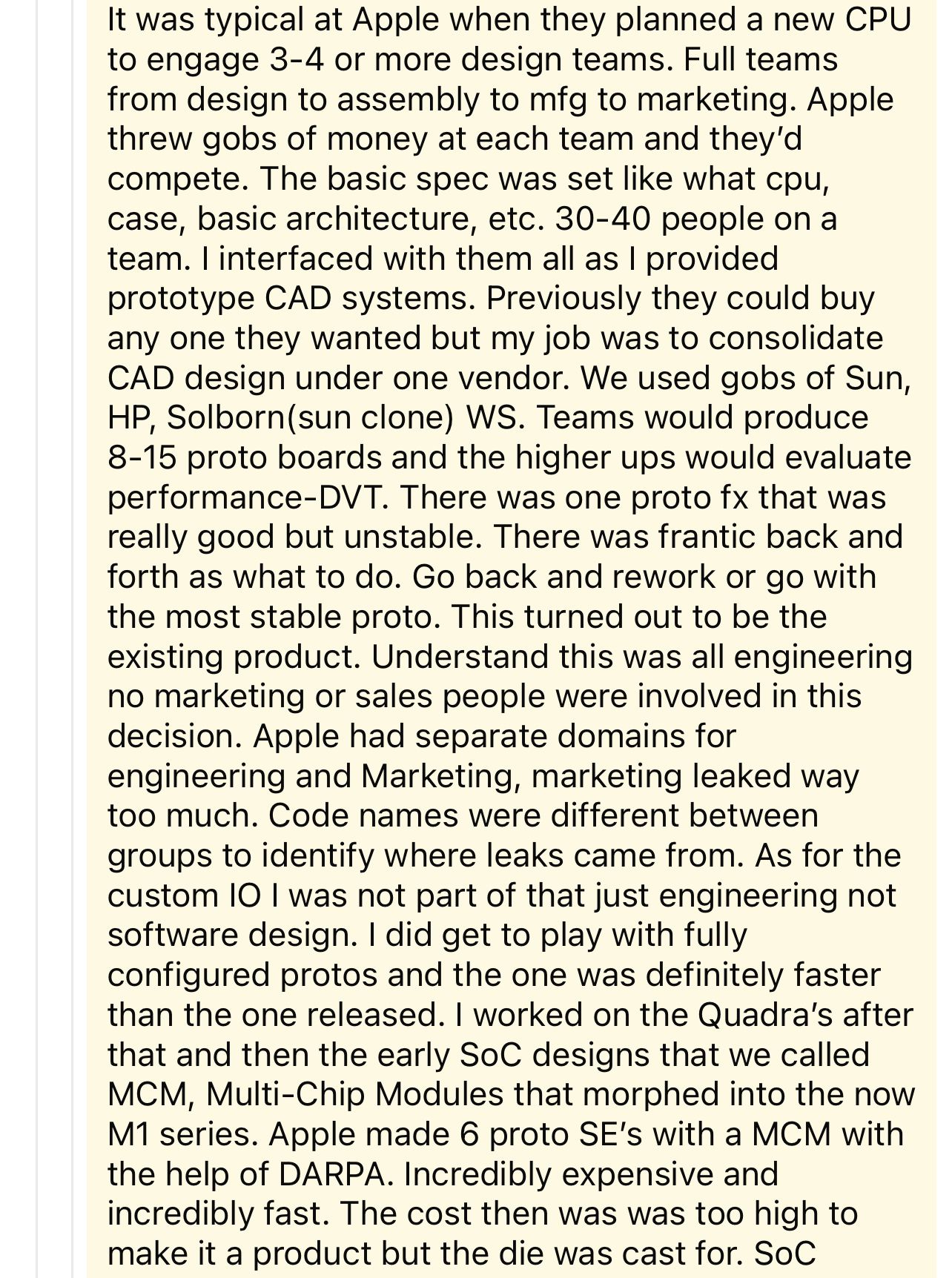

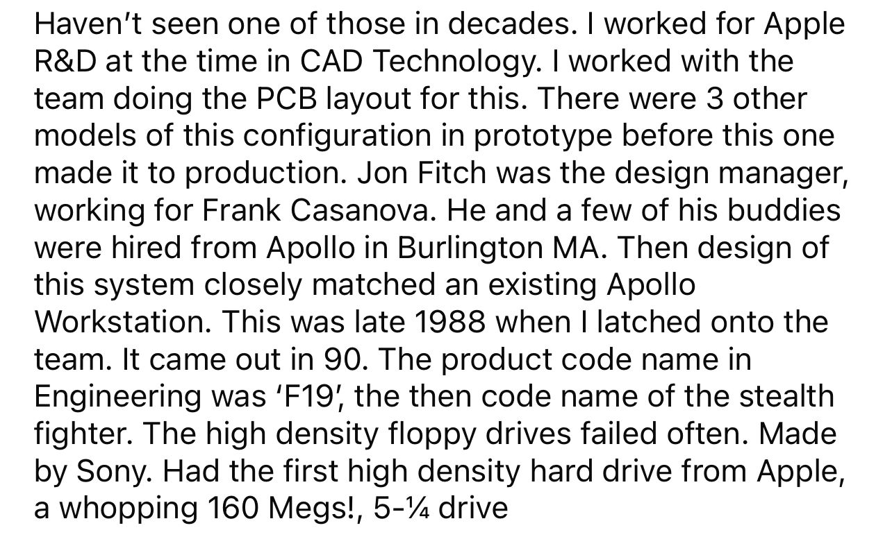

Thought you guys might find this interesting found this from a guy who worked on the team designing the iiFX for Apple apparently it's very similar to the Apollo Workstation.

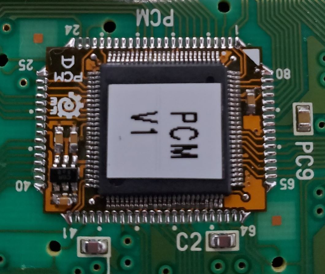

I'd love to be able to recreate the functionality of these chips in CPLD/FPGA form - so you could use them as replacements in Reloaded boards, or repairs.
I'm envisioning something like this: https://www.tindie.com/products/furrtek/neo-d0-replacement/ in terms of footprint, although you could use a thin flex-PCB header to link to an external PCB that has the logic on it, if it's not possible.
This image shows a castellated PCB with an FPGA on it as a chip replacement:
Reactions: Androda
Wow, didn't realize folks were so actively pursuing this kind of thing? Thanks! I was thinking a castellated PCB was a higher/multi-level version of an interstitial adapter, but it refers to castellation of thruholes used to make contact?
I've been hoarding an advert for a patented industrial process: solder balling the bottom of an interstitial adapter for reliable QFP component replacement in production of existing designs. Been looking at that since dr. bob was trying to tell me that I couldn't get a G3 into my Duo 2300c twenty years ago on 'fritter.
Castellated VIAs of that pitch might work, how fine have you seen them done?

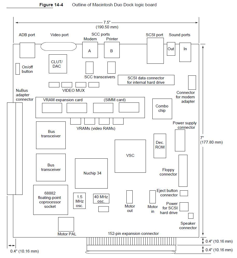

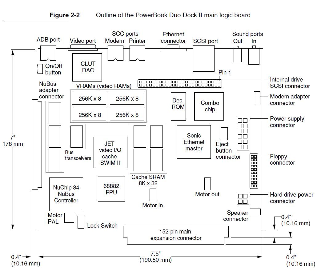

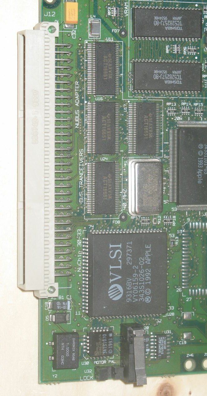

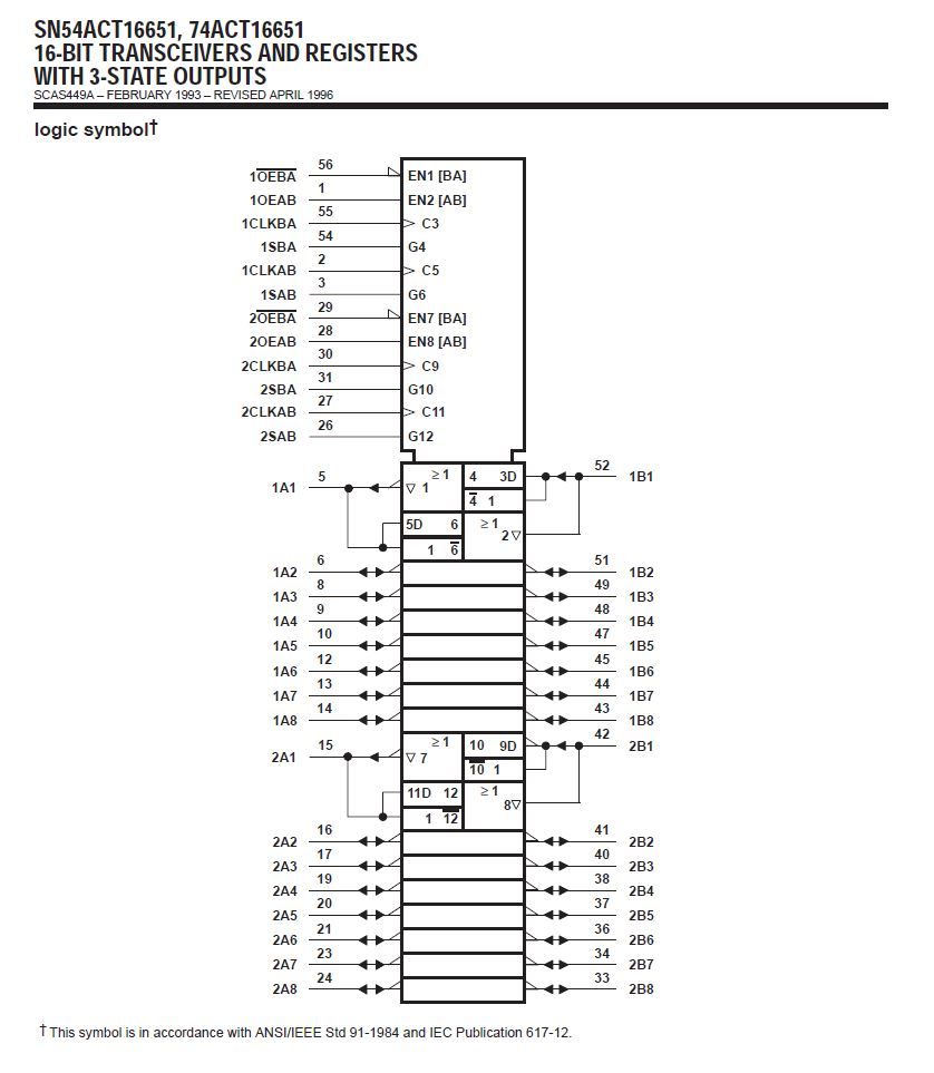

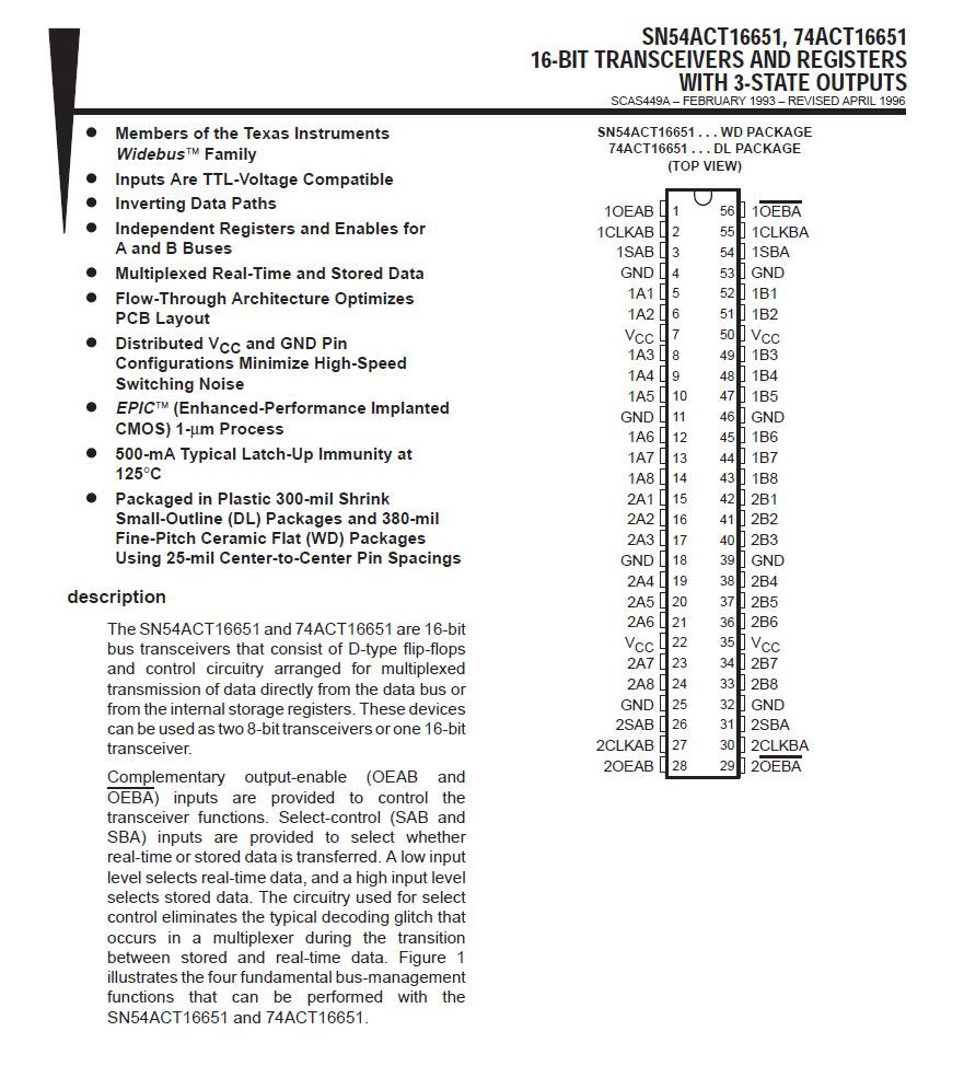

Found a Dock II board in the pile and have identified the quartet of Bus Transceivers from TI in the Block Diagram above:

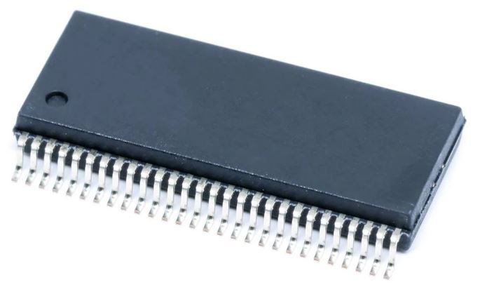

74ACT16651 - 16-Bit Transceivers And Registers With 3-State Outputs - mouser.com 74ACT16651 at $14.64 ea.
So they're more expensive than the dedicated Ti SN74BCT2420 - used Nubus Bus Transceivers @Kai Robinson found, but they're brand new, straight thru, smaller footprint and simplify board layout significantly.
Moreover they're narrow, low profile SMT chips that'll make a nice little row between the soldertails of PDS passthru or PowerCache adapter connectors on a TwinFunction IIsi adapter or Multifunction/30 adapter which would be where all this tinkering with NuBus implementations would be ultimately headed. :p
Here's where things get interesting, Breaking the reverse engineering necessary to as few building blocks as necessary:
1) determine the NuBus Clock generation circuit in the Rev.A
2) isolate the HALs implementing its three state machine
3) Isolate the HALs implementing NuBus Transceiver requirements so they can be ignored.
DuoDock II NuBus setup is looking more and more intriguing in its apparent simplicity. All but the state machines and control present in its NuChip30/33 ASIC appear to be equivalent to HALs in Rev.A, which is dependent on the out of spec (all things considered, we can grant Apple some slack, we can say thery're PRE-Spec) NuBus ID lines.
Dunno about Macintosh II series in between, but the IIsi 030 PDSSlot NuBus adapter has a single NuBus ID/Control line present on the IIsi/SE/30 PDS pinout.
Here's where things get really interesting! DuoDock architecture appears to do away with NuBus ID lines? It supports of a pair of Slots! It is based on the pure as snow 030 PDS "Slot" that is the Docking Connector.
DuoDock II Takes us into the realm of off the shelf, available transceivers. Both Docks appear to use a 40MHz Clock in deriving 10MHz required for NuBus, making them CPUCLK independent? Very good news for the SE/30 and an overclocked IIsi board that!
