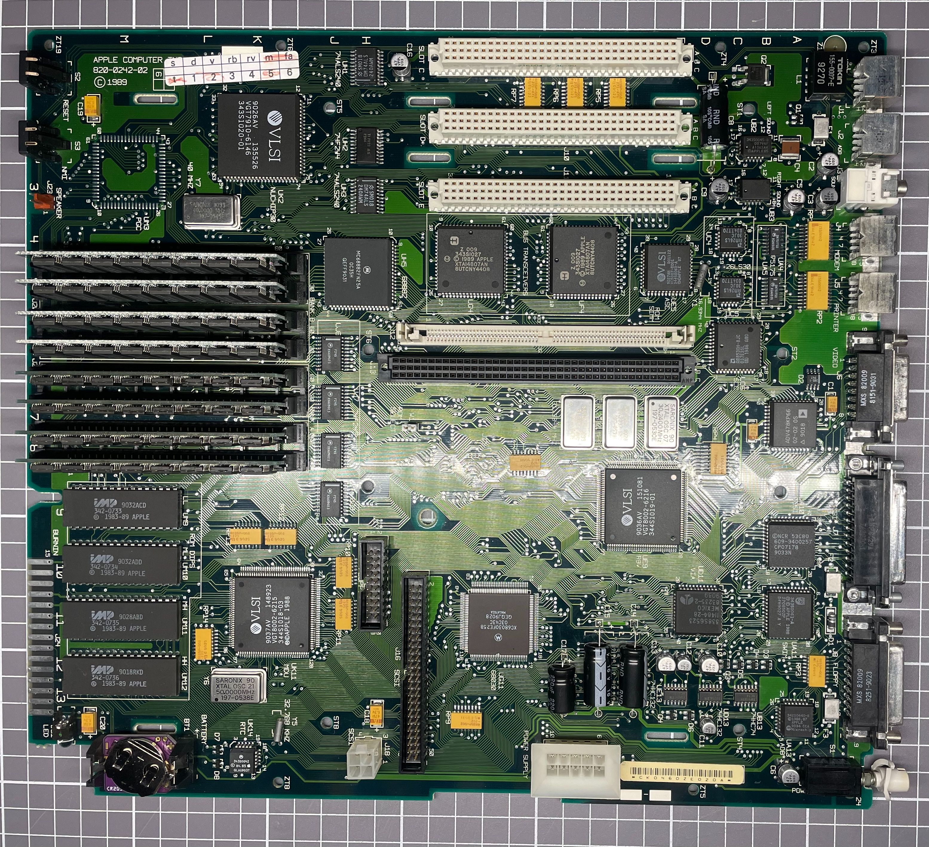

I am no electronics expert, either. But, many here are more skilled and their visual inspection could provide clues. Please upload the image of the whole board. That is a starting point. And you will likely get guidance for things to focus on, or requests for closer photos of specific areas.

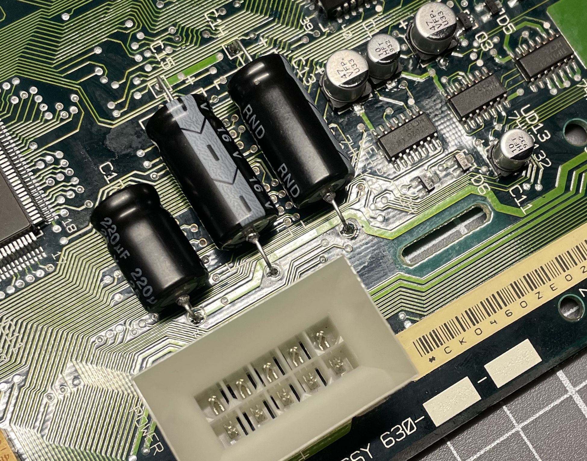

It's possible for cap leakage to result in damaged traces within the startup circuit, given how many caps are there. The place on the logic board to look at is in the area underneath the power supply. Magnification may be required to see any breaks in the traces. It's also possible there is a broken trace beneath one of the replaced caps or beneath UD13 or UE13.

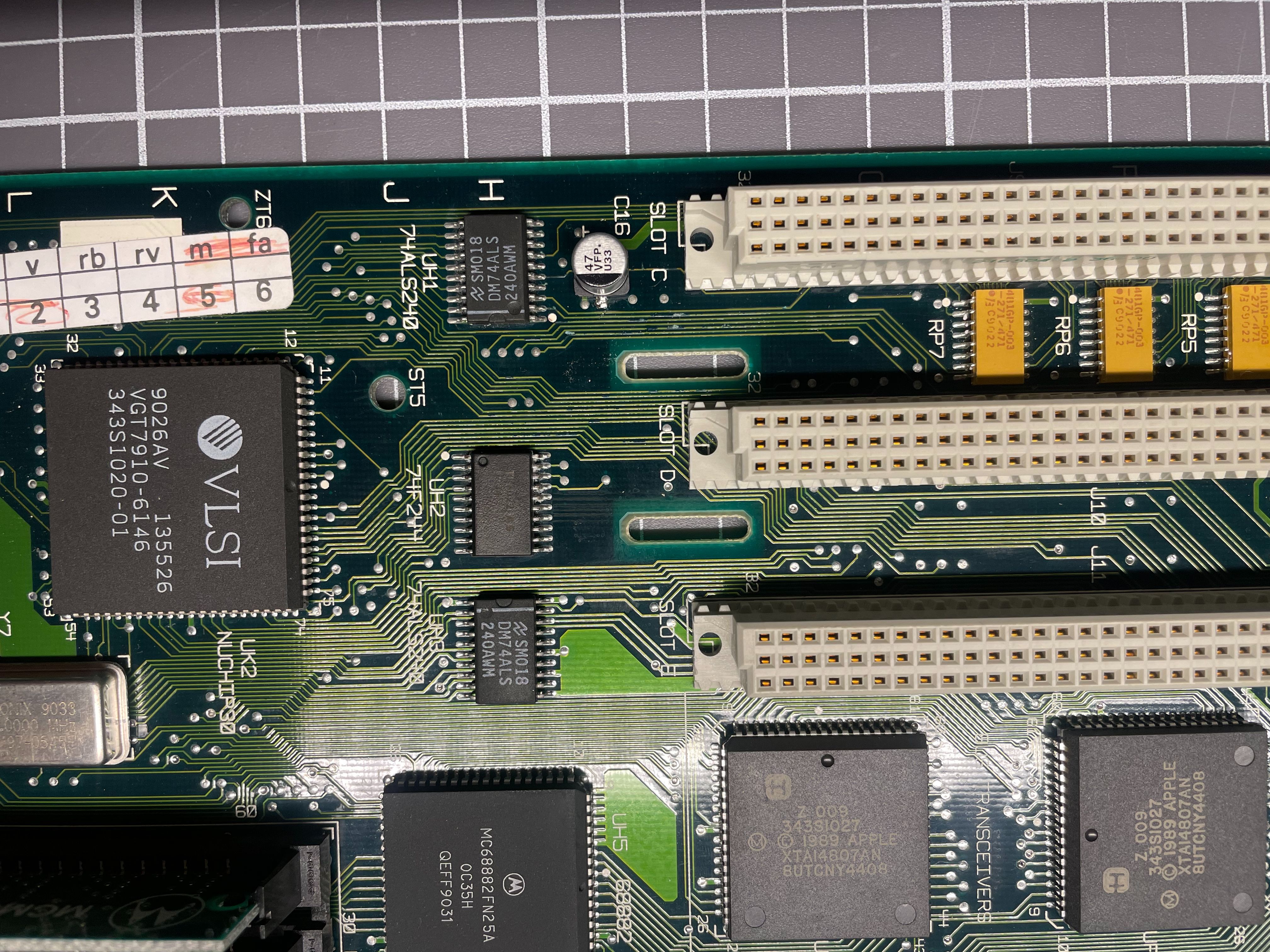

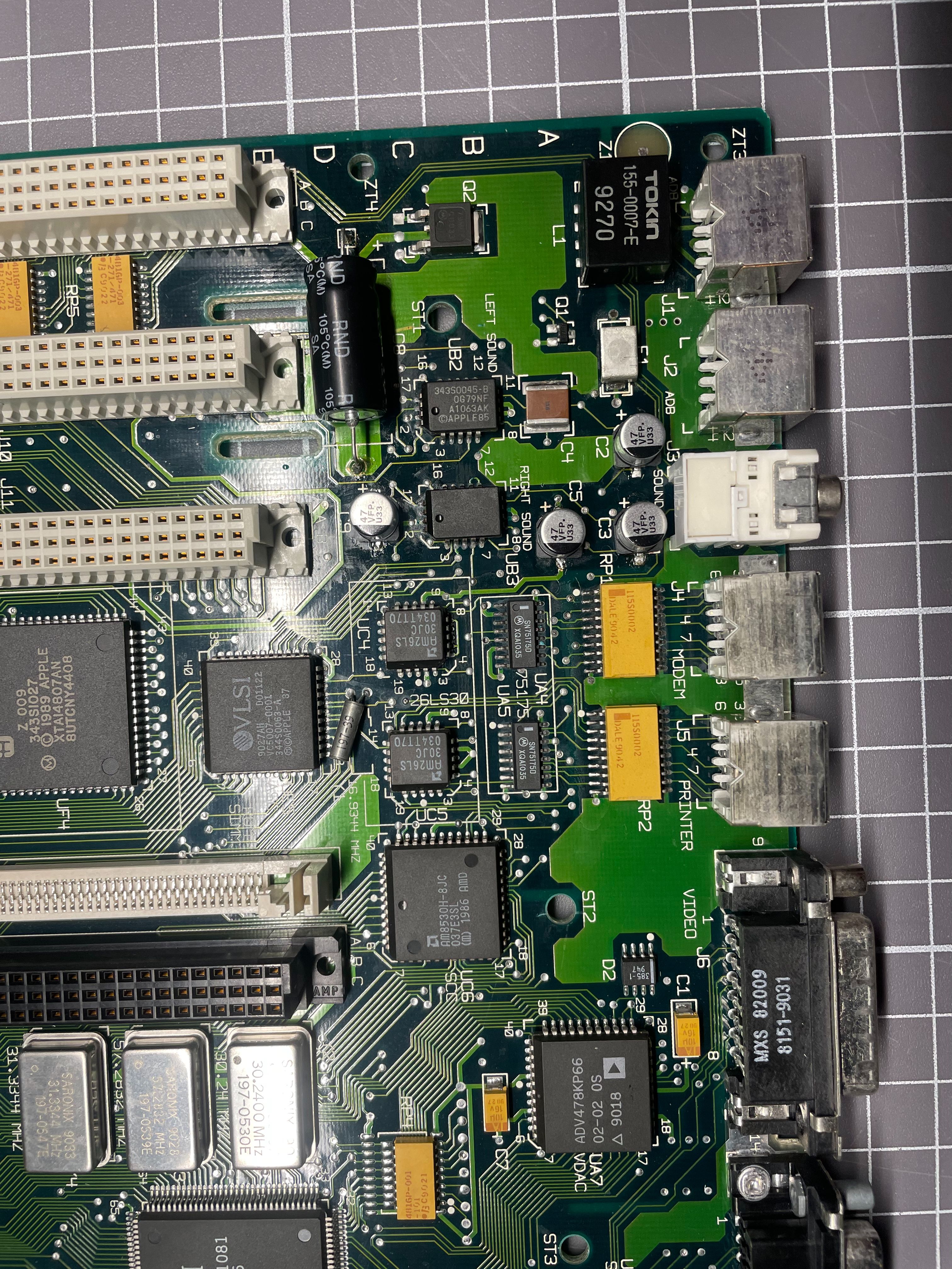

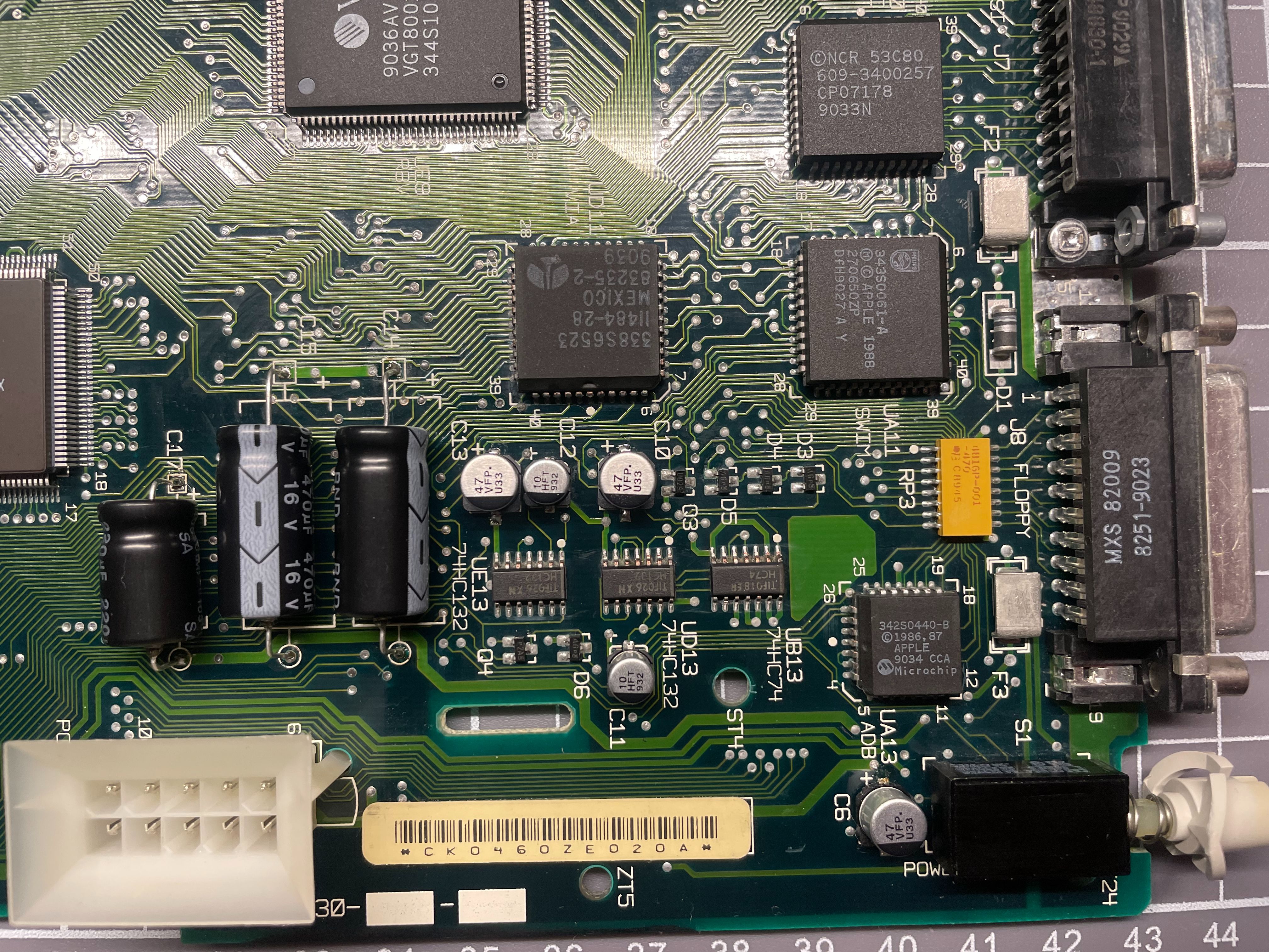

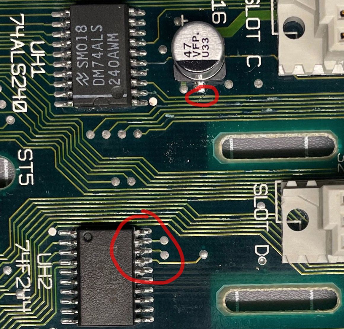

Hey all! Thanks for the suggestions, and sorry for the late reply! I've attached a few images of the board, in case that helps. Unfortunately, I don't have access to a microscope or the like so I'm trying to get by with only my eyes, and while I can clearly see damage between the expansion slots (C & D) next to C16 and some between the chips above the three axial capacitors, but that's about it. I've done some continuity checks and there seems to be a bad trace next to C16), but could that stop it from booting? I've tried to test other traces, but honestly I find it mostly impossible to follow them, so I guess I'd need to know where they end up, which is doable if I know what traces to check...since there's a lot of them. As for underneath the PSU and around UE13 and UD13 I can't really see any damage, not that that means there isn't any.

Did you clean this board? Did you do the recap?

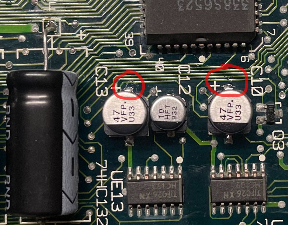

The traces near caps by the 3 big coaxials, I can't tell if that is flux residue or a scratch from the soldering iron.
Near Cap C16, you can see most of the endpoints, so I assume you continuity tested most of those traces. Look at UH2 and see if you can clean up those solder points on that chip. I can't tell if that is dust/residue/corrosion, or maybe cold solder joints.
Reactions: DevyDevly
Thanks, I'll check those spots and see what I can find
Yes, I cleaned the board. Not sure if the previous owner tried doing any repairs, but I'm pretty sure no one had tried recapping it at least.
First I removed all the old caps, cleaned the board as best I could with IPA and white vinegar, I then soaked the board in IPA for a few hours, brushing it a few times while soaked. Afterwards I used white vinegar and IPA to clean up the remaining corrosion I could see. There were quite a few bluegreen corrosive spots spread around the old caps on the board, not particular big ones but quite a few and spread out, but I did get rid of all that I could see. After that I put the new caps in.
This part of the board drives the soft power circuit. Any broken trace is a problem. To test a trace you suspect is cut without following it to the end, you can simply scrape it slightly to expose the copper.
@speakers That sounds like a good place to start. How would I do that though? I've done similar bypasses on atx power supplies to but here I'm not sure how to jump those pins when the PSU in in situ.
I think it should possible to put a shorting link in the base of the terminal block between pins 9 and 10 and still be able to put the PSU in place. But I haven't ever tried this .. I have an extender cable (made by cutting down an ATX extender).
Ok, so I reflowed Q3 and a few other chips (UA4, UA5, and UH2). Some were a bit stubborn but they all came out looking shiny and tested ok. I also touched up some of my capacitor work and I tested all the traces @phunguss mentioned and they all checked out fine. Lastly, I checked the power switch to make sure it's not broken and it checked out fine too.

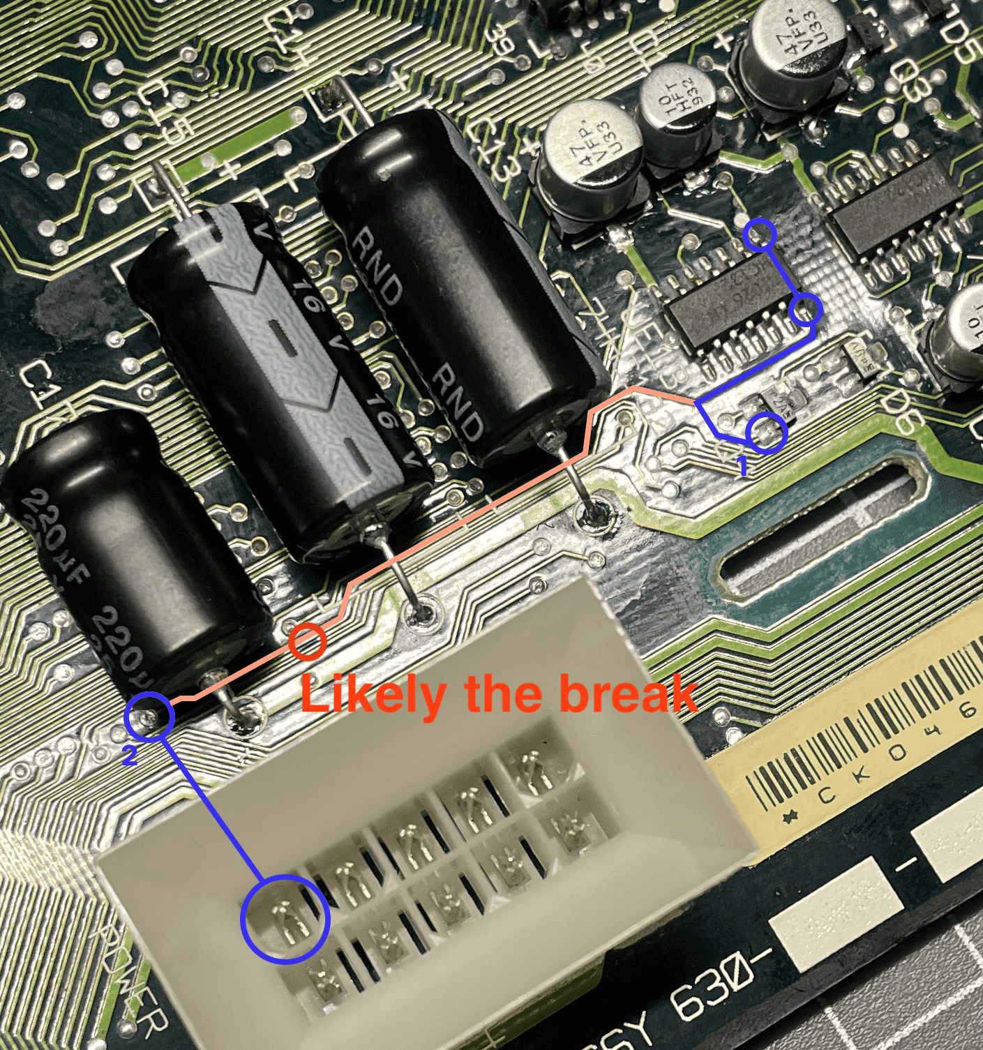

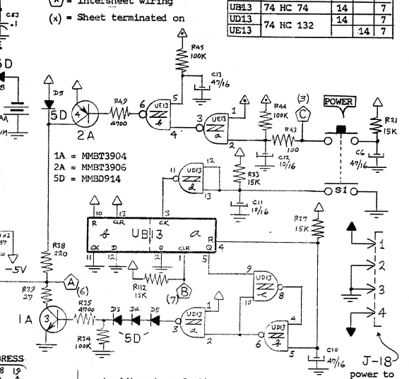

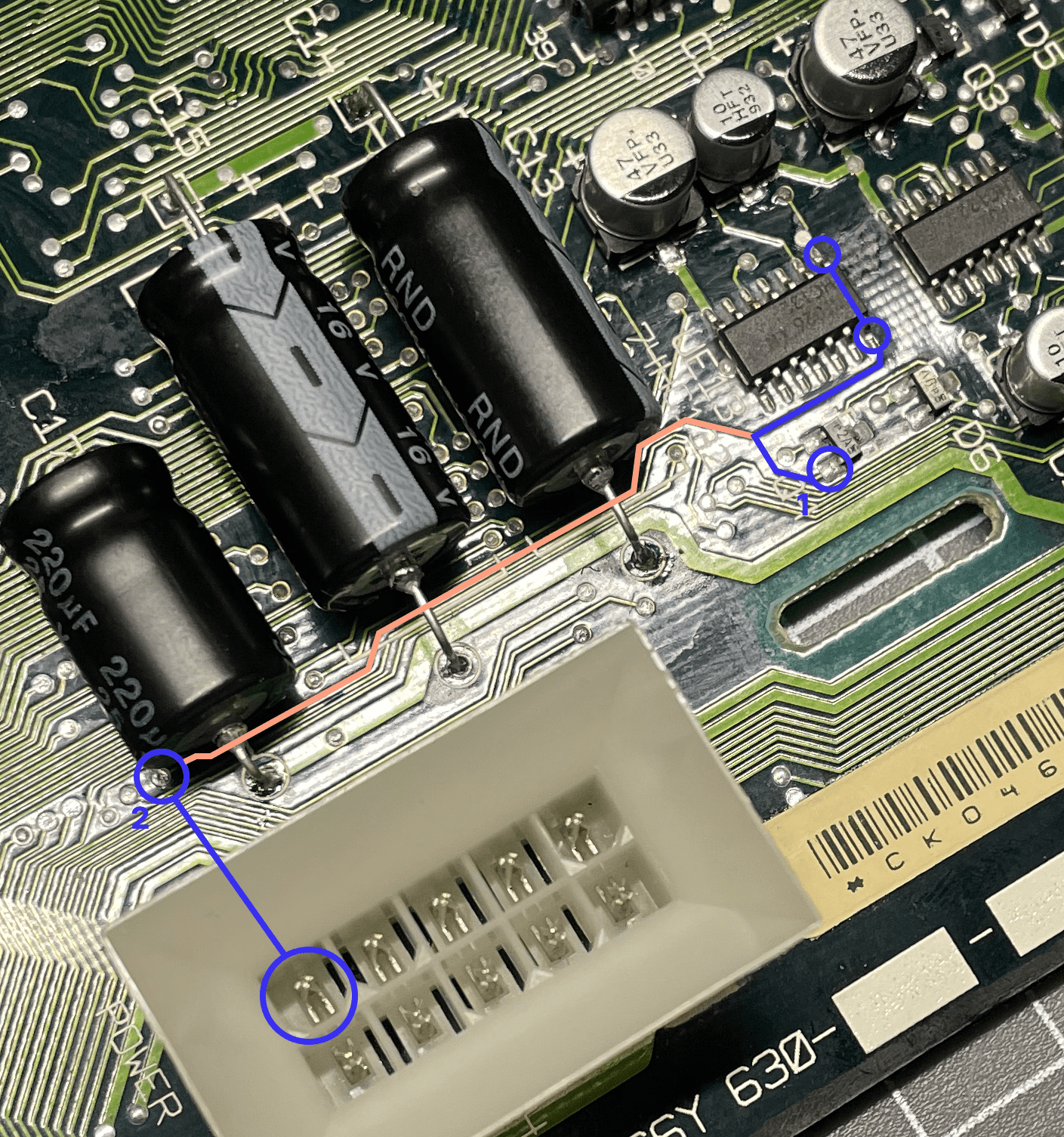

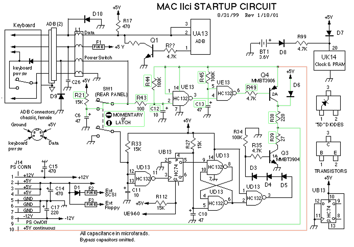

Having done a bit more amateur sleuthing and making use of the schematic @Hugotronics shared I think I might have found the break. There seems to be a break between pin 10 on the PSU socket and the rest of the circuit. Seeing as how, as far as I understand, pin 10 is the one providing the trickle power, it feels somewhat important. So, having potentially identified the culprit I needed to actually find the break, which I kind of did although I can't actually see it. As you can see in the image, I think all the purple parts should be connected but they are not. Q4 and UE13 are connected but they are themselves not connected to pin 10...which I think they should be...
Long story short, can anyone "confirm" my work before I add a bodge wire between 1 and 2 and accidently fry something?

Having fixed the break, the soft-power now works! At least in terms of the PSU turning on, and the LED on the logic board being green. However, I don't get a chime and no video as far as I can tell. One step at a time I guess. I'm using the same video setup (same cable, VGA-adapter and monitor) I use for my Quadra 700.
I'm assuming I need to troubleshoot the video circuitry, but again where do I start? Or could faulty RAM be the issue? Since the clips for the RAM-slots are plastic and probably brittle I'd rather not try and remove them unless there is a definite need to.
