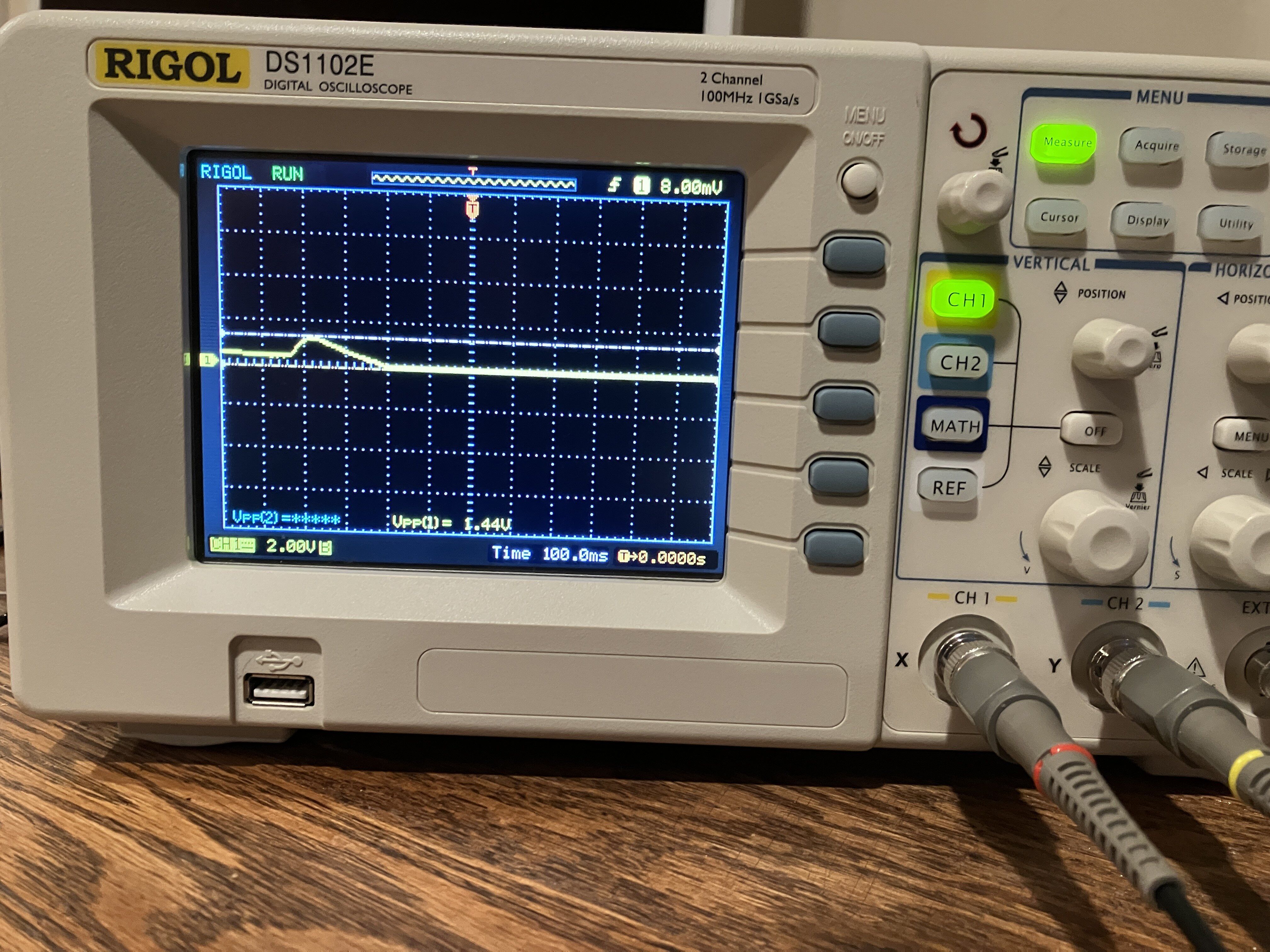

I am trying to debug this by looking at the Power On signal from the mac, while I turn the PSU rails on and off manually. With the computer on, pressing the Power button or shutdown from the menu causes the Power On signal to go down. The computer stays on at this point because the PSU is bypassing the Power On signal. But ... when I turn off the PSU (after the Power On signal is down) I see a bump in the Power On signal. I assume this is what causes the cycling when the Power On signal is controlling the PSU.
I am wondering if this bump in the Power On signal when the power rails go down is normal, or if there is a problem with my logic board. The bump is spread-out but gets sufficiently high that can trigger the PSU back on. I also notice that when the Power On signal is down its not all the way to zero. When the power rails go down, we see the bump and the signal goes to 0.

I have been getting a lot of fantastic help from TT design debugging this issue and I have managed to get the soft power off to work/
Adding a couple resistors that introduce a voltage drop in the Power On signal fixed my problem with repeated power cycling during power off.
I think this way the bump in the Power On signal doesn't trigger the PSU back on.
I also tried a suggestion from @Kay K.M.Mods here https://ameblo.jp/keroxiee1016/entry-12756425050.html
Putting a diode between the Power On signal from the mac and the PSU soft power circuit also fixes my problems with the soft power off.
I don't know if the bump in the Power On signal when powering off is normal, but at least these are working solutions :)
