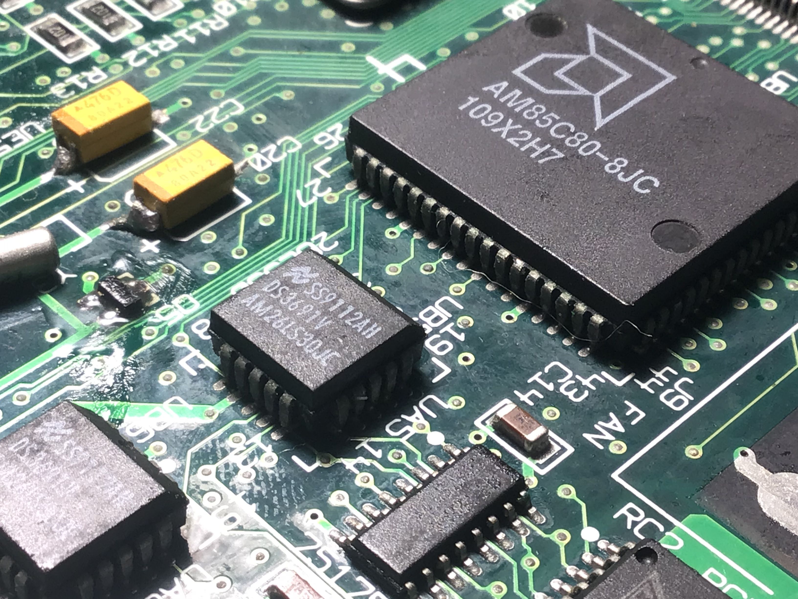

Now I’ve noticed some dark blue corrosion on the AM85C80-8JC and on the 26LS30 and from what I can tell on the schematic that chip being bad or not connected to the board would maybe give me the same problem. Going back to when the Mac boots I see that it resets once with a bunch of purple garbage on the screen then it boots into the flashing “?” on the floppy disc, now from what I can tell it only does it from a hard boot.

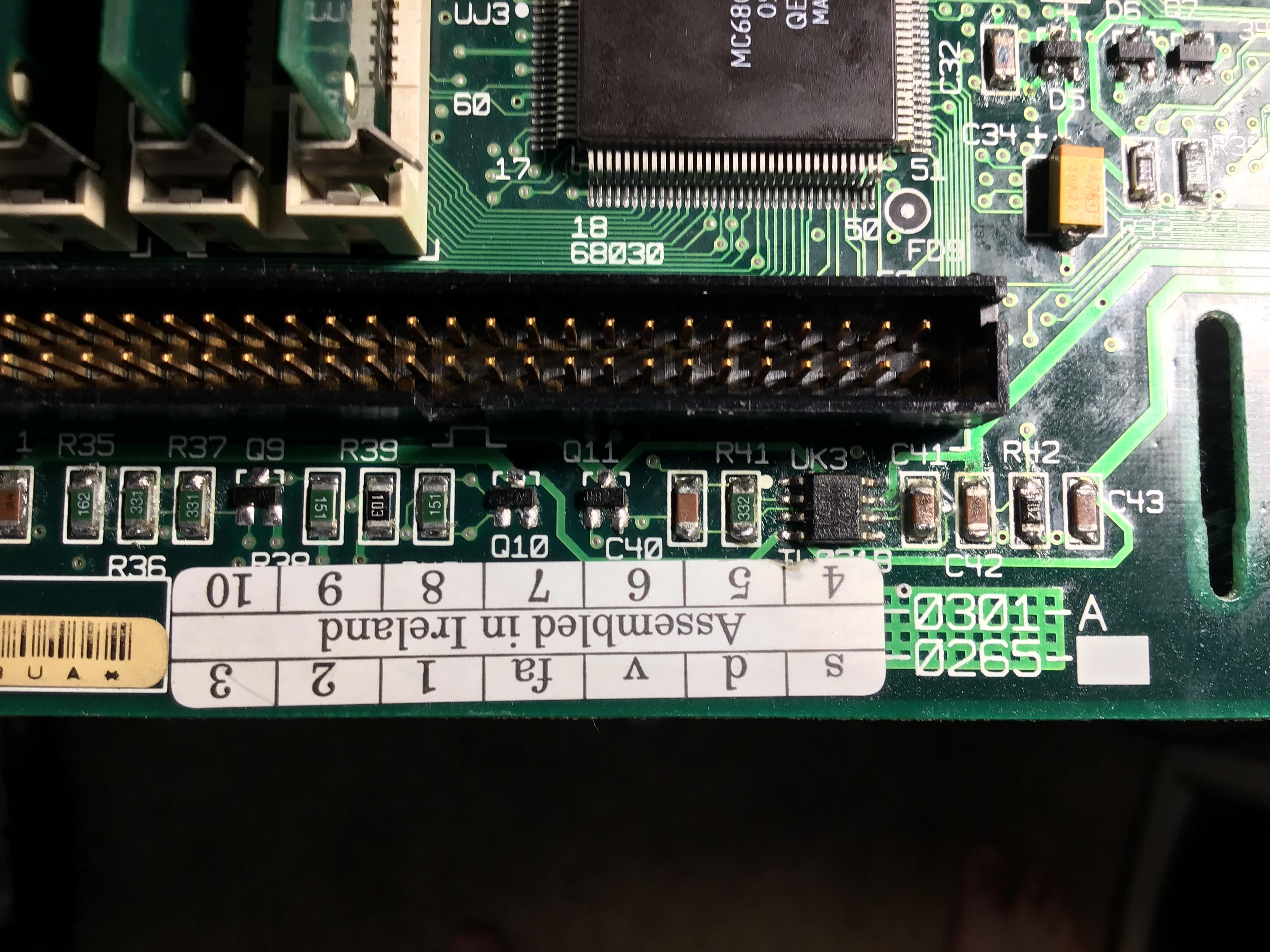

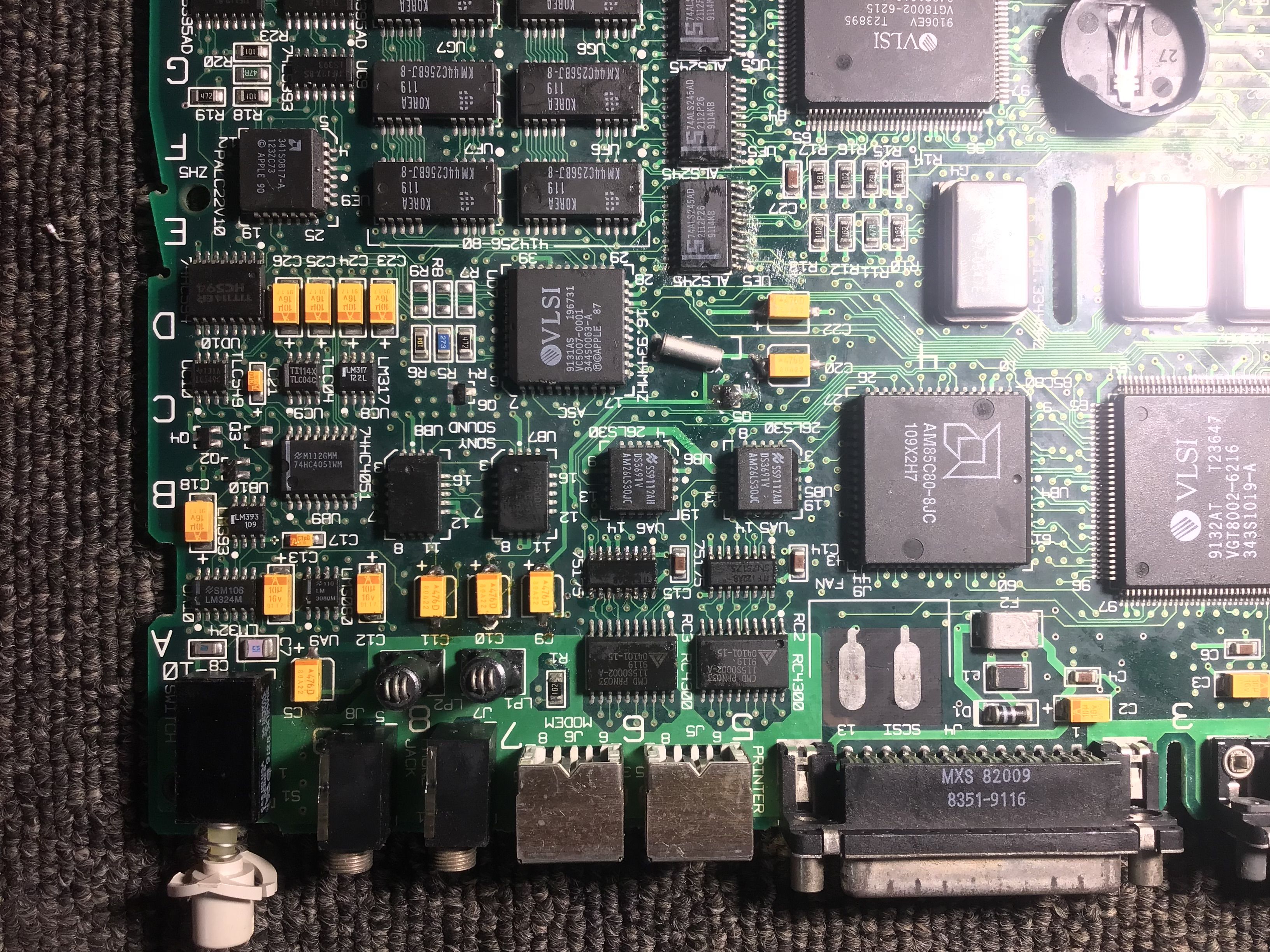

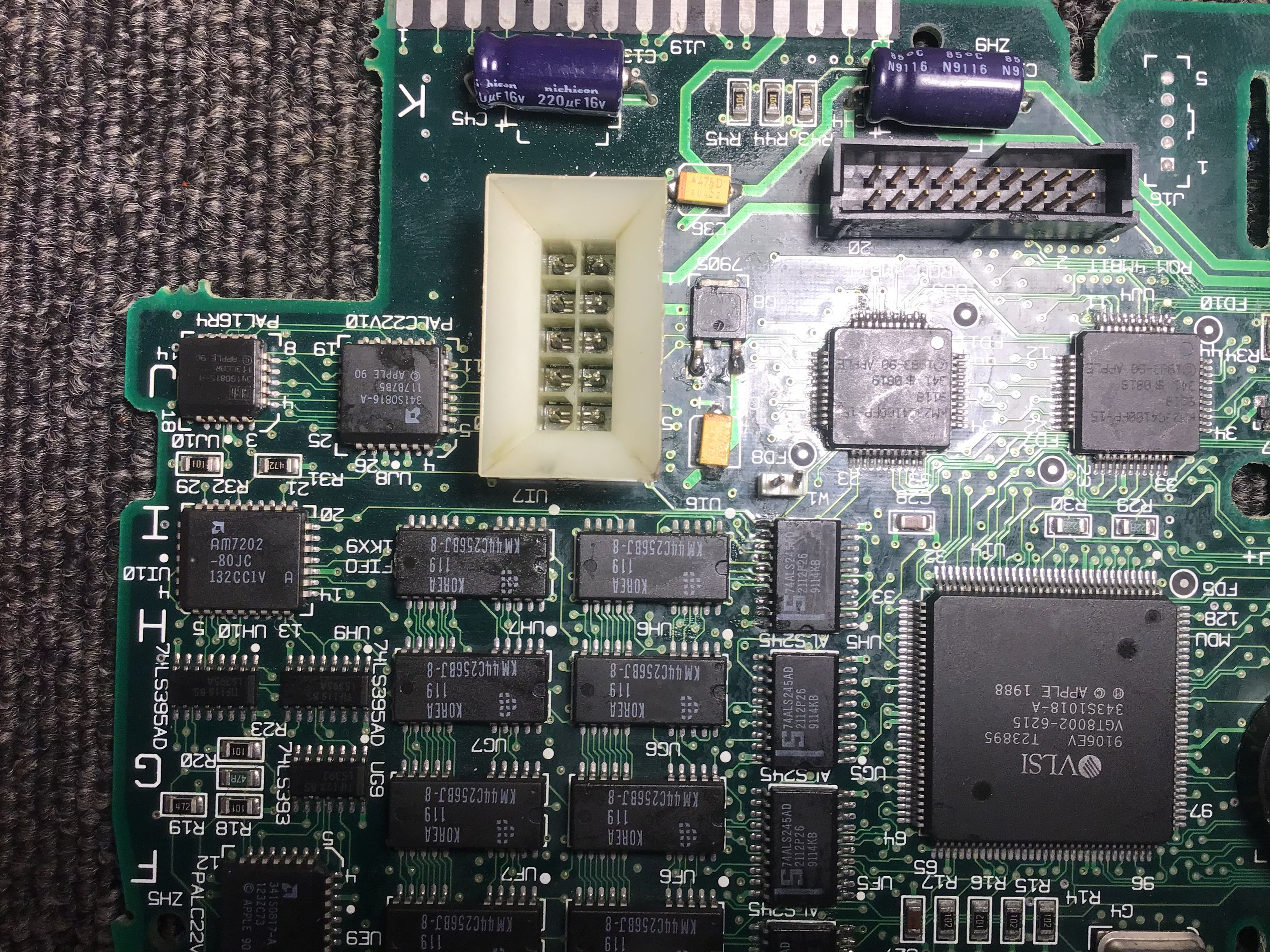

I have attached some pictures of the board when you can see my rough resoldering of most of the chips with nasty solder.

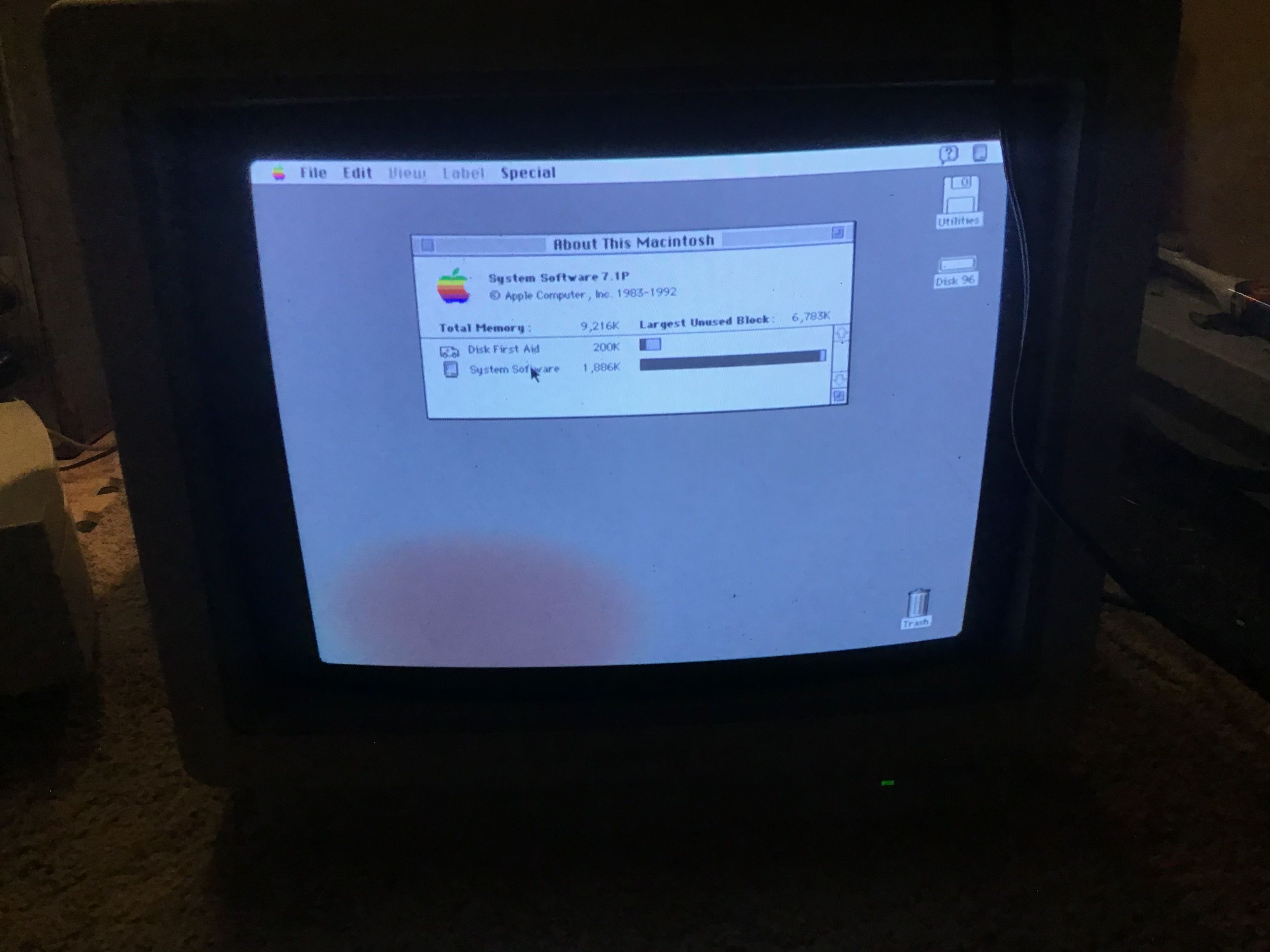

THE MACHINE IS HEALING.
There’s still almost no audio, but to answer you’re question I’m not getting just a crackle at the speaker but I’m getting a crunchy bong and with headphone I am getting perfect audio with no crunch so I’m guessing either the speaker needs to be looked at or the amplifier need to be fully looked over again.
The +5.4 was from the hard drive cable as the psu looks like it’s connected almost directly to it, loaded it’s around 5.2. I should take a scope to look at the voltage because I don’t fully trust the psu just quite yet.
The hard drive does not show up making me believe that the hard drive is bad or needs to be fixed, I’ve read that there is a piece of rubber that goes hard in them that stops the heads from moving and that quite a few people have been able to fix it. But good news is my ZIP drive is visible.

I was really hoping this wasn't the case but the speaker is dead.
I measured across it with my ohmmeter and it was open. If anyone has one from a dead macintosh let me know, from what I've read its supposedly 63ohm and 0.25w. I found one listing that was for a clear macintosh SE/SE 30 but it's only 8ohms.
On the bright side I got a good disk image onto my bluescsi and the machine fired right up! I'm really impressed with the performance of it. The only issue I've had was with Mactcp trying ping the outside world, the pico is connected to wifi but the mac wont ping to 1.1.1.1.
Anyway if anyone has a speaker for a Macintosh IIsi, Classic, or Plus please let me know!
