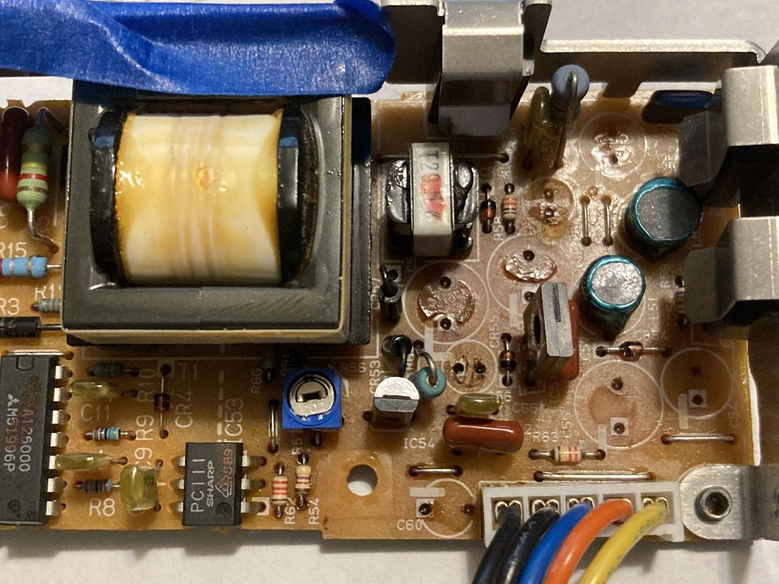

I found a "project" Macintosh LC (1) listed on CraigsList as "makes a clicking sound but no video, no HD" for US$20. Took it home and removed the power plug from the motherboard. Powered on the PSU and got some abysmally low values on the power rails. Dissembled the PSU, saw some leakage and removed the 8 typical caps.
Soaked and q-Tip'd it a bunch and let it dry for an hour. I recapped the PSU with caps I had on hand (not the correct values, but larger). Powered on and got good 12V, 5V, but only -4V. Close enough? Put it back in the unit and powered on.

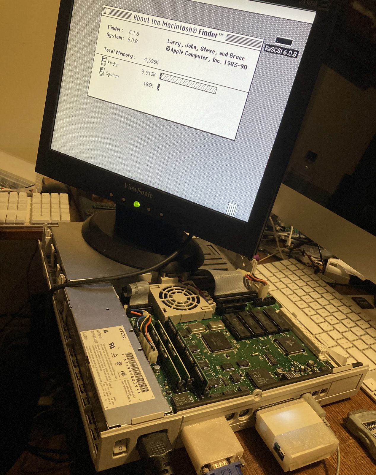

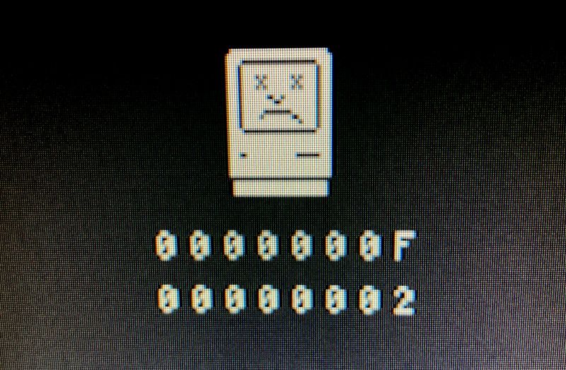

Oops, that was 7.6. Found a 6 image and it's GOOD! Add one more to the collection.

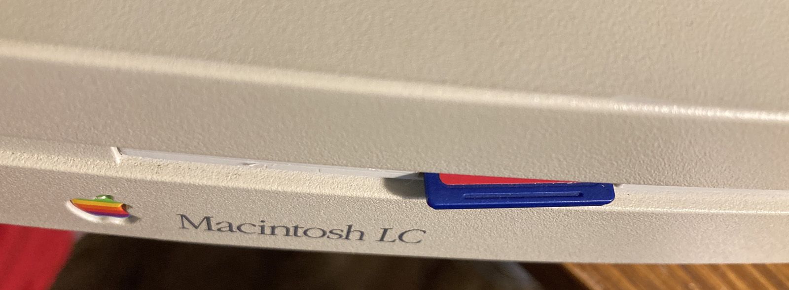

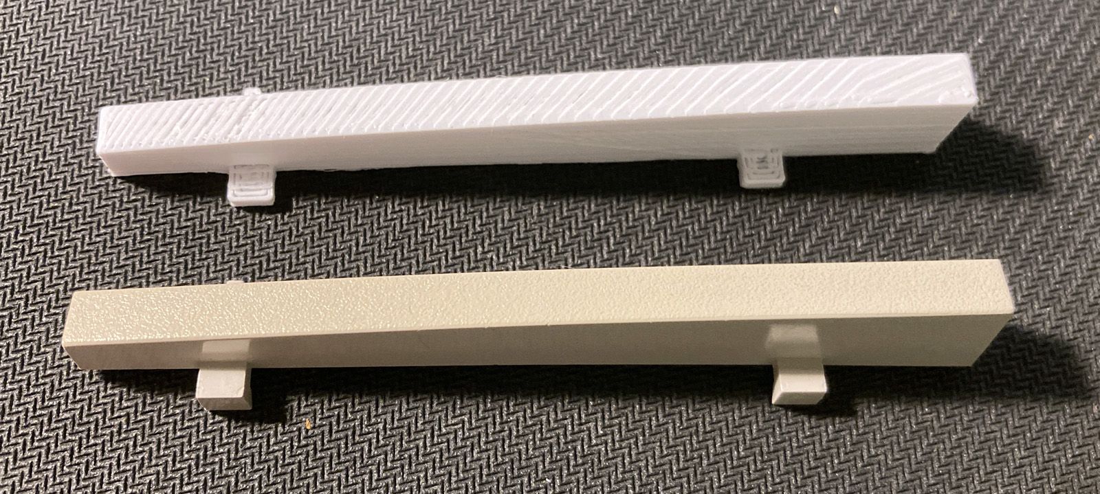

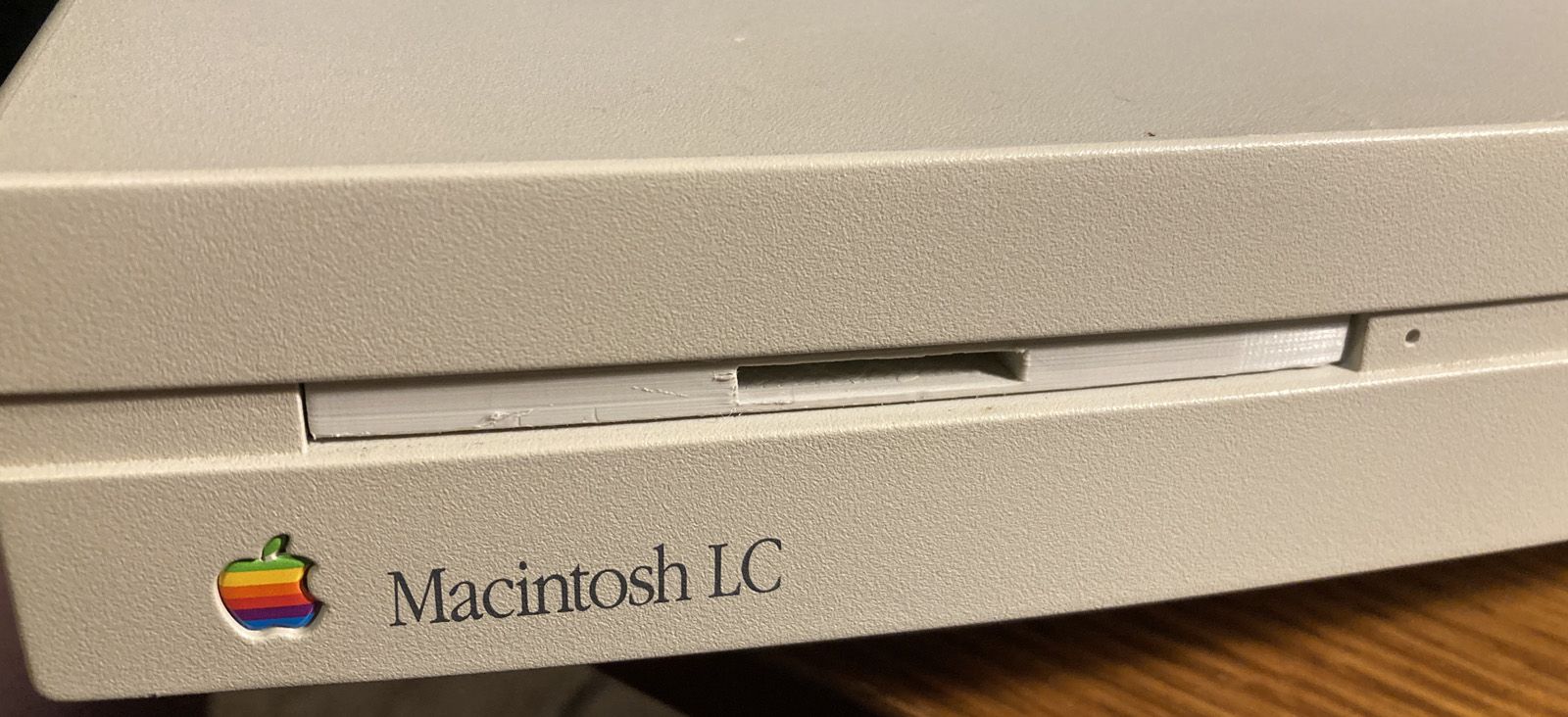

I looked around for BlueSCSI v2 mount for an LC 1, but could not find one. I wanted the SD card to come out the front instead of the rear. So I started with replicating the left front floppy cover first. Printed in white as a test.

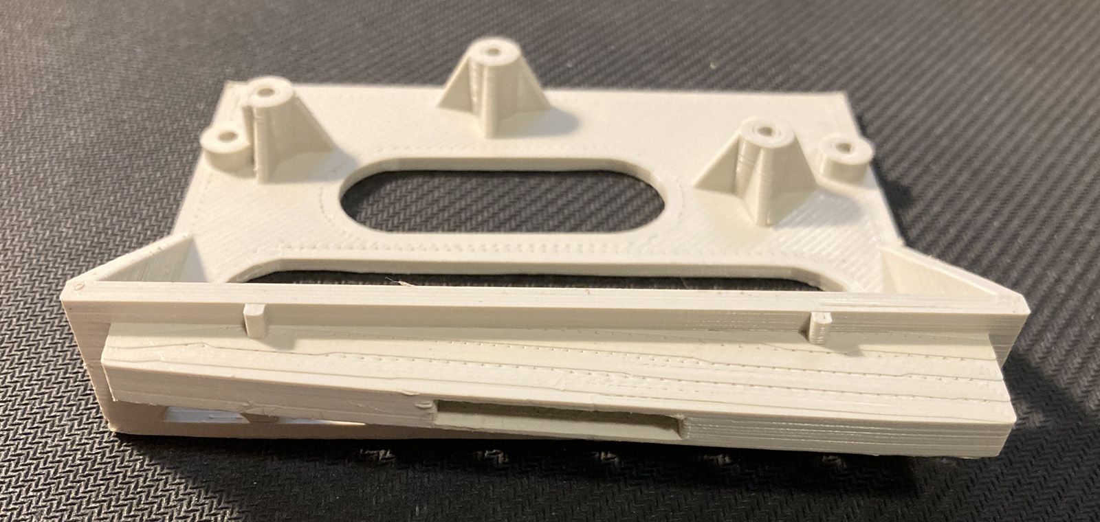

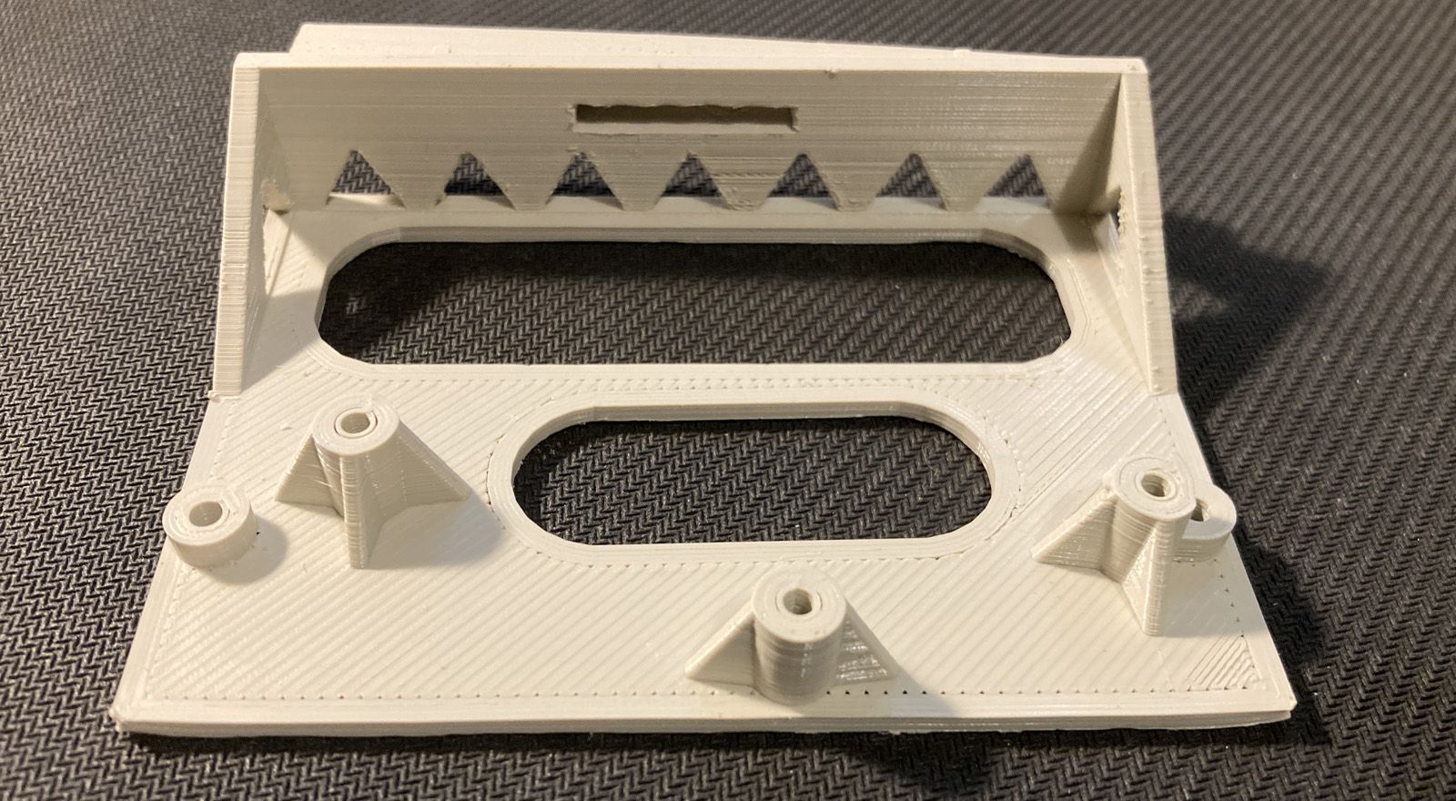

Then I found somebody else's 3D model for a BlueSCSI v2 mount and modded it to fit my needs.
From the back.
Just some crazy holes to reduce filament usage. I see I had some adhesion/curling issues on the corners. They won't be seen.

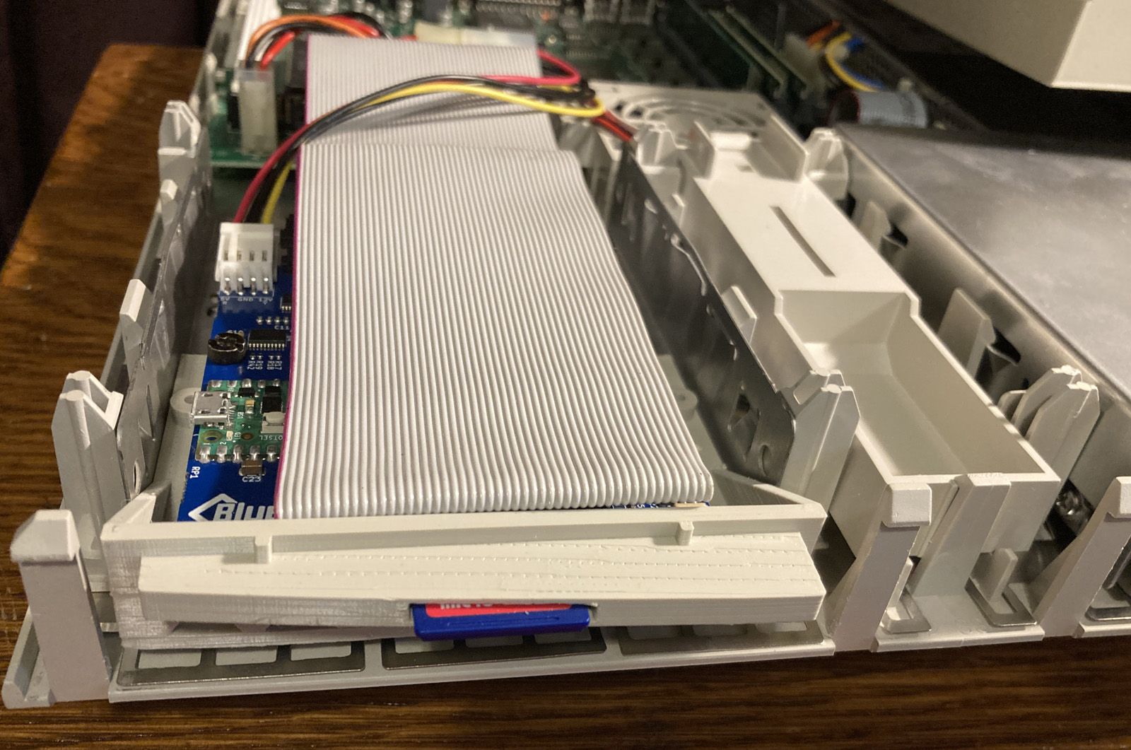

This mount puts the BlueSCSI v2 very far forward, and the stock SCSI cable is just a little too short. All I had was this super long one. But it still works.
And from the top, the card barely sticks out enough to grab, but does not extend farther than the front center of the case.

My experience with the pizza box LC PSUs is that they need some load to regulate power properly. Without it you tend to get screwy values. Might not be all but some that have crossed my path on the occasion behaved funny if powered on without load but if connected to the board were rock solid (didn't bother testing any of them until after recapping since they tend to be on the cusp of getting leaky).
