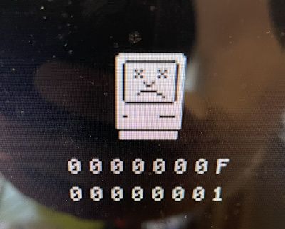

The drive showed the following start-up error:
Which I think it a software error... I think that it was from a PowerPC and therefore could not run on the 68k CPU

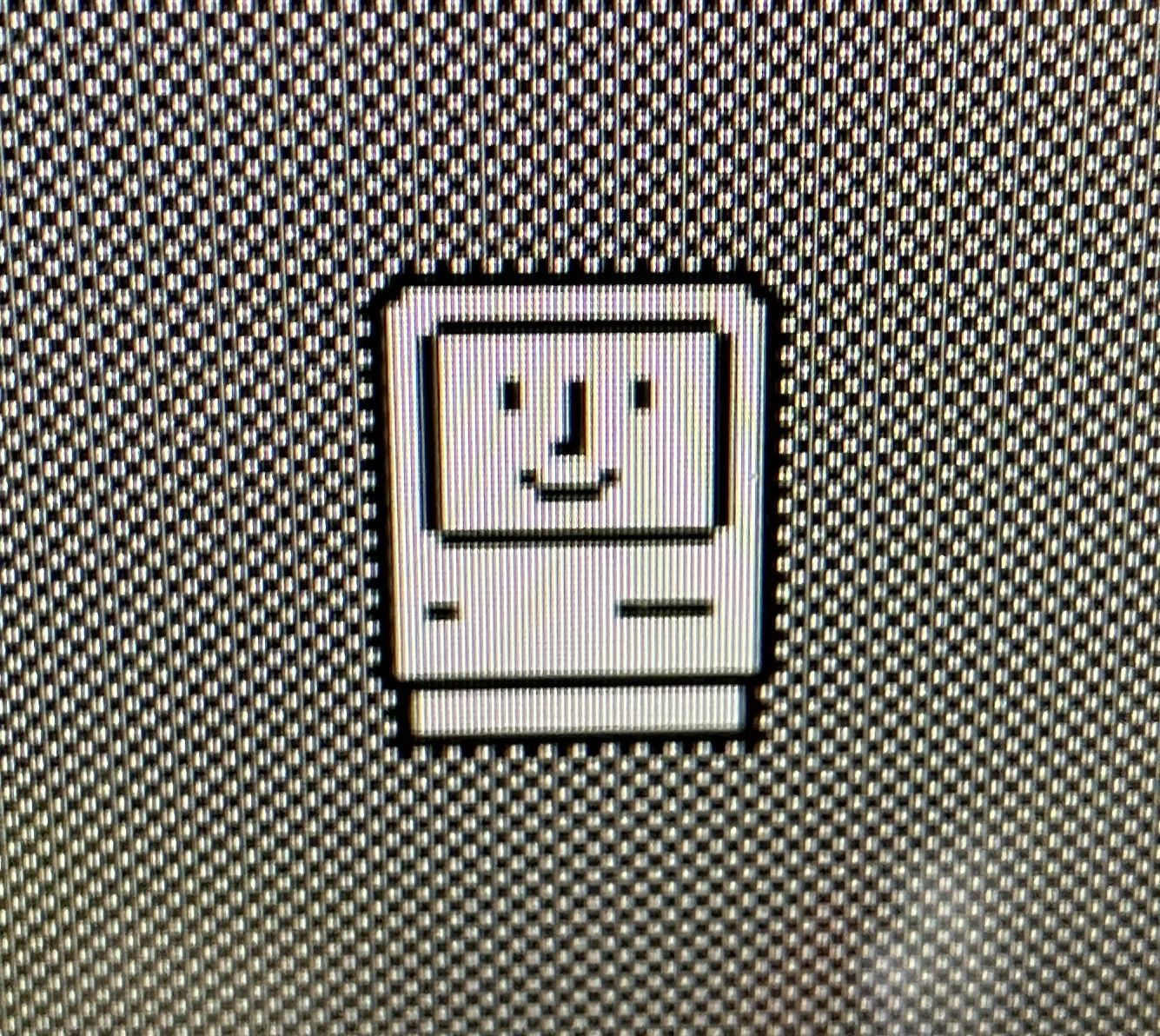

Using either the internal SCSI or floppy it starts ok and you get the friendly screen.
Starts to boot but within a couple of seconds there is a click from the speaker and it restarts.

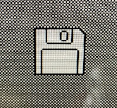

The next screen shows the floppy icon with flashing ?
So you get this:
And then:
