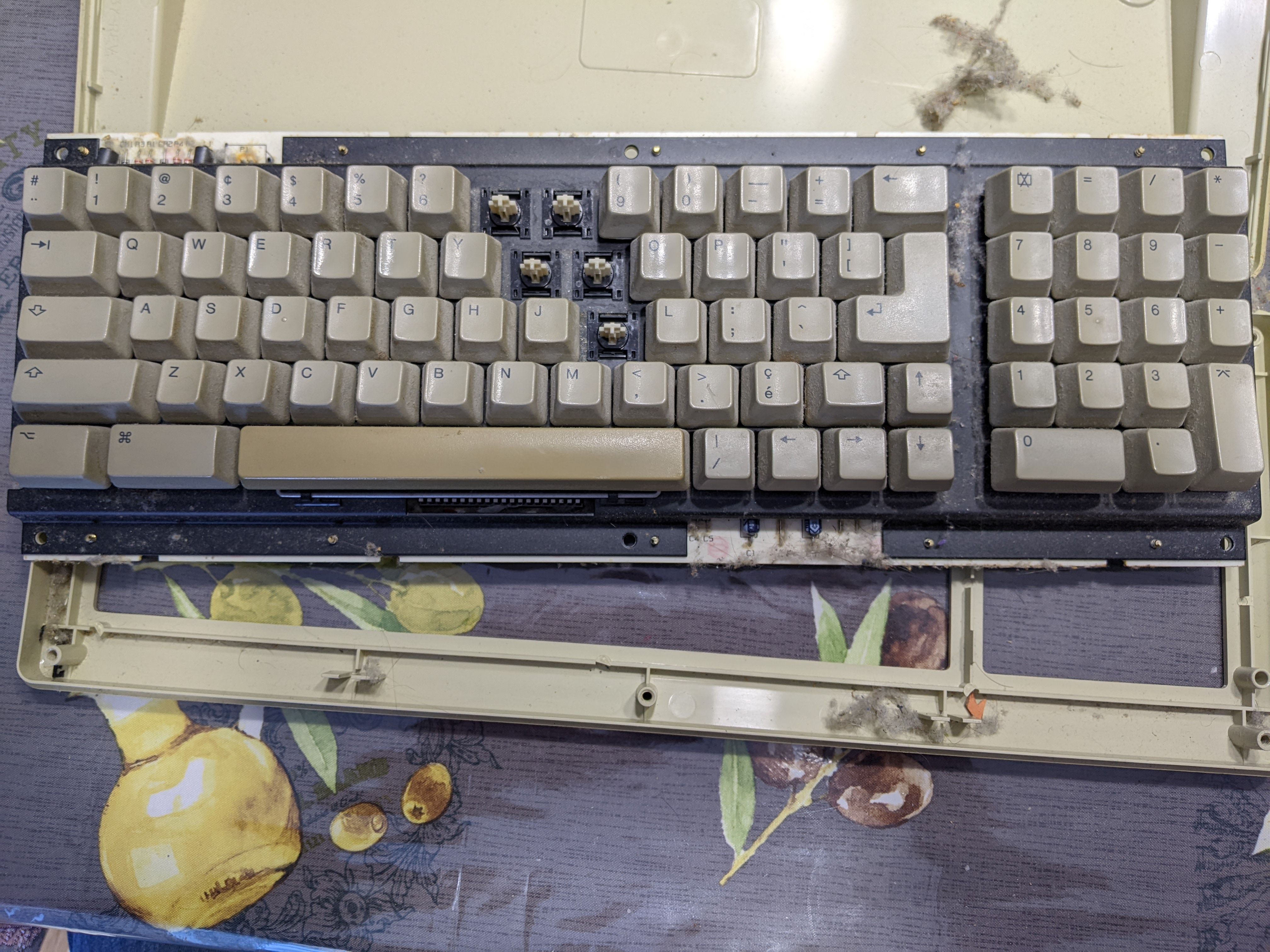

I have two of those, the original one from my childhood, and a platinum style one that I bought used from around 2005 or so. The latter works flawlessly while the former has some problematic keys.

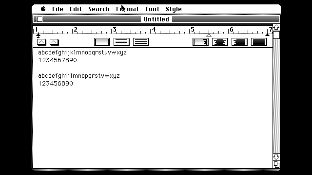

Here's a direct screenshot (thanks RGB2HDMI) of the full alphabet and numbers test (top: working one, bottom: faulty one)
As you can see, the letters K and U as well as the number 7 don't work. Are they part of the same line in the keyboard matrix? Where can I find the schematics of this keyboard before I open this up?
I tried to spray some contact cleaner and press the keys a bunch of times

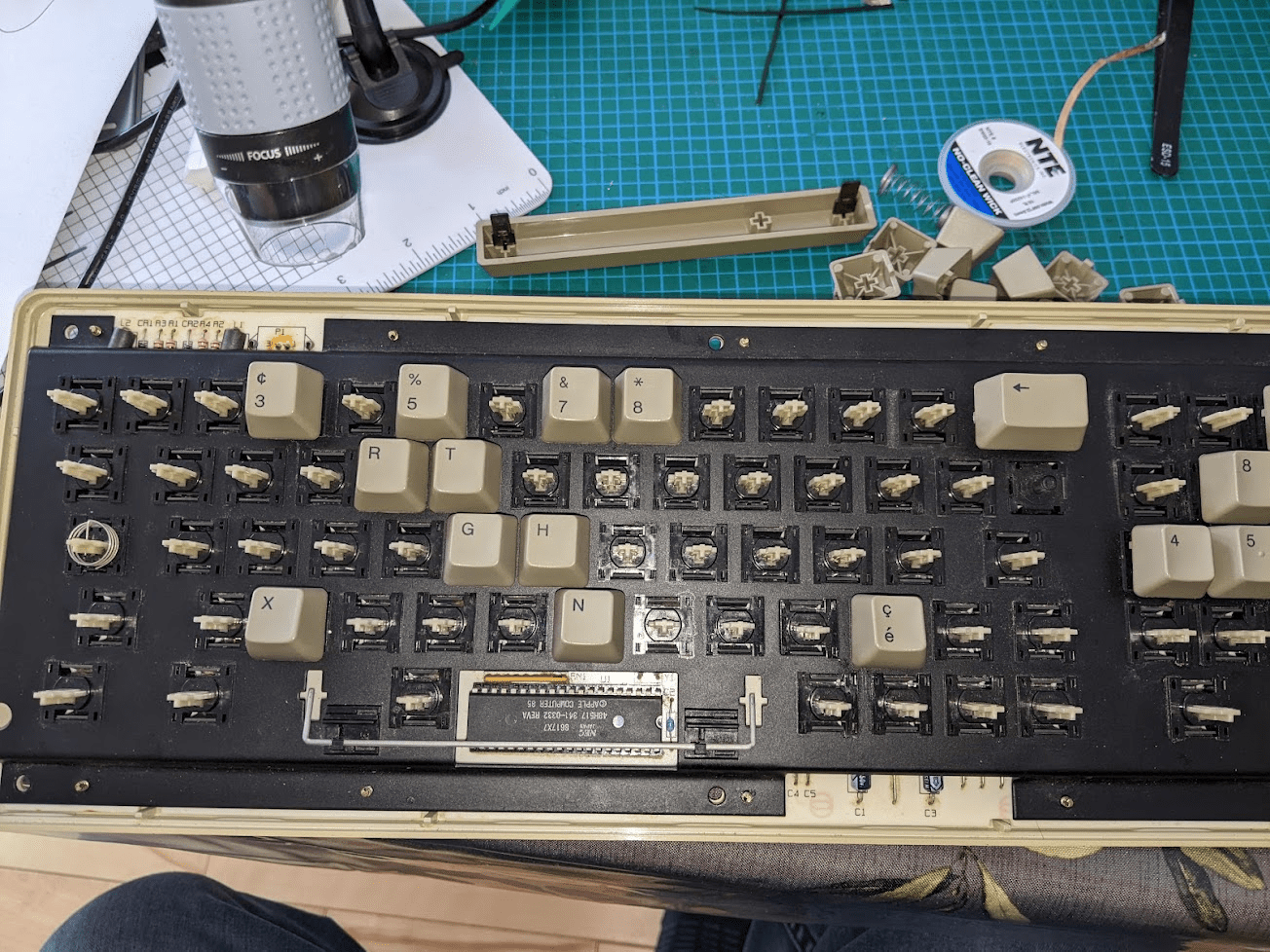

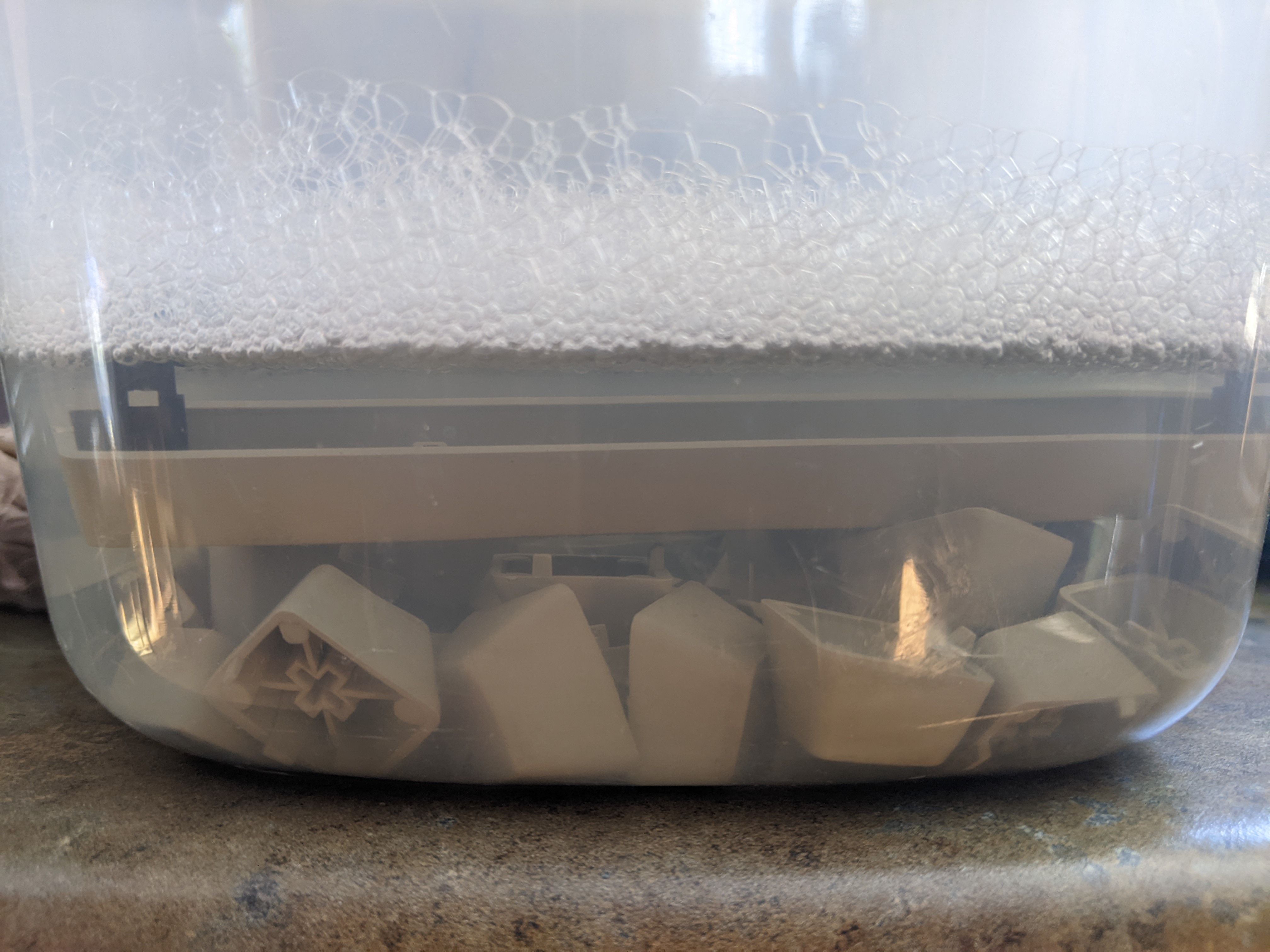

I'll give it a massive overall clean before I continue.

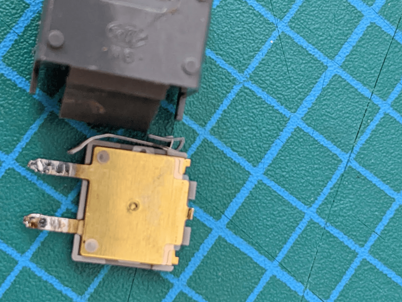

After doing a surface clean and getting as much gunk out without desoldering every key in order to access the pcb from the top side, I got out the '7' (non numpad) out by desoldering it and it seems to act totally normal when I test out the resistance across the pins (I'll post a video on the next reply)

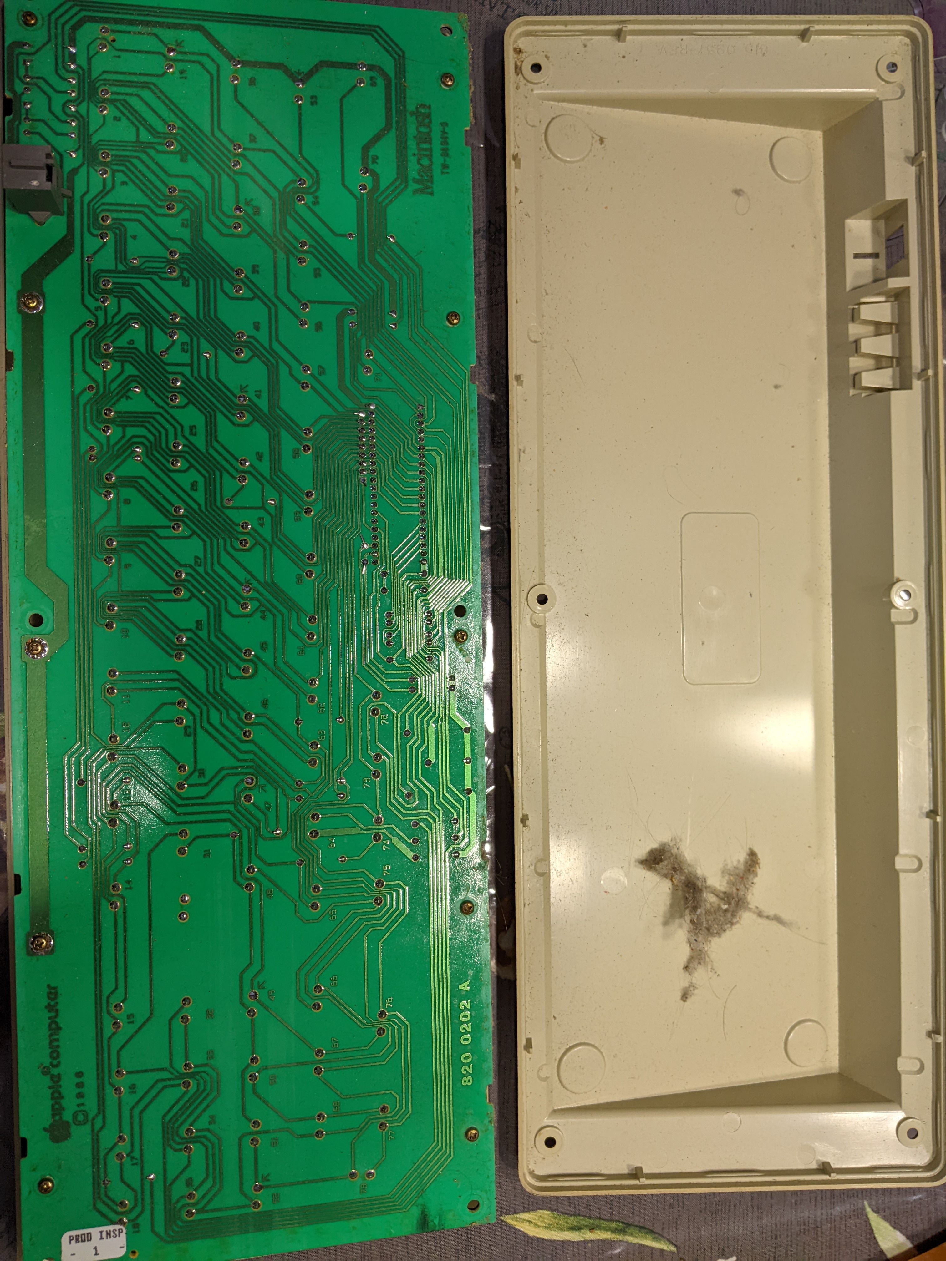

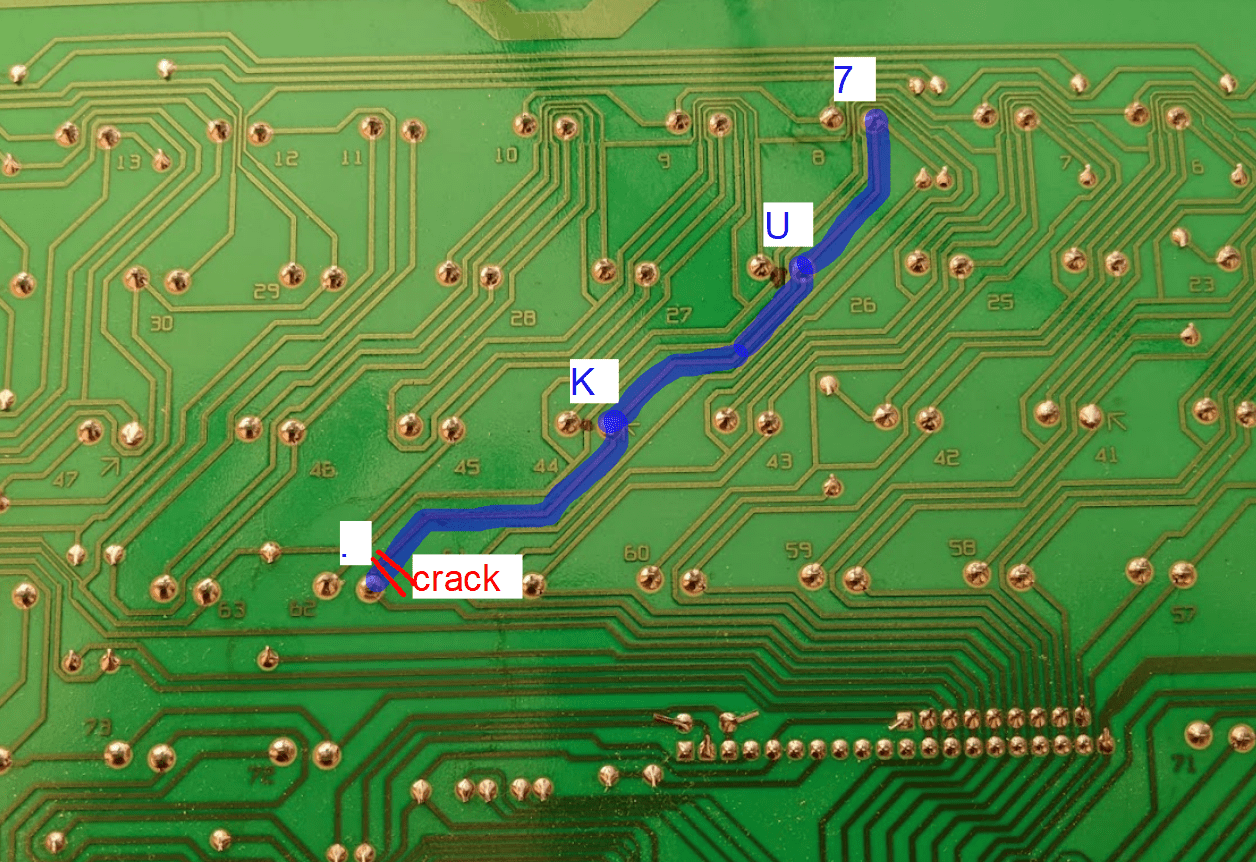

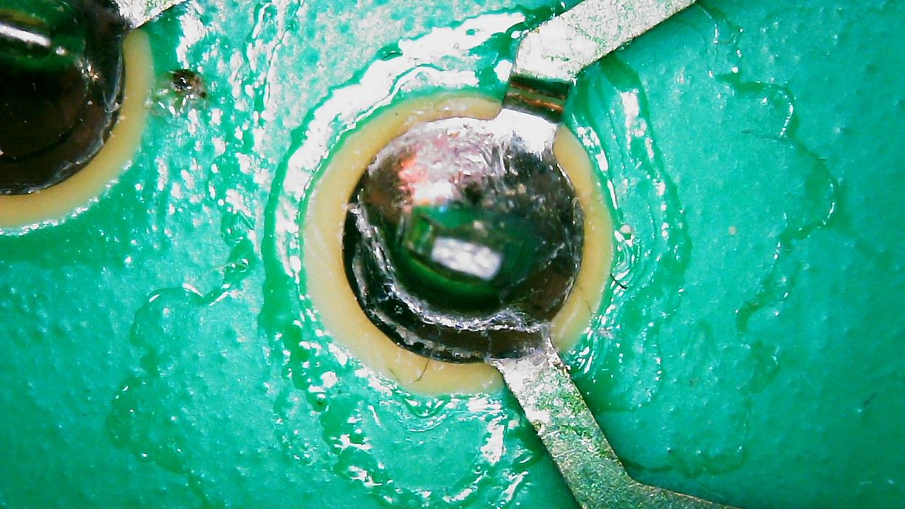

I'm thinking there may be a problem somewhere on the board, because there are shared traces between some of the problematic keys, but I dunno. There are 3 such "strings" if it's that.

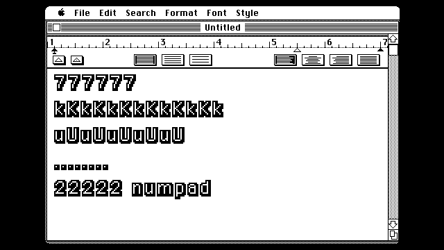

Faulty keys as of now:
7 K dot, numpad 4 and numpad 2 don't work. A is intermittent. N can get stuck and ghost repeat.

Normal behavior of a keyswitch when it's out of the board. It didn't work when it was in the board, doesn't work now that I've soldered it back.

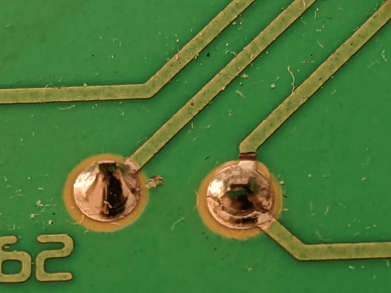

Good eyes! That thing does look like it got torqued a bit - that trace leading into it looks like it just popped apart due to stress. I've seen cold solder joints, but not a snapped trace before. Glad you found the issue!

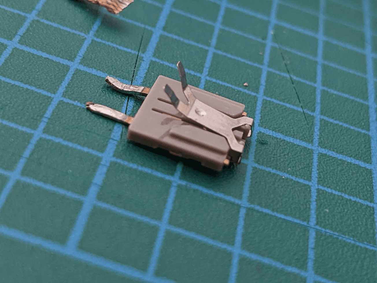

For the other keys that weren't part of that sequence of traces, I had to tweak the conductive part that gets pushed to establish continuity when you press the key. I found this video which greatly help:

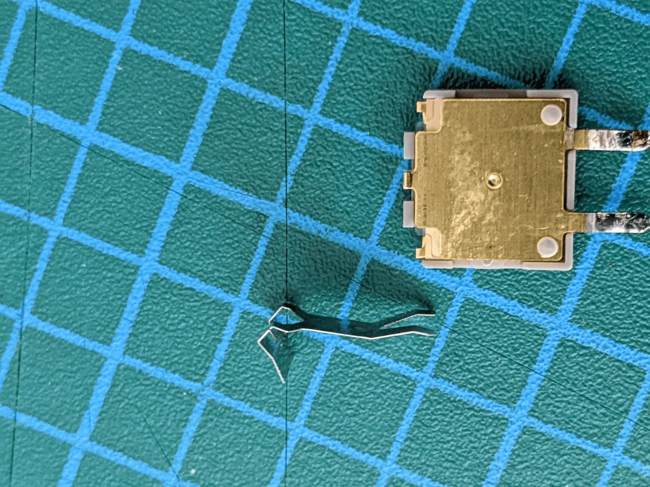

The part of a non-working key looks like this when it's removed:
This is how I looked after I squished the "shoulders together and brought out the "coattails" out - keep in mind that this new shape WASN'T enough to fix the issue:
I had to go way more all out to get it working:
