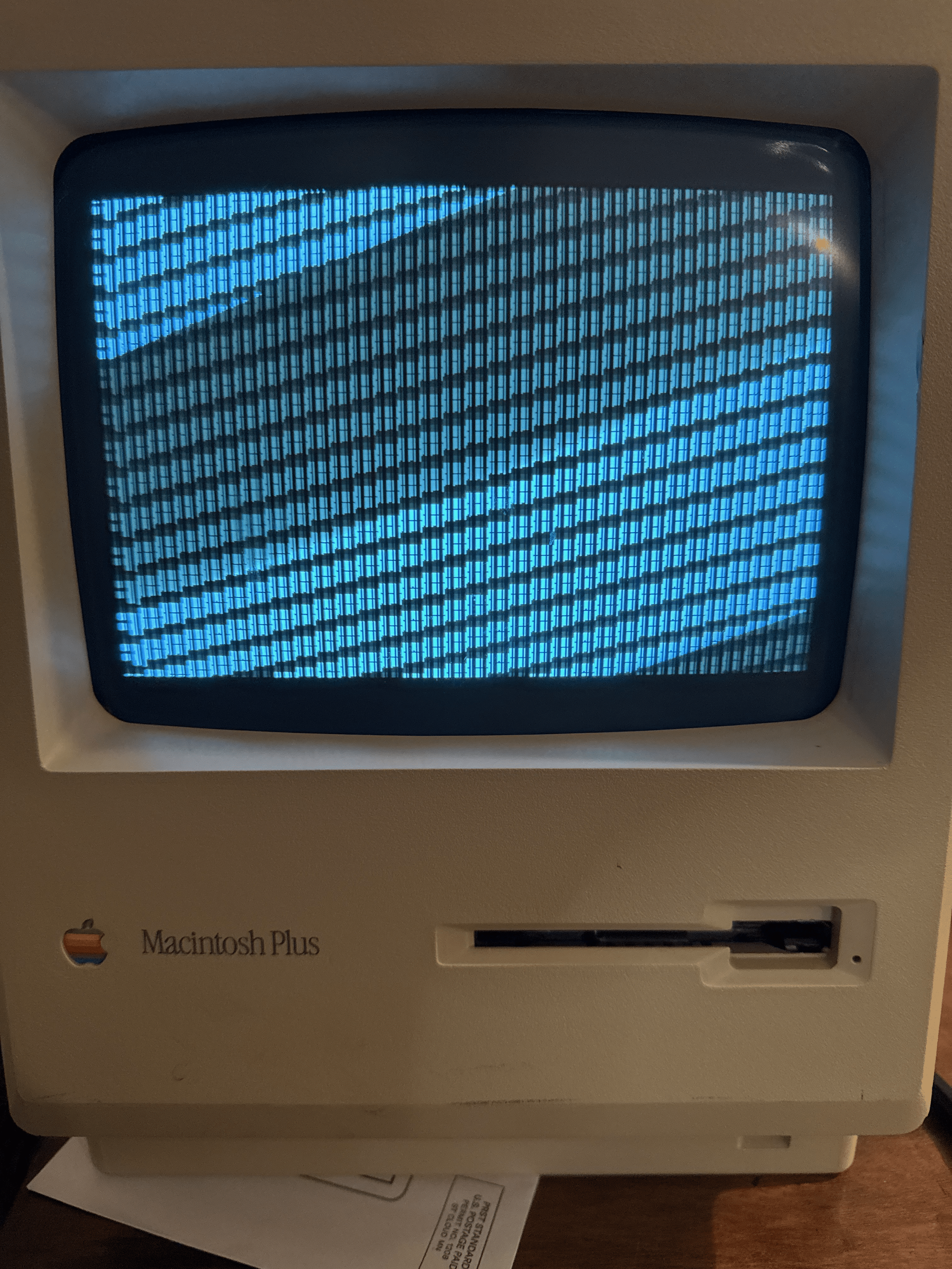

I recently acquired a Macintosh Plus that I knew would need repairs. I have already rescued a 512k with success.
At the start, it was clear that the Mac was unhappy. The symptoms as I received it are as follows:
* The startup beep is a low frequency buzzing sound. The length of the beep is about the same as a normal chime.
* The screen is filled with this pattern. It "blinks" and rolls vertically.
What has been done so far:
* Complete recap of the analog and digital boards. Using the kit that console5 sells. Each capacitor is done individually and polarity is carefully confirmed.
* Reflowed the solder on the various harness connectors.
* Swapped RAM around.
* Reseated the ROMs with Deoxit on the sockets.
* The voltages at the floppy port are within spec. 5.01vdc and 12.11vdc respectively. The -12 matches the +12.
Because of the unusual layout, I have not tried to test reset circuits. Nor I have I tried to scope data and address lines.

That distorted sound reveals something isn't being read correctly. If the chime is the right length but the wrong frequency or texture, it suggests the CPU is executing the startup code, but the data being fed to the sound buffer is corrupted.
Replacing those original single-wipe sockets with high-quality turned-pin or double-wipe versions is a highly recommended insurance step. It rules out mechanical failure before you start chasing phantom logic bugs. Also, if you have access to an EPROM programmer, it is worth verifying the checksums of those ROM chips. Internal bit-rot is rare, but it isn't impossible.
Since you are using two 1MB SIMMs in the lower bank, you'll want to ensure the RAM SIZE resistors are strapped correctly for a 2MB configuration. If the board is still strapped for 1MB (with the 256K bit resistor installed), the memory controller glue logic will miscalculate the addressing.

@Builde68 You've nailed it. I hadn't considered the ROMs might be at fault. I pulled the ROMs and put them into my tester/ripper and the LO rom is testing bad! (As in completely unreadable)
I've got two new 27C256 EEPROMs on the way and will burn some new copies this evening and report back.
I'm also going to take the opportunity to replace the single wipe sockets with some nice turned pin sockets.

The screen pattern is unusual for a Macintosh Plus. Let's hope the problem isn't in the glue logic, as that is complicated to diagnose. The 74253s and 74257s are the prime suspects; they multiplex the address lines for the RAM for both the screen display hardware and the CPU. To me, it looks like an issue with the address bus. If the data bus were corrupted, you should see at least something on the screen, such as scattered pixels or thin vertical lines.
Thanks for the tips. I at least know where to start with the scope.
Success! Well almost success.
Replaced all of the 253s and 257s. Nope.
Replaced the BMU2 and TSM chips. BINGO!
Now the only thing left is that startup sound is still the low frequency buzz which makes me think it might be something on the analogue board?
