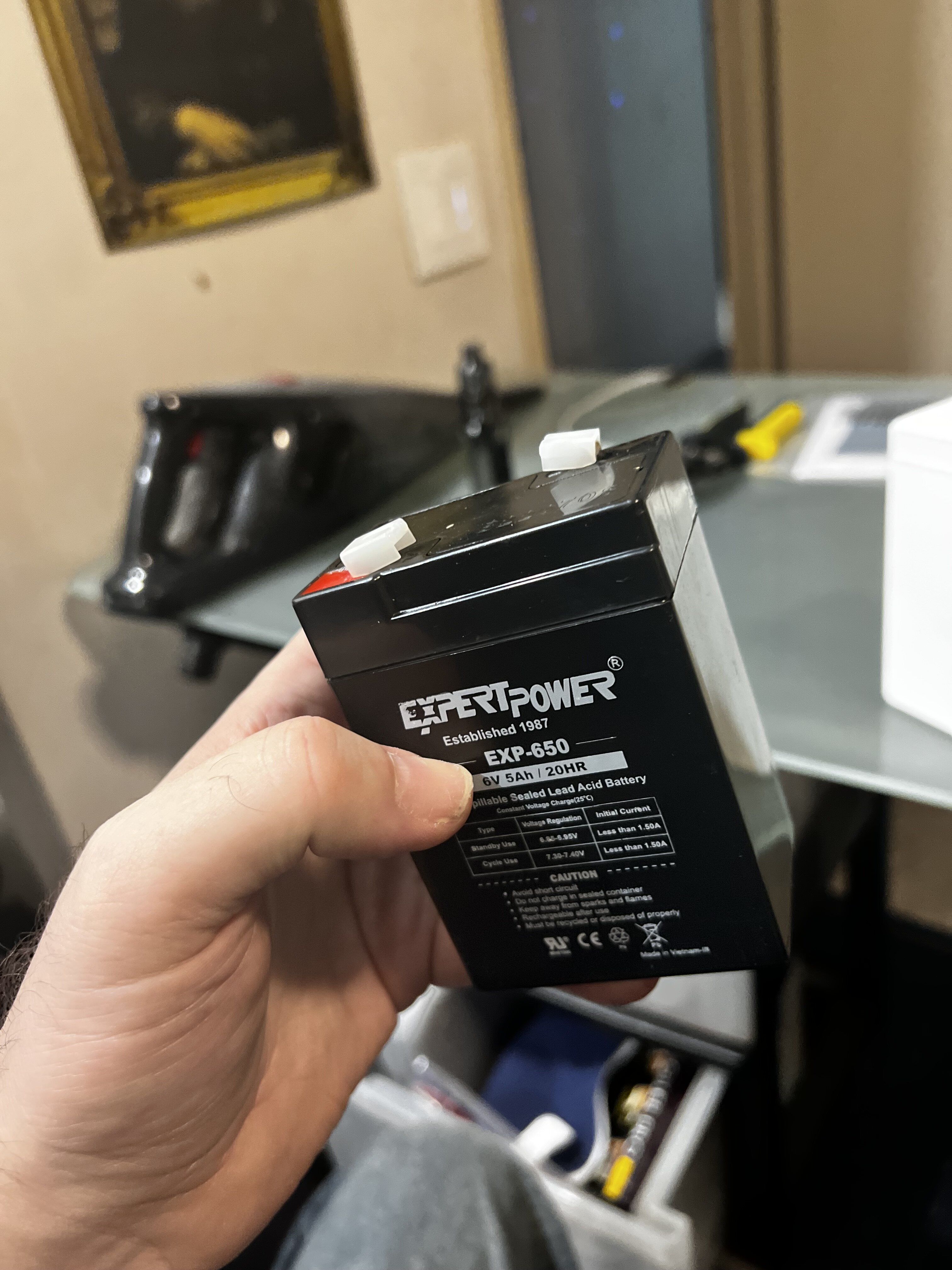

This project was created to allow current rectangular 6v lead-acid batteries with spade terminals to be used as a Macintosh Portable battery in a cost effective manner. This is achieved with a spacer made of plastic or cardboard and PCB for the battery contacts. The lead-acid battery is then connected to the PCB via wires with female spade connectors.
The spacer and PCB is sufficient and the cheapest way to use a 6V lead-acid battery in the portable. This is useful for testing since the battery can be easily swapped.

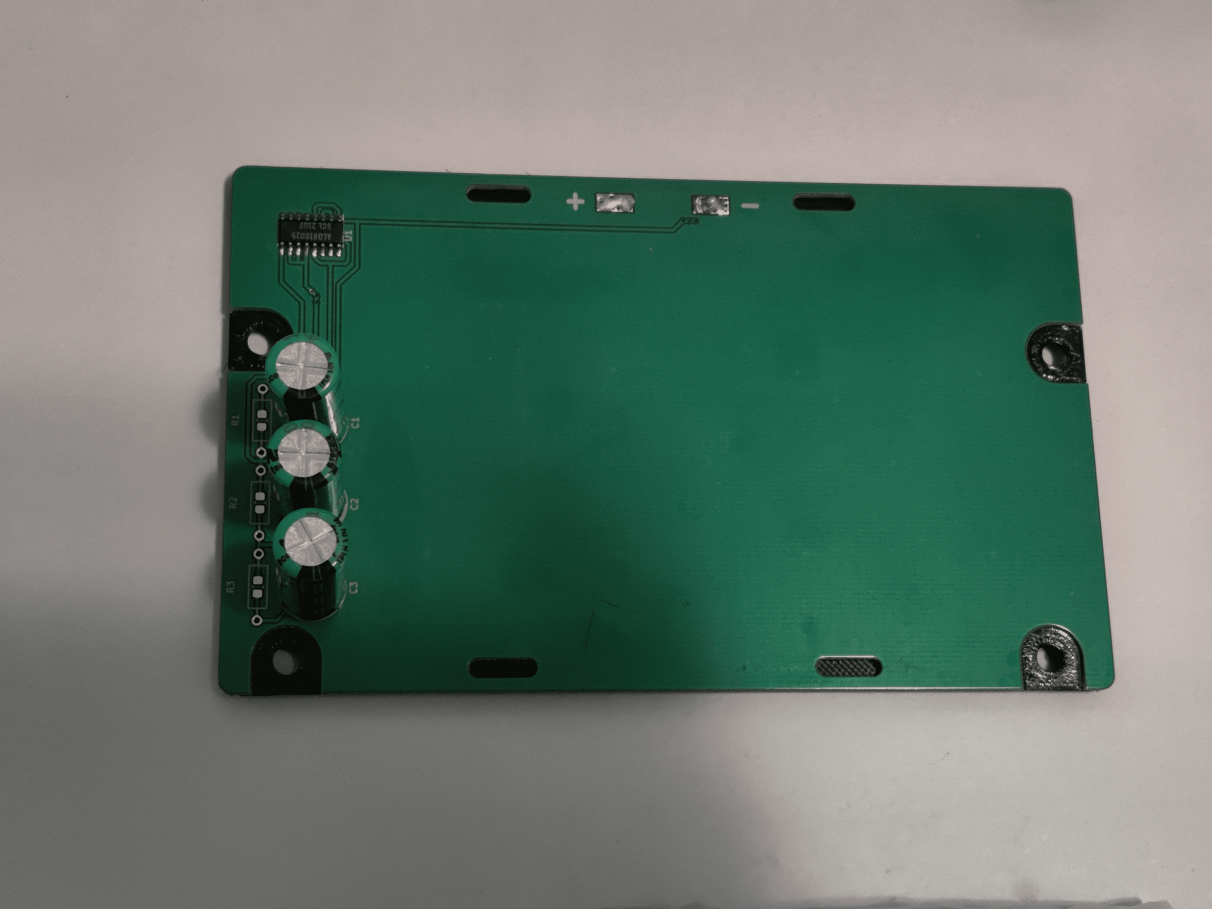

This version adds supercapacitor support to the PCB. This will allow you to run you're Macintosh Portable with no lead-acid battery! The supercapacitors cover the brief power spikes during hard drive spin up and such that the battery normally handles, so the computer won't shut off when running off the adapter. Supercapacitors are not a substitute for a real lead-acid battery. You won't be able to run without the AC adapter connected. Another difference is that it takes a few minutes for the supercapacitors to charge up before you can use the computer. You can still use a lead-acid battery along with the supercapacitors if you want to.
The supercapacitors need to be balanced since they are used in series. I give two options on the PCB. The best option is to use ALD810025 which is a purpose built supercapacitor balancing IC. The ALD810025 will prolong the life of the supercapacitors and has very low to no leakage. The cheaper alternative is to do passive balancing with resistors. Zener diodes can also be used but I haven't done the calculations to know what the appropriate rating should be. If you're interested in the different types of supercapacitor balancing here's a wonderful PDF by Würth Elecktronik that explains it all.

Ok just finished updating the git repo with the info for v1.2 with supercapacitors.
I've tested only with a M5120 with copying between the floppy and mechanical hard drive. If anyone is able to test on a Macintosh Portable with backlight (M5126) let me know. Pretty sure it will be no problem but would like confirmation.

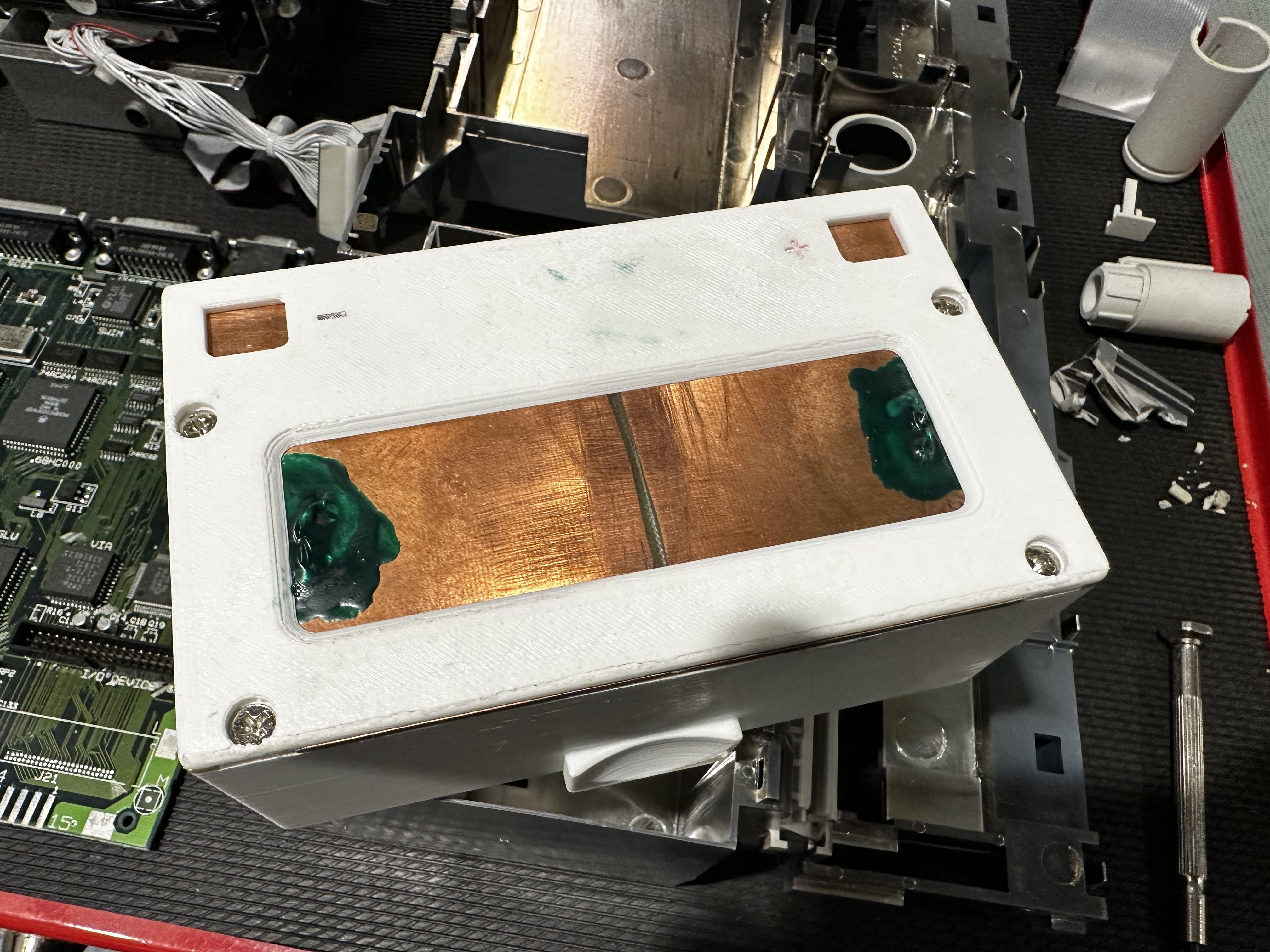

I just made my own. You don't need anything fancy honestly... this went into my Portable over the weekend for the first time and it works a treat. A sheet of PCB, two holes for the wires, and then I hacked the copper down the middle like a caveman! :)

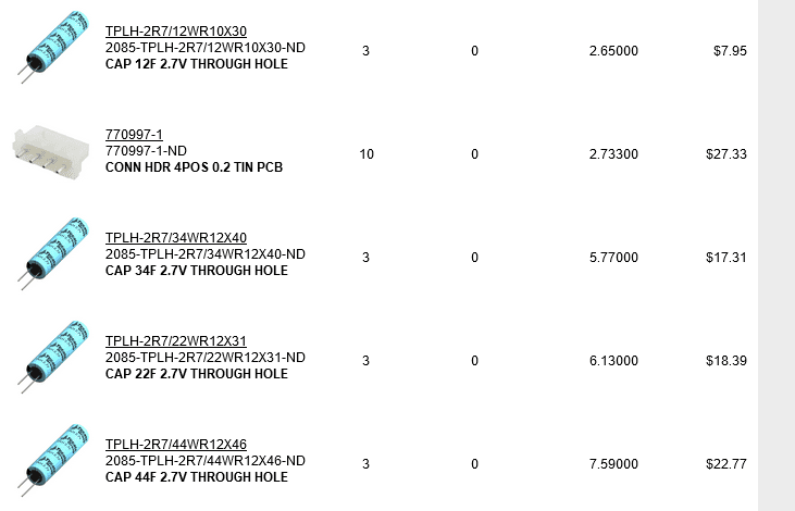

Just an update about the using supercapacitors based on recent tests. It seems like using 6F or 10F supercaps is not sufficient to spin up newer SCSI hard drives with higher current draw.
The original drive `CP-3045` 40MB is alright and another `IBM-H3171-S2` 160MB drive worked alright, but when I tried my `Quantum Fireball 1280S` 1.28GB drive it would not work.
I just bought a bunch of higher capacity supercaps to test. The price increases quite a bit for the 22F and up.
We'll see what works ... or not 😅

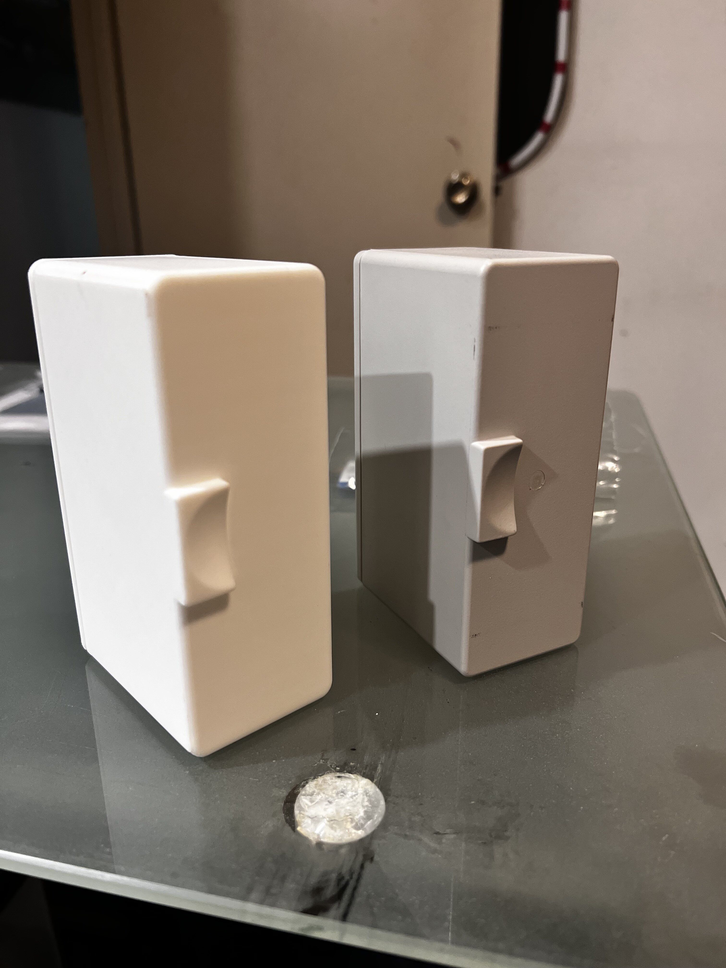

There’s a replica stl of the original battery pack online. It’s very acurate. I think it’s a 3d scan. I used it to make my battery. I cut some strips of copper sheet and made some 3d printed fasteners to lock them into place. Worked perfect but I’m not sure how well the copper pads wil hold up over time.
Reactions: JDW and alxlab

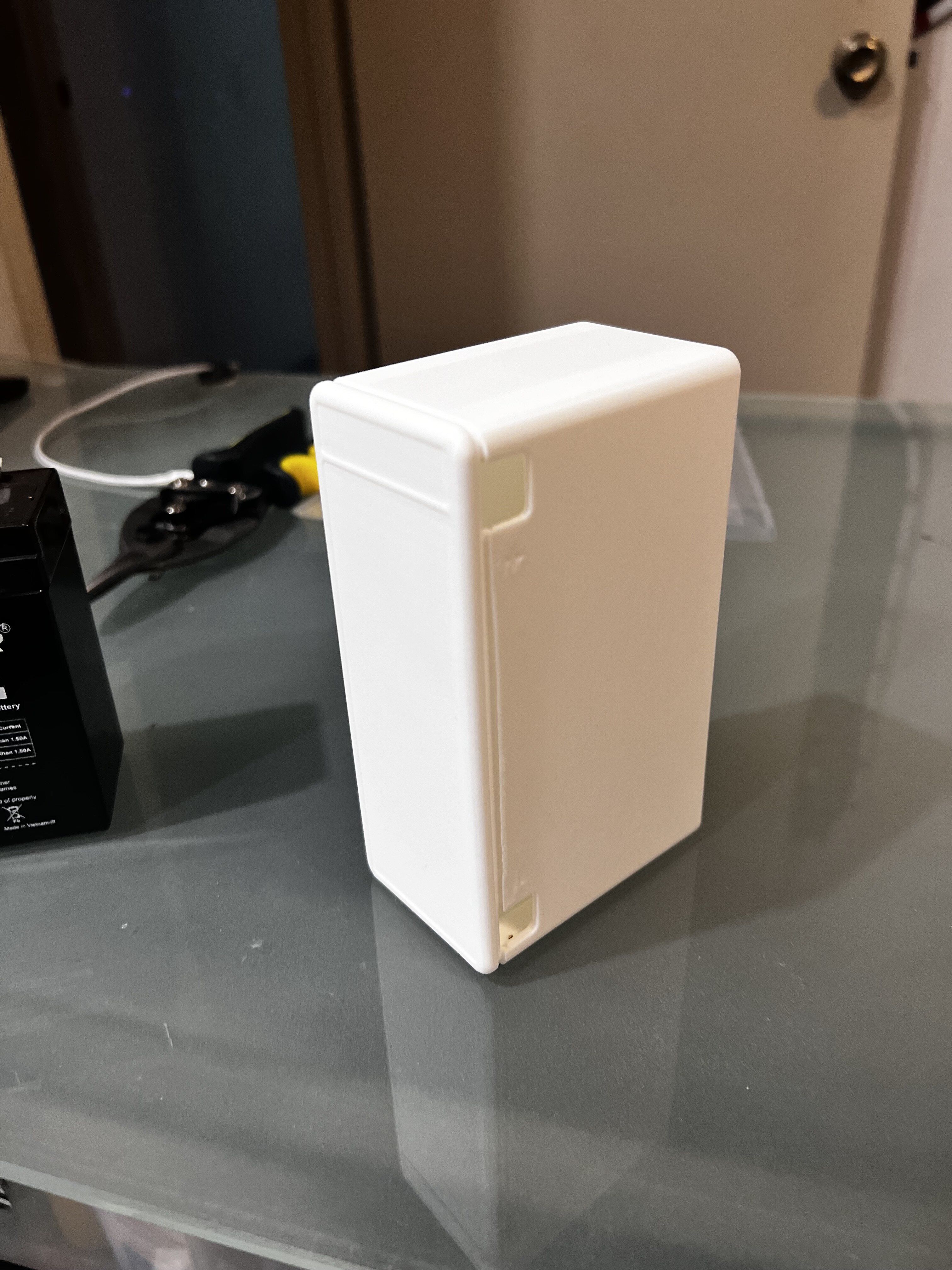

How'd the printing of that case go?
One reason I didn't go with the original Macintosh Portable battery case design for my battery adapter is because it would take a lot of support material or compromise the surface finish of one of the sides to print on an FDM printer.
The main reason though is that I didn't want to require printing the whole case. Only the spacer is really needed with some padding so the battery contacts won't be bent.
It went well. Yeah lots of support material inside but I needed to test my new replacement printer out anyway and I have support pla which is really nice. It falls right off the part.
