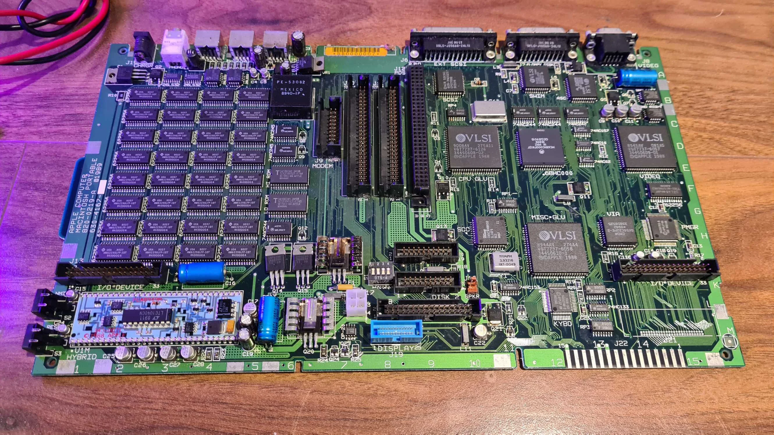

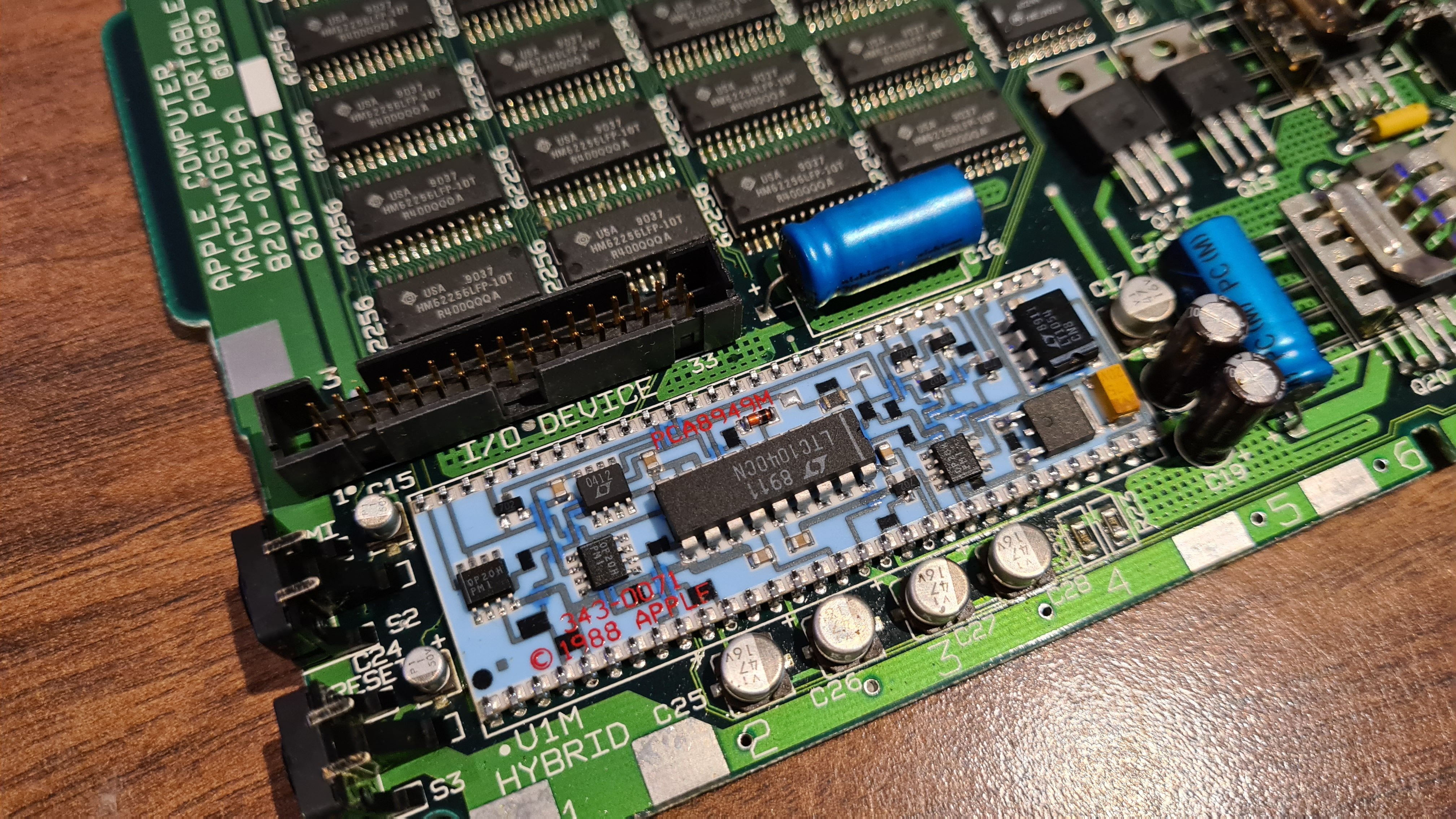

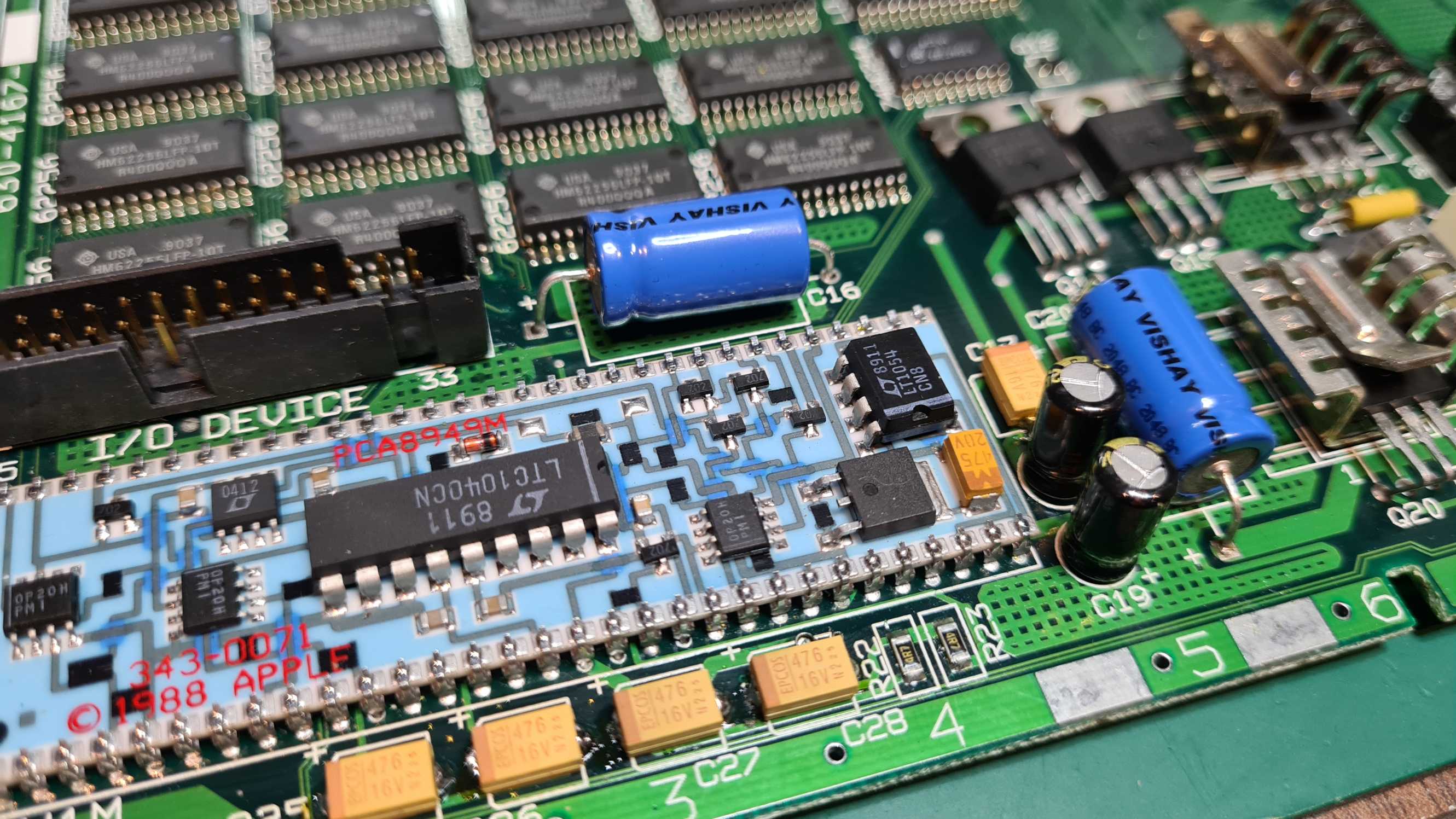

Currently working on a one of these but I am kinda stumped. Its a non backlight model.
I have fully recapped it, (every cap was leaking, including the axials)
So I can get it to Bong, and will show flashing floppy. The Connor SCSI drive is working, and it can boot, but after booting it emits a loud screeching noise. Normal audio can still work, I turn it off ASAP when it makes the noise. Then sometimes it wont switch on at all. I leave it for a while and it will power up fine. Then screech. Anyone experience anything similiar?
Speaker may be shorting against something. The design is dangerously compact — try putting tape on the back of the speaker to rule it out and inspecting the wires.

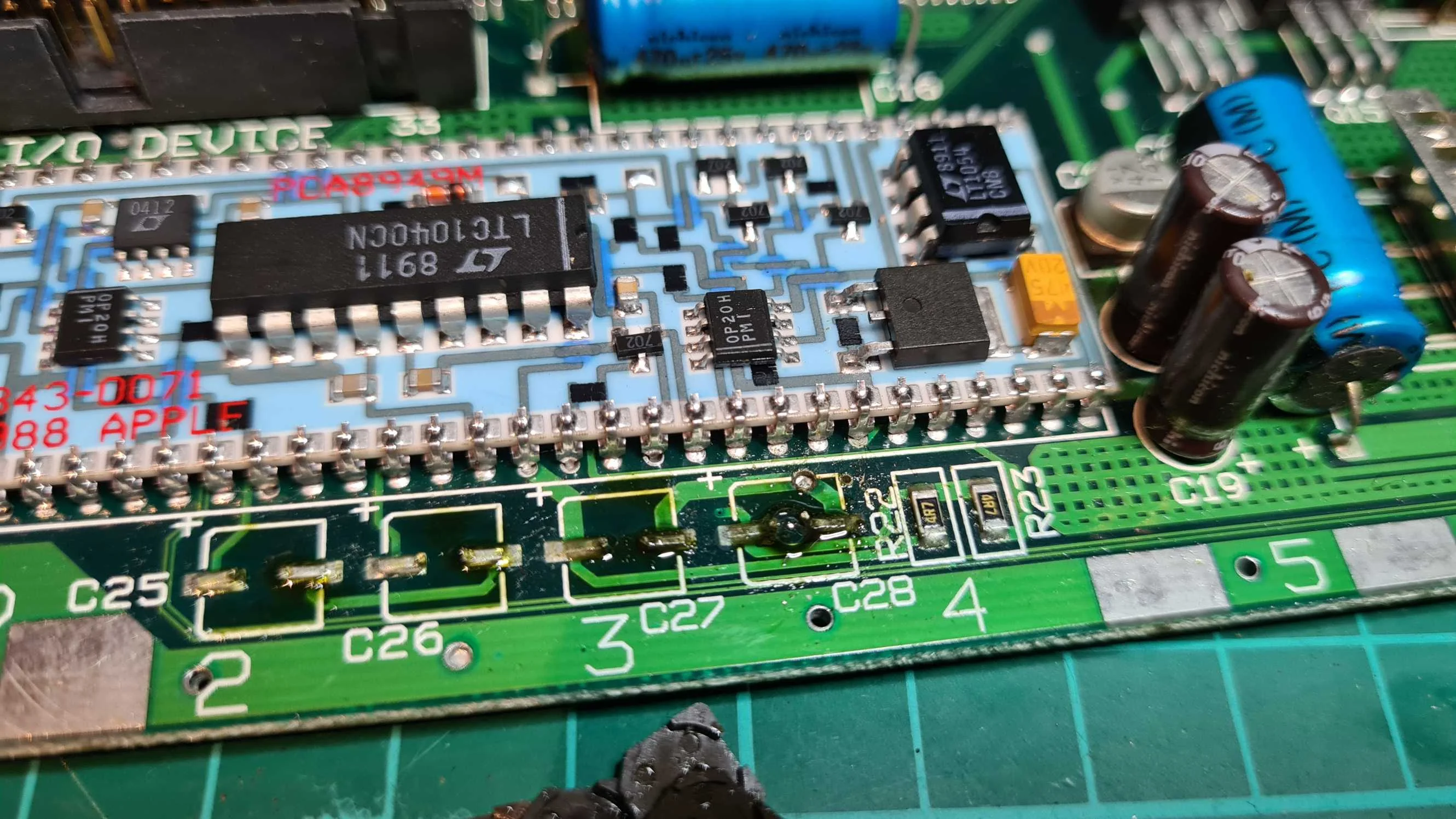

A little late to the party... did you resolve the issue? My first thought was whether or not the board was cleaned after recapping.
Cap goo leftovers around the sound area of the board. I had the exact same problem on my Portable. As soon as the sound chip was kicked into low power mode by the power manager (aka the 12V supply to the sound chips gets shut down) it started screeching horribly.
I desoldered everything from the board in that area, cleaned up the board and ICs and resoldered them - since then the problem was gone.

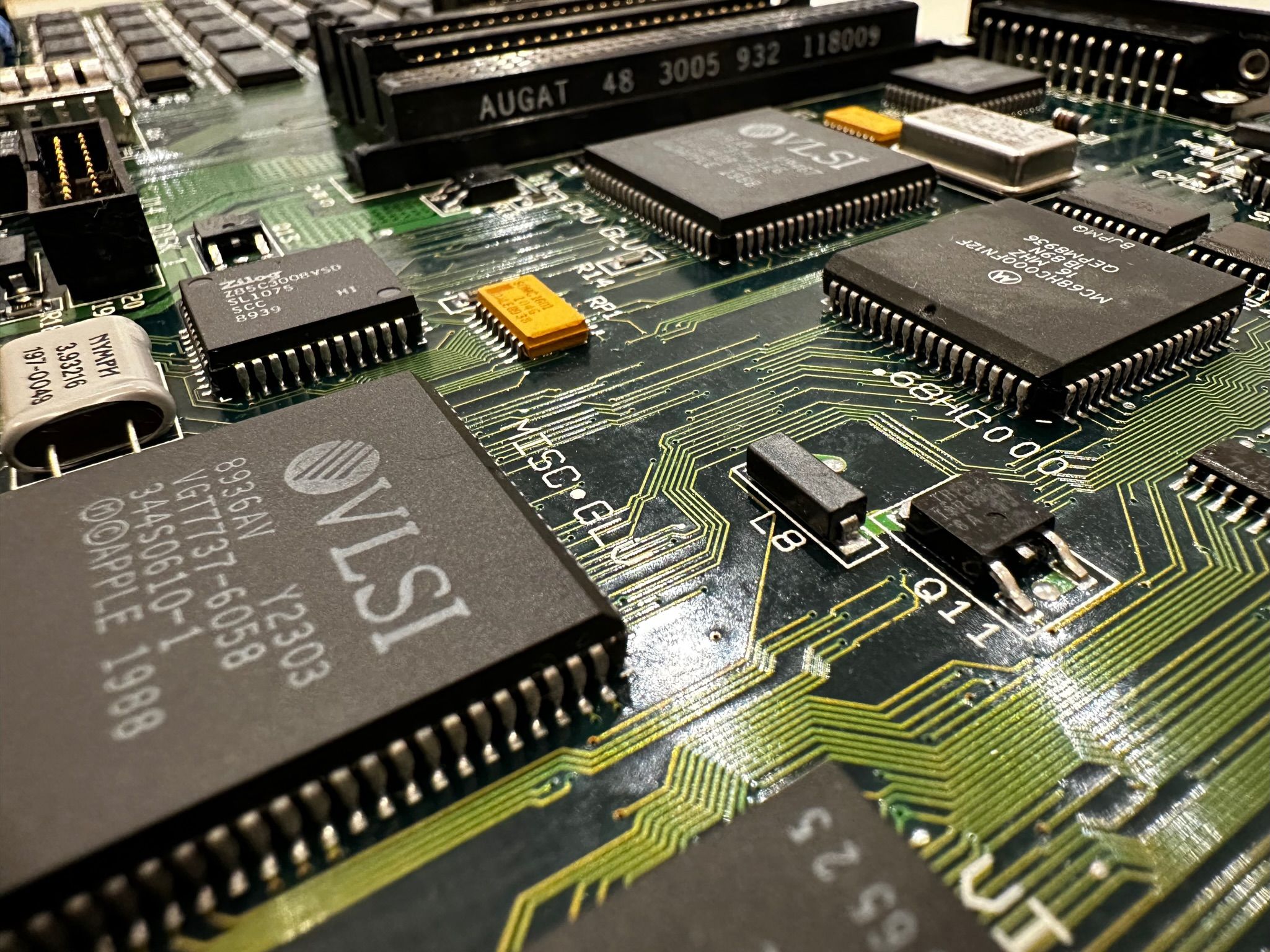

I had this exact same issue... about 20 seconds after boot the Portable would just start wailing from the speaker. I'd previously recapped and cleaned the board, and the board in question is super nice - no corrosion. I started looking for areas that hadn't cleaned properly and in doing so discovered that L8 was loose. It was soldered down - but the core was wiggling between it's own connectors. I removed it and it seemed ok, apart from the wiggling. So I re-soldered it back down, and made sure to use enough that it didn't wiggle any more. As soon as I booted after that the noise was 99.9% gone! There's still the slightest step change in speaker hum at the 20 second mark post-boot, but if you weren't listening for it you wouldn't notice. And I'm guessing once it's back in the case it won't be noticeable at all.
