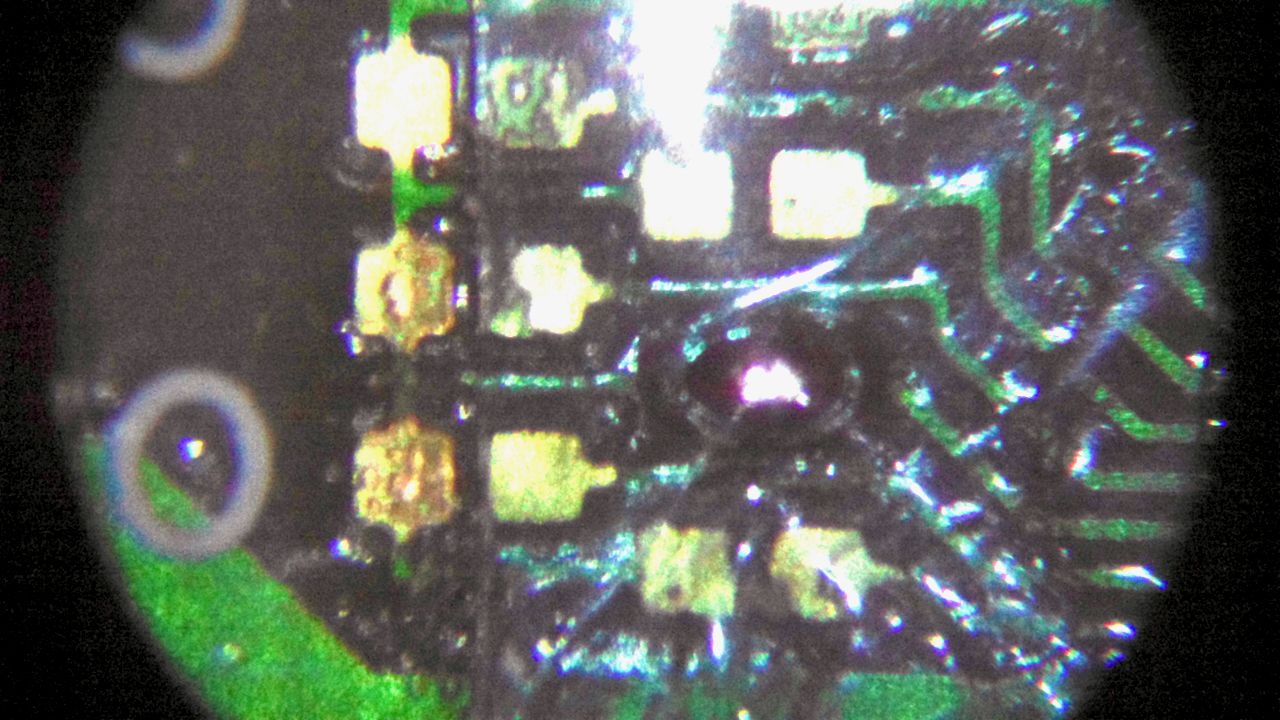

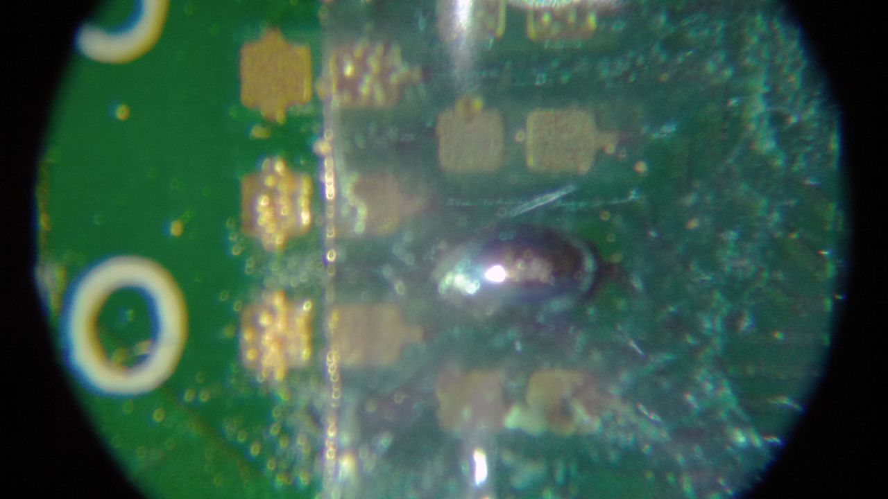

After successfully recapping and replacing the Hybrid (thanks again @Androda ), I needed to correct one faulty matrix line of the display.
I replaced the flat ribbon connector as it was torn at different places.
Unfortunately, same issue.
Checking the back of the display more carefully, I realized that there was a kind of corrosion under the protective adhesive.
I had this type of corrosion once in a LCII PSU, probably due to a bad board cleaning at manufacturing.
Sorry for the bad quality, my camera was out focus...
To my surprise, after replacing the protective adhesive, pads were perfect!
Back to square one.
Checking the whole board, I realized that other areas have the same aspects.
I plan to remove the protective adhesive from the additional places, but is it normal to have these solder connecting pads?
I have that at 4 different places on the board.
Thanks for your advices.
View attachment 13549View attachment 13550
Back to square one.

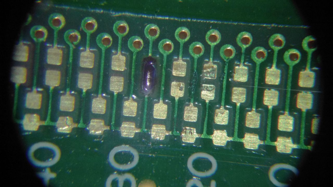

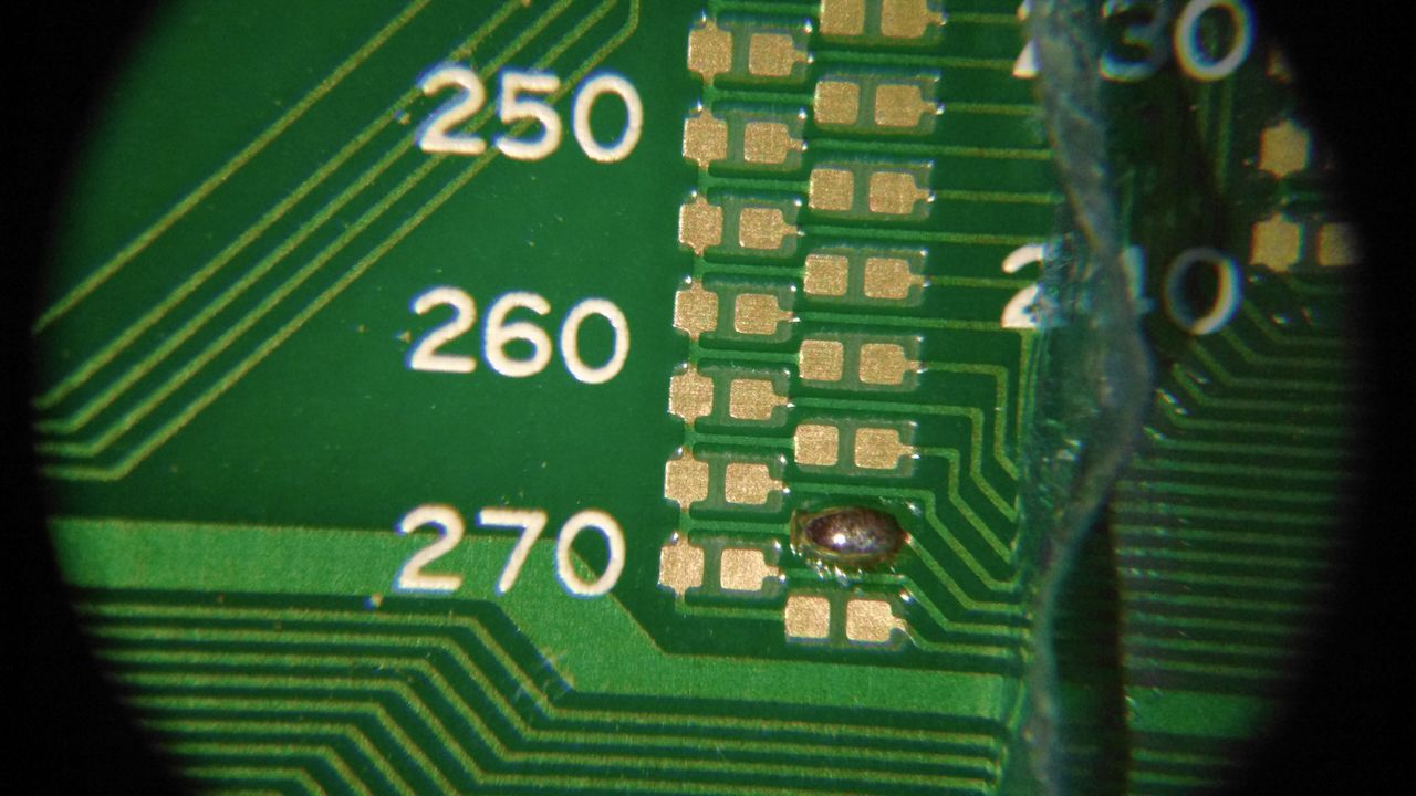

Yea the solder bridges like that are normal.
Those solder bridges are actually a form of bodge. There's line numbers next to the pads on the edges, and there are corresponding line numbers on pads connected to the driver chips on the opposite end of the board. If for some reason there's a bad connection, this allows you to connect the same line using the elastomeric/zebra connector that's on the opposite side of the LCD. It is limited to one bodge per side of the driver chip however.

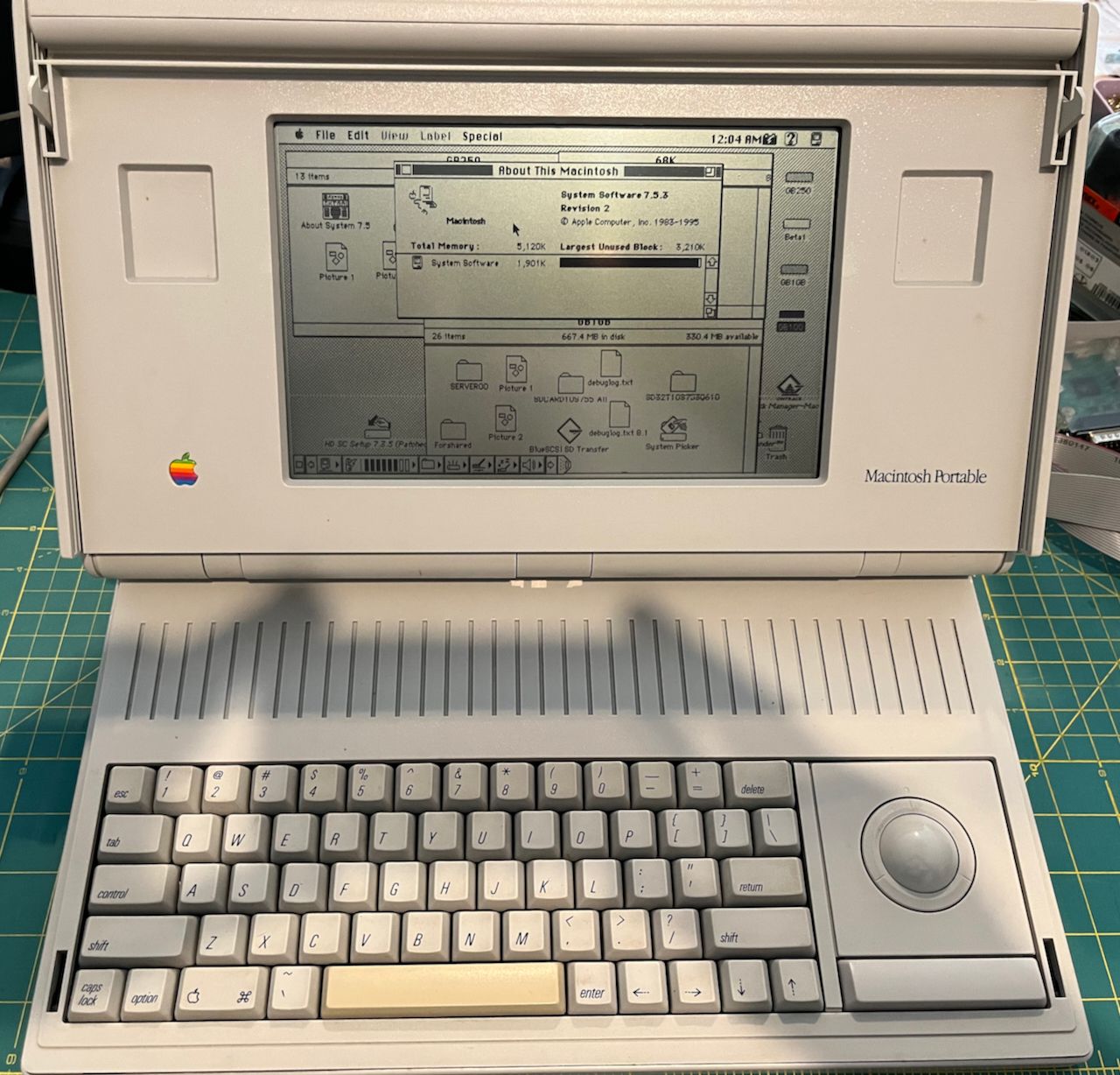

While waiting for it, A single line is actually acceptable.
I finally found a decent display now. It has one dead pixel that I’m trying to not let mother me 😂
