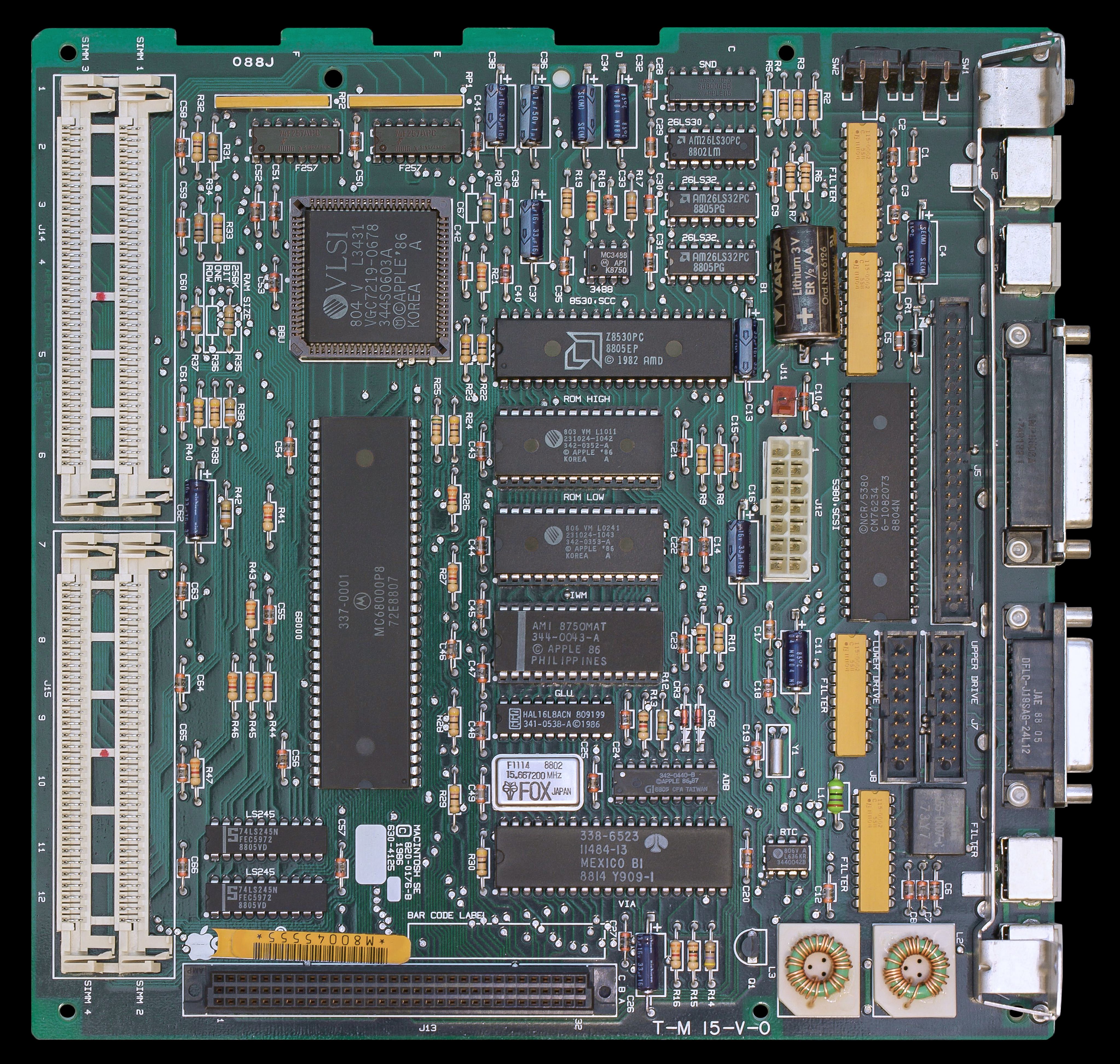

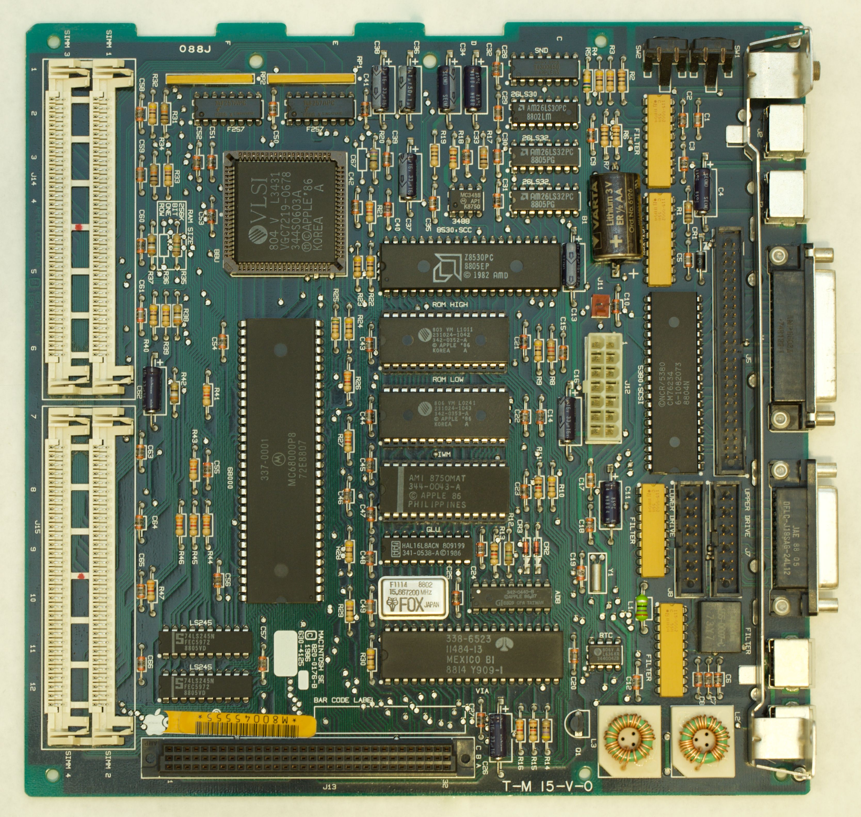

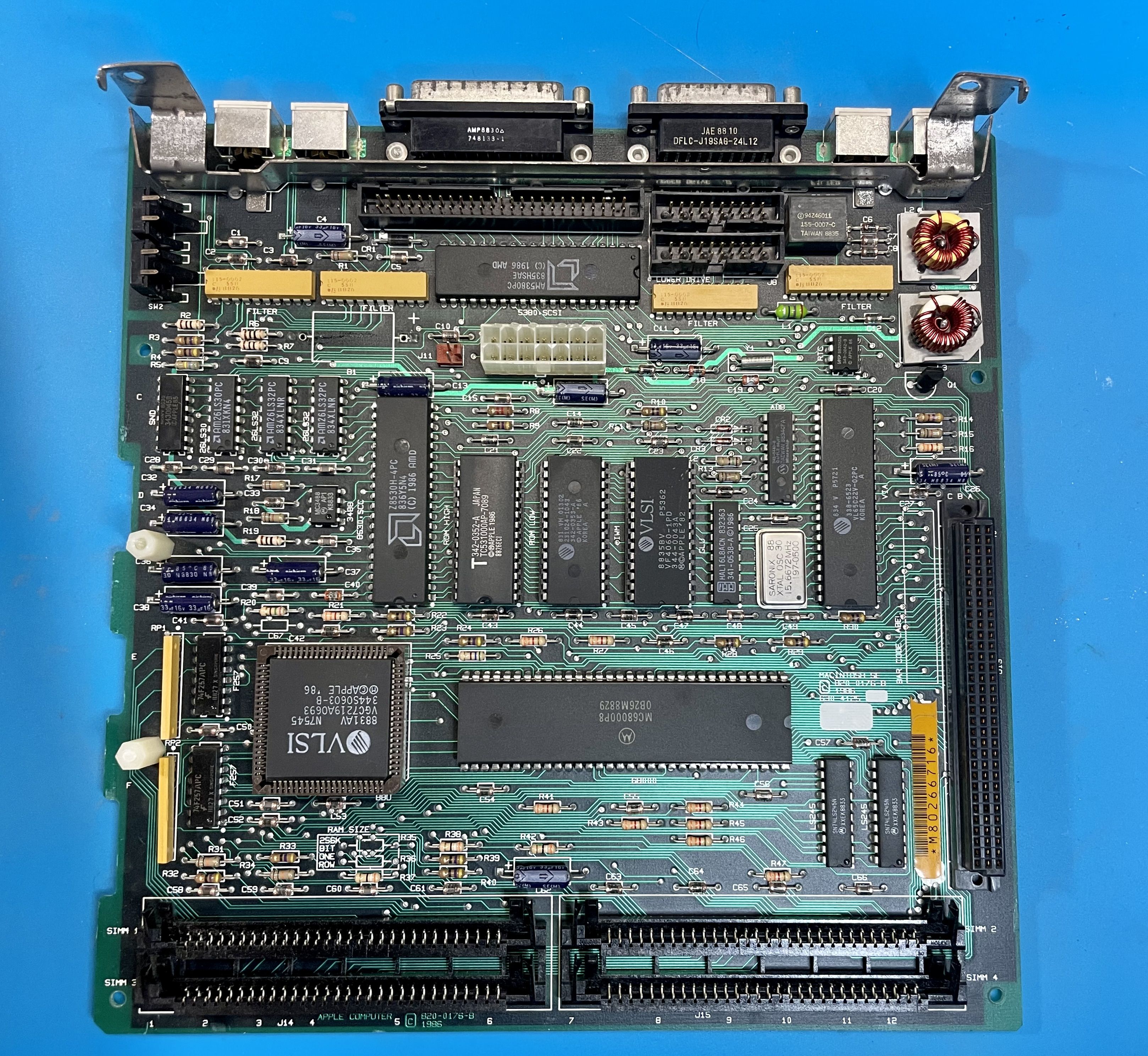

Hello, friends. I am in the middle of editing Part I of my @Kai Robinson SE Reloaded video, and I am trying to find high resolution, top-down photos of the SE motherboard and chip sets that are different from mine. Here's a high resolution (20 megapixel) photo of mine, which is revision 820-0250-A...
Note that there are 2 SE logic board revisions:
OLD: 820-0176-B (1986), 630-4125
NEW: 820-0250-A (1988), 630-4250 (the one I have)

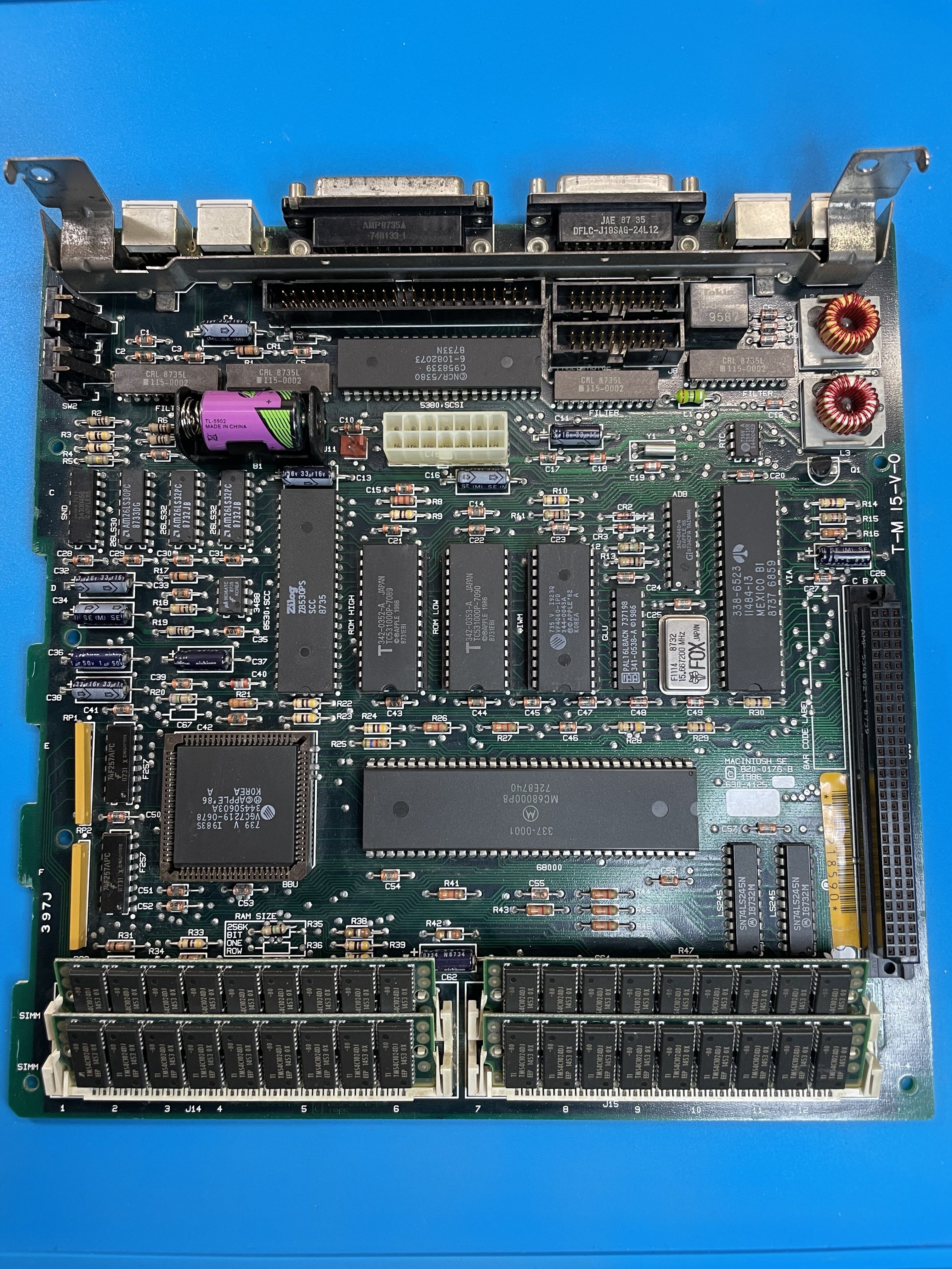

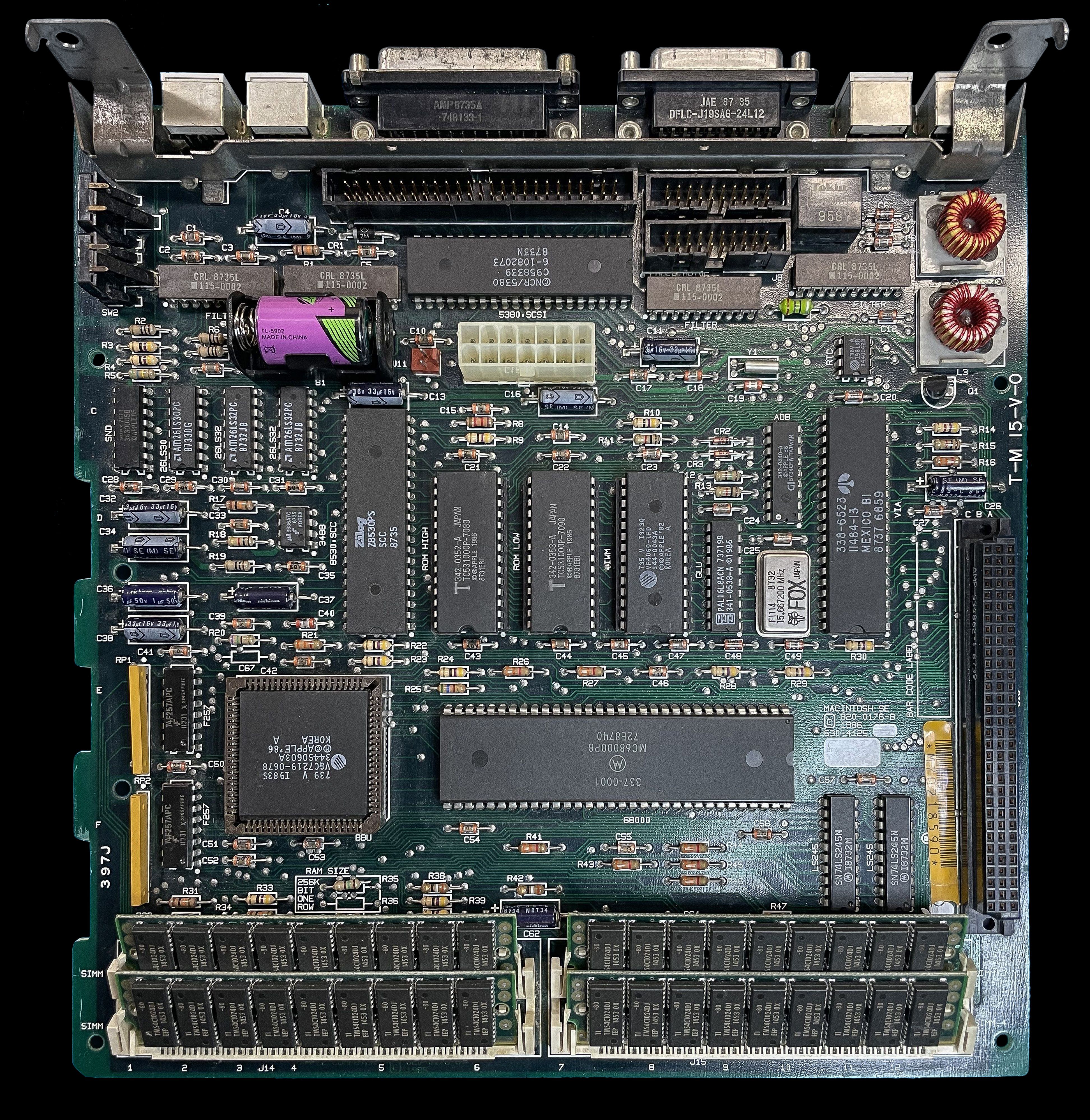

@Branchus has a wonderful top-down photo of the OLD 820-0176-B board, but unfortunately it has 2 non-stock mods: (1) button cell PRAM battery and (2) a RAM selection jumper board soldered in place of the stock resistors. I am seeking a high resolution, top-down photo of a fully stock 820-0176-B board without any mods, and without the RAM SIMMs installed.

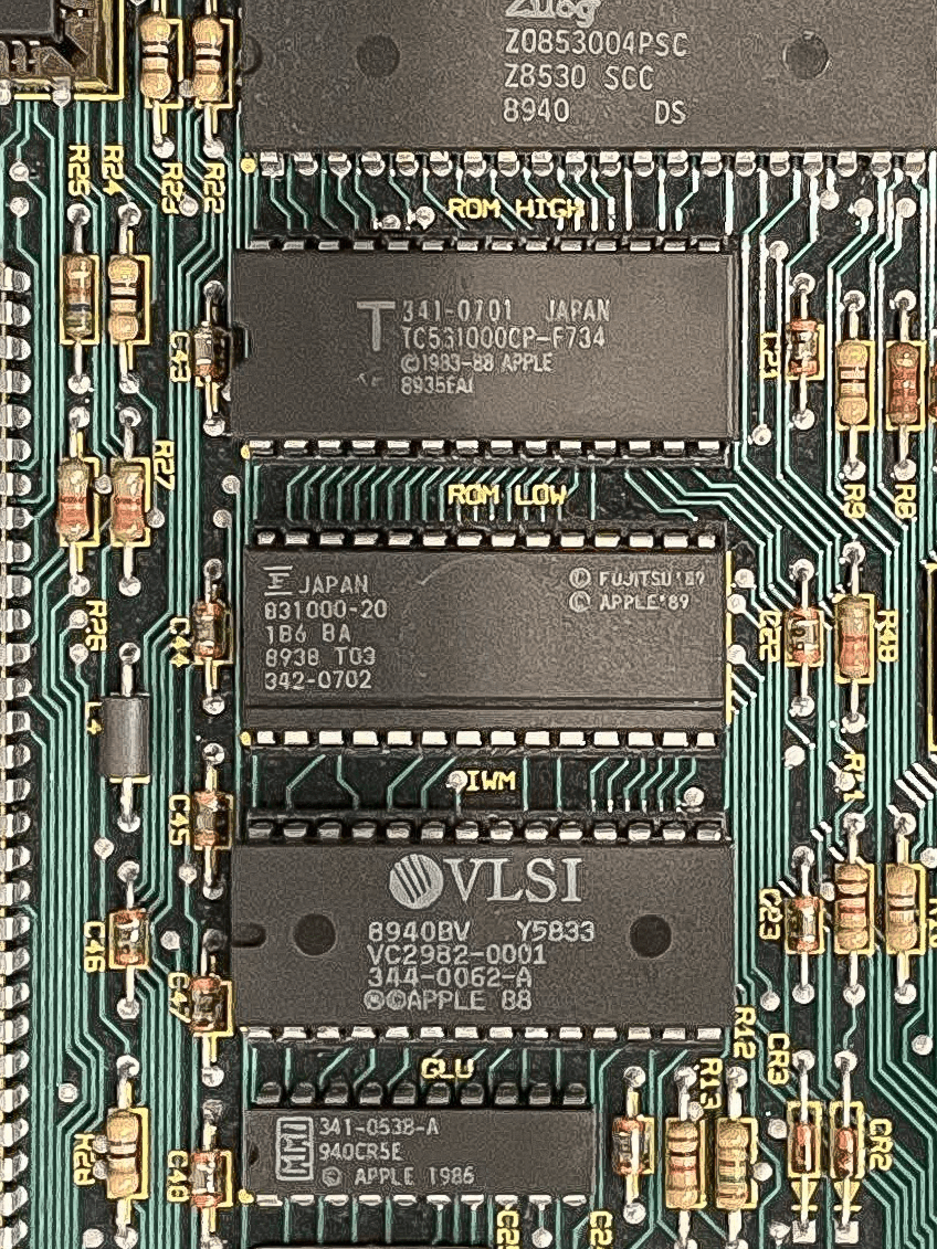

I also don't have a photo of the 1.44MB-compatible FDHD model chips which are typically found in the newer 820-0250-A boards:
342-0701 HI ROM
342-0702 LO ROM
344-0062 SWIM
Despite the fact my SE board is the newer 820-0250-A revision, it has the old 800K-drive compatible chips in it:
342-0352-A HI ROM
342-0353-A LO ROM
344-0043-A IWM
So to recap, I'm seeking these 2 high resolution top-down photos:
1) 820-0176-B board with no mods and no RAM installed
2) The newer chipset trio (342-0701, 342-0702 & 344-0062) mounted on either board revision (since I can Photoshop the chips onto my board photo if necessary)
Can anyone help me out with this?
I will of course credit the contributor(s) by name (or however you prefer) in my video. I just want to show people the two SE boards with their stock chipsets.
Thank you!
I think i have the older board - it was a New-old-stock one that i used for reference. Not sure if the photo's i take will be great though :p
A hi-rez, top-down photo of that older unmodded board would be great, Kai. Thank you. Not sure how @Branchus took his great photo, but in my case, I put my camera on a tripod and faced the lens straight down. I extended my tripod to be fairly tall so I could put distance between the lens and the motherboard, then I zoomed in with my zoom lens to fill most of the frame with the board. Not only does that maximize the resolution, but it mostly eliminates any lens distortion too. Lighting was just your standard overhead fluorescent room lighting that any office has, since I shot it at work after hours when no one was there. The fluorescent lights mostly eliminate shadows. I shot it very slightly at an angle to prevent my camera from casting a shadow on the board, and then I used Photoshop to make slightly adjustments so all 4 edges of the board look perfectly straight.
Also, if you have the newer chipset (I don't), I would love to obtain a photo of those chips as well (top down), with as little lens distortion as possible. What I can then do is mask out the body of those chips and put them on the chips in my photo. The end result will then be that my newer edition board (the one you kindly shipped to me by the way) will also show the newer chipset that is the stock configuration.

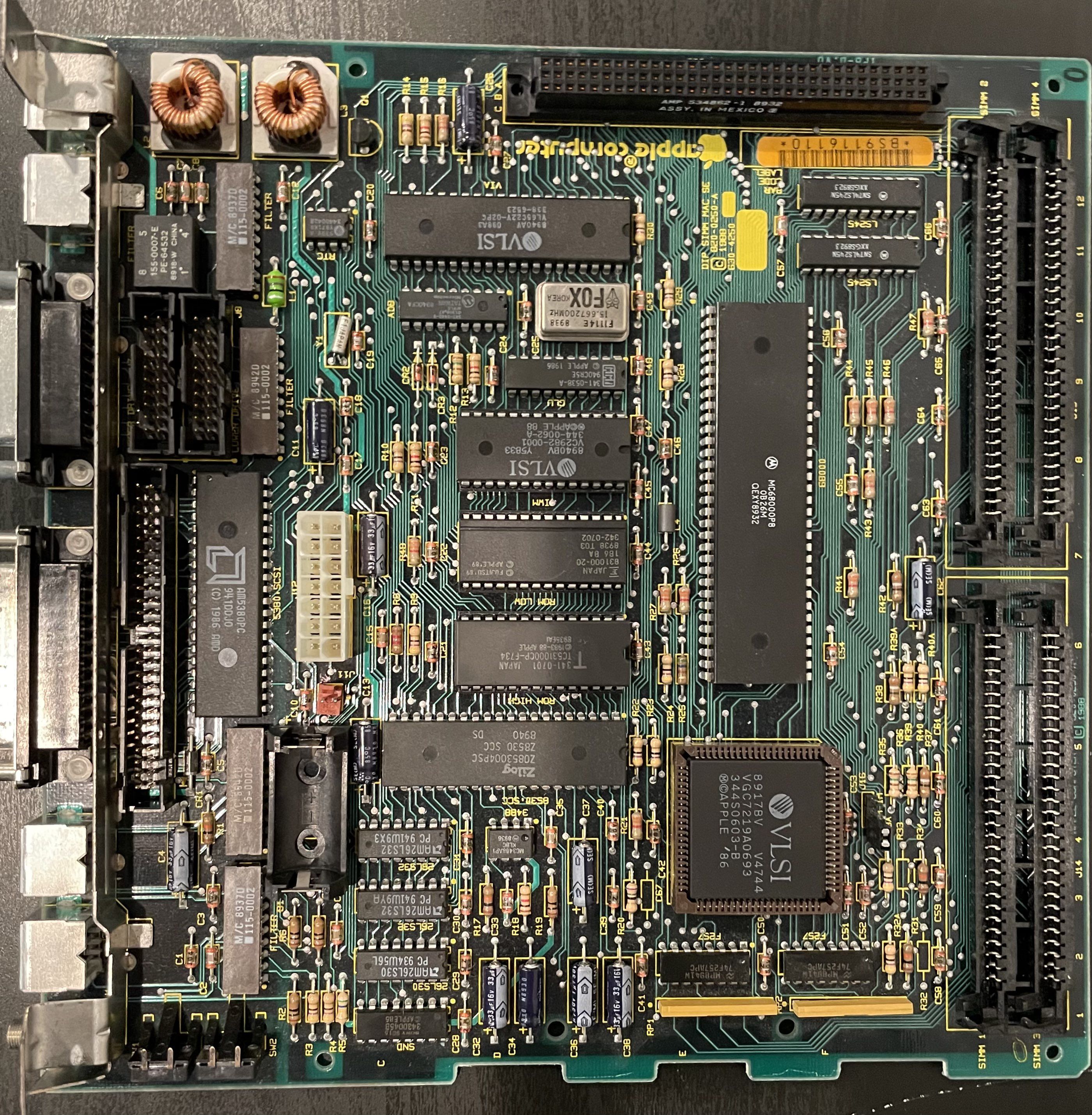

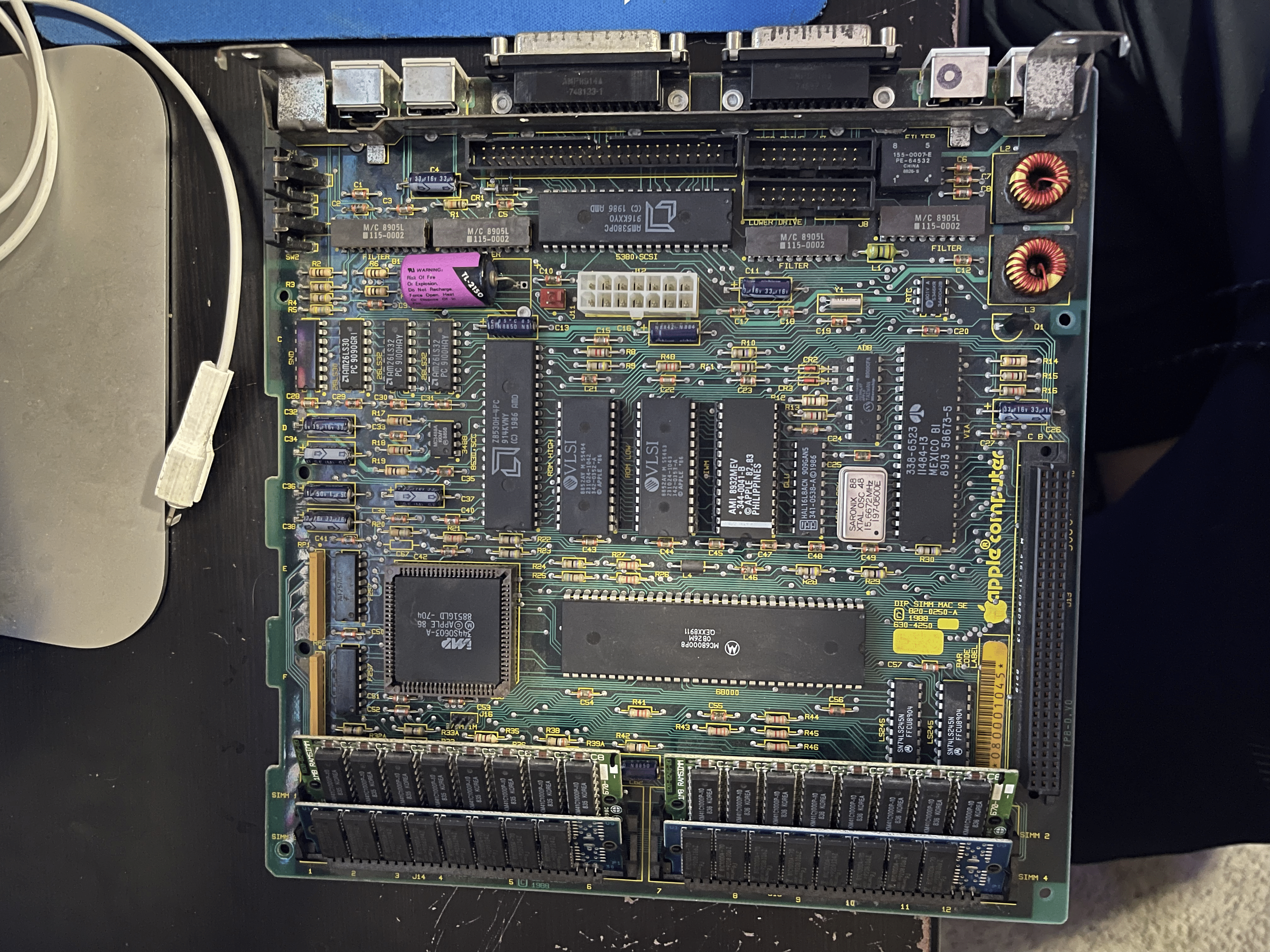

@chrisangellis Although the RAM SIMMs are installed in your old version board, I can see the RAM configuration resistors, so I believe I will be able to use that. Here's how it looks after a few edits...

@RetroJack You have the newer chipset that I am after, but some of the markings are a tad blurred. Could I trouble you to reshoot only the area of the 3 chips, so as to boost the resolution? (Please don't boost the digital resolution, as I can do that.) Here's an example of the area I am talking about...

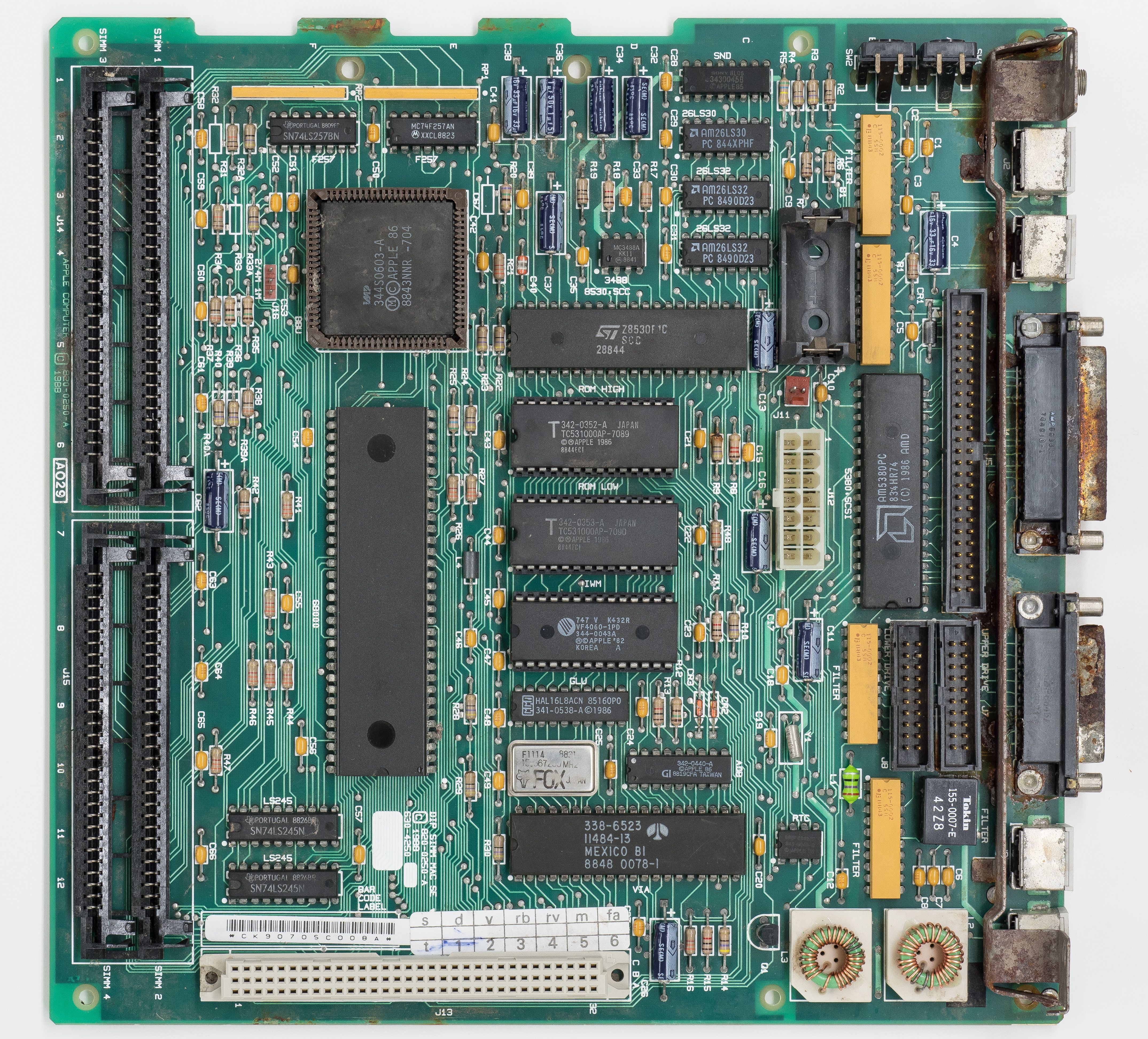

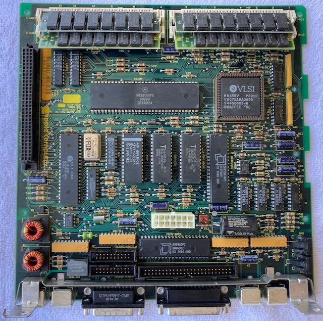

This is my 820-0176-B board. I reversed a couple things for the photo to look more stock: I had clipped R35 on one side for a 4MB upgrade so I scooted it back over so it would look connected. I also pulled the Varta battery out previously so I just set it back on the board (I keep all my old Mac batteries quarantined in an ice cube tray to see if any will eventually explode :))

Now that board and photo are pretty amazing. No RAM makes it easy to see the resistors used to set RAM size. I love the old soldered battery type! A truly well-shot photo without pretty much no distortion! I've color corrected and sharpened it, as well as cut out the background, which you can see here:
So in terms of the OLD revision board, I will go with that photo and credit @MacMaster in my video for the photo.
The only other thing I need is a high resolution shot of the 3 newer chips, either from @RetroJack or from someone else. My intention will be to mask out the part numbers (and chip bodies if they look nice) and Photoshop that on my own newer-revision motherboard photo. That will help me show people what a new edition motherboard looks like (new board, new ROMs and new SWIM chip).

Old SE Board 820-0176-B, with Old ROMs, Old IWM (thanks to @MacMaster for the board photo):
(I added color corrections and sharpening only.)
New SE Board 820-0250-A, New ROMs, New SWIM (thanks to @RetroJack for the chip trio photo) :
(I masked the bodies of the 3 chips onto my motherboard photo — board provided to me by @Kai Robinson.)
