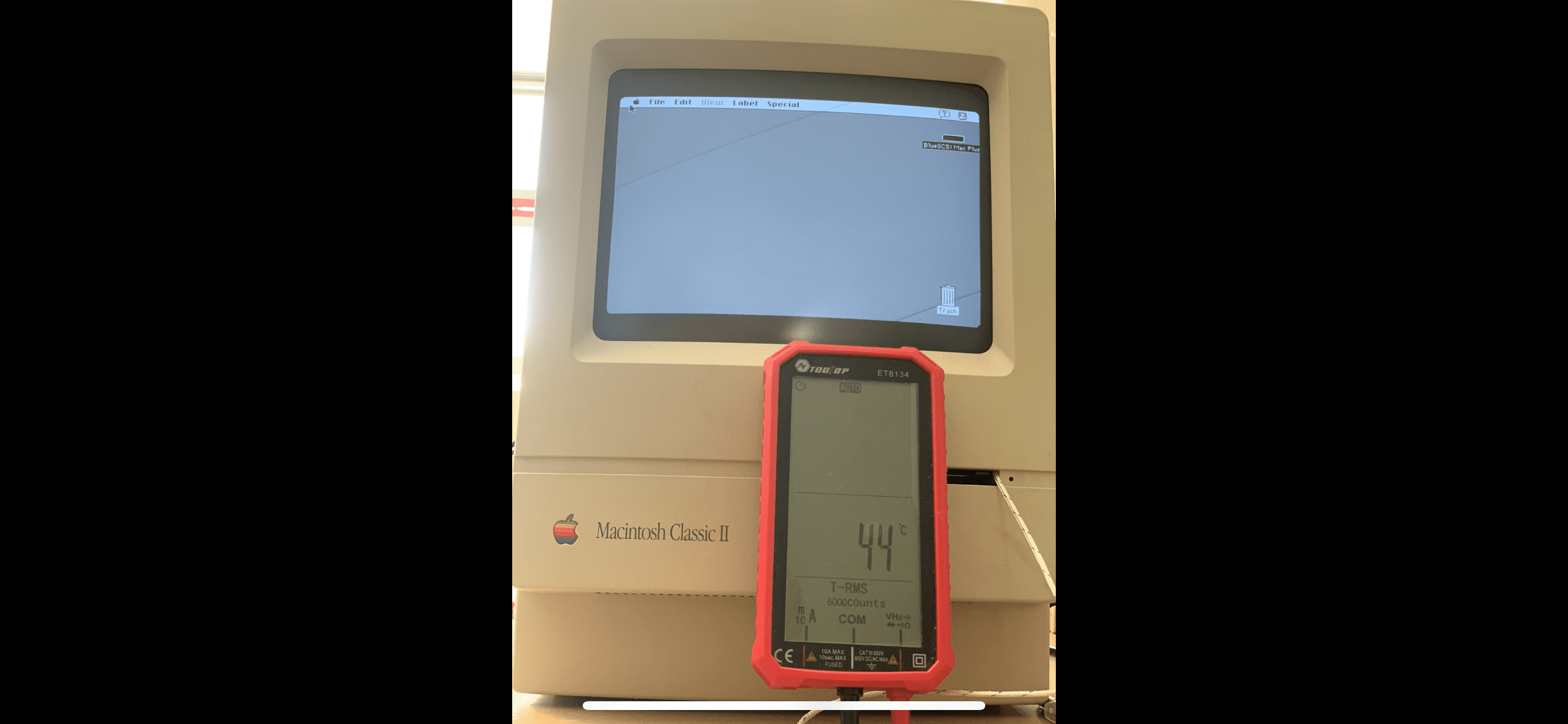

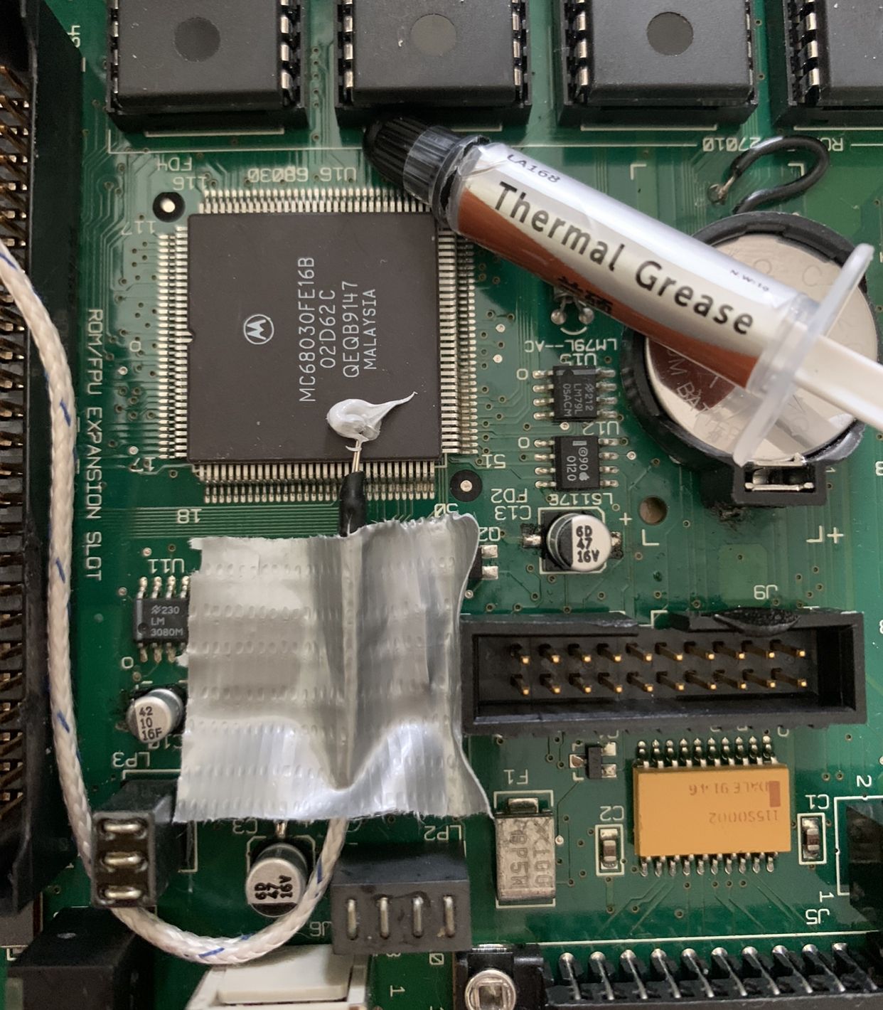

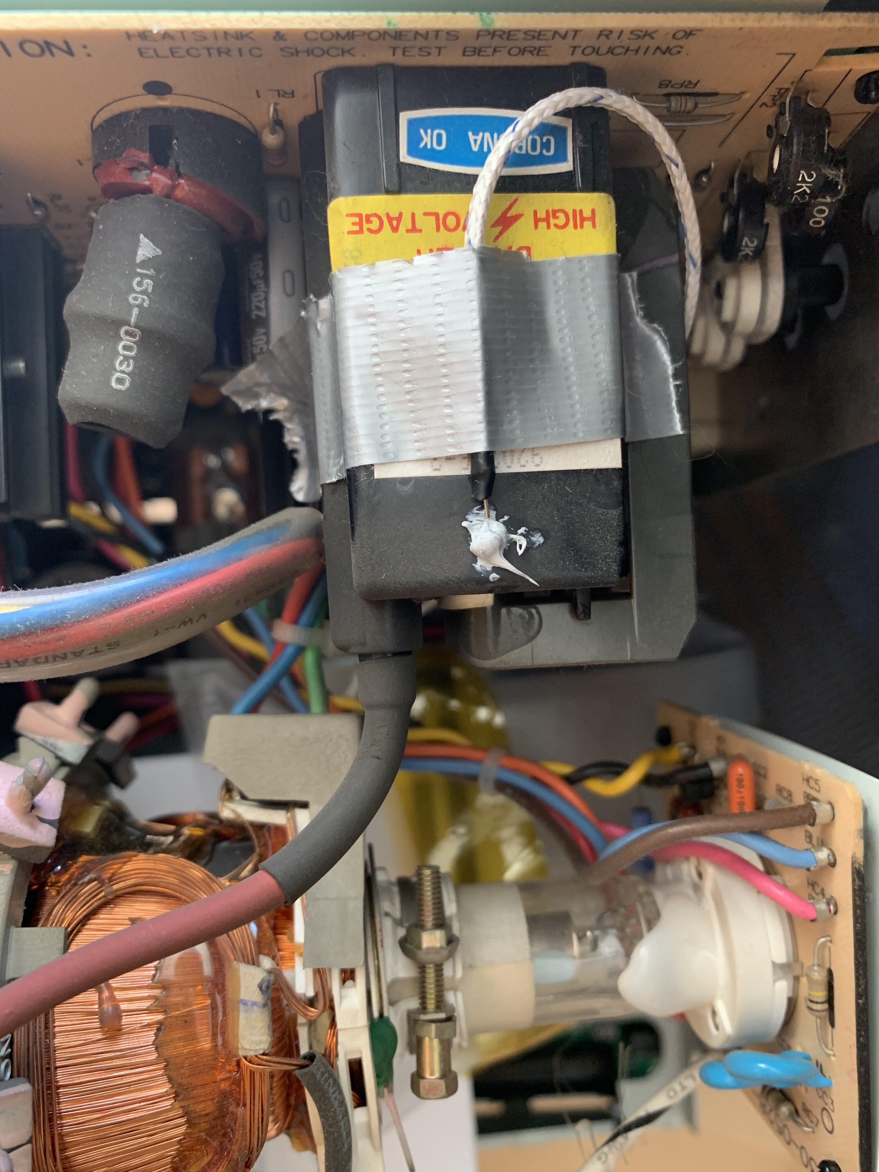

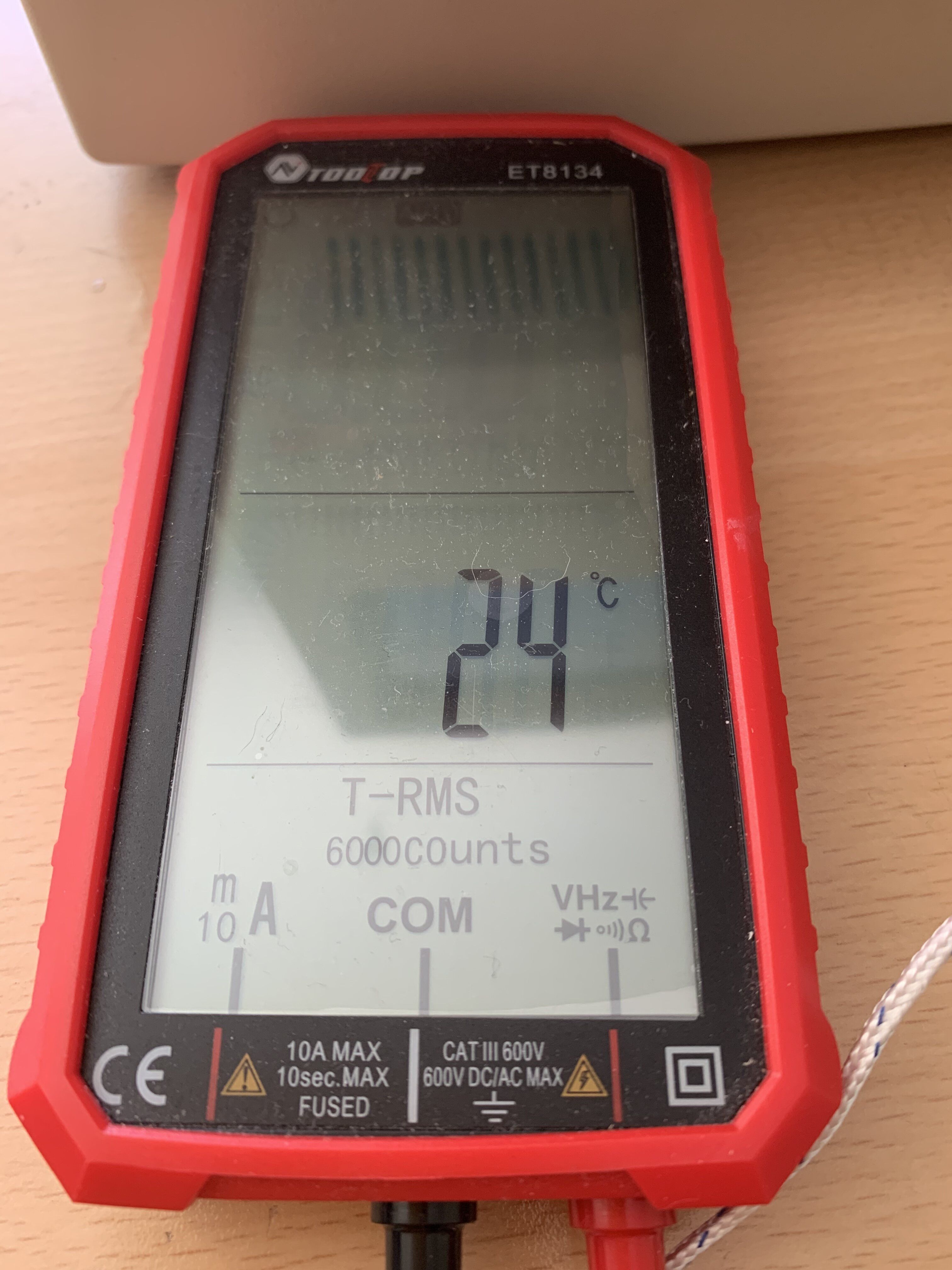

just to know…..did place the sensor on the coil. It went up from 24C to 45C in about two hours. Dont think this is crazy hot or so.
What machine's flyback is that, no cage apparent? The fact that temp readings are lower on flyback in comparison to CPU temp doesn't matter. Now you're sampling a point more closely aligned with machine cooling state that's unaffected by processor activity. Readings are much nearer to point of exit and should prove to be more relevant to the problem at hand I think?
It's @-SE40-'s Classic II; if you look at one of the pictures, he attached a white wire running through the floppy disk opening, which is clear is a Classic II. :)
The flyback on the AB in the Classic II does not have a metal fence cage around it. I guess maybe Apple decided it is not wild enough to corral it? 🤪
