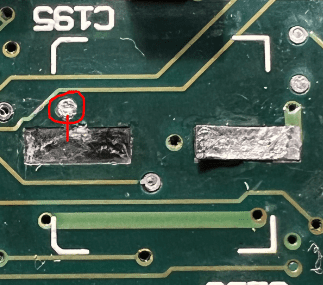

I was replacing the last capacitor on my Mac TV logic board (C195) and because it was a larger one, I tried to desolder it instead of using my usual push and twist method. Turns out there was a decent amount of leakage under the cap and the pad ripped clean off. The other one lifted a bit, but is still connected.
The problem is I can't see what the pad was actually attached to. I don't see any trace or connection point, so I'm not sure what I can even try to run a bodge wire to to fix.
Does anyone have a Mac TV logic board or schematic that will tell me what it should connect to? I thought maybe I saw some metal showing through underfeed, and scraped it a bit, but I didn't want to make things worse so I stopped. I was also trying to see if there was a trace connecting it to the via directly above the path, but I don't believe there is.
Any help y'all can provide would be greatly appreciated!
I don't own a Mac TV, but to my eye that capacitor pad probably goes to this via. It's the positive side of the capacitor (based on the curved silkscreen marking). If you check from that via to various other capacitors and chips, it will probably be connected to a power rail.

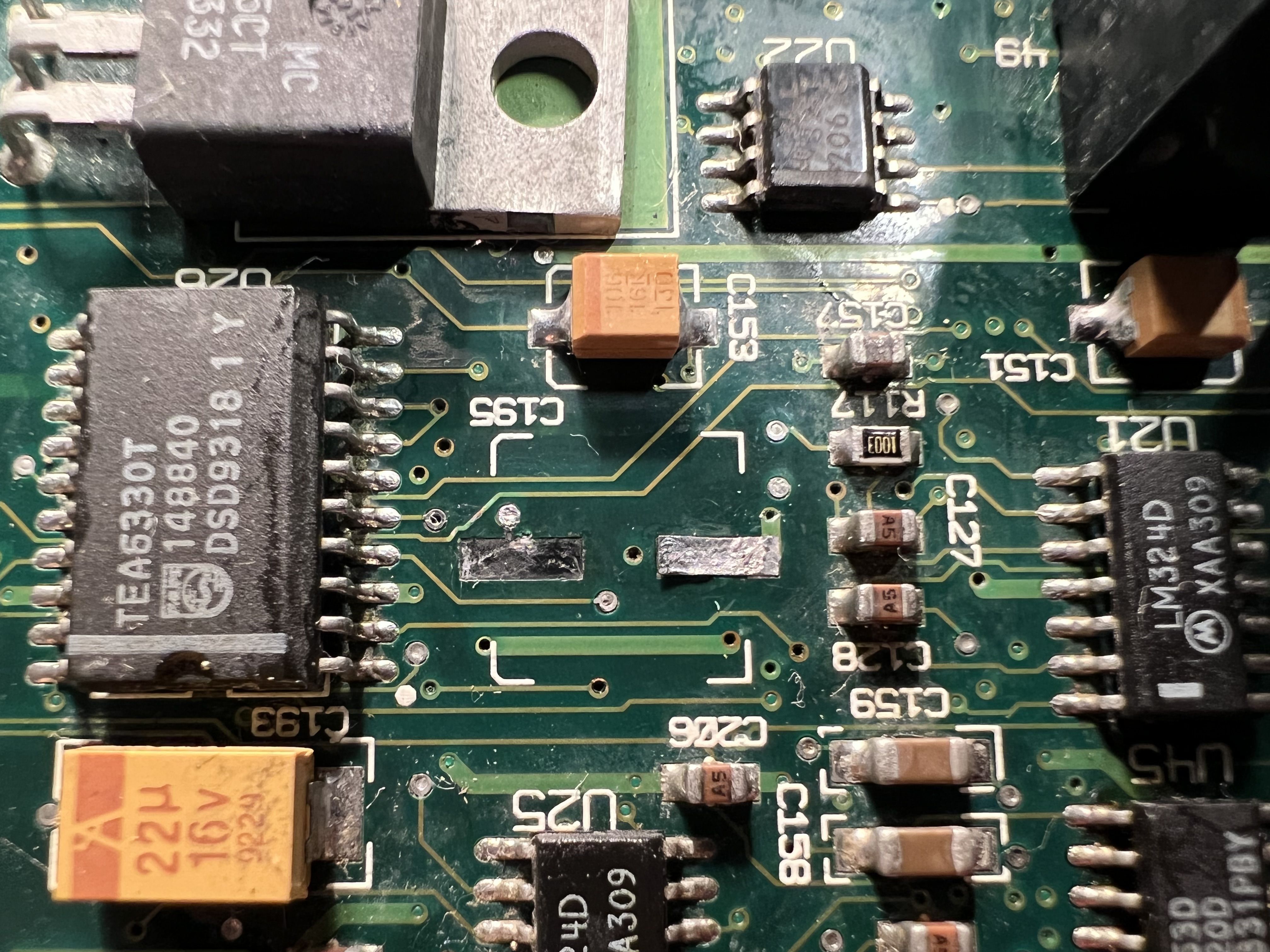

Yeah, that was the only one that seemed to make sense. Unfortunately, I couldn't get a wire soldered into that via , but I did find where the VIA is connected to pin 1 on the U26 IC to the left of it. I was able to get a bodge wire from that to the new capacitor. Unfortunately, I am unable to get the machine to boot.

Fortunately, I spoke too soon. These Macs (for reasons I don't understand) sometimes need to be plugged in a bit before they'll boot. I left it plugged in and powered on (without pressing the soft power button) for a bit and went back and it booted up. My bodge wire work is horrendous, but it appears you were correct about that via being the connection for the positive leg of that cap.
Hopefully no one does what I did, but at least we have confirmation of the fix if it does. Appreciate the help!
