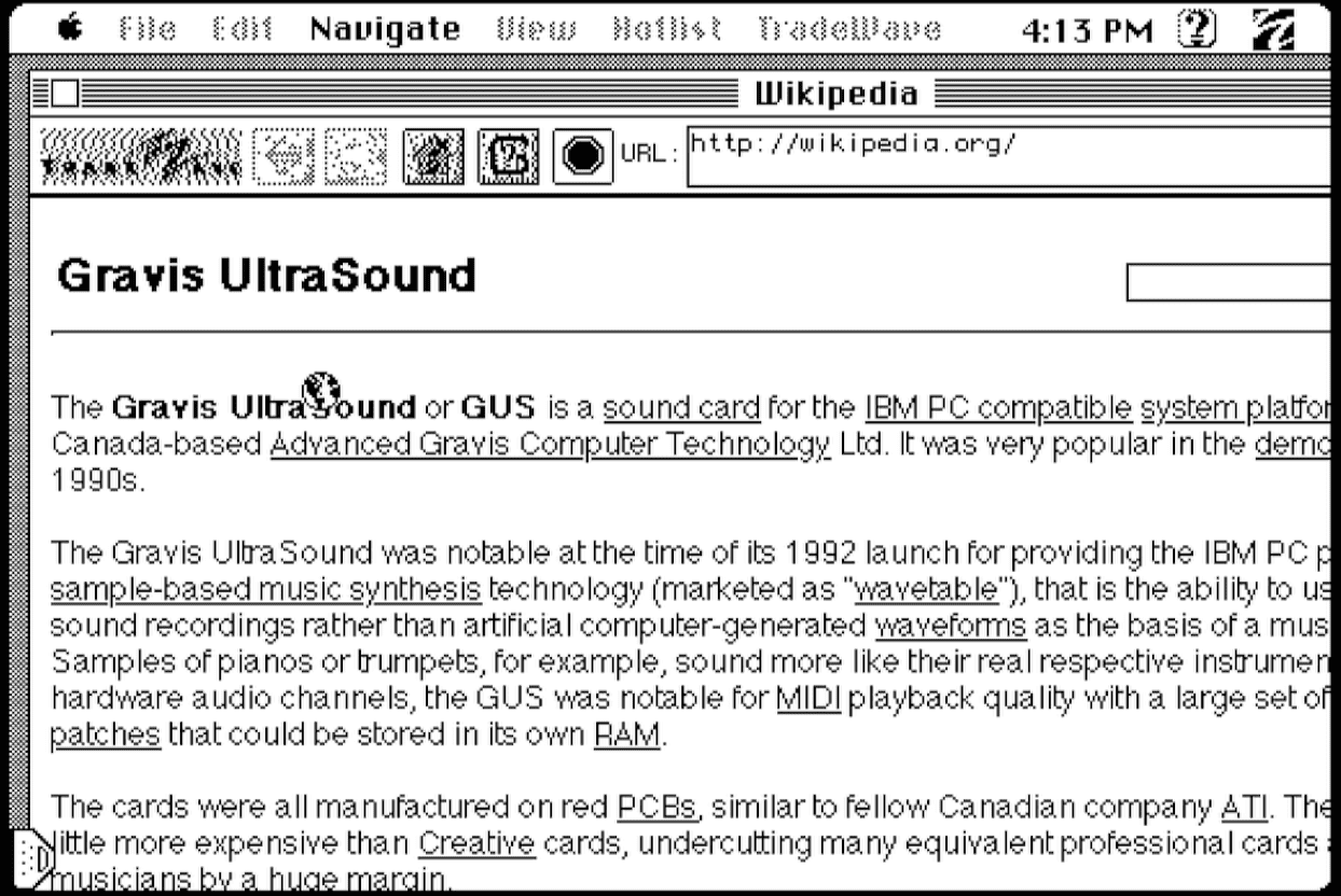

so this video made the rounds, and in it, Hunter Irving exposes how a linux flask server can act as a proxy for his Mac Plus using the very old MacWeb2.0c browser (but any old computer that can set up a http proxy is fair game, ie a SE/30, a windows xp machine, etc)
Places that work with it:
chatgpt, claude, hackaday, hacksburg, hunterirving, npr, override, reddit, waybackmachine, weather, websimulator, wiby, wikipedia, notyoutube
I'm currently looking to run this server on my Windows machine through WSL and I'm getting my behind kicked thoroughly. I'm very untrained in all things linux/ubuntu/whatever distro you want and I try not to mess with network stuff if I can help it usually - sadly, this project requires a HEAVY hand in both.
My gear in the retro side:
Mac Plus with BlueSCSI v2 w/ pico W, booting with 7.5.3 and can MacTCP ping local addresses on my LAN, I can run Mac2.0c and it shows a connection to my wifi
Mac SE/30 with BlueSCSI v2 w/ pico W, booting with 7.5.3 and can MacTCP ping local addresses on my LAN, connect to a hosted ftp on my modern PC, or connect to a local http python server hosted on my modern PC as well. It shows a connection to my wifi.

edit - with the help of polpo, ian scott and gutbomb, I ditched WSL and just went straight to python
Code:
pip3 install -r requirements.txt
python3 proxy.py --port 5001
