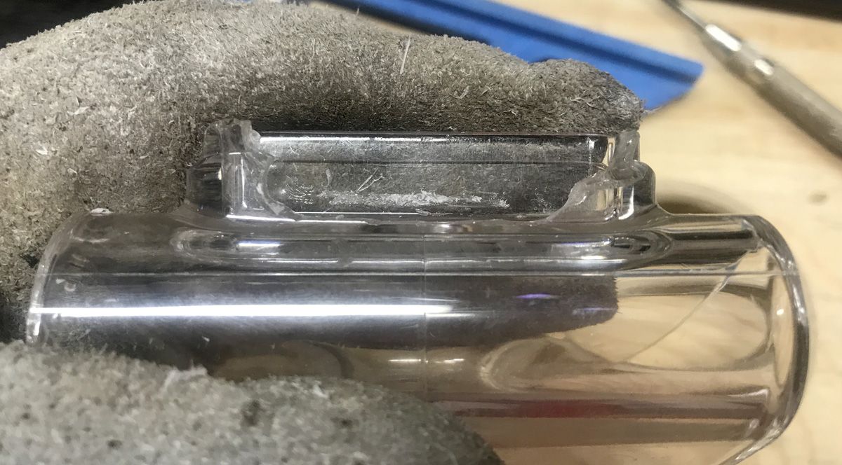

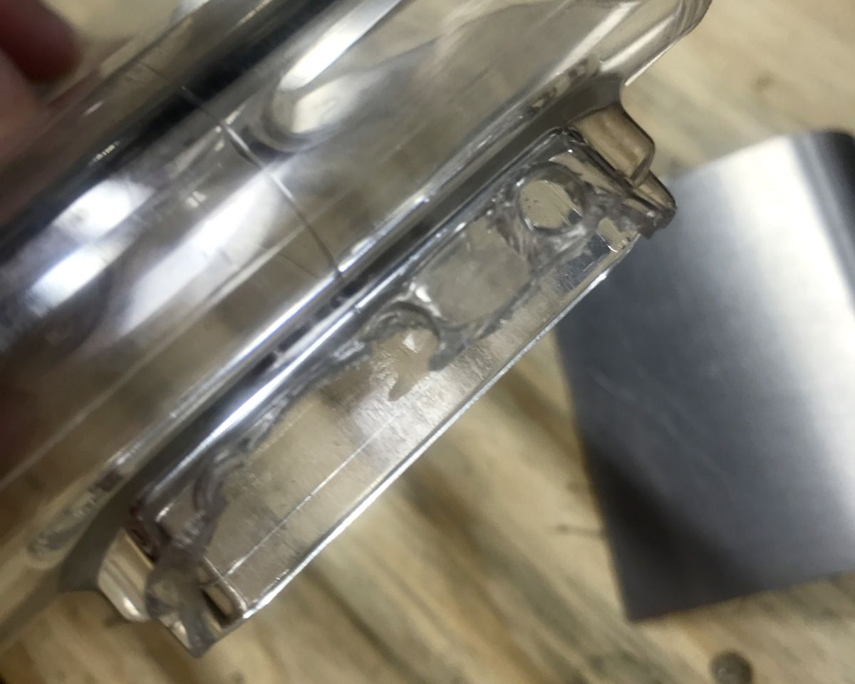

I have the other end of this problem (hinge replacement). My hinge is fine, but my acrylic kickstand is broken.

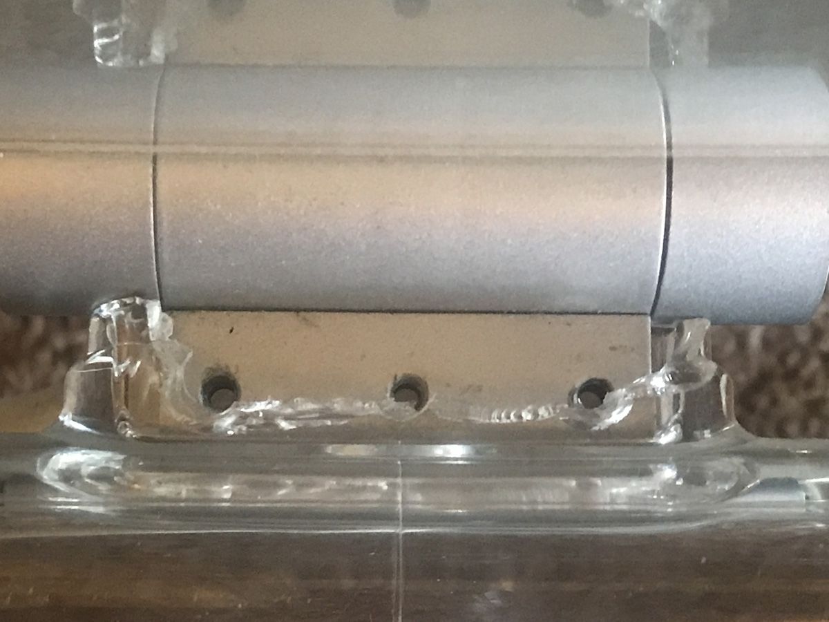

Not much left to hold on to
I removed the excess to make room for a metal shim so the screws can hold on tightly.

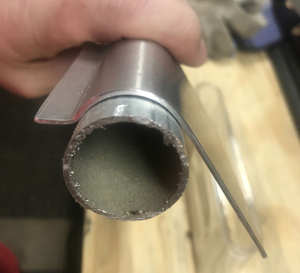

I used some flat sheet aluminum and a bench vise to bend it. I utilized a piece of pipe similar in diameter to get a curve to match the kickstand.

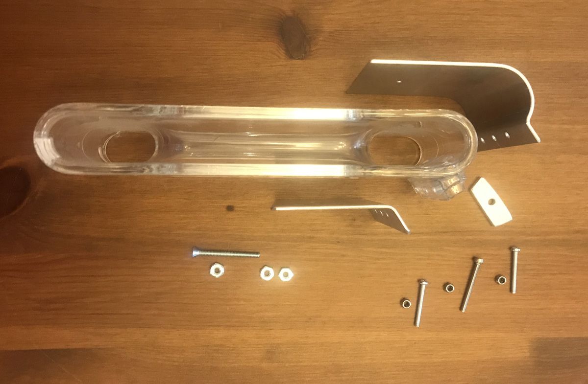

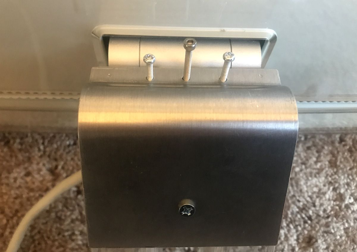

These are the parts required:

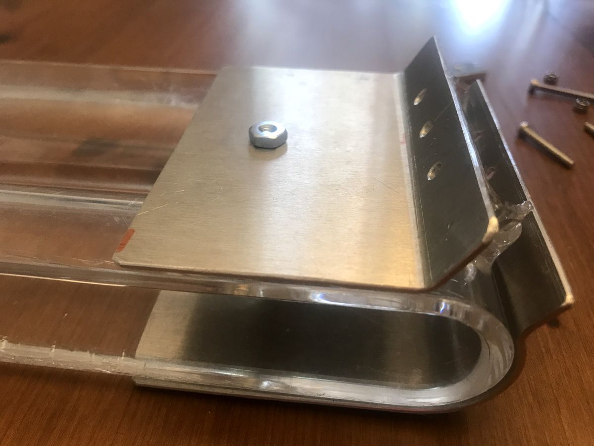

Assembling the top and bottom plate with a screw through the center hole to hold them in place
I have mismatched screw heads and lengths

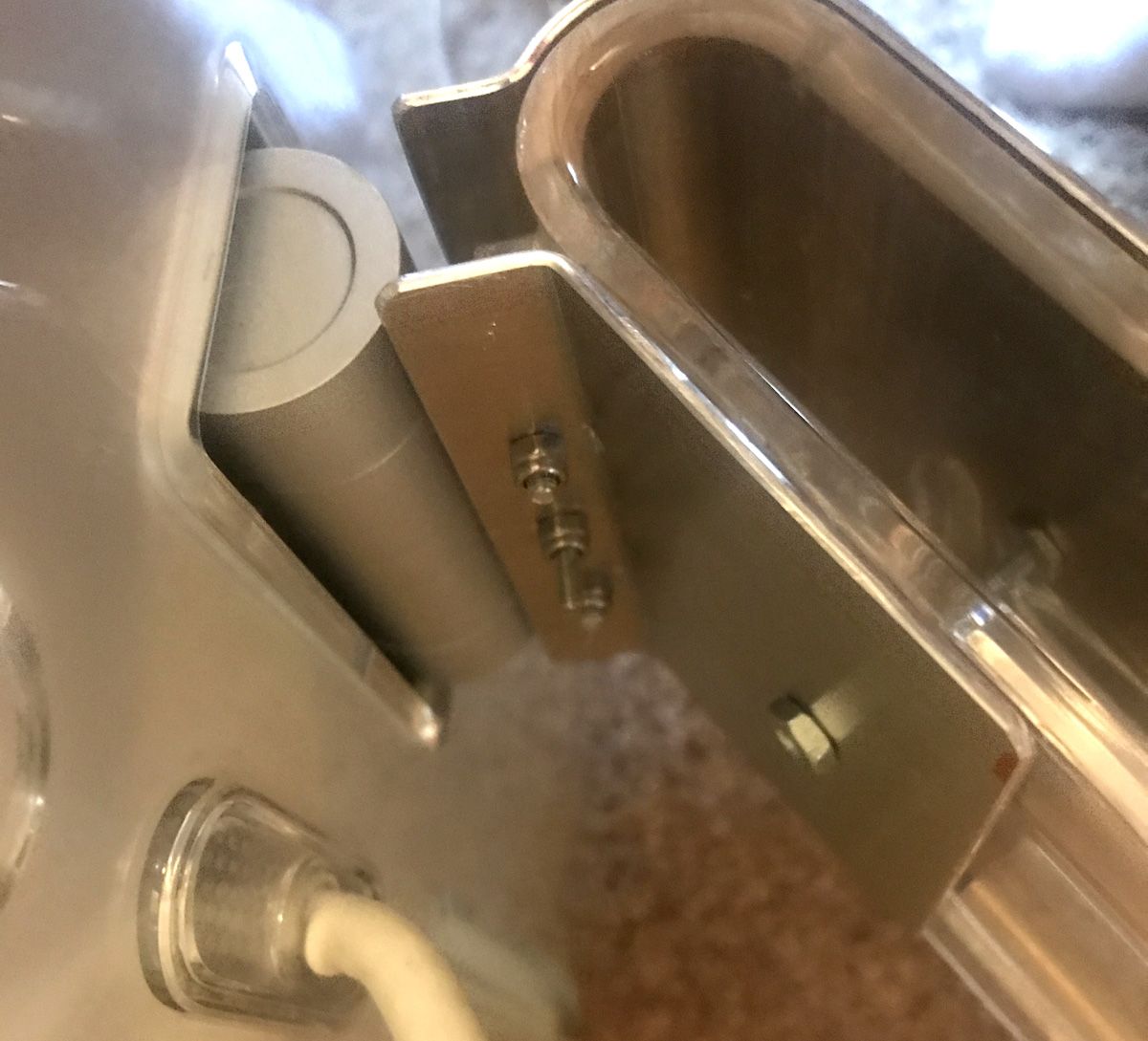

And locking nuts on the bottom

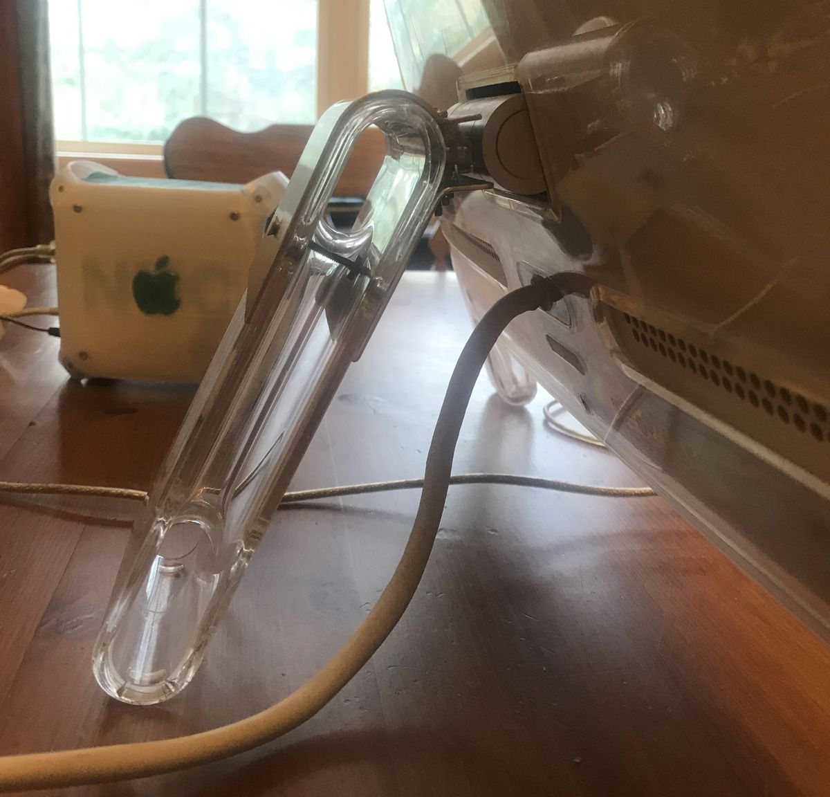

Its kickin'

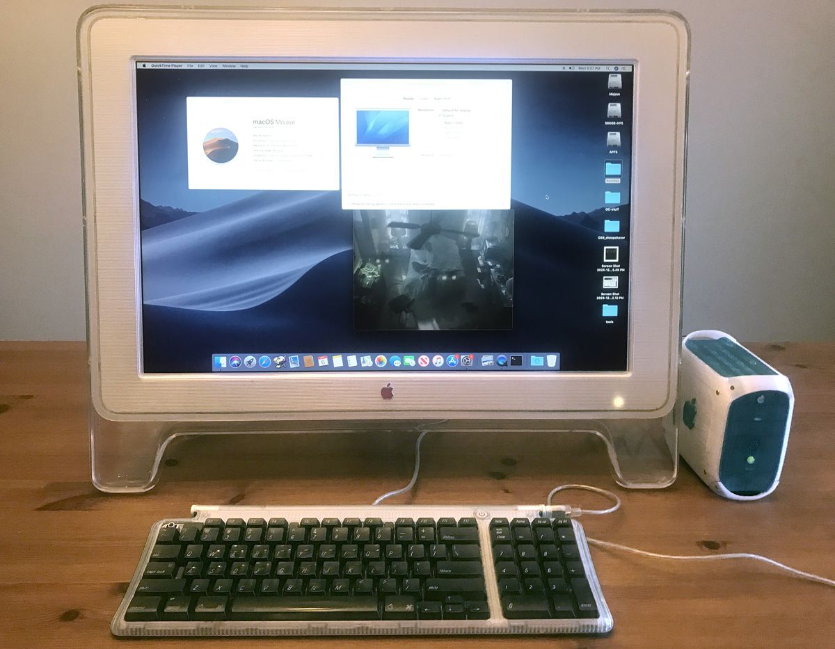

23" Cinema repaired next to the mini B&W G3
