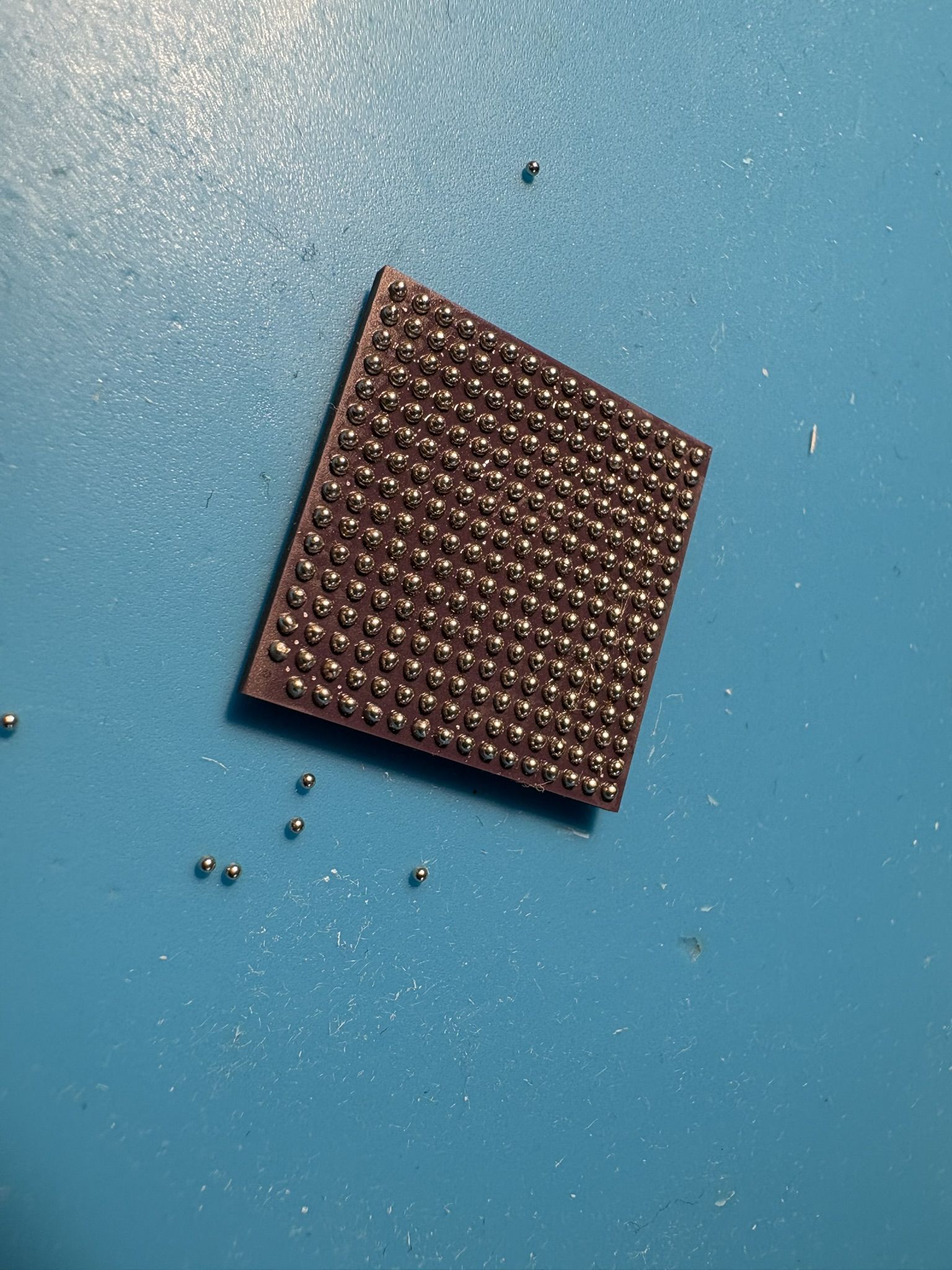

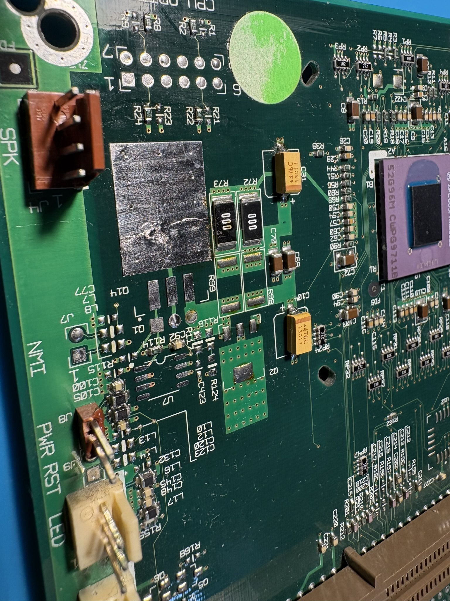

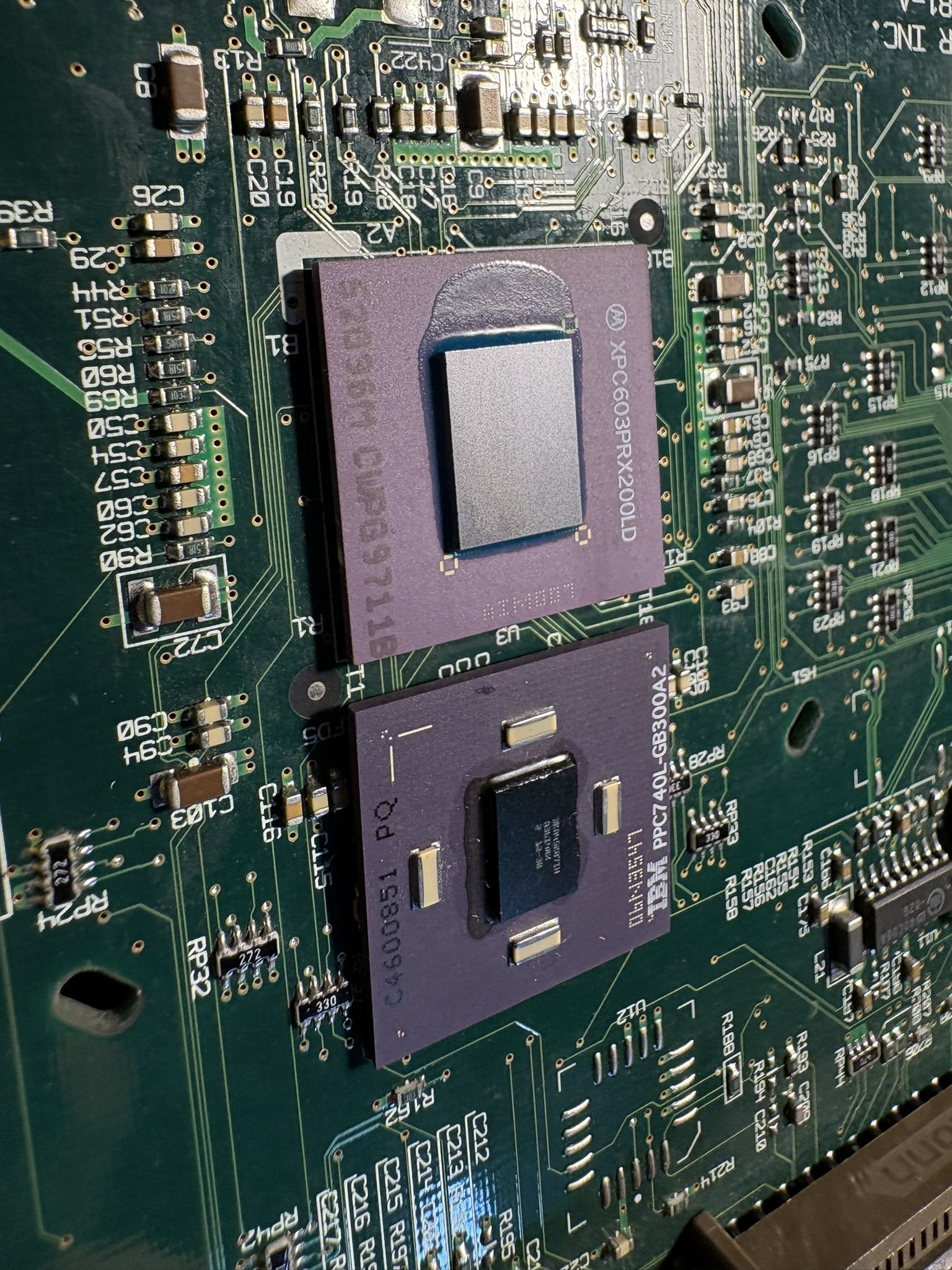

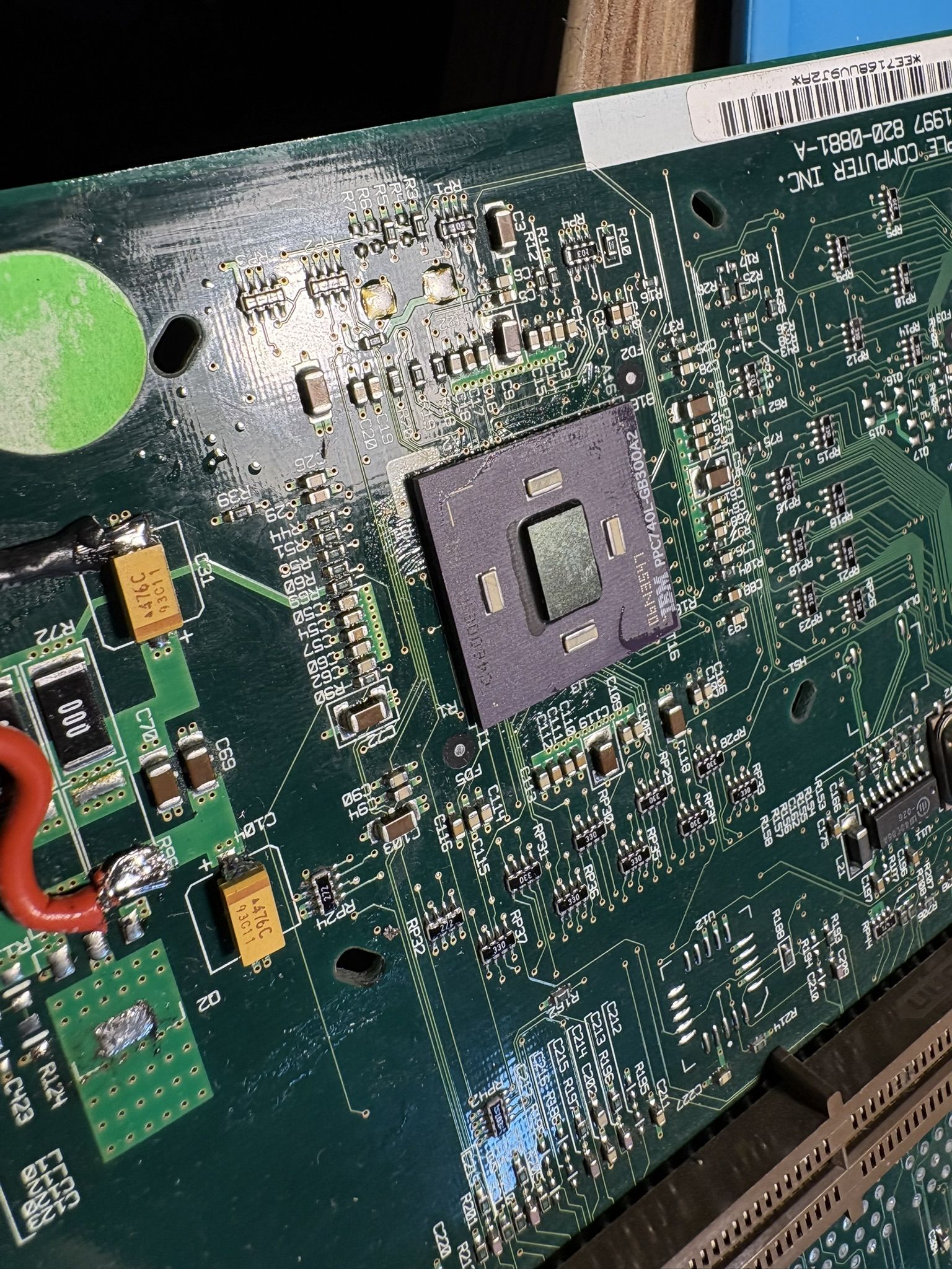

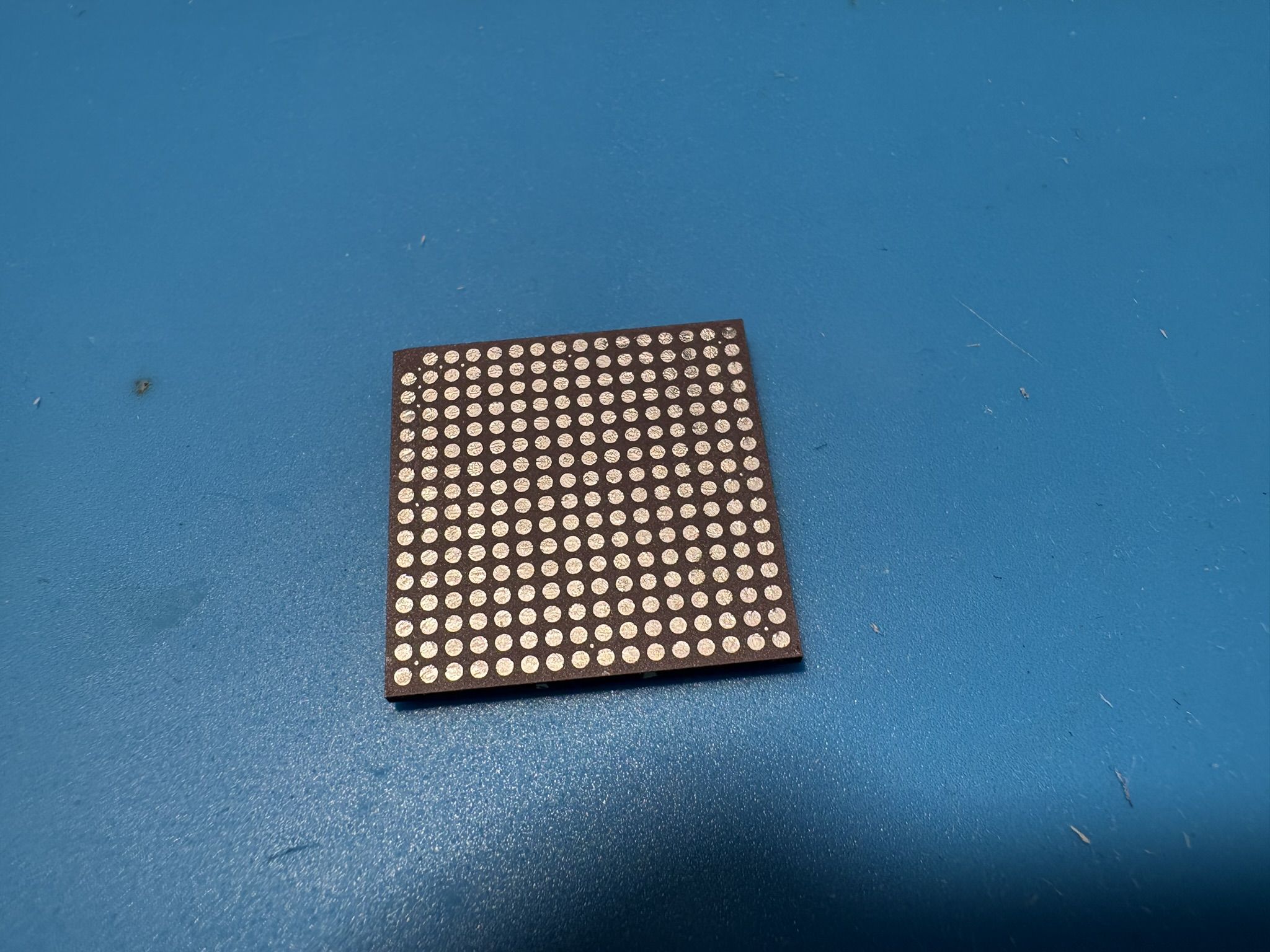

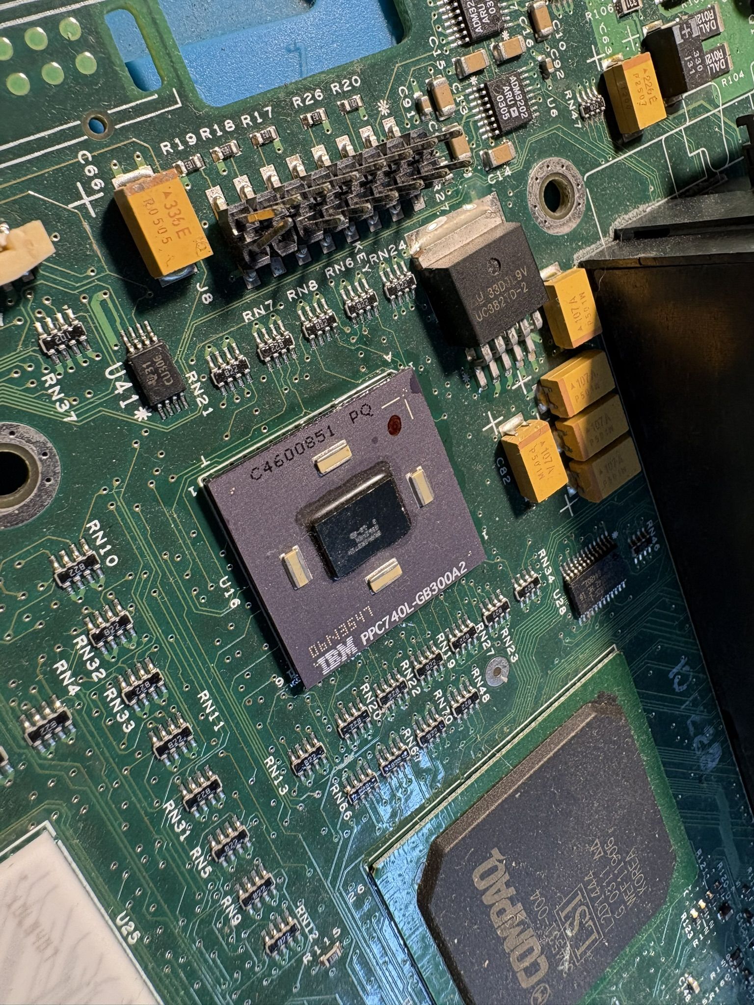

Hello from Polish Amiga enthusiast, master of soldering iron, having an affair with a couple of Macs recently!

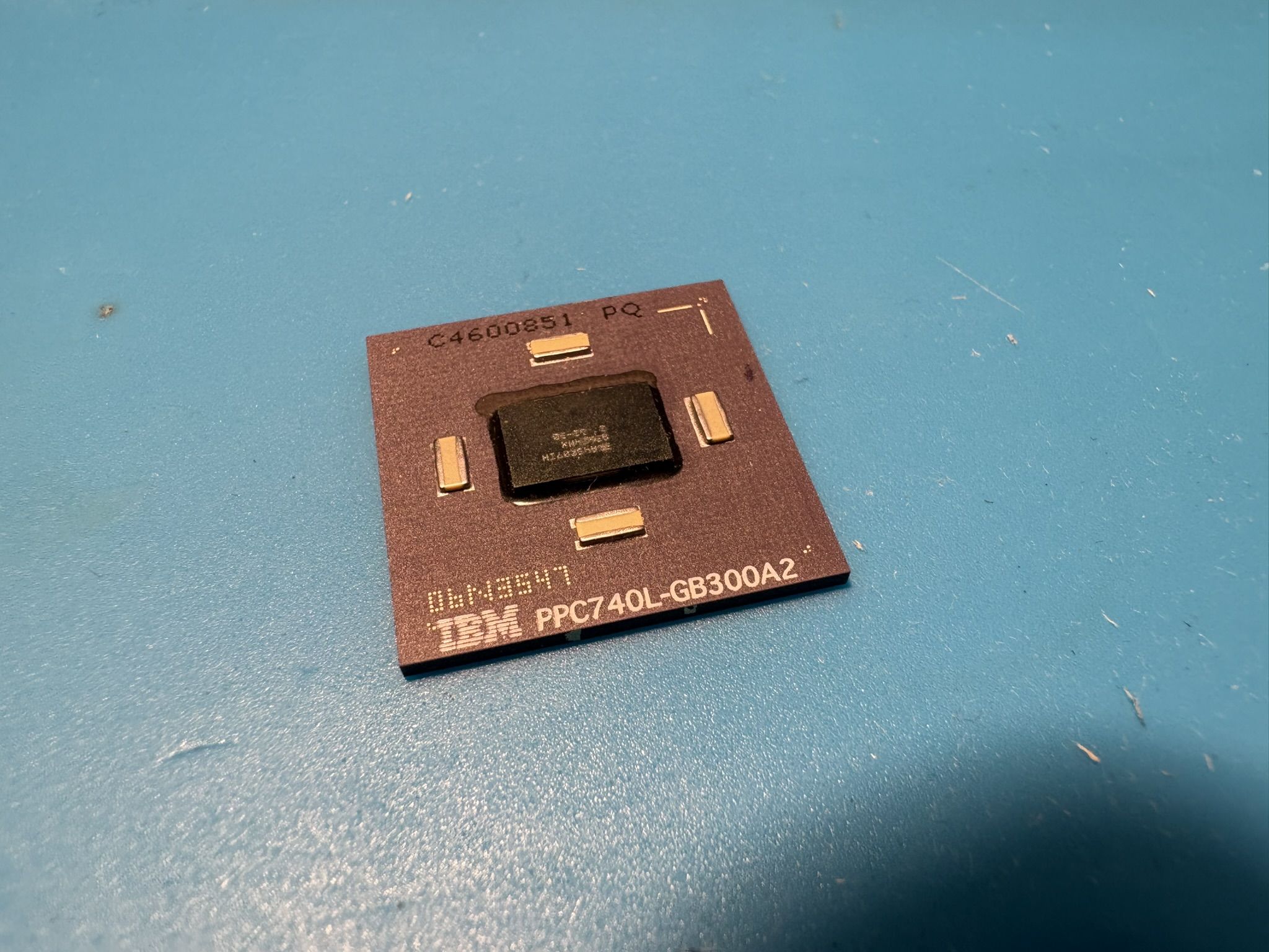

My first ever #MARCHintosh entry is a pretty hacky G3 upgrade of PowerMac 4400. Perhaps I'm the first to ever do it.

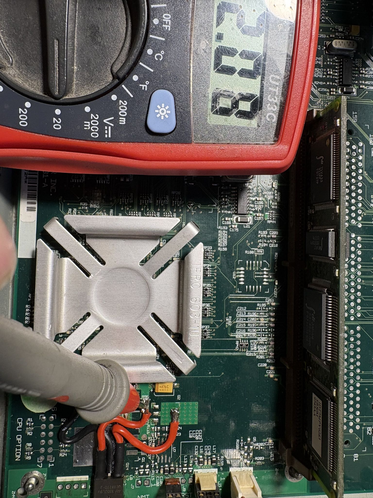

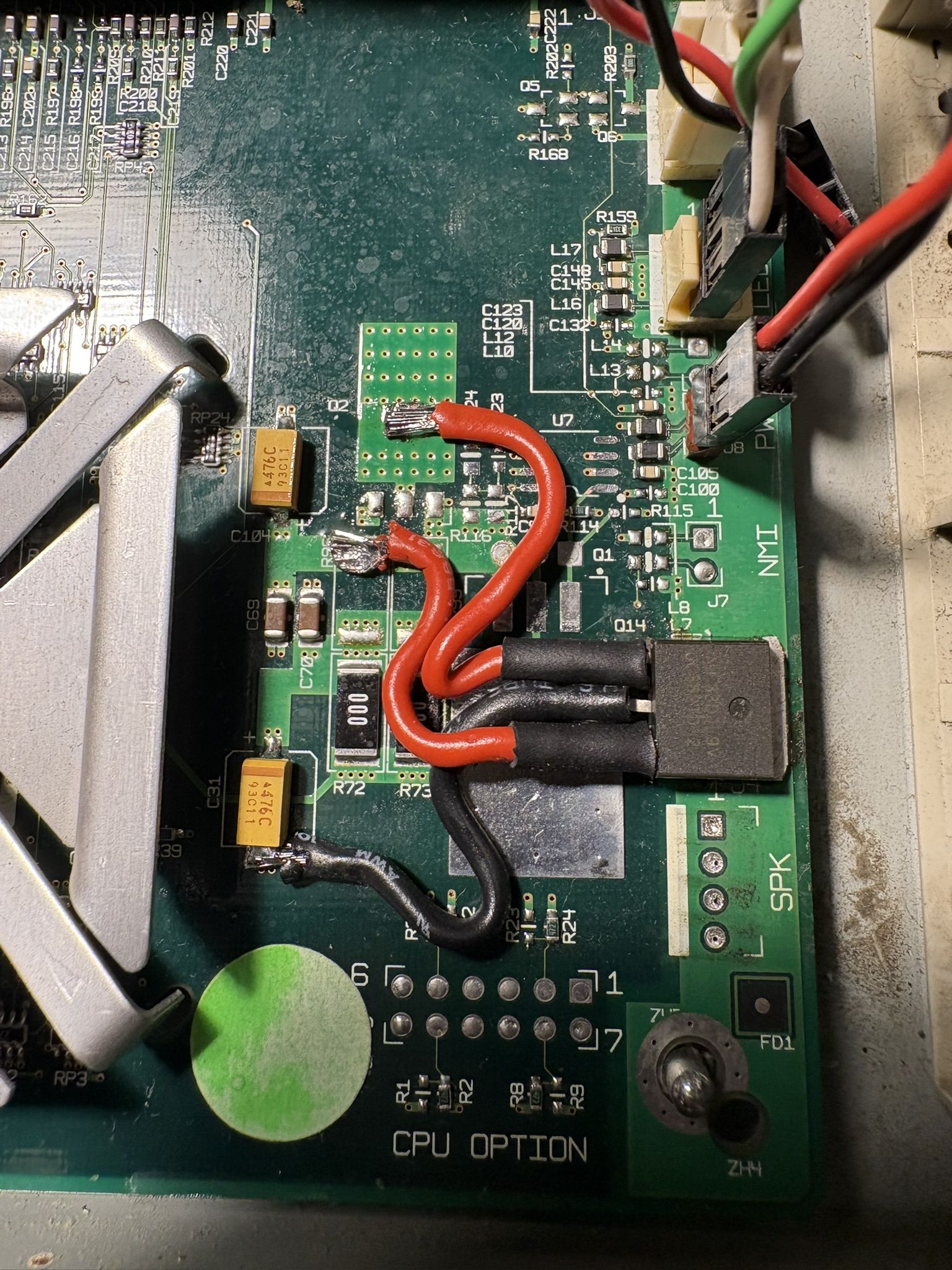

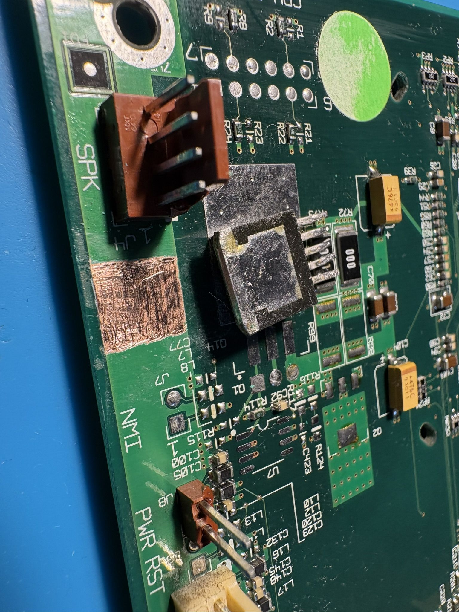

Having a parts donor board from Compaq MSA500 which ran on PowerPC 740L I decided to try and swap it in place of 603e in my PM4400.
The only issue was supplying correct voltage as the 740L requires 2.1V as opposed to 2.6V of the 603e. The solution was to bodge in voltage regulator from MSA500 board that is hardwired 2.1V regulator so no extra circuitry required.

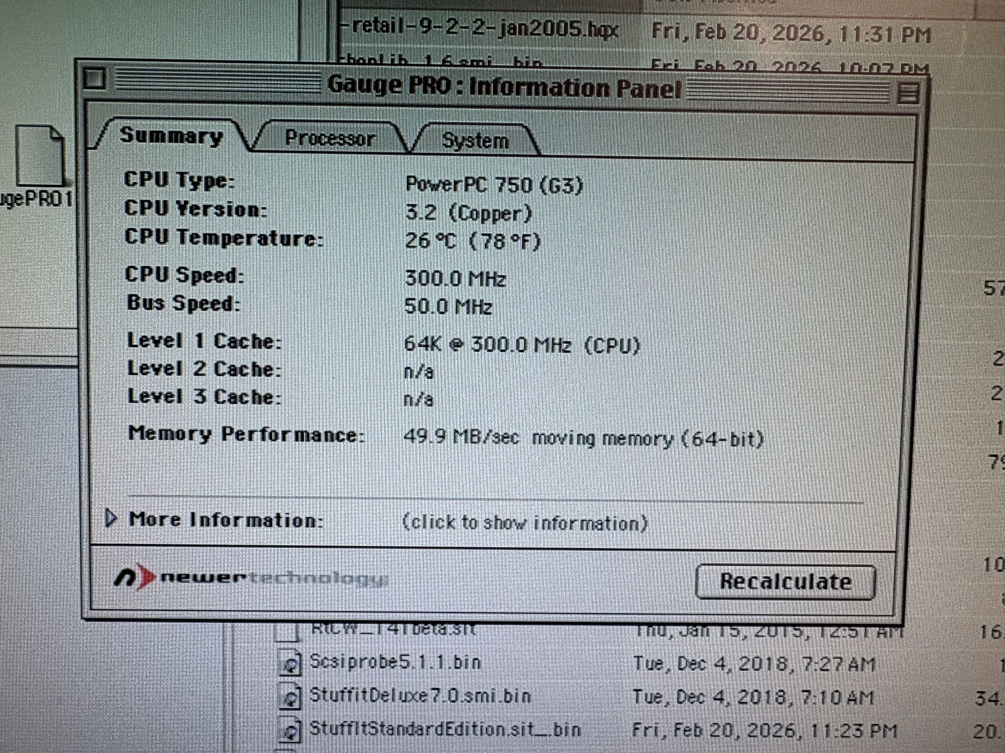

To my surprise, the Mac happily booted with the 740L, first at 240MHz that I had set the 603e previously. Later, I experimented with bus and multiplier settings and managed to get it to work at it's rated speed of 300MHz, and finally at 50MHz bus, multiplier of 8x and 400MHz speed!

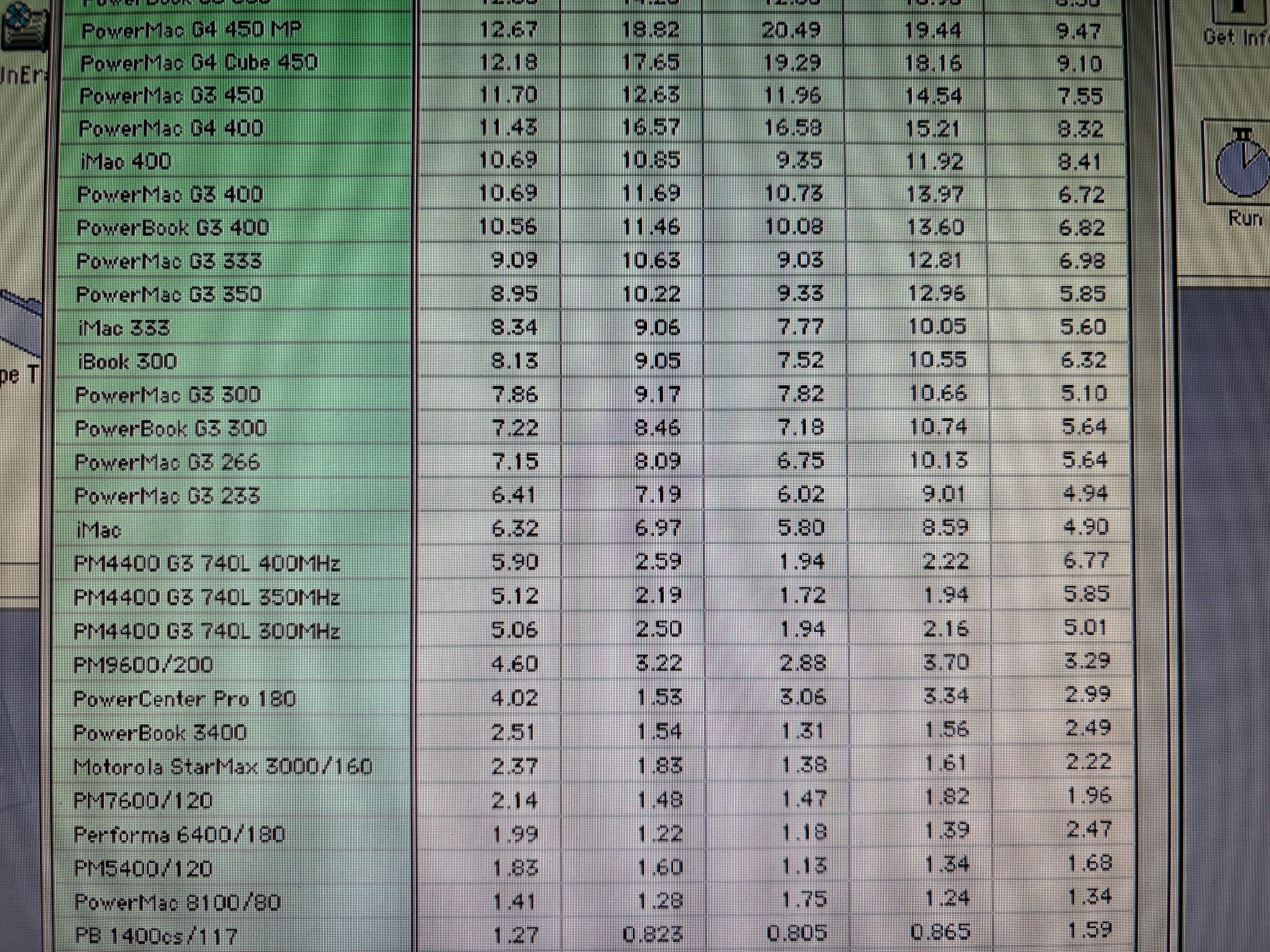

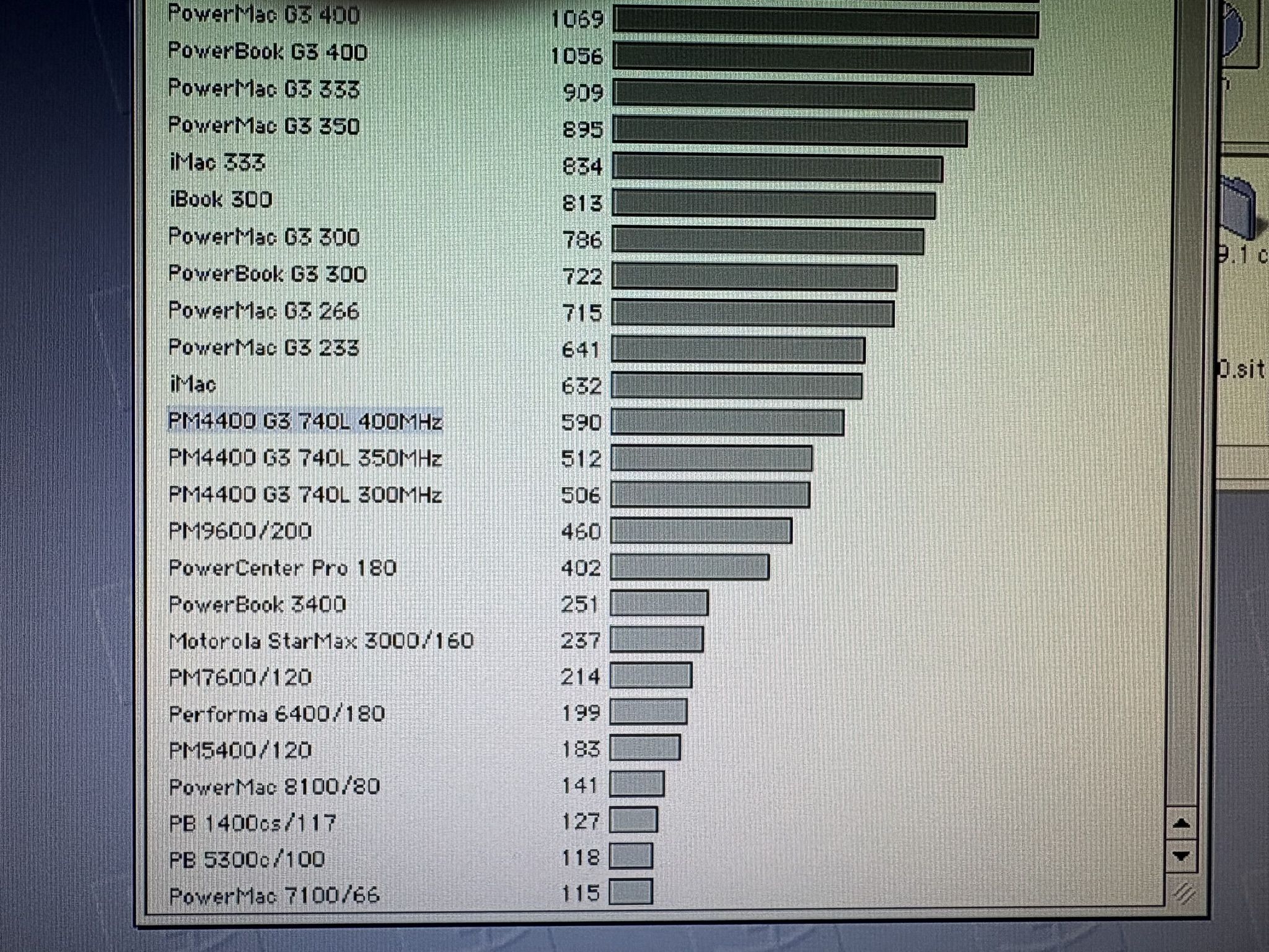

The performance is - as expected - excellent compared to 603e, especially given that the raw clock speed is doubled. The only (heavily) limiting factor is lack of backside cache, however the onboard L2 cache works (despite Gauge Pro showing it's absent) and provides some substantial performance boost.
Attached is .SIT with Norton System Info 6 results. The 300 and 400MHz run on 50MHz bus, with default 40MHz 4400 RAM timings. 350 runs on 50MHz bus and timings. The fact that 300 and 350 results are very close shows how the bus speed is critical in this system.
Can anyone send me System Info results for stock 4400/200? I forgot to run a test before upgrade...

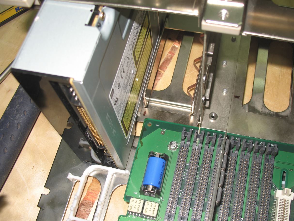

I was planning to finish up my PowerPC Challenge'd MDD'03 setup to finally get an OS9 PortlyTower/G4 graphics workstation back into the rack for this.

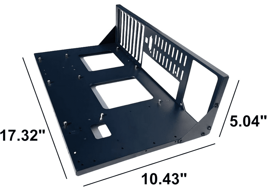

However that's not nearly as exciting as the open air ATX chassis I recently found on Amazon. Most all ATX toys terminate at the side backplane insert, but this one has provision for a PSU at that point with room to spare. So I'll be re-booting a long somnolent project instead.
Trimmed up, it should tuck right in, replacing the Netra t's plastic standoff if not sitting directly atop it. Scheduled to arrive on March 1st! :D
PEx + Sun Netra t 1125 = Sun Macintosh 1125/4U​
Metalworking aside, the computer part of the challenge will be getting it to boot up into 4U PEx/G4/800 mode. PEx board's tested thanks to a ROM SIMM recreation by my buddy @trag Really looking forward to testing the several accelerators I've collected along the way in the 22+- years I've had this lovely 9700 Prototype MoBo in my grubby little paws!
