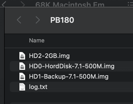

Thanks for the reassurance guys, I just cracked it back open and this time i left the 500MB boot image in there and then ADDED an additional 2GB image and that has showed up on the desktop. SO I am copying the files from the boot disk to it then I will try rebooting with the 2GB as the startup disk. If all goes well I will then replace the boot disk on ID 0 with the 2GB one and see what happens.

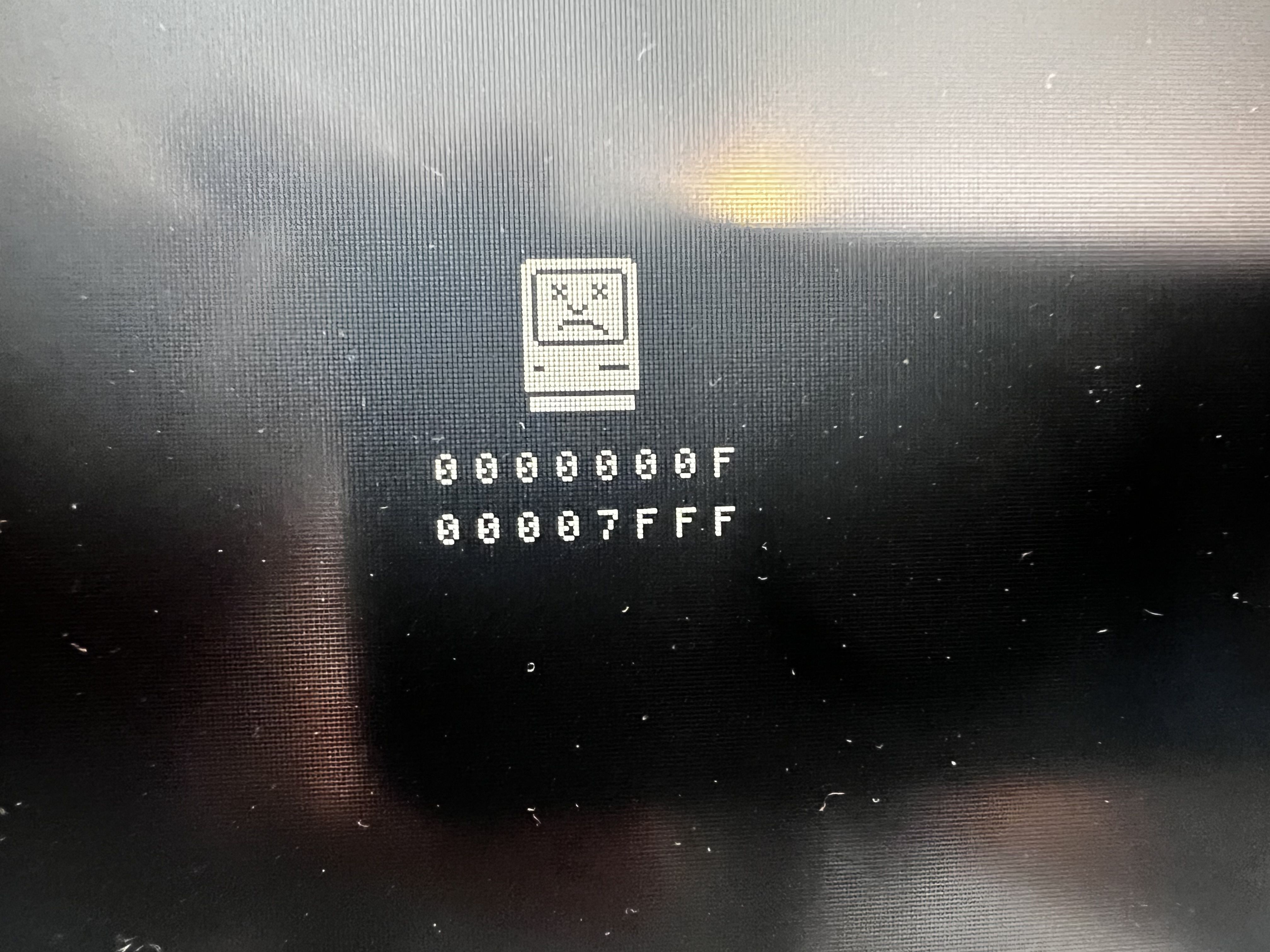

OK it's confirmed now. My PB180 will not boot form a 2GB disk image no matter what SCSI ID it is on.
The disks all mount on the desktop but setting the 2GB as the startup disk gets a sad mac.
I tried it on ID 2 and ID 0

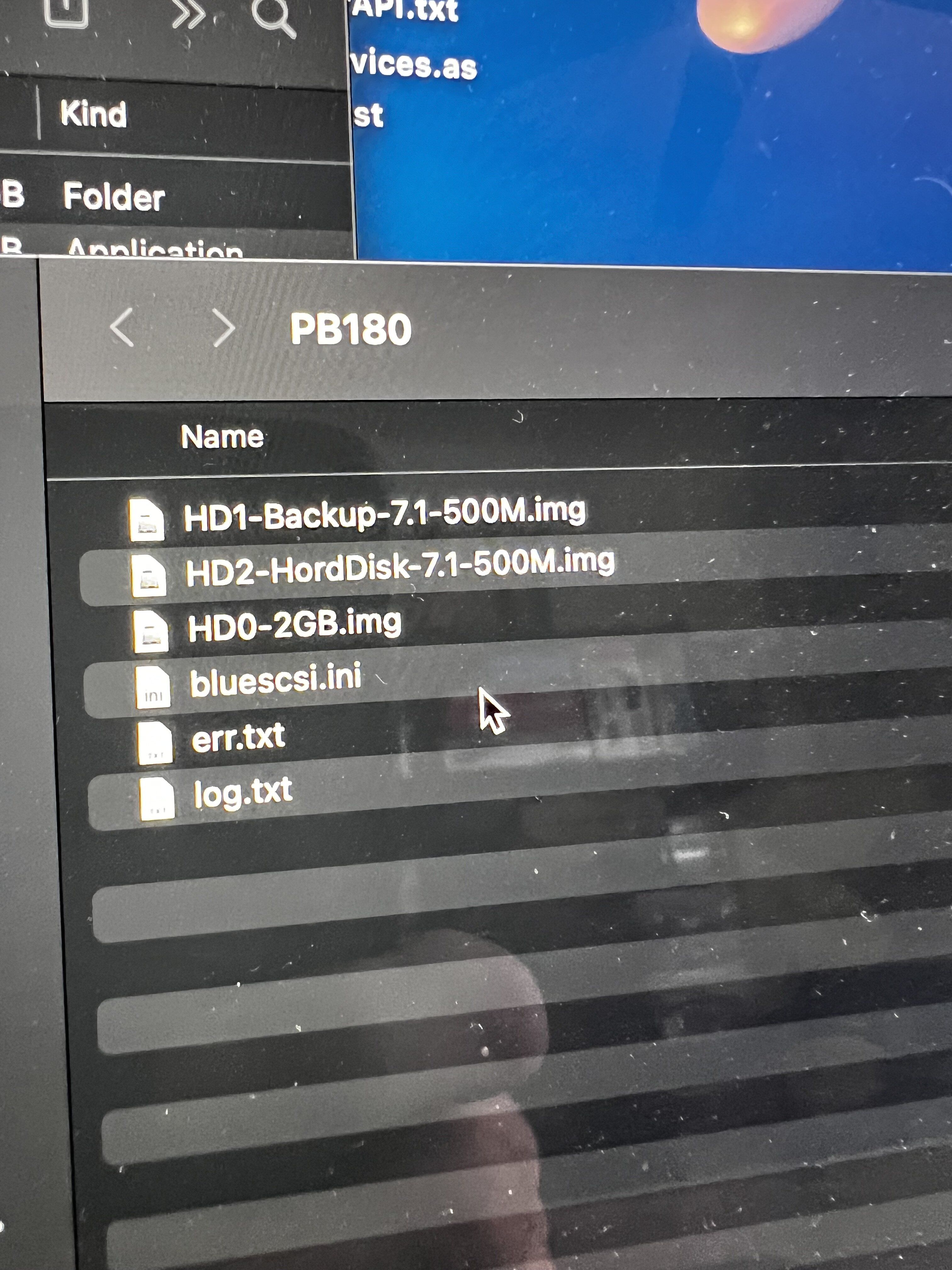

What is in that ini file? The PowerBook shouldn't require one (not sure if that's causing your problems or not). Maybe try removing it?
Reactions: eric
Few things - please delete the ini file, none of that is needed unless it is a Mac Plus or Mac Portable.
Second please update to the latest version of BlueSCSI v2
We should take a step back and just start with the initial Trouble Shooting steps in the wiki - be sure to go through each (please don't skip any) and then post your log or err log once done.

The one I do have is only a month or so old from Android and it looks like its got the April 10, 2023 firmware. the reason it has that ini is i also have a Portable and a plus so i used the same disk images and files.

just found this thread on the error code I was getting: https://68kmla.org/bb/index.php?threads/mac-iici-startup-sad-mac-error-code-0000000f-00007fff.6165/
Looks like it might be a system file issue.
The system on my current 500MB disk image is system 7.1 with the required system enabler.,
Could simply copying that system file to the 2GB Disk image be a problem? Would I need ot actually run the installer and do a true install onto the new disk image?
System Enablers can be copied from another drive, it does not need to be placed by the installer. However, a normal error for a wrong or missing enabler is simply being told that the System is incompatible with your machine, not the Sad Mac screen. :(
I’ll probably open it back up again tomorrow and remove the init, log, and error files and add an additional 2GB image to experiment with since it mounts ok. Not sure about updating the firmware. I wonder if the April 10 version that’s on it is recent enough. The main concern is is probably have to pull the BlueSCSI out to do it and not sure if it’s worth opening the machine back up that far since i can just slightly life it to get to the sd card only.
I wouldn't be very surprised if the Mac Plus fix was causing trouble here. The main concern with taking it apart too many times is damage to the interconnect cable. It's deceptively fragile! Internal sound doesn't work on my 170 anymore, and it quit working right after taking it apart. I highly suspect internal damage to that cable is at fault. It's been known to happen.
