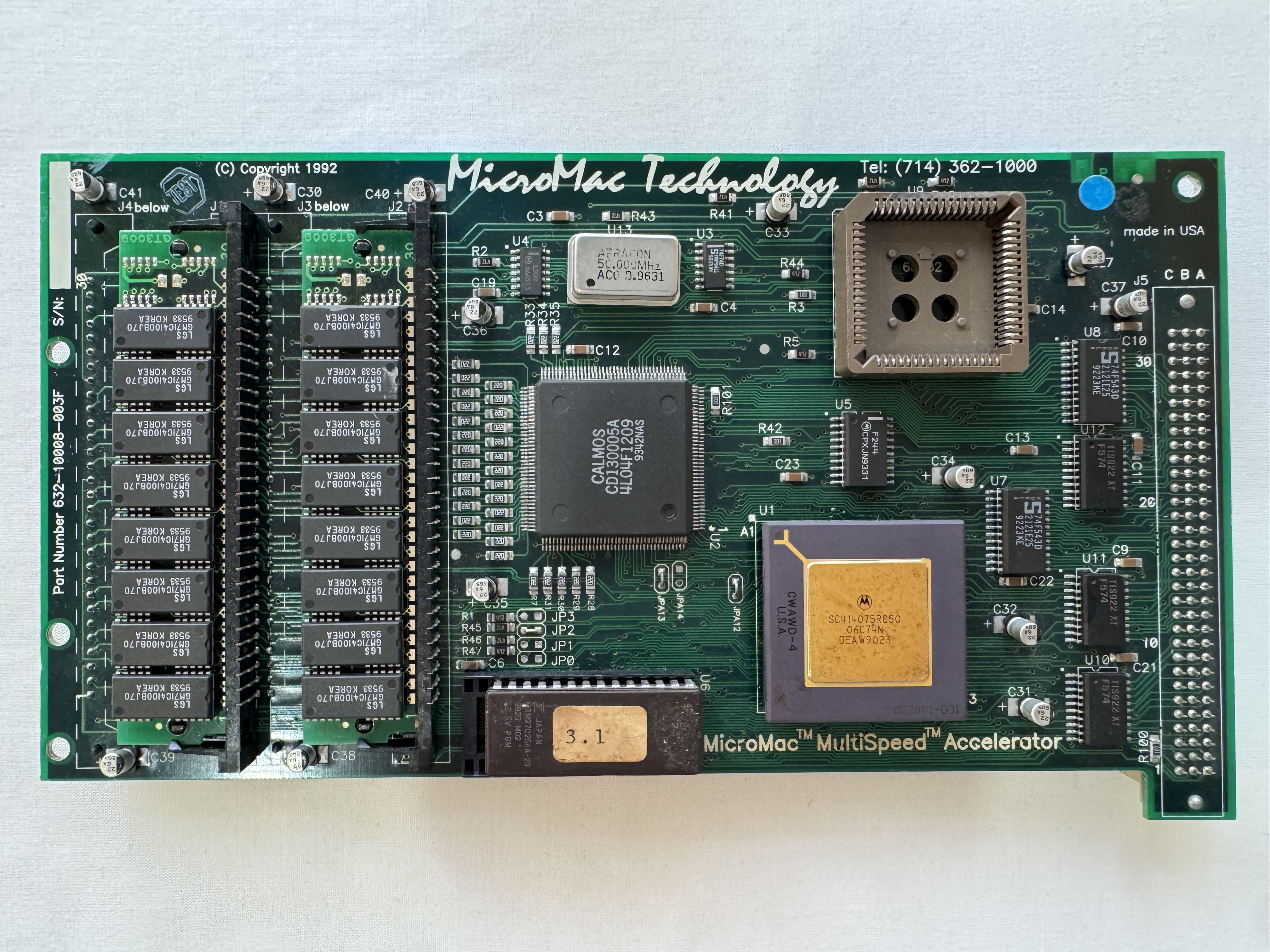

I could use some help getting my Accelerator fixed.

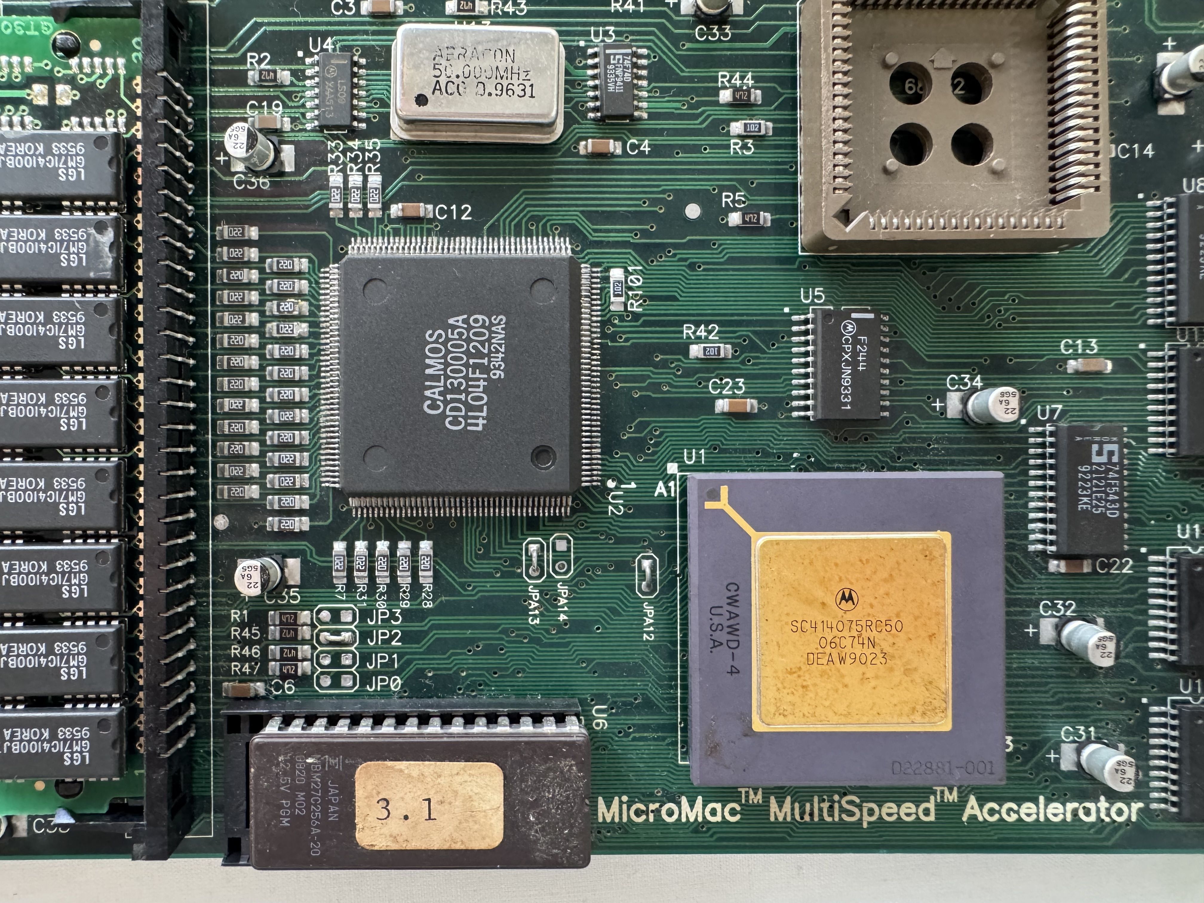

I recently got a Mac Plus with this MicroMac MultiSpeed Accelerator installed. I'm, however, having issues booting from it.
The initial boot screen is fine, but when the logo is supposed to animate off-screen, I get a snowy screen instead, and the system locks up.

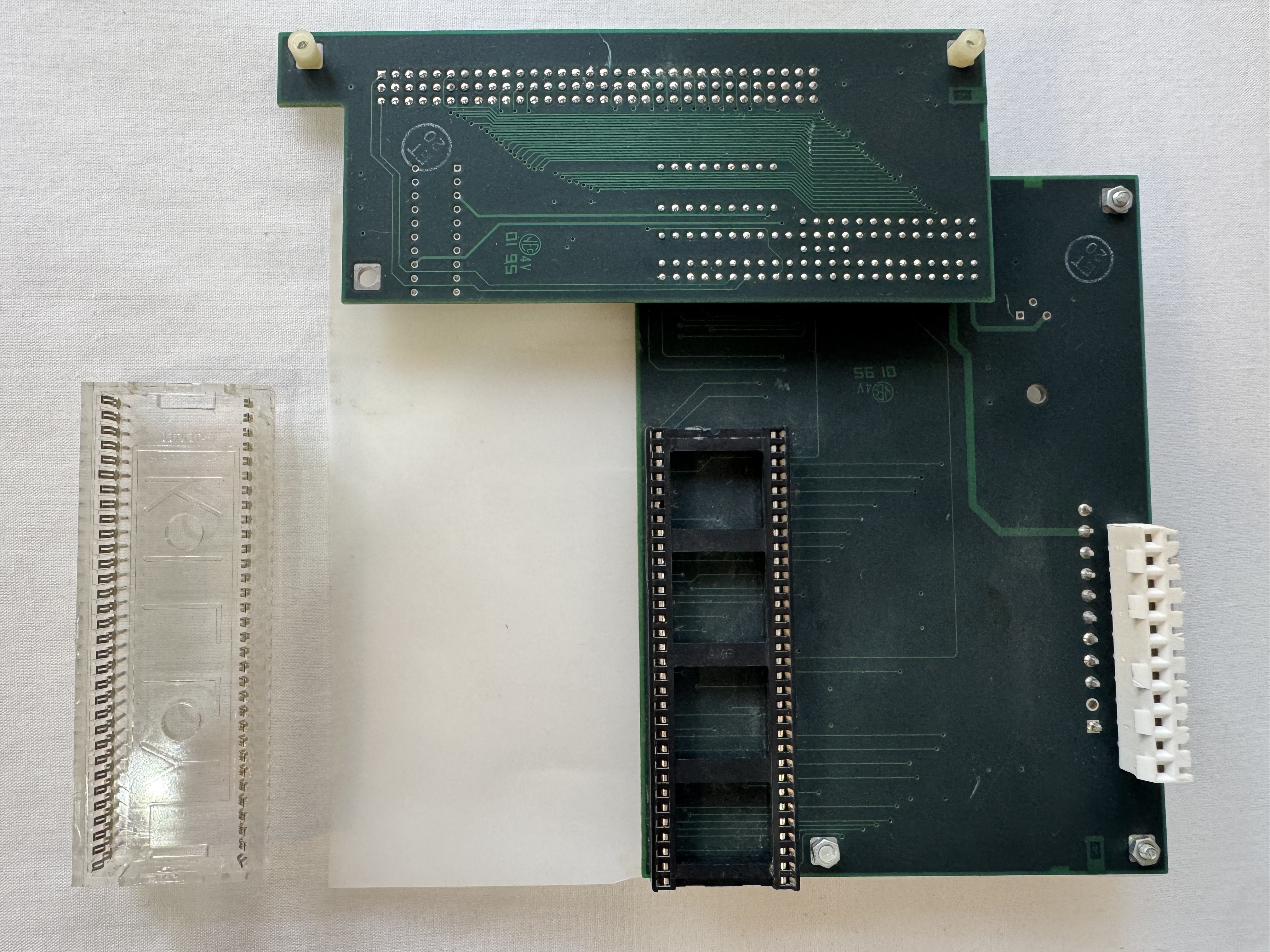

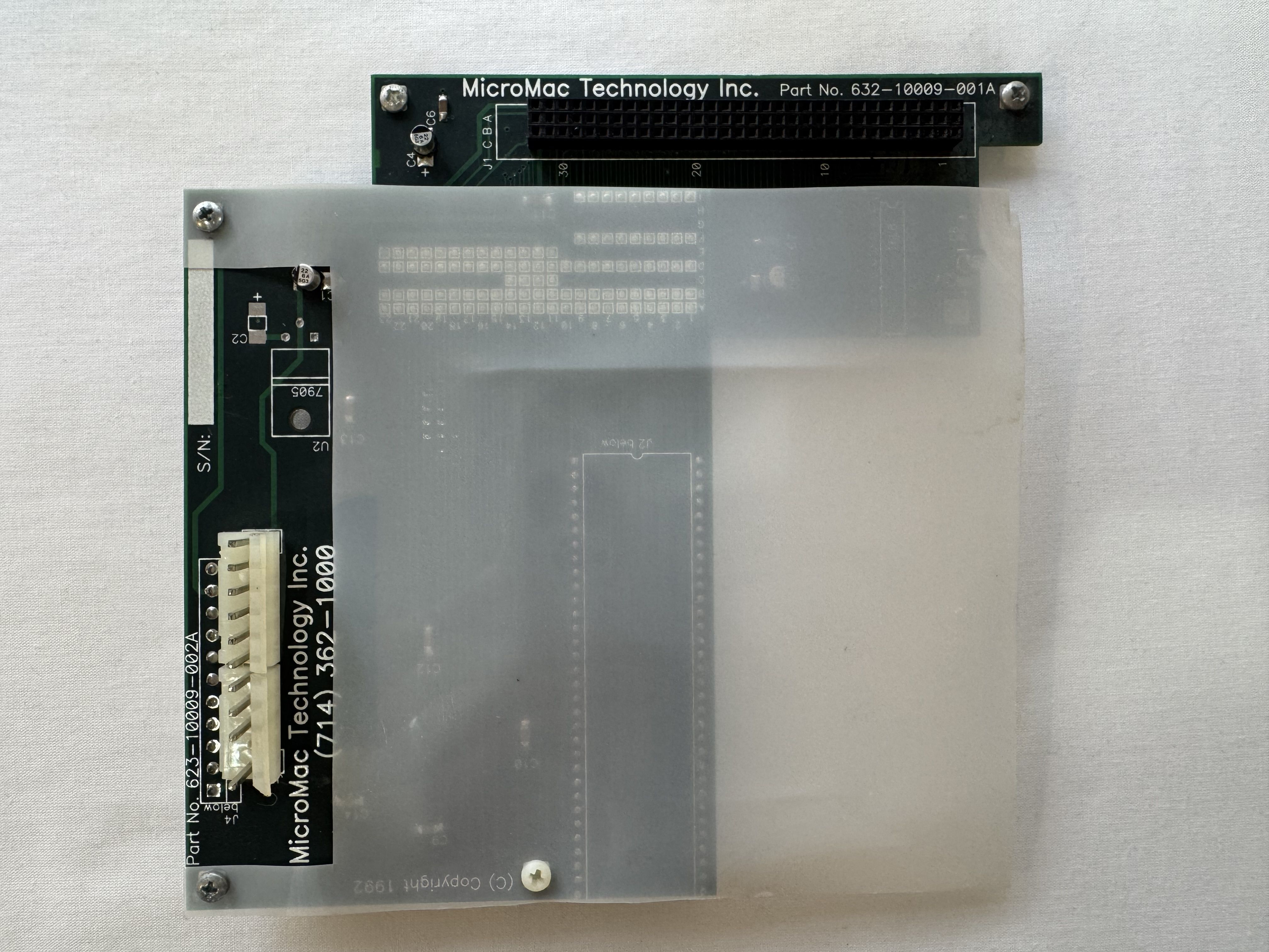

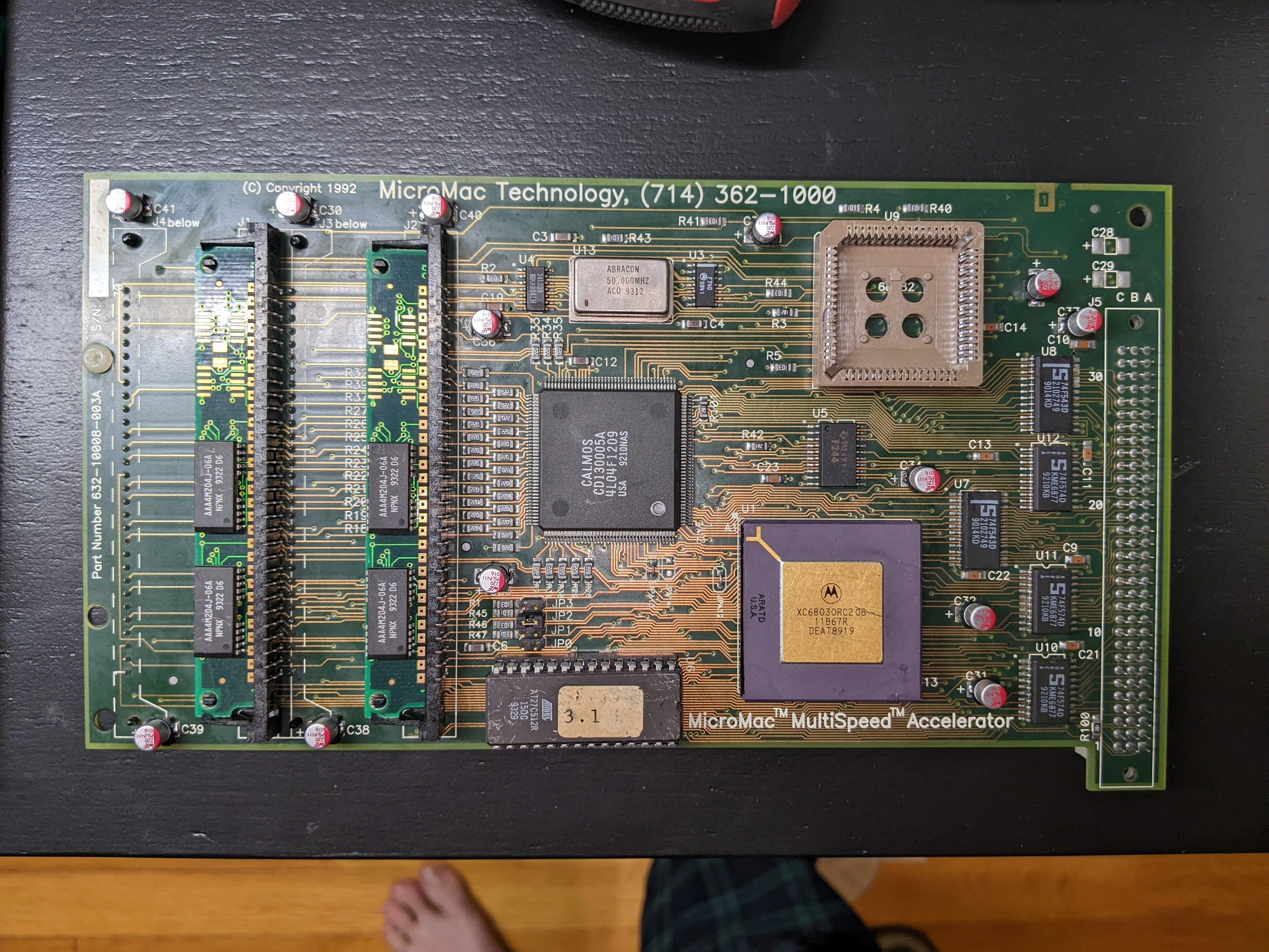

Below are the images of the board from when I first got the system and pulled it out.

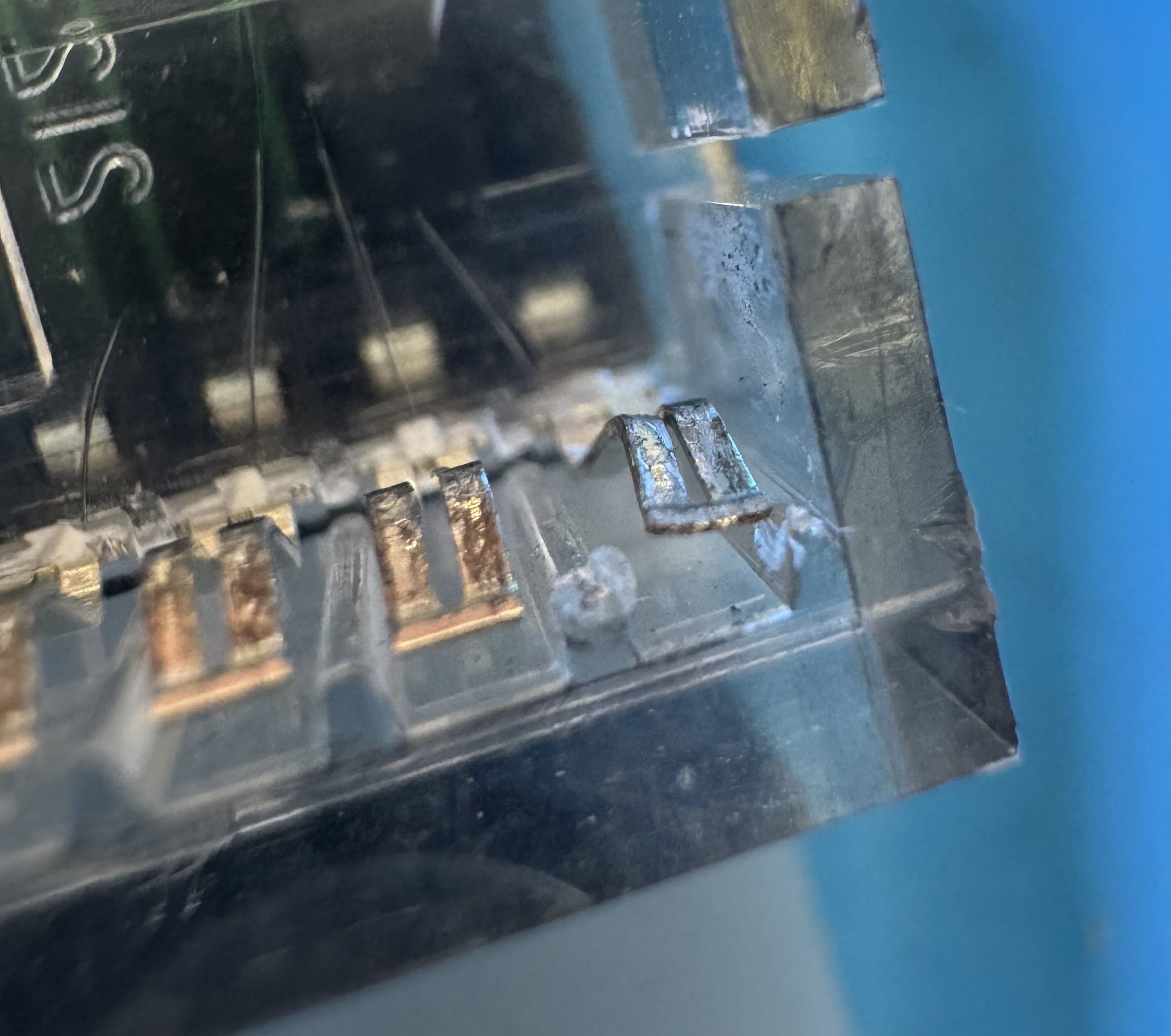

Initially, when I received the system, it wouldn't boot at all. Upon close inspection, I noticed the CPU pins were bent on the socket. My guess is that the previous owner tried to do some troubleshooting by pulling the board off and back on, which caused the pin to be bend.
I carefully managed to bend the pins back into place.
I noticed some minor cold joints at the cable connector, so I resoldered those.
I pulled the ROM chip out to verify it was reading well; when I did so, I noticed one of the legs was barely hanging on due to rust, so I burned and put in a new eprom.
This finally takes me to where I'm stuck now.

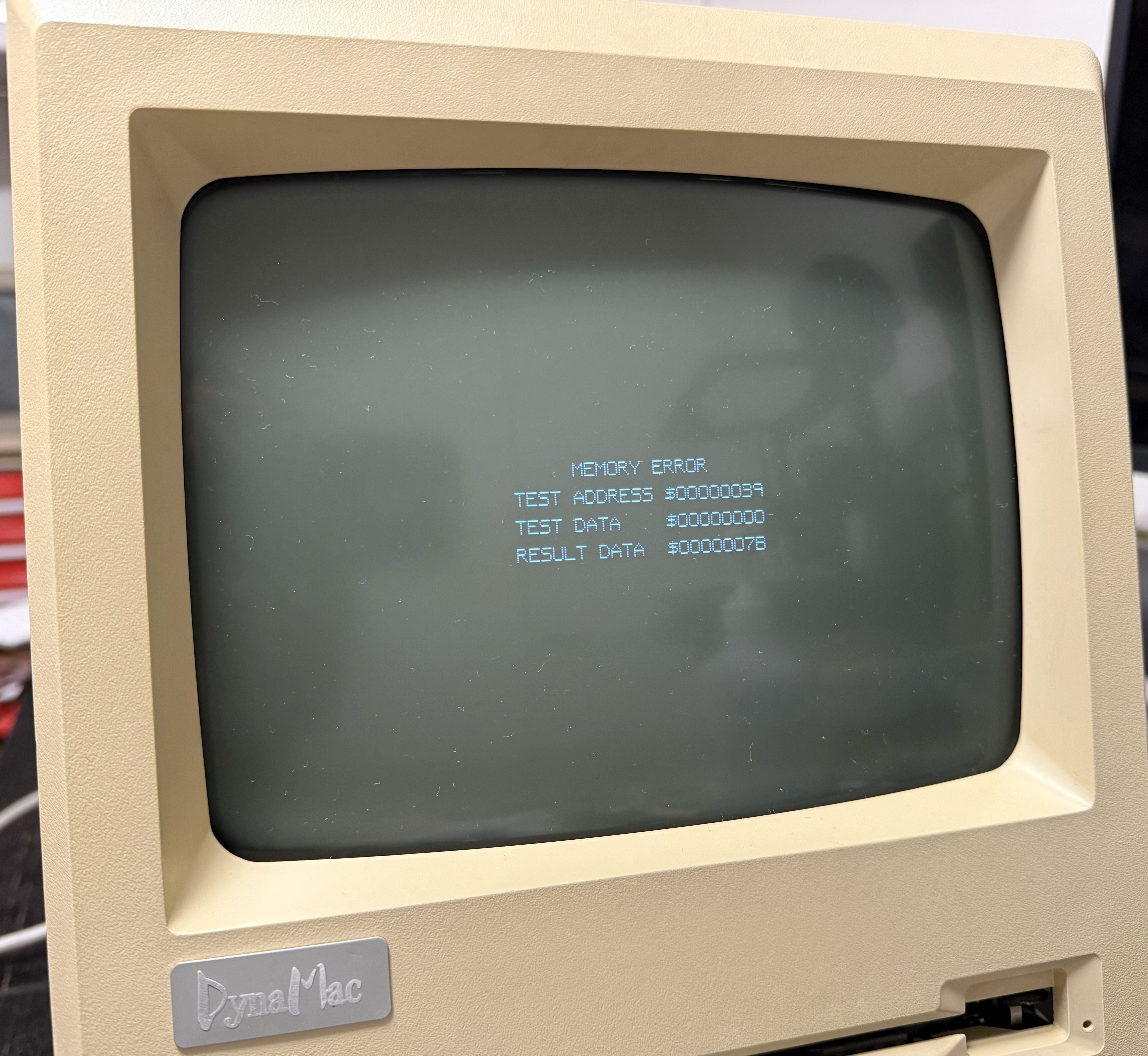

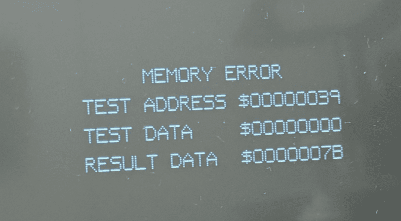

One interesting thing is that if I replace the 4MB sticks with 1MB sticks, I get a RAM error on boot.
The error reads
Code:
MEMORY ERROR
TEST ADDRESS  $00000039
TEST DATA     $00000000
RESULT DATA   $0000007B
The error varies on every boot; "test address" is between 1 and 31, while the "result data" is between 1 and 7B. I initially thought this was probably expected as the jumpers are most likely configured to only accept 4MB sticks, and I can't find any documentation on the jumpers. I recently found this post where the seller states he has 1MB sticks in there, and the jumper settings are the same. So perhaps this clue is meaningful, and there's some error with the RAM (e.g. bad trace?)

I figured out why I was getting the MEMORY ERROR when trying the 1MB sticks.

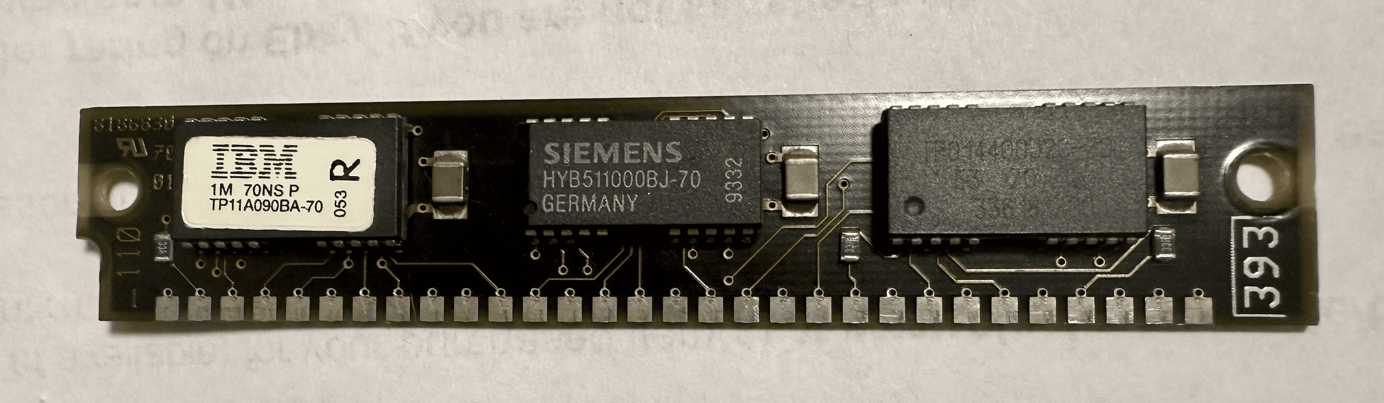

It turns out all the different RAM sticks I tried were too slow, the RAM on the acceleration card needs to be really fast.
I tried with these 1MB IBM sticks, and the system was able to show the MicroMac logo instead of the MEMORY ERROR message.

My guess is that one of the other components on the board has gone bad. Here's a quick lick of all of them:
2x - N74F543D - Scientific Solutions Octal registered transceiver, non-inverting (3-State)
1x - F244 - Motorola MC74F244DW Octal Buffer Line Driver
1x - LS09 - Motorola 74LS09 Quad 2-Input AND Gates with Open
1x - 74F74D - Scientific Solutions Dual D-Type Positive Edge-Triggered Flip-Flop
3x - F574 - Octal Edge-Triggered D-Type Flip-Flop with 3-State Outputs
1x - 68030 @ 50 mhz
1x - CALMOS CD130005A
These boards use the same CALMOS chip and software used on the NewLife accelerators. I did manage to find instructions for those. It seems the current jumper settings is set to support 4MB or 16MB total. If I want to use 0MB or 1MB, I'd need to change the jumper settings.

Also, that 030 being labeled as a 50Mhz part makes me wonder if that's the original CPU. I'm pretty sure your accelerator actually runs at 25Mhz even though there's a 50Mhz oscillator on it. I think the Multispeed was only available in 16Mhz, 25Mhz, and 32Mhz speeds. A lot of these accelerators overclocked their CPUs, not underclocked. If MicroMac had enough 50Mhz 030s laying around that they could put them on 25Mhz accelerators, then I wanna know why they put 33Mhz 030s on two of my 50Mhz accelerators 😆 If that's not the original CPU, it could be a remarked one. Even if it is, I wouldn't think it would have trouble running at 25Mhz, but trying a different CPU is an easy thing to do just to rule that out. My Multispeed has the same 50Mhz oscillator, but the 030 is marked as a 20Mhz part.

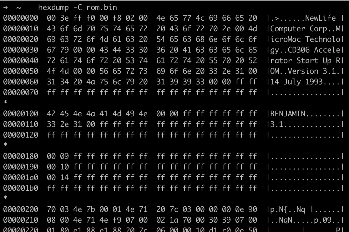

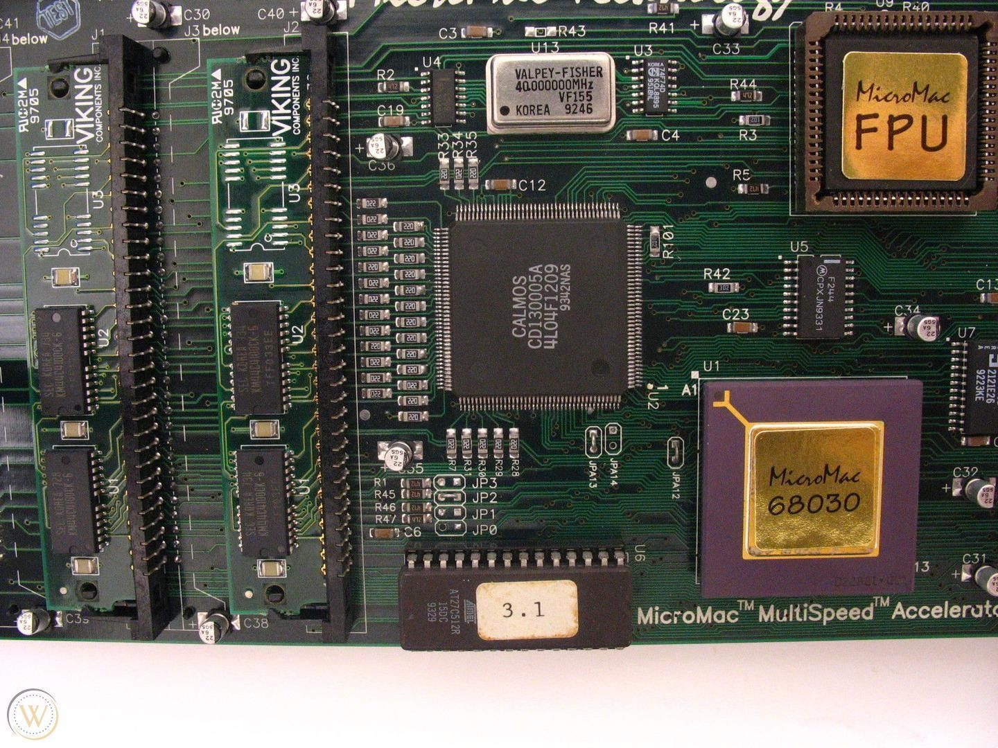

Also, I'm pretty sure these are NewLife accelerators that MicroMac bought/licensed. Here's the top of ROM 3.1:
I ran across someone at VCFMW last week who had one of these in an SE with ROM 2.7 and his splash screen said "NewLife" instead of "MicroMac", even though the PCB said "MicroMac" like yours and mine.

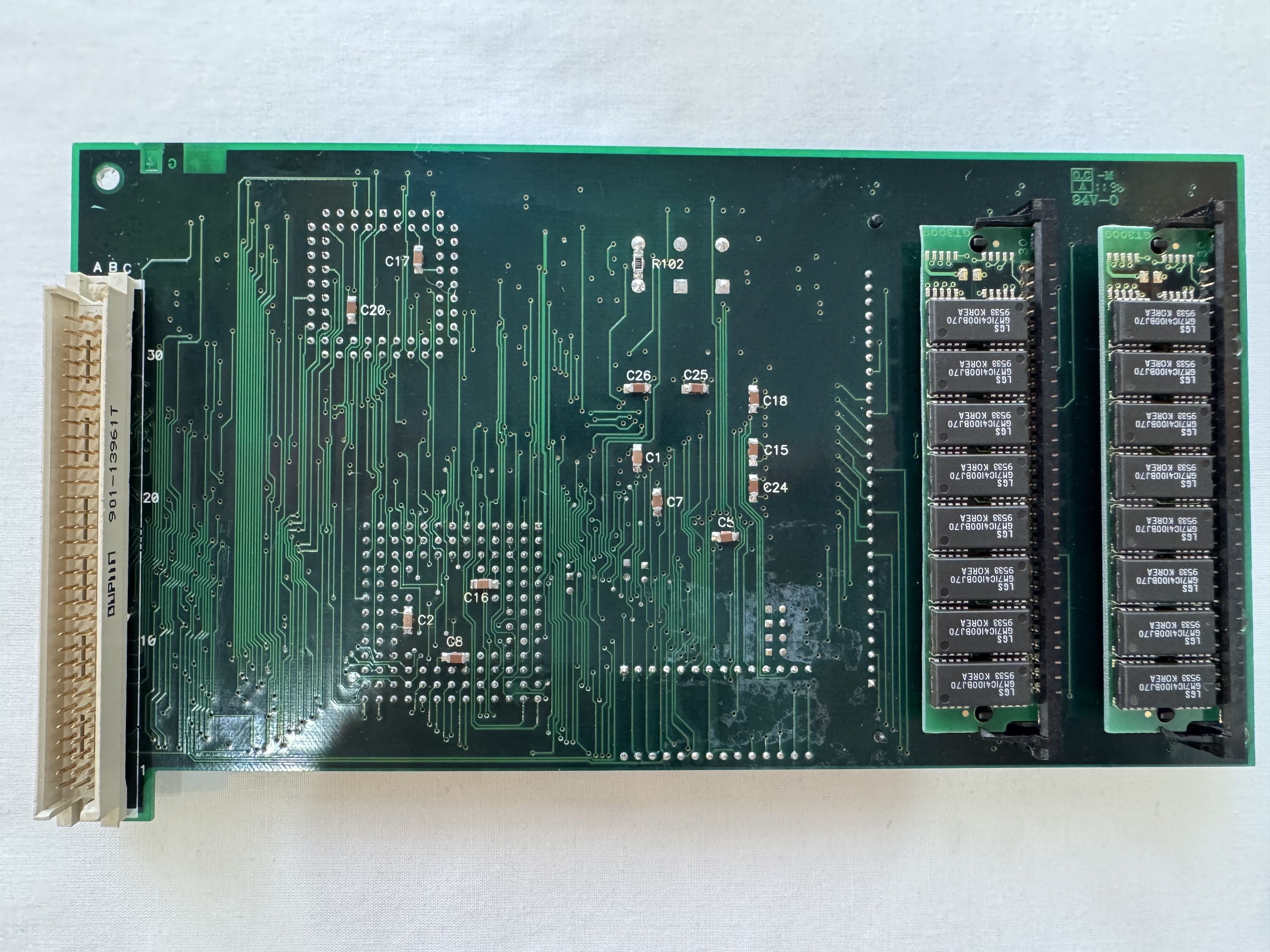

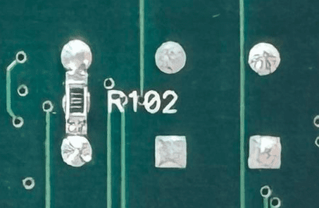

Is R102 connected to the oscillator's ground pin? I can't see if there's a trace in that gap there.
Mine doesn't even have R102...looks like a pulldown resistor on the oscillator's output? Yours looks newer than mine...
Great callout! The one thing that catches my eye is the date code on that oscillator, 9631, which is 31st week of 1996. The other chips are labeled between 1992~1993. This leads me to believe that someone tried to upgrade the CPU on this unit.
Nice find, I've put the board away for now. I'll double-check next time I get the board out for further testing.

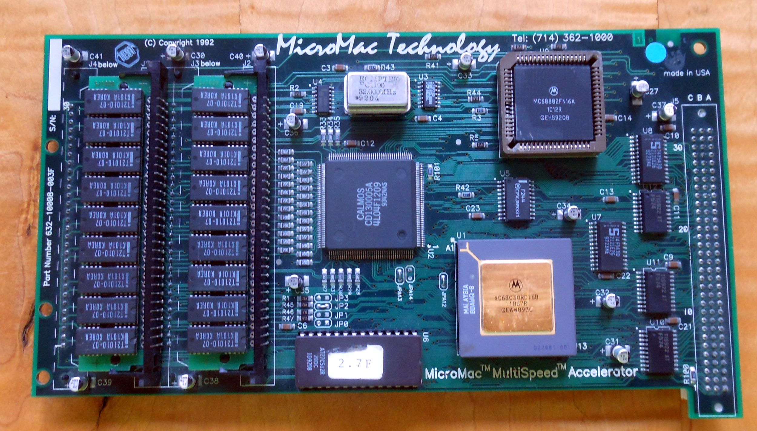

I'm curious how you arrived at this mapping? I'd always just assumed the CPU was being run at half of the oscillator's frequency, but I've never verified that with a scope. I did find the below photo (not mine) of a MultiSpeed with a 40Mhz oscillator though, and 40/25 and 50/32 are similar ratios 🤔
Awhile back on 68kmla, some people were trying to figure out what jumpers JP0-JP4 do. There was initial speculation that they might control the multiplier, but that was eventually abandoned, especially since those jumpers appear to be in the same configuration on all 3 variants. Here are the best photos I could find of MultiSpeeds with all 3 oscillator frequencies (the last two are yours and mine):
DSCN8234.JPG unused-micromac-multispeed_1_23b9116818e4eaafc2507a184902dfa1.jpeg IMG_2784.jpeg PXL_20220627_004907051.jpg

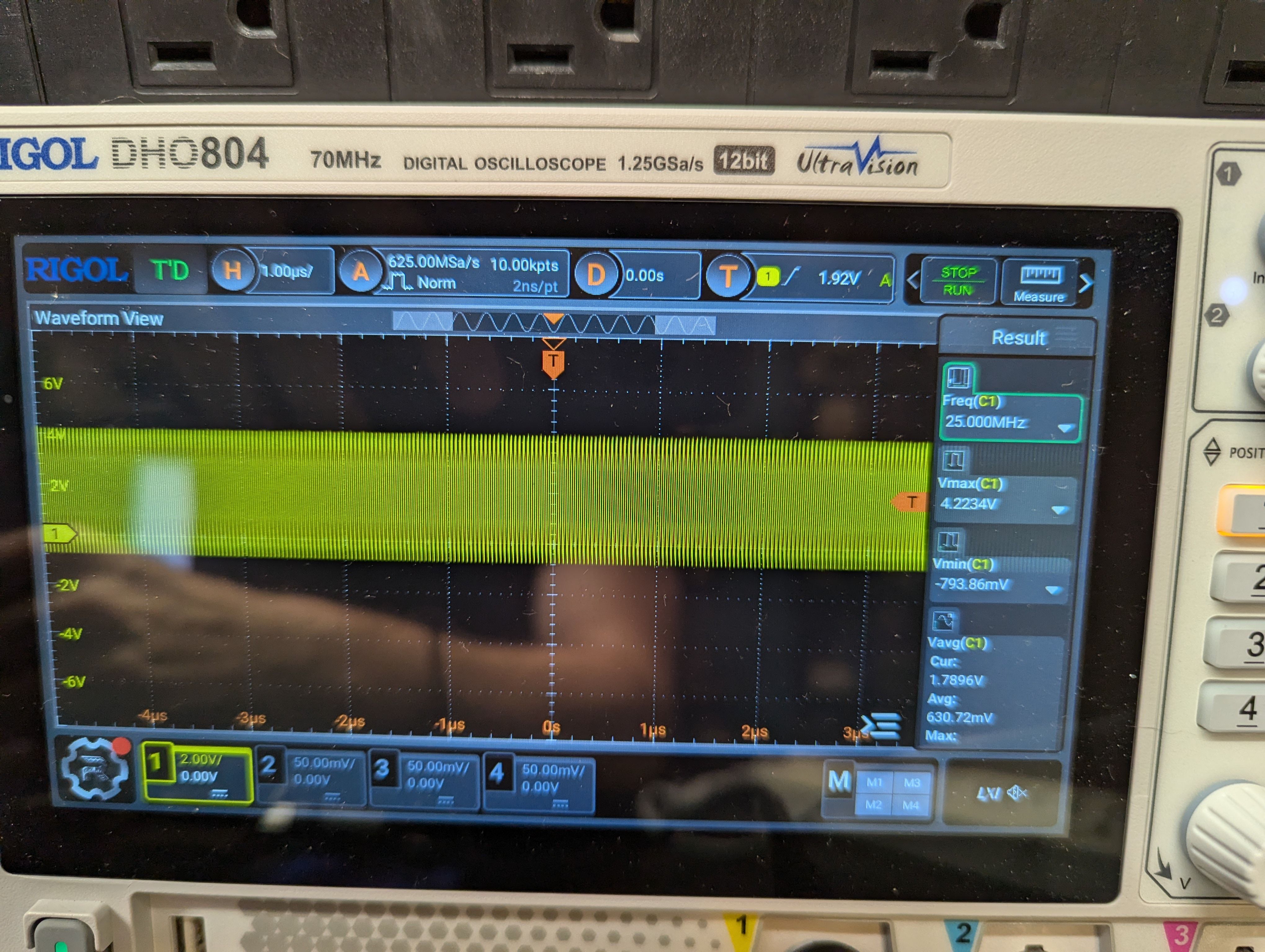

It looks like that F74D dual flip flop to the right of the oscillator is being used to divide the frequency because its second output pin appears to be connected directly to the 030's clock pin (at least from squinting at some front/back photos). Maybe I should get my SE out and verify the CPU frequency with a 50Mhz oscillator...is it 25Mhz or 32Mhz?
Mine with the 50Mhz oscillator is running the CPU and FPU at 25Mhz:
Both the CPU and FPU clock pins are connected directly to the output of the flipflop IC next to the oscillator, so the flipflop is halving the frequency. That implies that, unless there were significantly different board revisions, the CPU/FPU frequency on these is always half of the oscillator. I guess that picture of a MultiSpeed with a 40Mhz oscillator is an unadvertised 20Mhz version?
