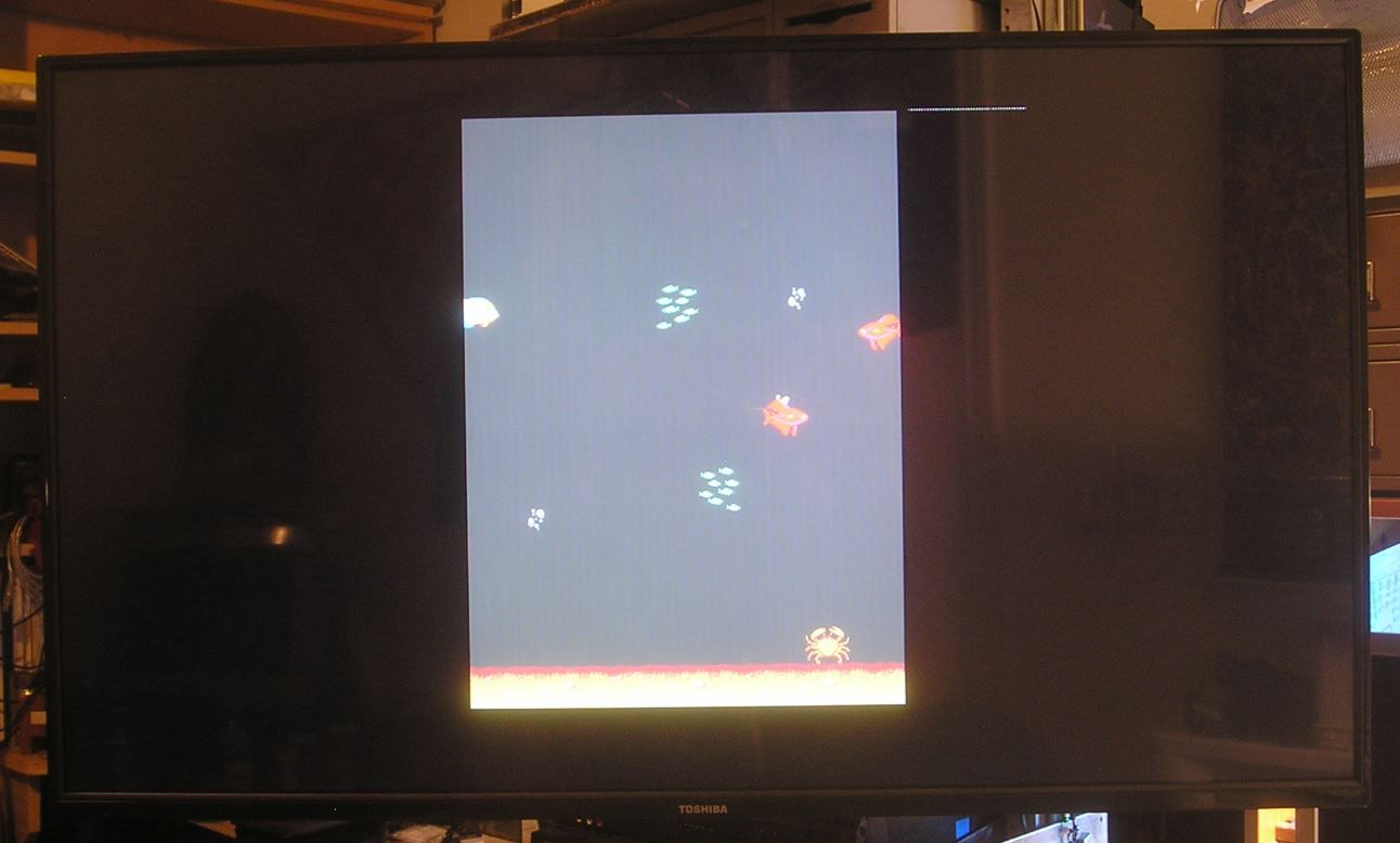

Nope, it doesn't scale specific resolutions to fill the available screen resolution on any given display with edges letterboxed or pillared the way I've tried it. @cheesestraws knows the ins and outs on this one.

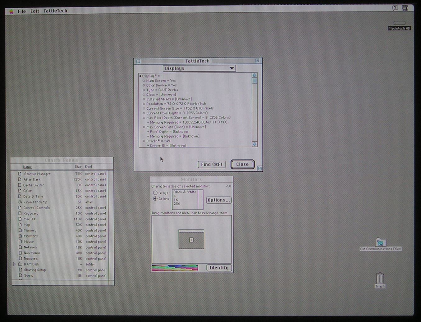

Portrait res of some flavor or other looked like this centered up at 1:1 on my 1080p TV:
I guess I'd call this picture framed 1:1 as opposed to a scaled image in one of the "two blank band" formulations?
For my use, setting the 1:1 TPD/FPD resolution to display within and inch or so of the lower right hand corner of this display does what I need. I got somethingorother to do that very nicely back when, but don't recall what it was offhand.
My hope is that one day something along the lines of that RGBtoHDMI thingie will be able to be daisy chained to a controller. 1:1 windows displayed from multiple sources on one large display would be great. TPD+FPD side by side on one modern panel from different sources would be insanely cool.
This one would look great beside the one above on that 42" TV.:

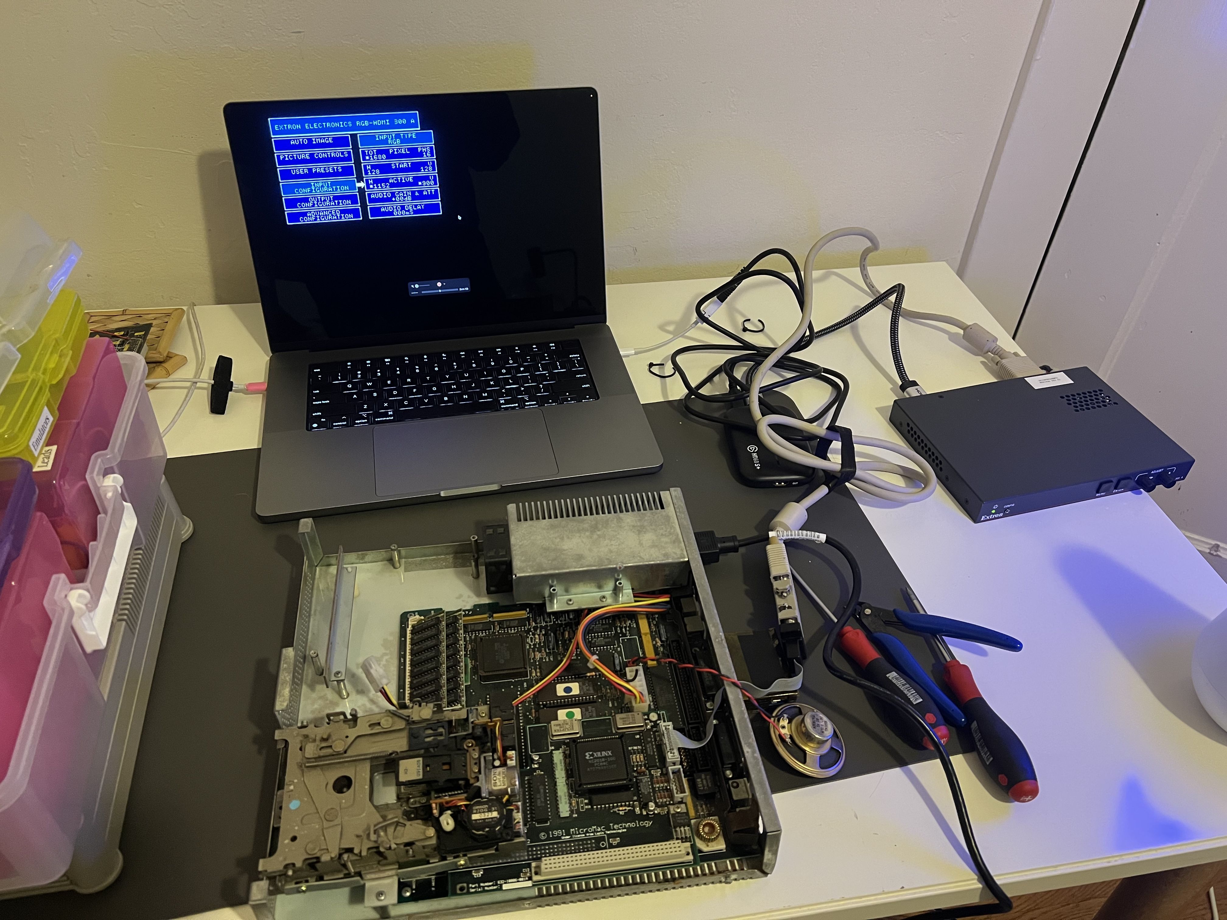

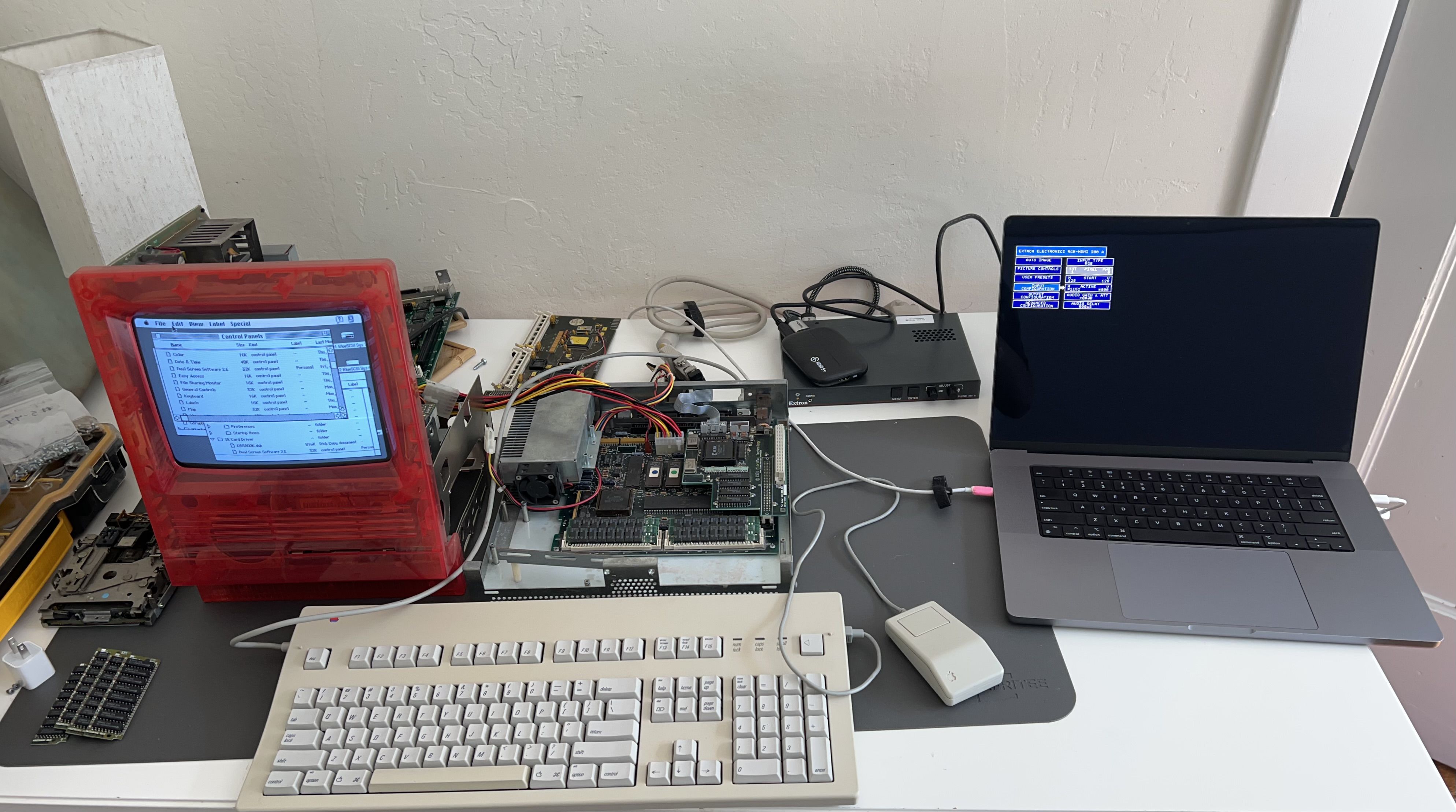

I got the Extron RGB-HDMI scaler.
The box itself is outputting video. I have it routing to an Elgato HD60+ connected to a MacBook Pro.
The MicroMac Lapis card is connected to a DB-9 to HD-15 adapter which is connected to a regular VGA cable which is connected to the Extron.
The status light on the Extron is solid amber when the Mac SE is off and flashes amber and green when it’s on but no video from the SE is displayed. I tried the pressing auto image button on the Extron that didn’t help.
I’ll start digging through the Extron manual but if there’s something obvious I should try first please let me know.
I did this first try headless so to say. Tomorrow I’ll try with it connected to a regular SE analog board and monitor so I can get a better view of what’s happening. For instance I can’t recall what version of the control panel I had last loaded.

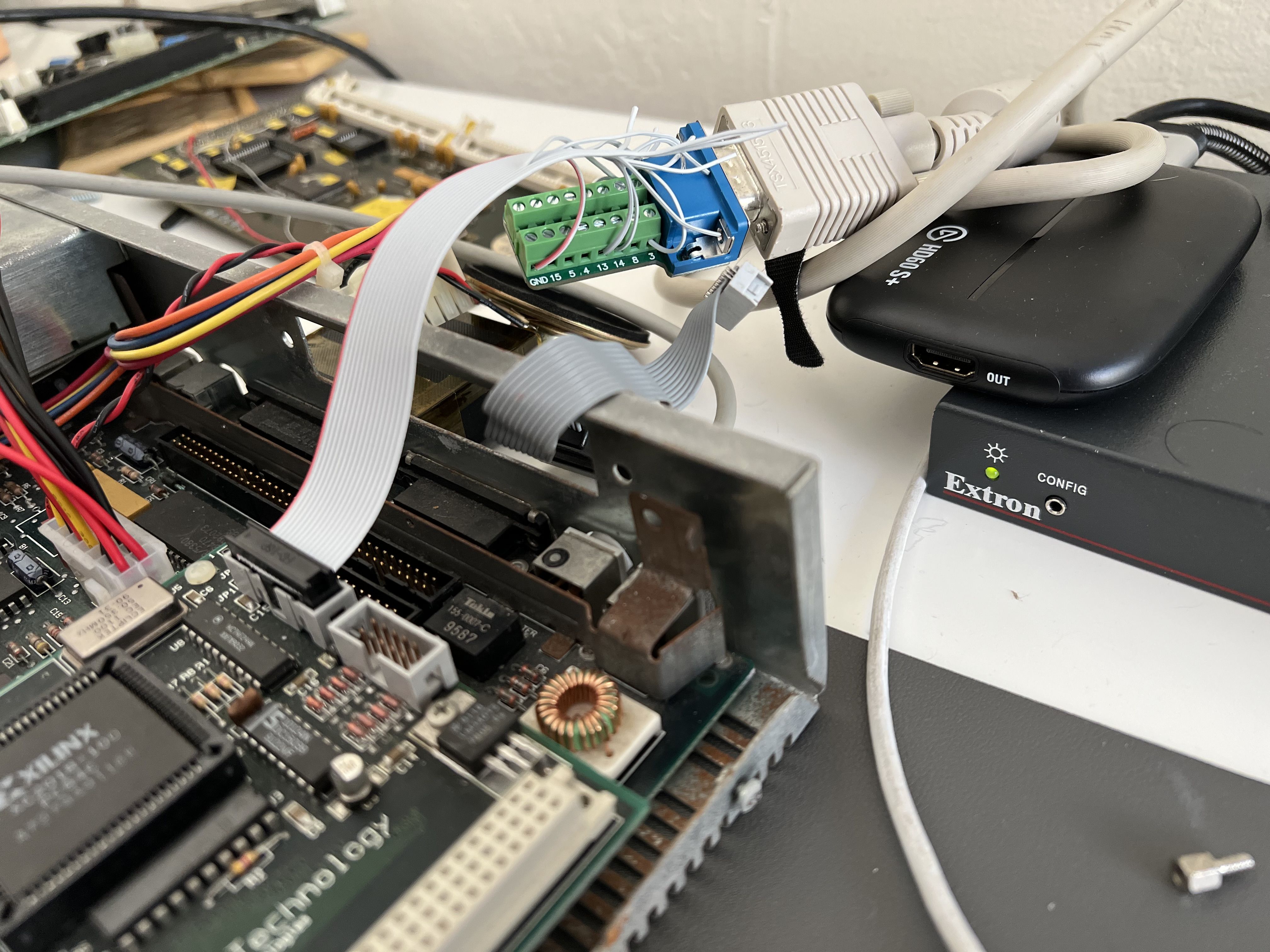

That still looks like way too many wires and connectors, which introduce capacitance in your circuit, ISTR?
Quick question, why is the VidCard not plugged into the PDS in that shot?
It is, it just also has a pass through PDS slot which may be hard to make sense of in the photo.
I can definitely hack some jumpers together to make the wiring simpler. Will put some more energy into it soon. Thanks for the info!
I hooked up the regular SE analog board and CRT to the micromac MLB. Found some bad ram and that the BlueSCSI image had no driver. I installed the Lapis Dual Screen Software 2.E control panel I had the most success with previously on System 7.1. I did see some brief distortion on the Extron output but then a whole lot of nothing.
When I try to manually set the input, it seems to be cycling through random resolutions. If I try to manually set Total Pixels for instance, the adjustment knob will cycle through 1 and some random seeming number with an asterisk like *5535, *1712 etc. The knobs work fine in the main menus. A video is below showing the input menu acting on its own.
'Auto Image' is off in Advanced Configuration and I tried power cycling the device to see if I could get it to stop trying to sync on its own, but no luck.

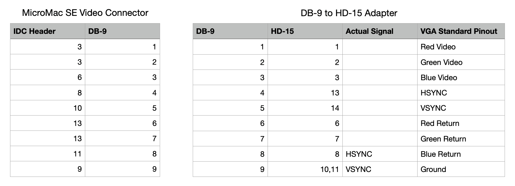

Next step will be checking the pinouts from the header and through the adapter and cable to see what is firing on what pins at the Extron HD-15 input connector.
After checking the pinouts again the problem seems pretty clear. At the very least HSYNC and VSYNC are on the wrong pins. Next I'll jumper HSYNC and VSYNC to the right VGA pins and start experimenting to find the right pin for video.

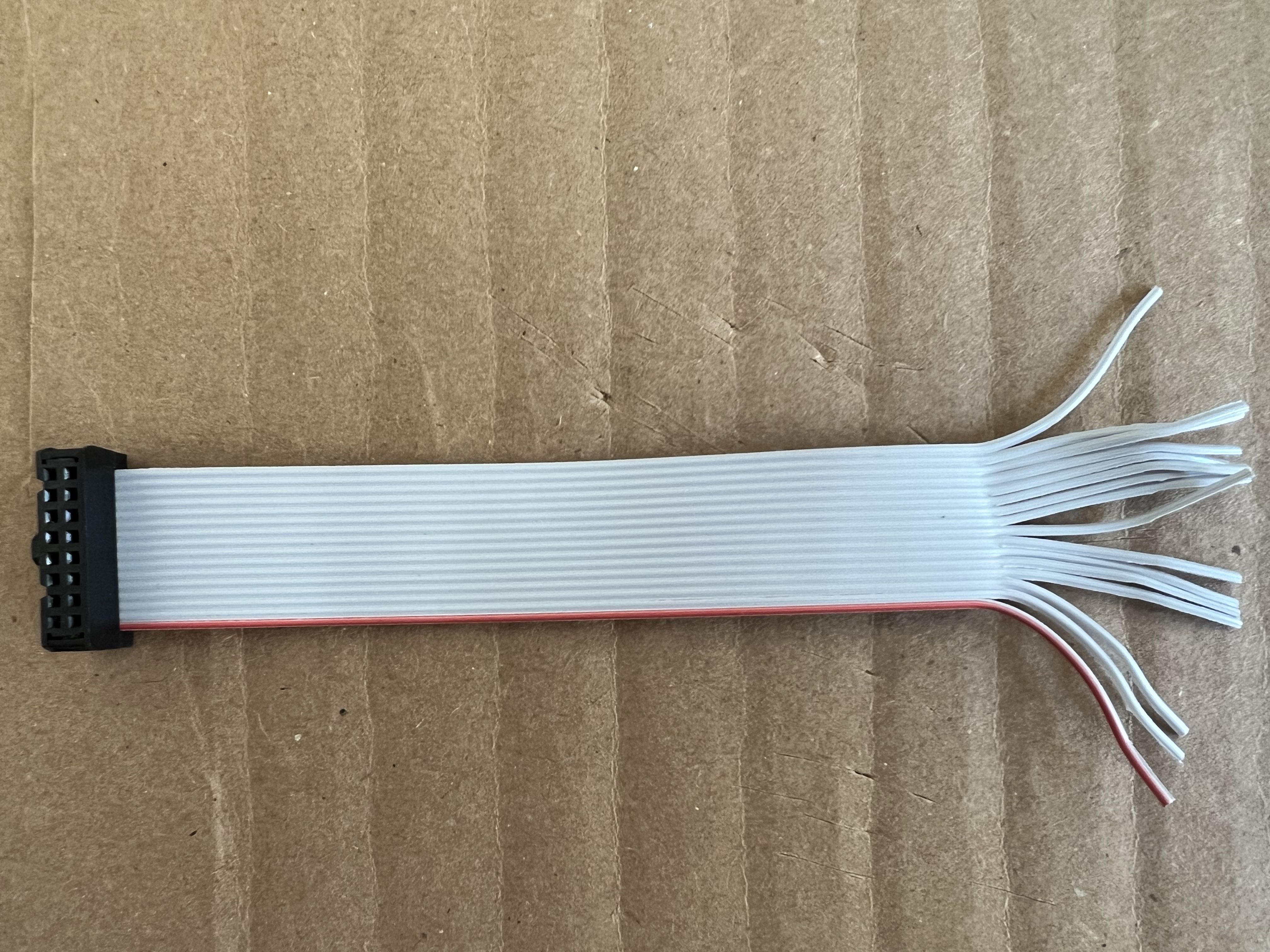

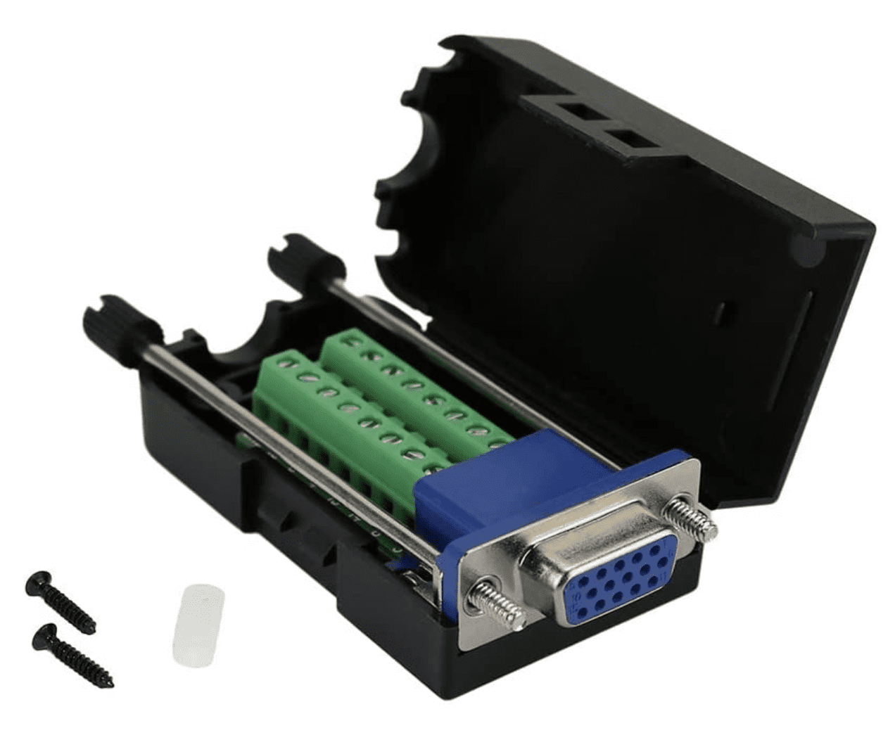

I made a new 16-pin IDC cable to connect to the video card's header and ordered a HD-15 terminal breakout connector to make trial and error a bit easier.

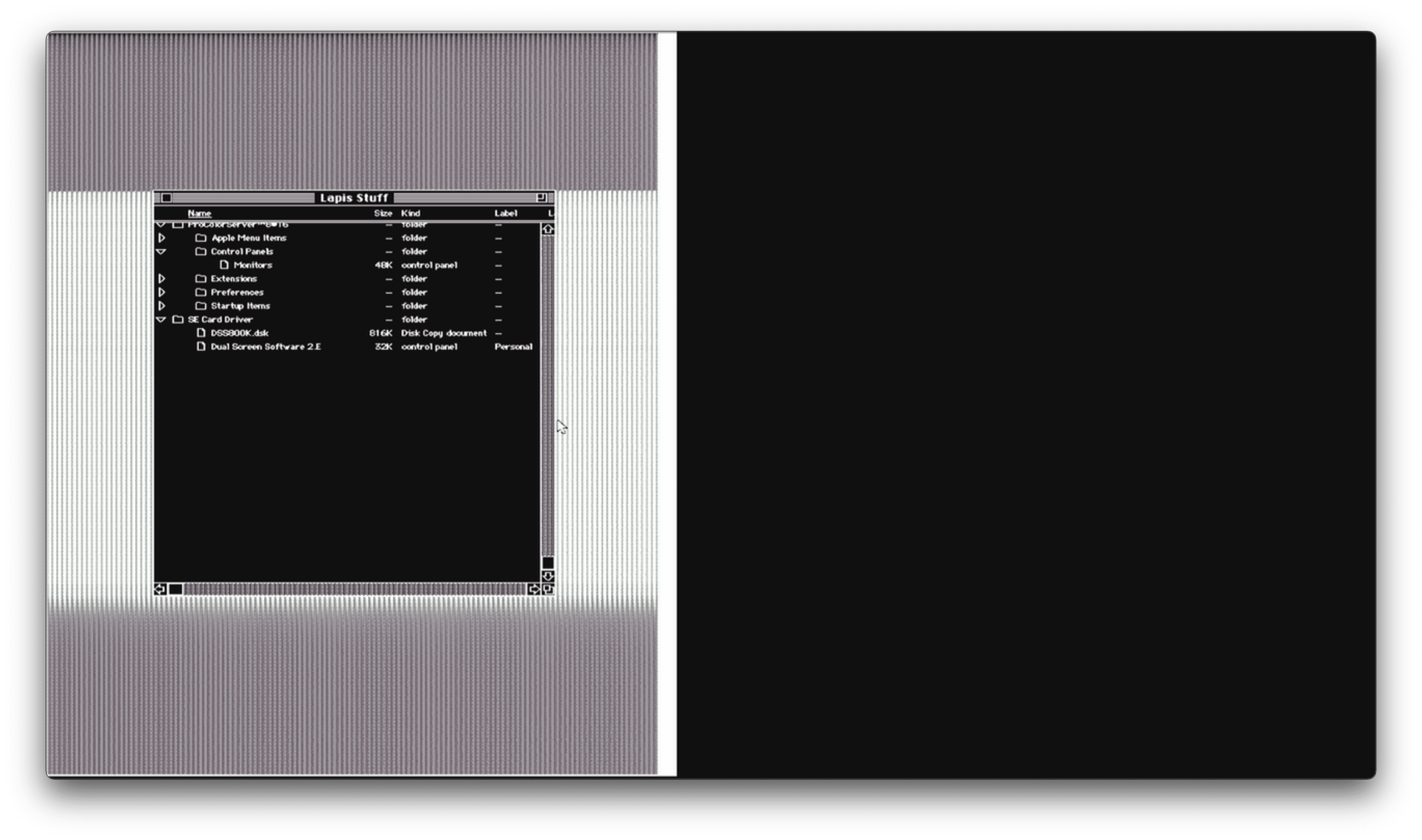

Yay it's actually doing something!!
This is with the following setup
IDC PinVGA Pin (Female)
15 (HSYNC Ground. Not necessary, but improves clarity.)
36 (Red return. Not necessary, but improves clarity.)
914 (VSYNC)
1113 (HSYNC)
131, 2 and 3 (Video signal) combined to get B&W

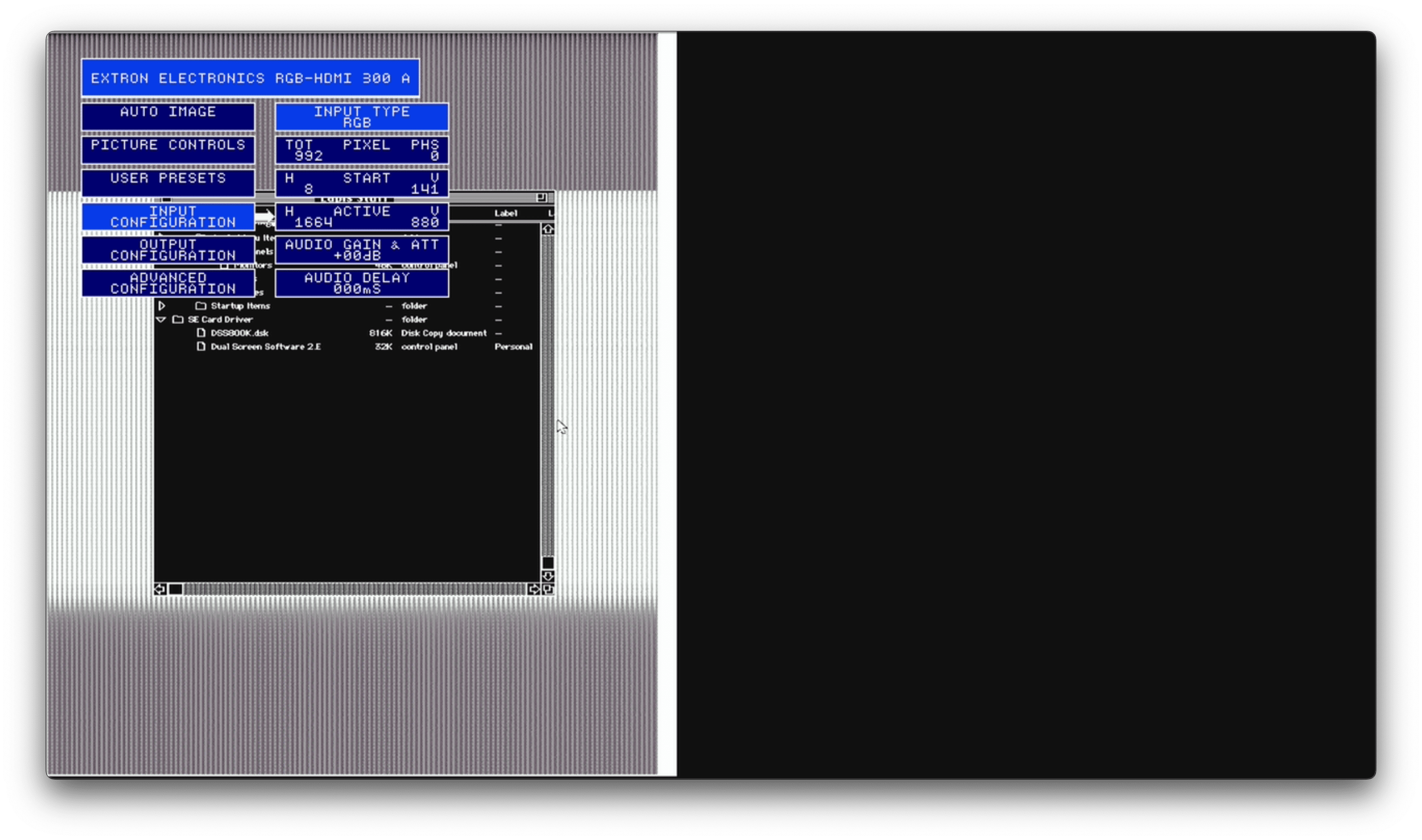

The video is inverted and there's a lot of noise in the signal. Any thoughts on how I can fix the color inversion or improve signal clarity?
Also, I got the resolution looking more or less correct, but the actual numbers I had to input on the Extron are way off from reality. You can see in the second screen shot I had to set the active resolution to 1664x880.
