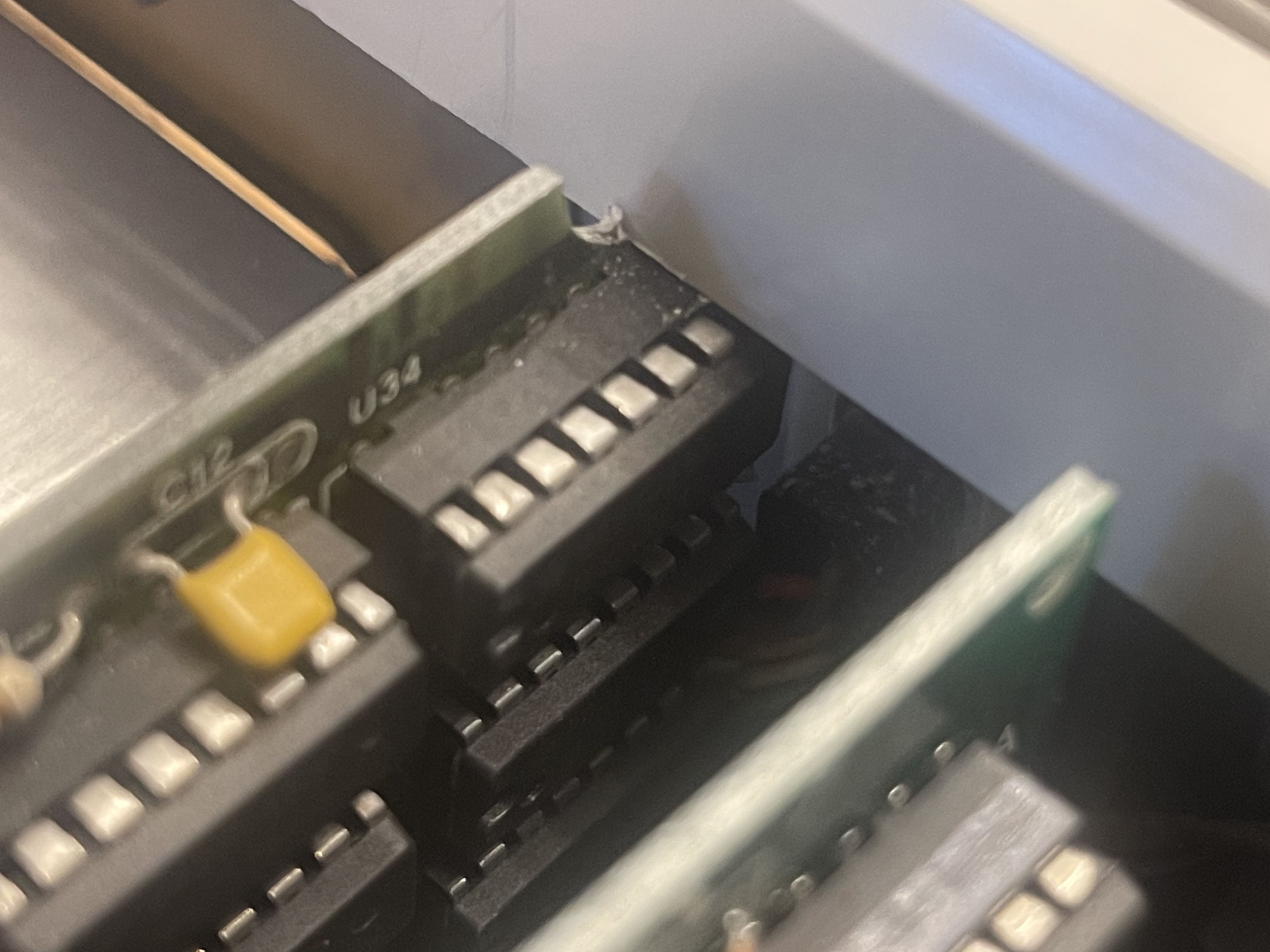

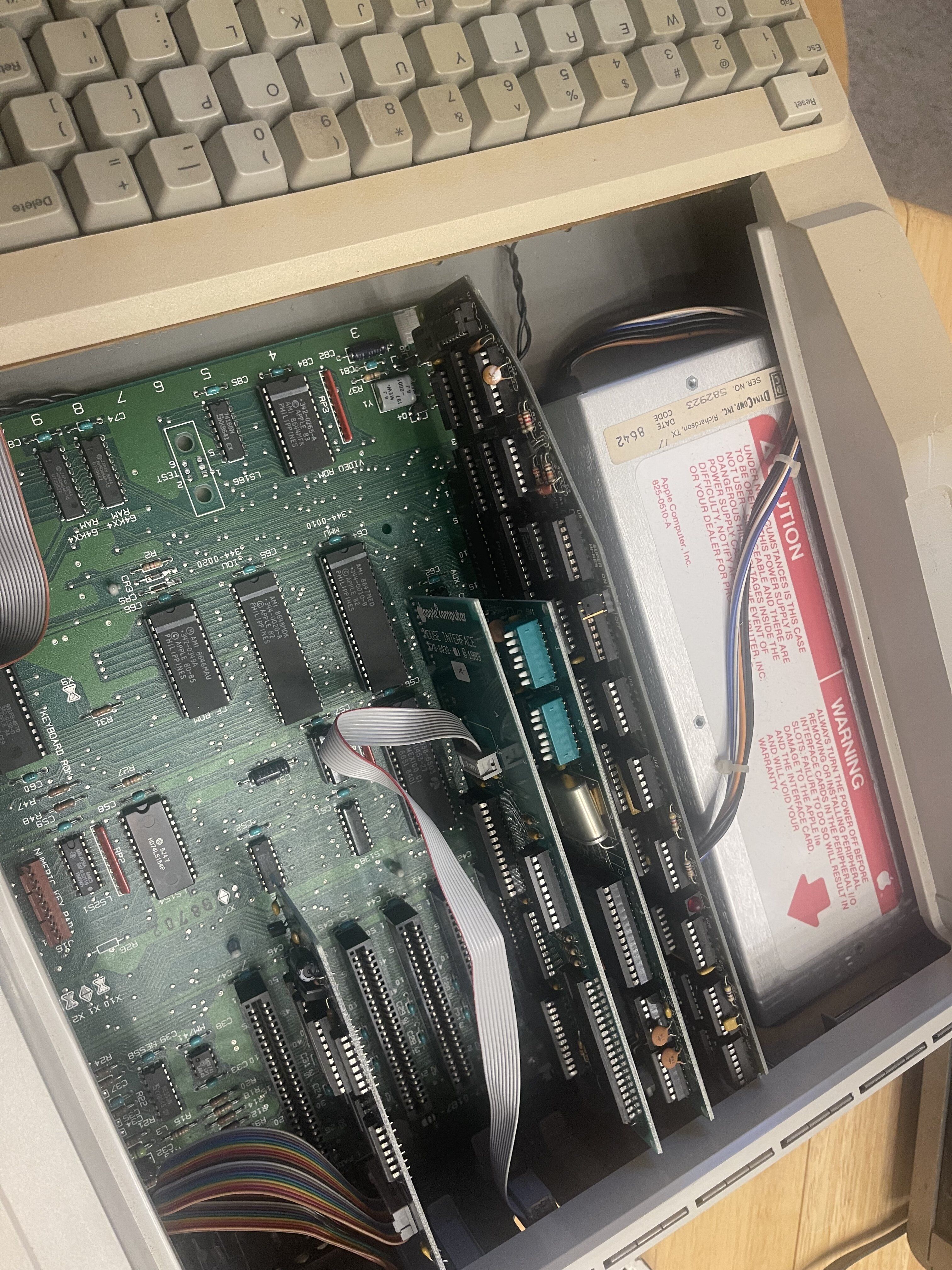

Well, I spoke (err wrote) too soon. I managed to get it to fit. I'll show you proof! It is a TIGHT squeeze.

But, it isn't lighting up and shows zero signs of life, so I am going to reset the chips to see if I get a spark out of it, hopefully! I do have original Microsoft disks, etc. Plus a copy of Apple Wordstar, not sure how I acquired it, but maybe dad had found it somehow.
No dice on any life out of this card so far, having reset half the board. I do worry that I am using the wrong disk controller for it. I have a 5.25" apple disk controller. Is this fine? Do I have to use a Disk II controller? I would assume that the red light would light if it at all times, but maybe it only lights up if the z80 processor is in use?
On my clone of the microsoft card, the LED only comes on for CPU activity I believe (that's how I remember it working with the lid off).
