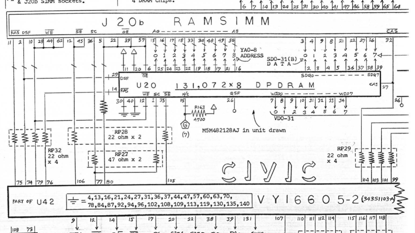

Has anyone tried piggybacking another set of VRAM chips on top of the ones already mounted on the motherboard? On the 840AV, most of the signals are shared between the soldered VRAM and expansion VRAM. The only different pins are separate /RAS and /SE lines on the CIVIC video chip which are pinned out to the sockets on the 840AV. I’m thinking on my 660AV I can just wire a second set of VRAMs in parallel except for /RAS and /SE and run those to the CIVIC.
I’ve attached some pictures from the 840AV Bomarc schematic showing the wiring for the “X” and “Y” VRAM banks. I should be able to duplicate this on the 660AV with piggybacked chips and only four bodge wires.
But will the ROM / Mac OS recognize the extra VRAM?

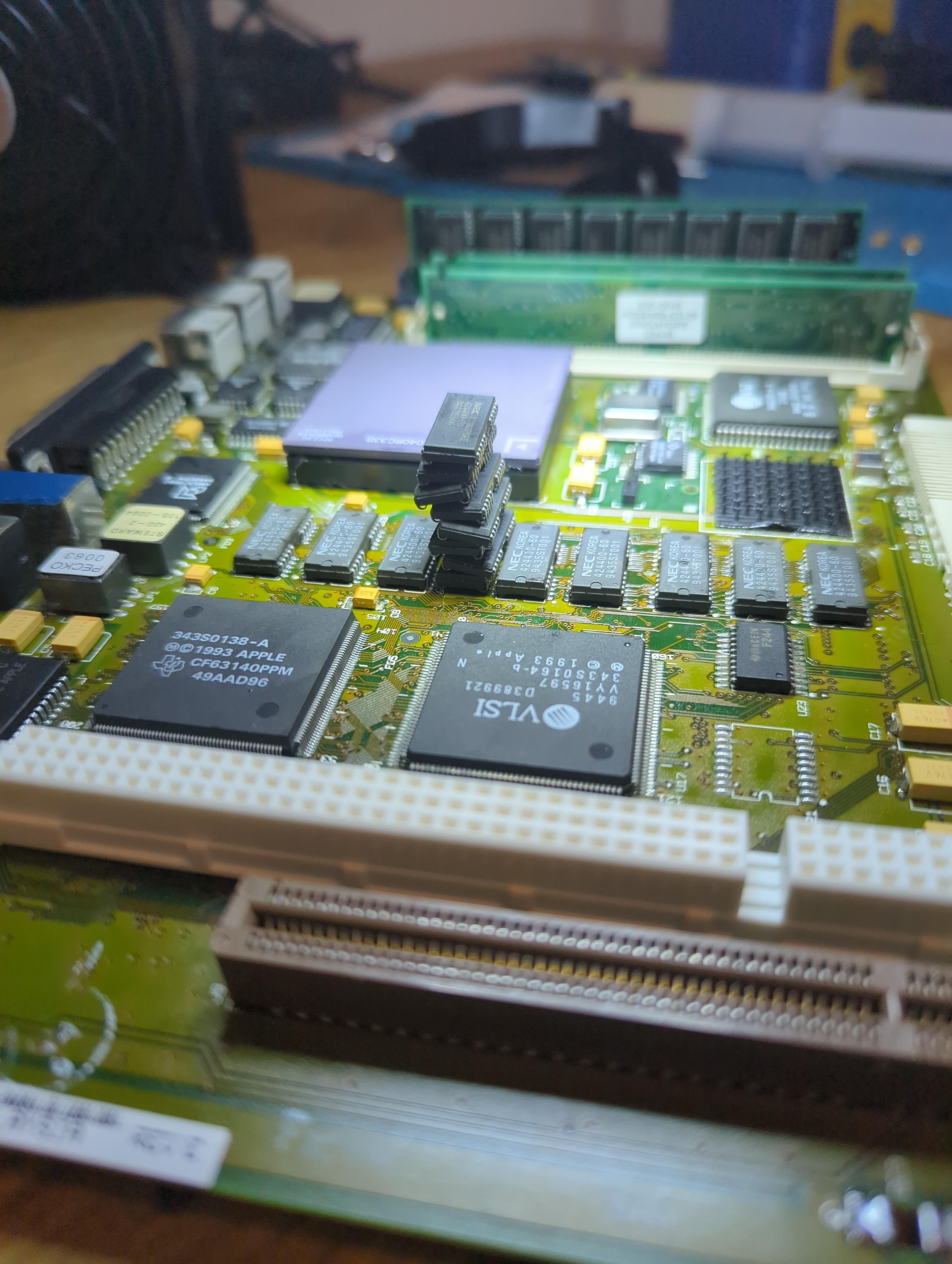

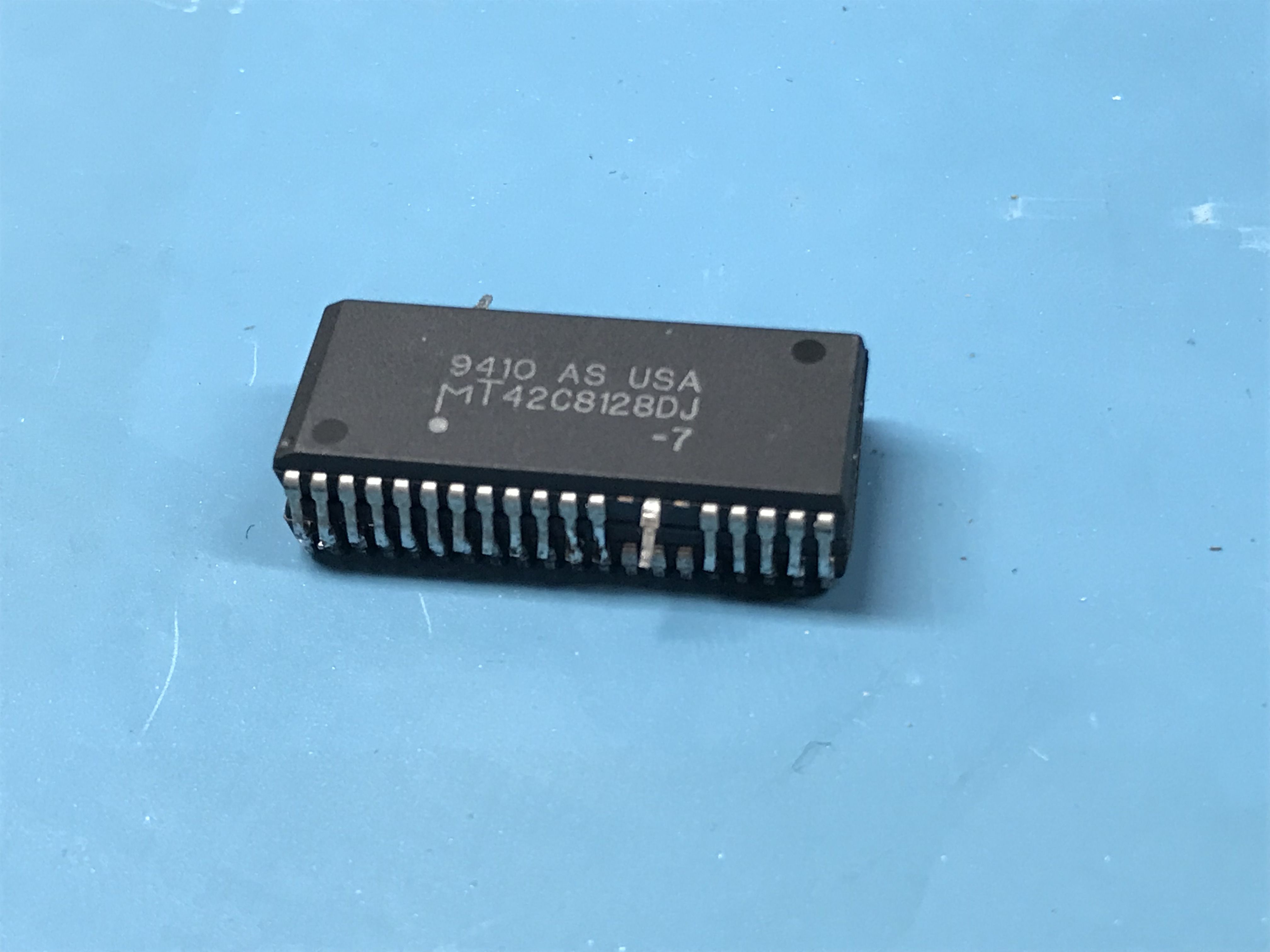

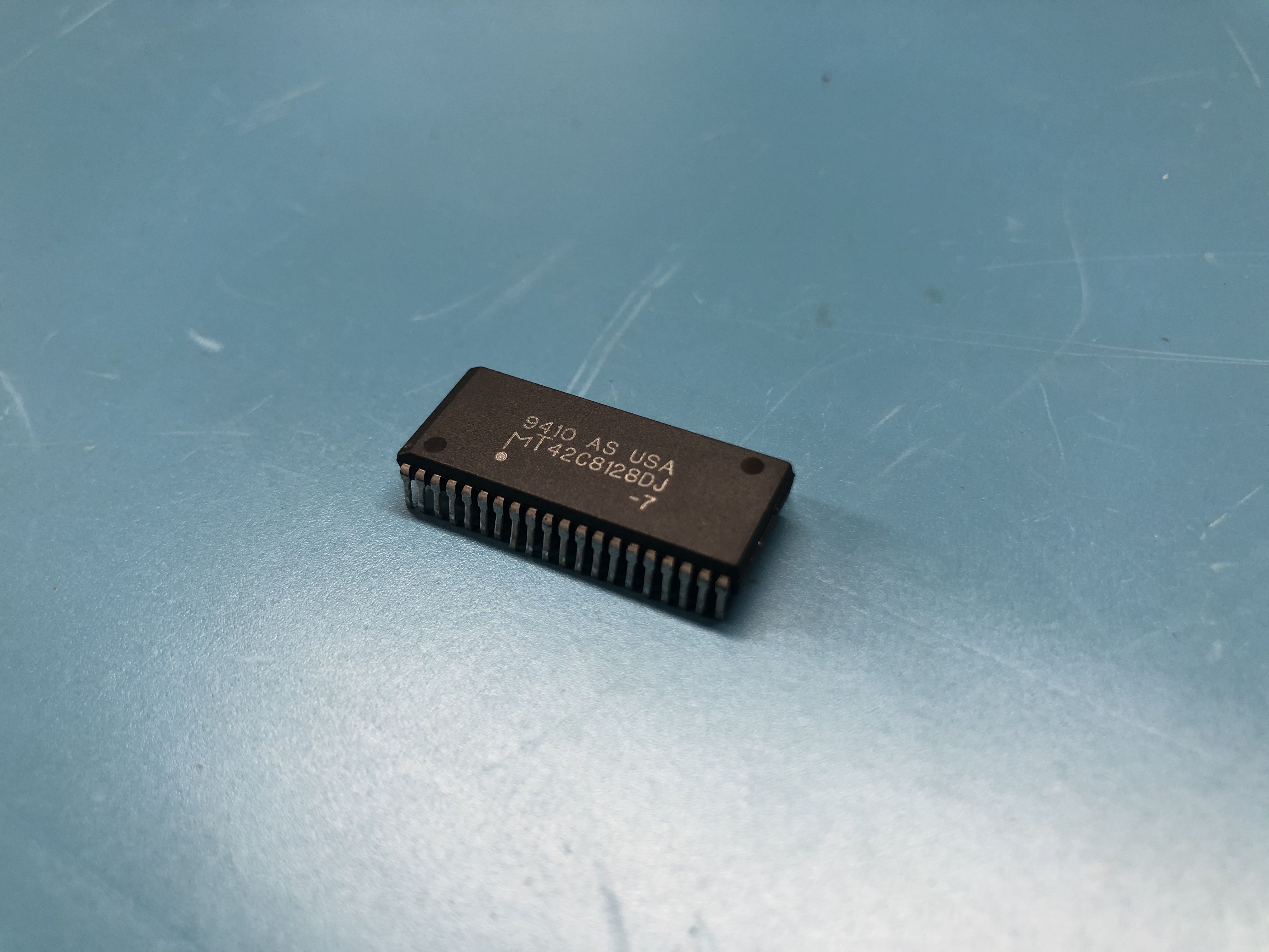

Currently Garrett is assembling the VRAM stacks which we are going to swap onto the board. Here’s some pics

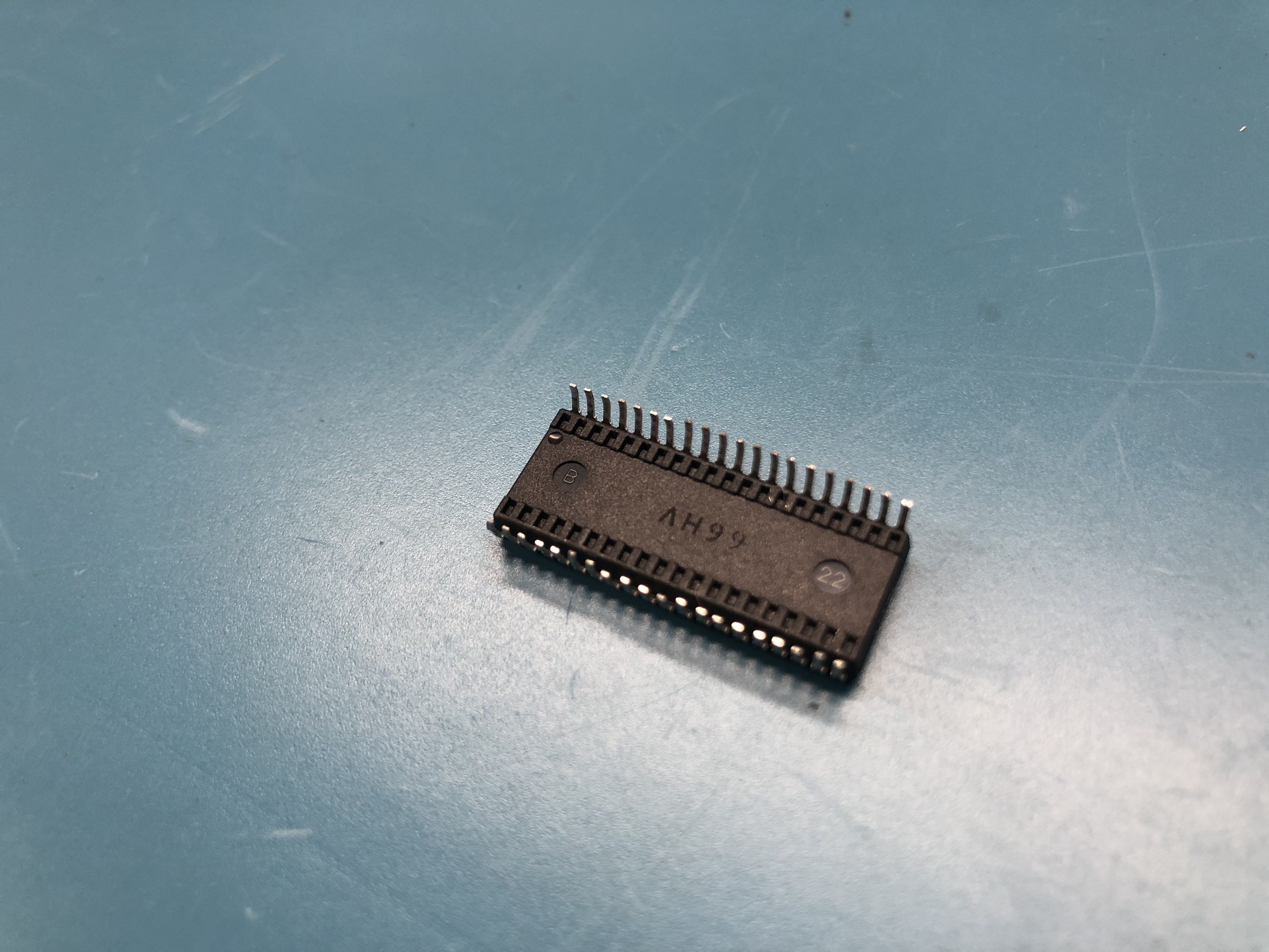

Bending out the leads:
Stacked atop unmodified SOJ:
Separating the RAS and SE:
Soldered:
All credit for stacking these things so meticulously goes to my best friend Garrett Fellers. (Maybe one day I’ll get him to post on here himself.) I certainly couldn’t do it; I’d break a bunch of legs.

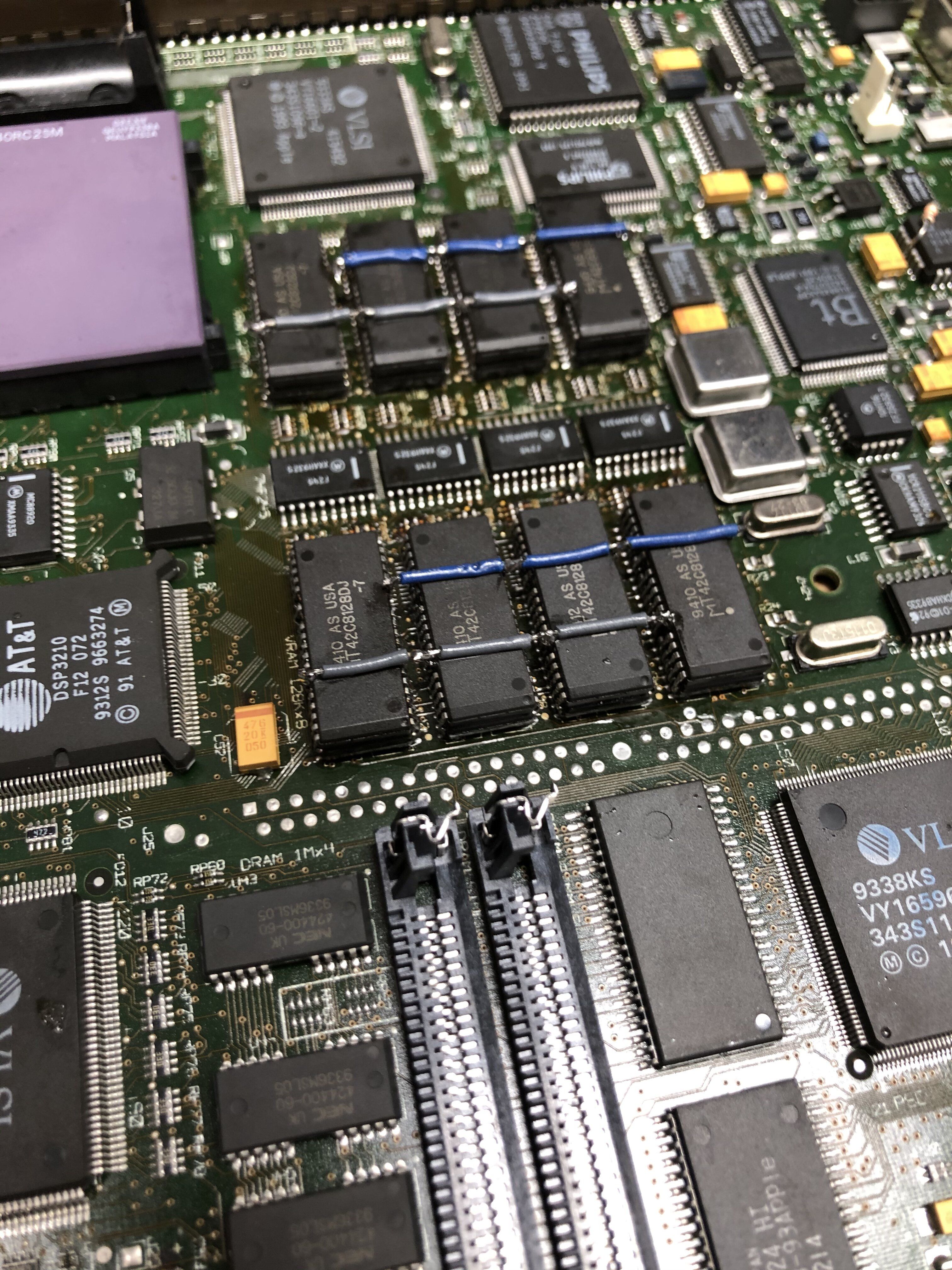

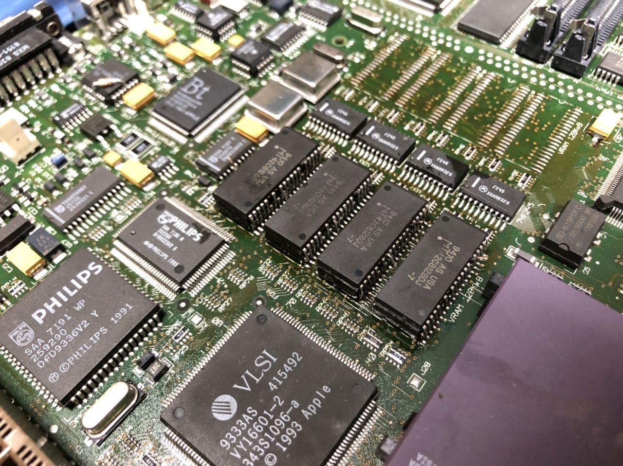

Finally we got around to putting some of the VRAMs on. First attempt a few months ago was a failure and we lifted a pad so I was kinda discouraged. Garrett fixed that and put half of the VRAM stacks on. (Pic attached.) The rest are going on tomorrow and then I’ll test it out. First test will be with the additional RAM banks disabled just to see if the machine works, then we’ll wire the other bank signals up to the CIVIC video chip and see if we have any more bit depth options available.
A little bit more progress:
It’s working like this with the RAS and SE pins tied to 5V (i.e. inactive)! Of course there’s no extra VRAM like that. Just gotta solder the wires to the CIVIC and we’re good to test the 2 MB capacity! Will do this later tonight or tomorrow

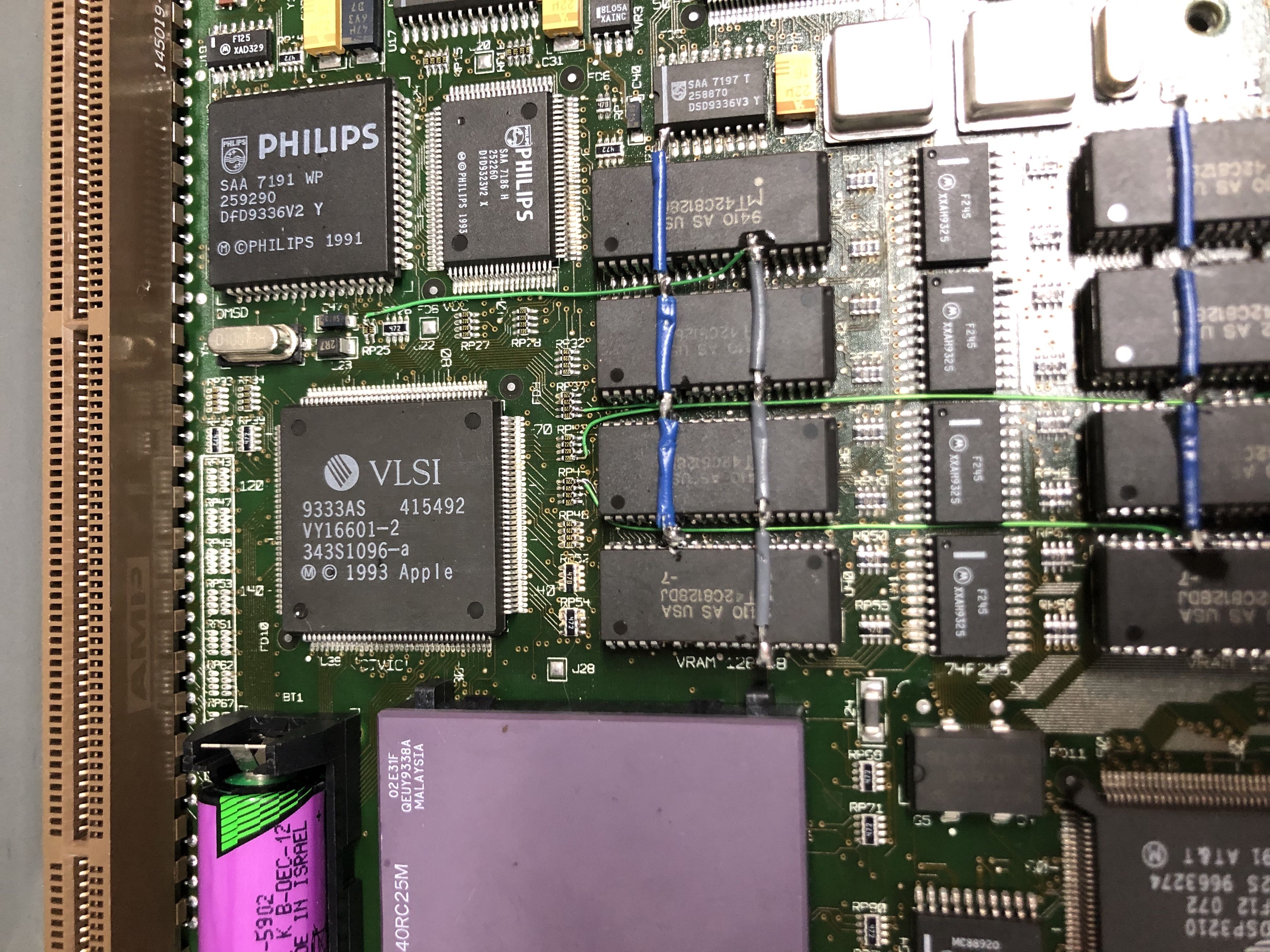

Mod successfully completed!

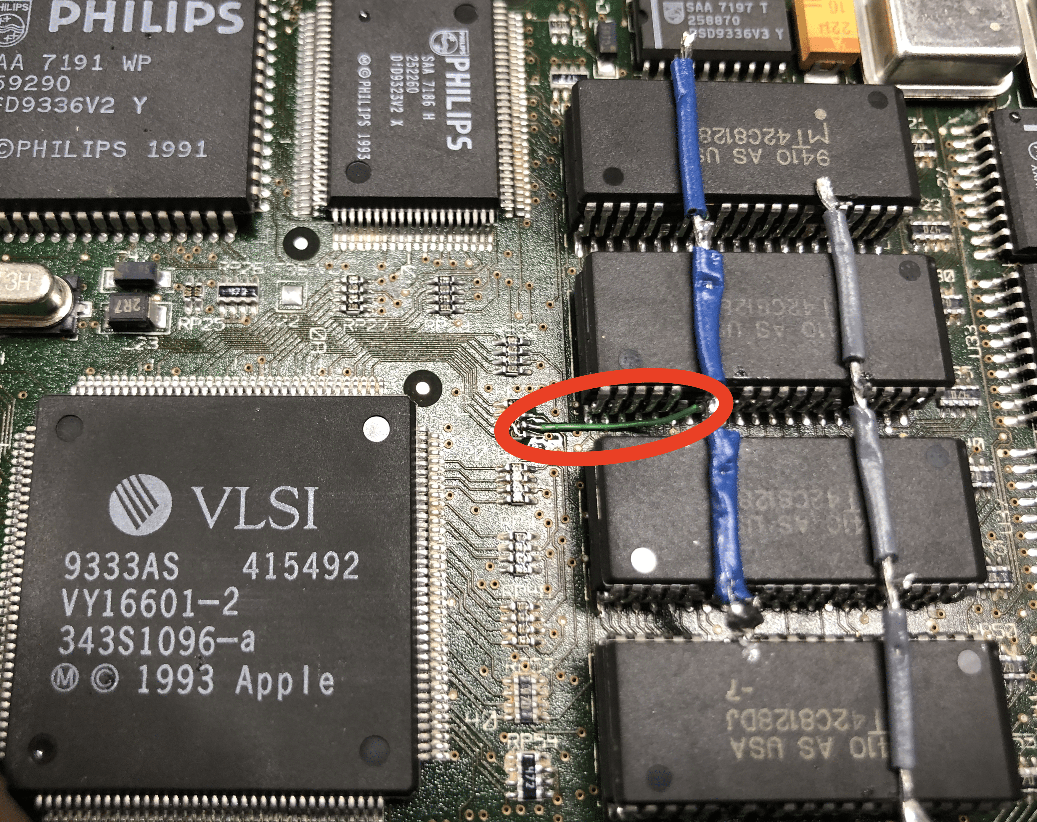

Here's the mod wires from the extra VRAM to the CIVIC chip:
Very nice of Apple to put the requisite series termination resistors and connect them to the CIVIC! I thought Garrett would have to put em inline with the mod wire and solder directly to the CIVIC itself.

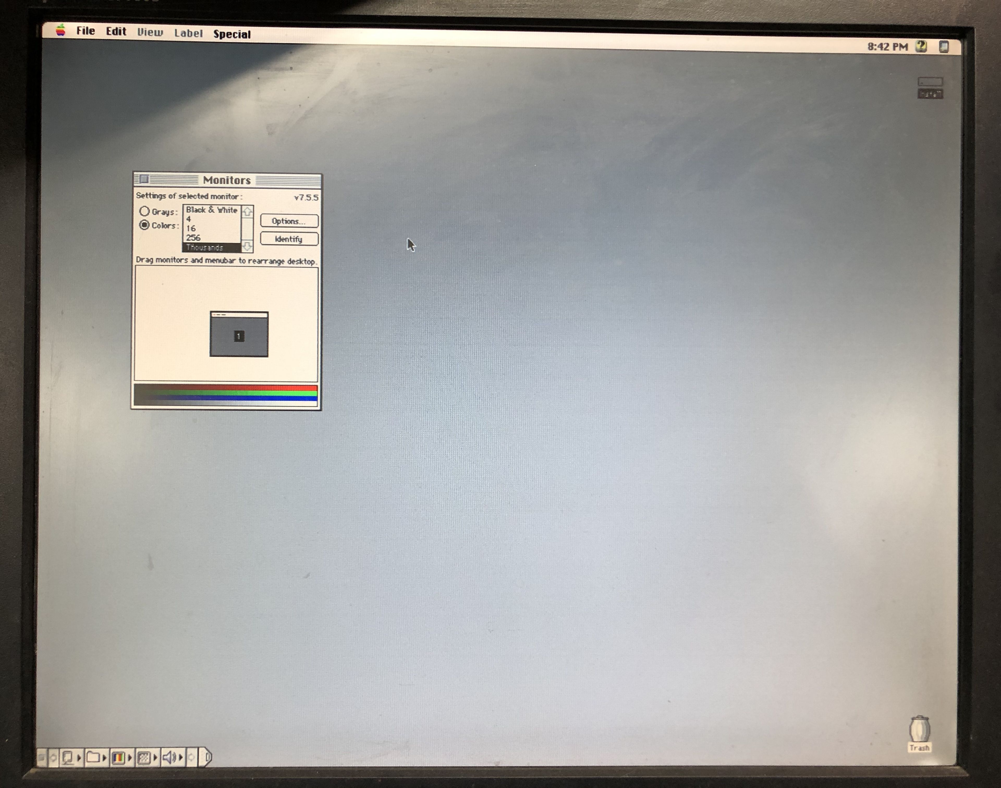

And the requisite screenshot showing 1152x870 resolution with thousands of colors (approximately 2 MB VRAM usage):
