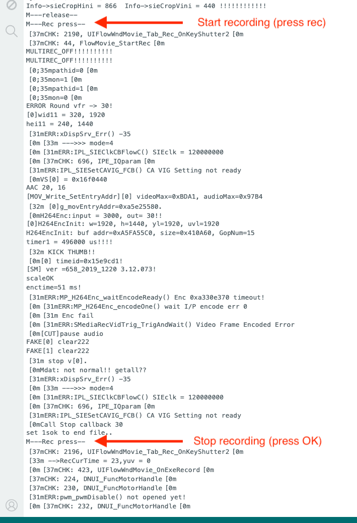

Thanks! For my model A, it now successfully flashes.
But while it does try to record, and the device gives no clear errors (it even says a movie file name when you press stop) - it seems the files don't save on the SD card.

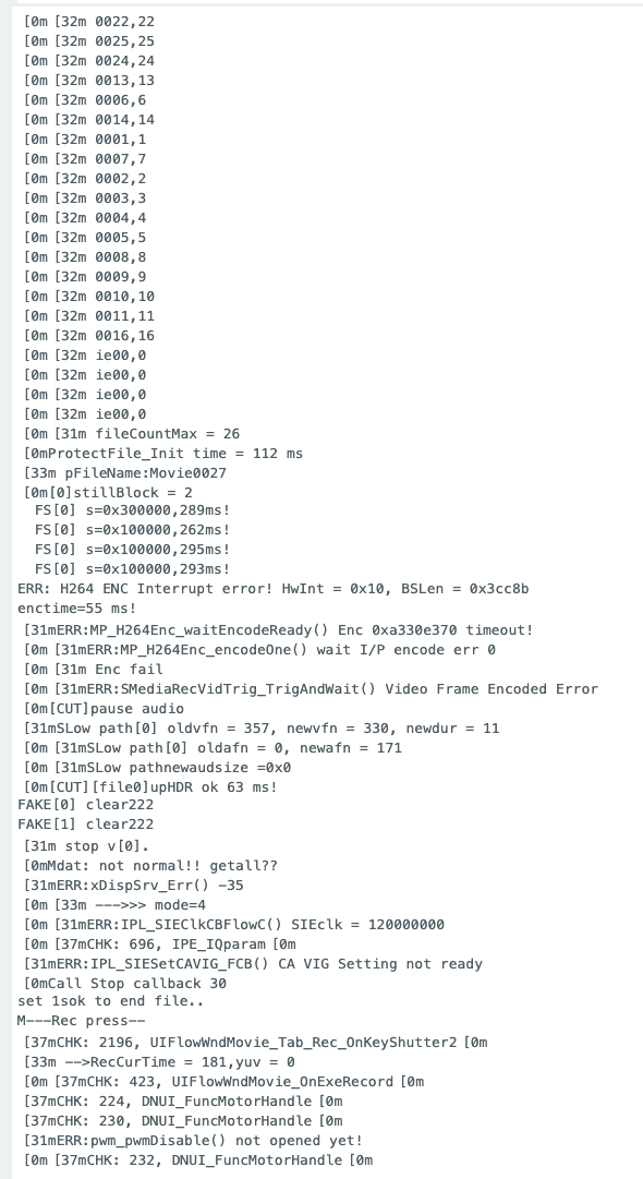

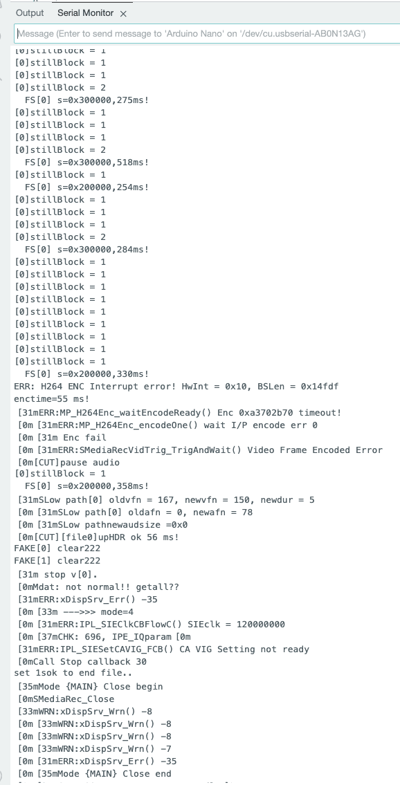

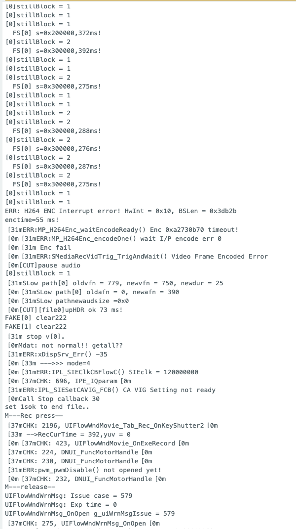

Here's the readout from the console which may provide some clues, I see a lot of errors. this was with "P0 (A)", I'll try another:
Ah that's really interesting. It looks like the encoding takes too long with that setting.
FYI - QP10 works, but QP5, after a few moments, gives the same "ERROR!" calls in the serial monitor. It will save a file to the SD card, but it doesn't do it properly so it won't open with VLC or QuickTime.

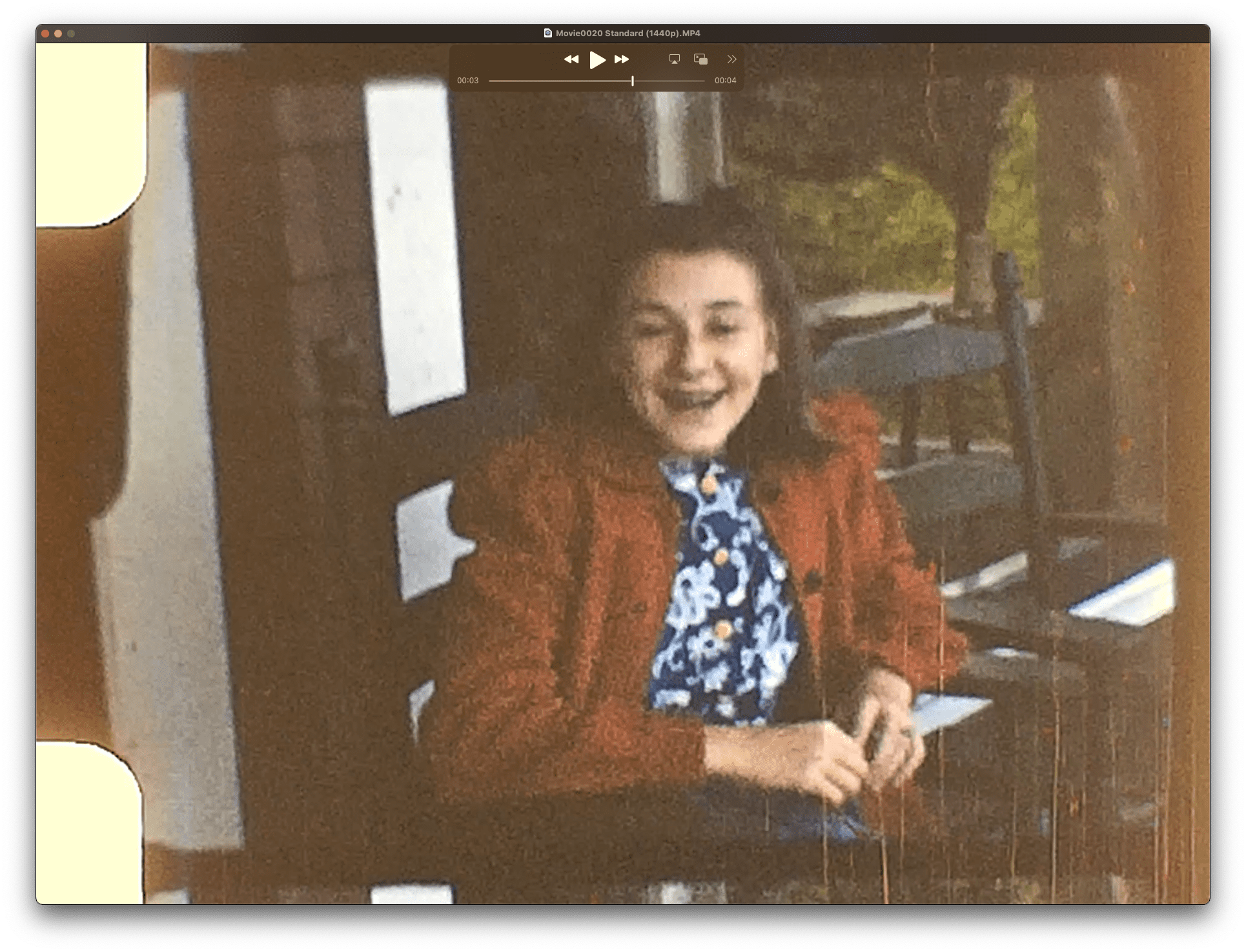

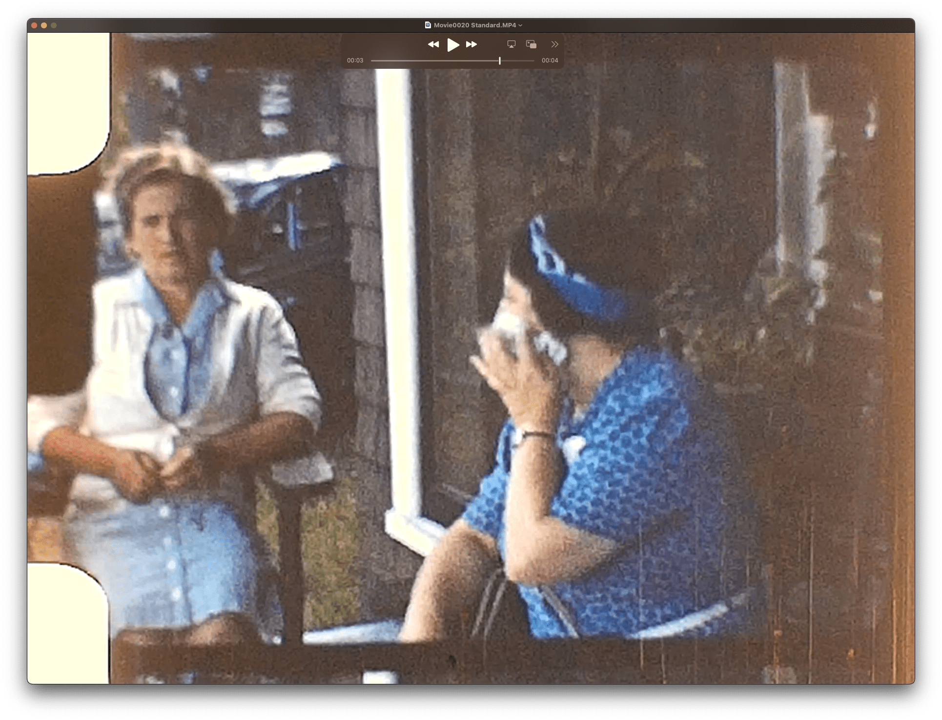

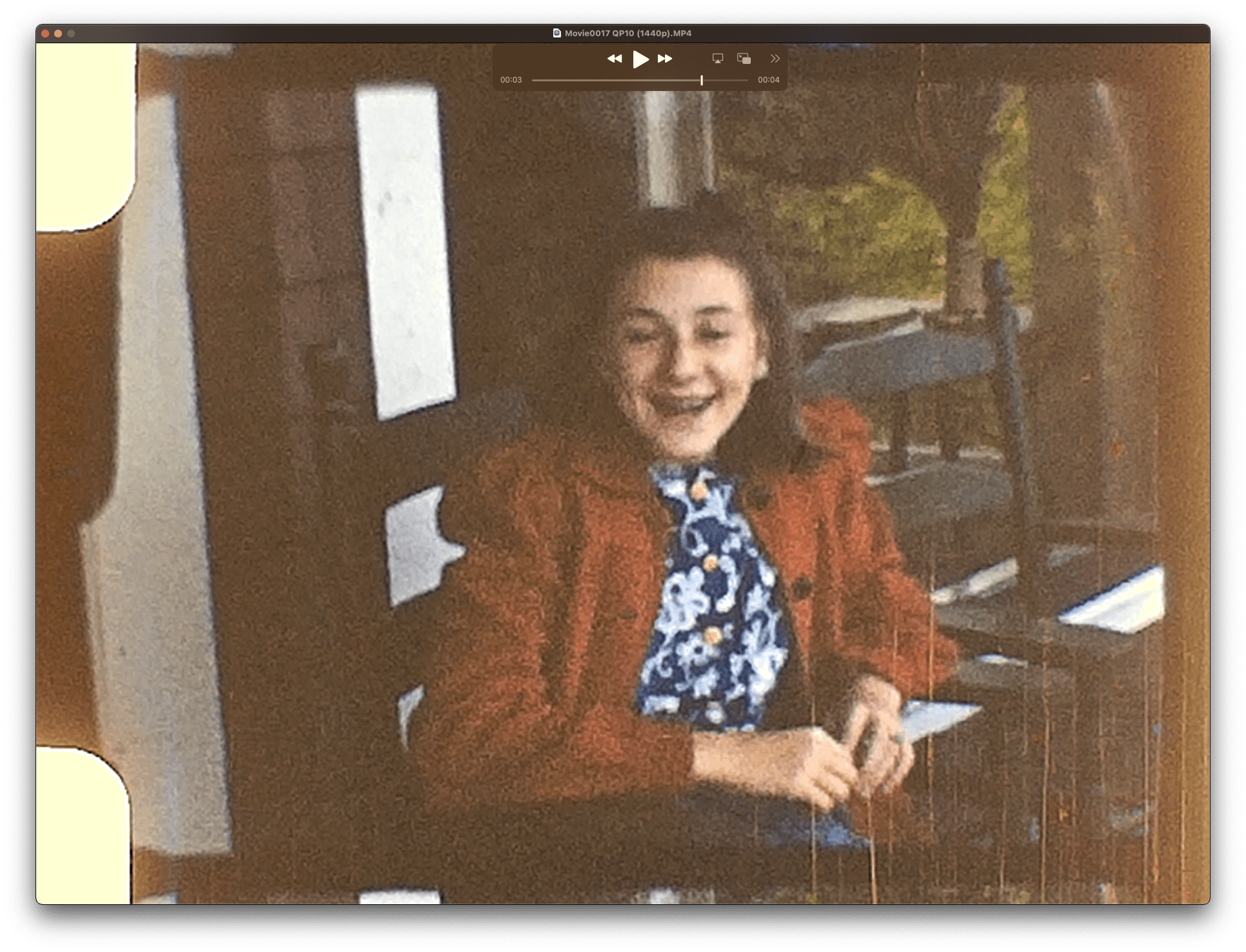

Yeah, here are two near identical recordings. The one with my standard modded firmware (Movie 20) versus the QP10 (Movie 17): https://drive.google.com/drive/folders/1xizA1qN5kcgCmOA1dha1xsCl_uJeyLq2?usp=sharing
Note: Due to the firmware being uploaded, these are set at the default picture values, aka Sharpness set to "0.0".
Also attached here are some stills, I see a little bit of difference, but it also may be my imagination :)
Thanks very much for doing that comparison! No, it's not a "night and day" difference like I saw with the Somikon scanner. However, you can see all of the film grain with the QP10 firmware and with your standard firmware the grain is causing tiny rectangular shapes which are taller vertically (blocking artifacts). I don't mind doing the mod to Firmware C if you're interested.

However, I'm curious, QP10 works and gives this flags every once in a while. I wonder if it's calling out that there's a delay between the capture and writing to the SD card? I suppose small steps, say QP "7" maybe would be good to try (a halfway point between QP10 and QP5) but I don't know if it would be worth it.
I see, very interesting! :)
I only have FW A and FW B units, so sadly FW C is something I can't test.
Yes, that's exactly what the problem is. The scanner only has 500ms to get a frame scanned and on to the SD card.
So, we need to go in the opposite direction. To make it easier for the scanner to encode on time we need to increase the QP to 11 or 12.

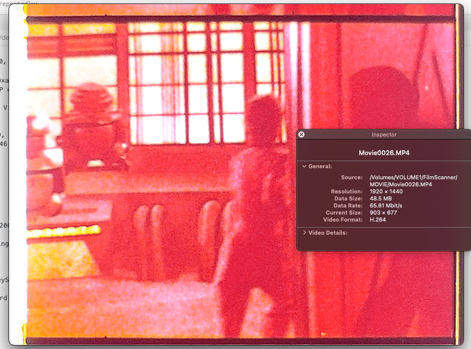

What's interesting is, I tried leaving the projector running for 10 minutes, and it was working with QP10. But - then all of a sudden it stopped (I only know because of the serial monitor, the digizter keeps chugging along).
The resulting video file is nice (link to video here) but it looks like it got a bit upset! This sample was a Super 8mm clip of "The Black Hole" film. Also attached is a screenshot of the serial monitor getting upset.

Oh wow, any idea why it blasted to 111+ Mbit/s, is it simply the QP control setting? :oops:
After just 2 minutes on QP12 it crashed again :( Recording at about 112+ Mbit/s (see screenshot below)... but the recording looked great! 😅
Sadly - it also fails at QP15 after a few min. (which seems to record at at ~65 Mbit/s). Maybe forcing it to something like QP25 would be a happy medium? Just thinking out loud - thanks so much!!
It's the QP being low and the amount of motion in The Black Hole clip (I think).
