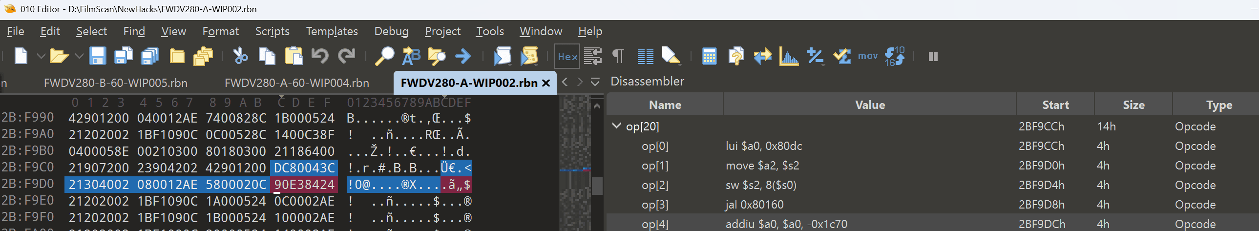

That looks interesting, when I zoom-in these values go up (these are the coordinates for the top left corner.) So I use a good hexeditor, like HxD (free) or 010 Editor (way better as it has MIPS disassembler), and search on "sieCropHini" . At address 0xdbe478 in the firmware I find this string:
Info->sieCropHini = %d Info->sieCropVini = %d !!!!!!!!!!!!
So this is passed at a formatted output like printf() or sprintf(), with input values of x and y.
So we need to find where is referenced in 0xdbe390 in the code.
The compiler used for these old processors seems to always use the register 'a0' for the first parameter in a called function. So a call like printf(a0, a1, a2 ...), the string address (0xdbe390) is likely loaded into a0. MIPS is a old 32-bit CPU, so it can only load 16-bit into a register with a single instruction. So 0x00db is loaded separately to 0xe390.

The compiler could load 0x00db like
lui $a0, 0x00db <- Load upper immediate
but in this case it did this
lui $a0, 0x00dc <- Load upper immediate
This seems weird, the default compiler behavior to use the add function for the second part.
addiu $a0, 0xe390 <- As 0xe000 has the top bit set (0x8000) is treated a negative (e.g. -0x1c70)
It is all weird, but logical. The add opcode is always
<addr> <command>
90 e3 84 24
So when I search on 90 e3 84 24 (little endian format), I found where the resolution is set up with the scanner.
So the opcodes for the highlighted bytes are:
lui $a0, 0x80dc - Load upper immediate
move $a2,$s2 - ignore for now as it is not $a0
sw $a2, 8($a0) - ignore for now as it is not $a0
jal - this is the call to printf() or similar
addiu $a0, $a0, -0x1c70 - Adding e390 to 0x80db0000, is the same as added -0x1c70 to 0x80dc0000.
More MIPS weirdness, the instruction following branch (jal) is executed before the call to 0x80160.
So search on the bottom 16-bits for the thing you want to find, then make sure the top 16-bit are setup correctly. Then you found the code area, to have ghidra look at. You can test by removing the print call. Replace 5800020c (jal 0x80160) with 00000000, a No Op. The code with run without the print.
I use the call to 0x80160 to add my own print-outs to learn more of the scanner behavior.

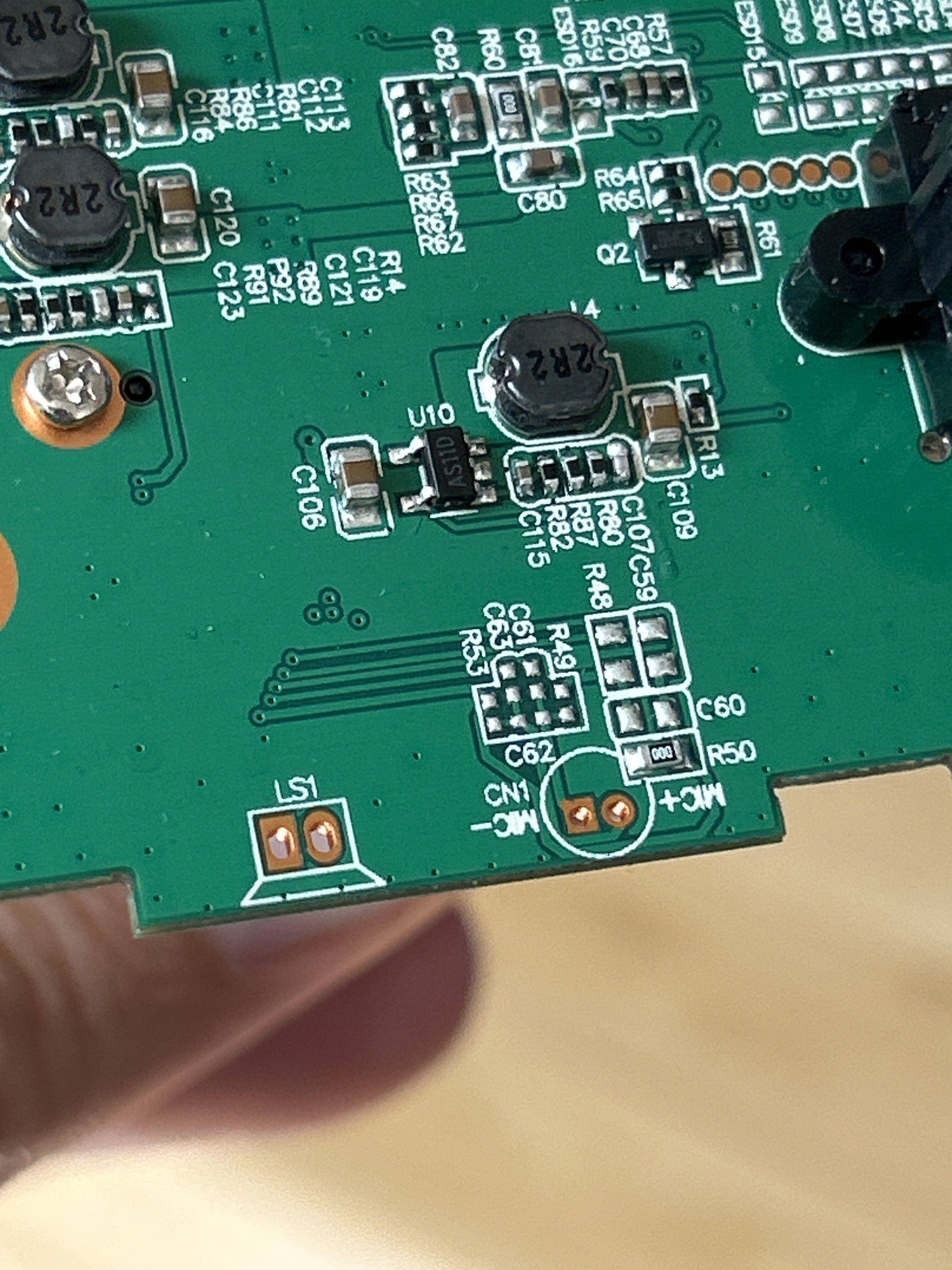

That's amazingly detailed thanks @0dan0. I've not setup a serial port. I'm not sure if there is one on the M127 so I'll take a look. Sadly my C knowledge is zero and I'm not a developer. I could hack around with it if it was something simple like Python but my brain isn't cut out for proper programming! I did notice all the serial port commands are hidden away in the binary with some syntax, so perhaps if I can find a serial port I'll take a look.

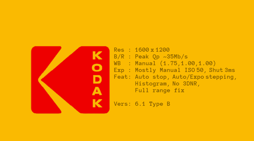

v6.1 for type B & C
In an attempt to make the frame more stable, dark images can now increase to ISO 200 (range 50-200), rather than a 16ms shutter time (4ms is the max in v6.1.) The console logging is improved to support this:
iso:100 shut:3493 enc frame:26
iso:100 shut:3837 enc frame:27
iso:200 shut:2107 enc frame:27
iso:200 shut:2314 enc frame:28
iso:200 shut:2542 enc frame:28
Type B now has working exposure controls. In 6.0, the histogram was working, but the exposure controls where still pointing to Type C address. I've since found these difference between the units:
Type A:
0x80e56134 - ISO 50 to 1600 (0x32 to 0x640)
0x80e56138 - exposure time 230us to 32767 (0xe5 to 0x7fff (or more))
Type B:
0x80e56224 - ISO 50 to 1600 (0x32 to 0x640)
0x80e56228 - exposure time 230us to 32767 (0xe5 to 0x7fff (or more))
Type C:
0x80e556b4 - ISO 50 to 1600 (0x32 to 0x640)
0x80e556b8 - exposure time 230us to 32767 (0xe5 to 0x7fff (or more))
Type B is not not look as detailed as type C, don't why yet.

These look promising to get a serial connection running on the m127. If i manage to get a console up and running will have a go at resolving the issues in that firmware.
Those are not likely a serial port. You need to find RX and TX pins/pads.
