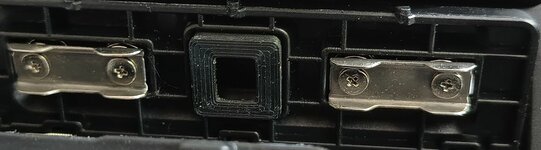

I have had such skipping and sounds on film that shrunk over the decades and doesn't align well with the advancing mechanism. Not sure that it is a defect in the Kodak.
CDenhart ​
Thank you for trying to help me. I've tried the firmware from the link before. Some didn't work and left only red spots on the screen. Some worked just like yours, but they all had the same defect. The opening image was different from my original. So the way back to the seller is closed and I won't try it again.
TheFage ​
I noticed that some of the film was twisted, probably because it was cut incorrectly. Holding the door slightly open helped a little. The film went smoother. I'll try putting softer springs under the pressure plates, that might help. Someone mentioned it here already.

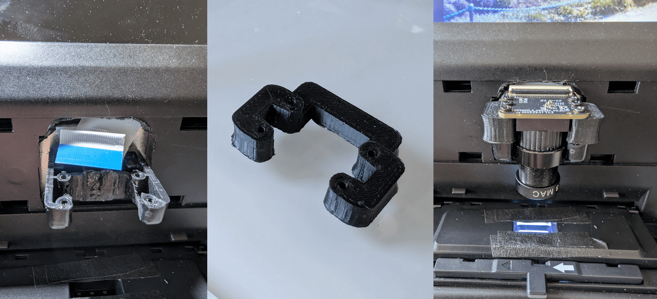

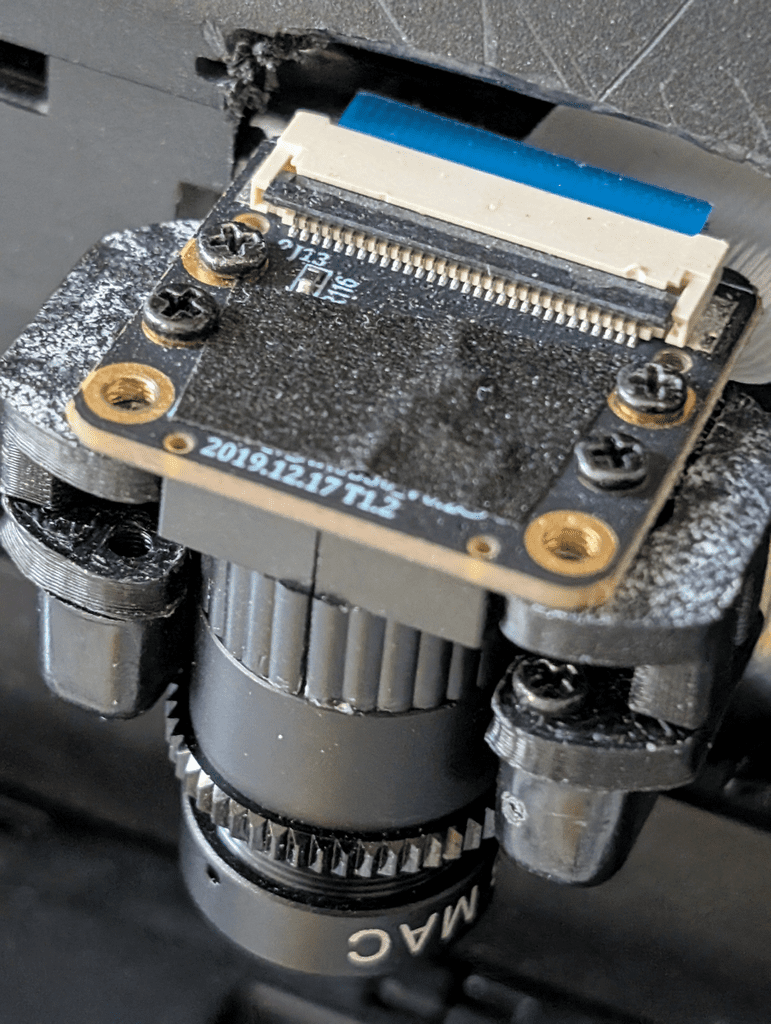

3D printed the lens offset. Attached is more model for the 3D print. Now my frames in focus and not skewed. There is even space between the lens, and the open film loading door.

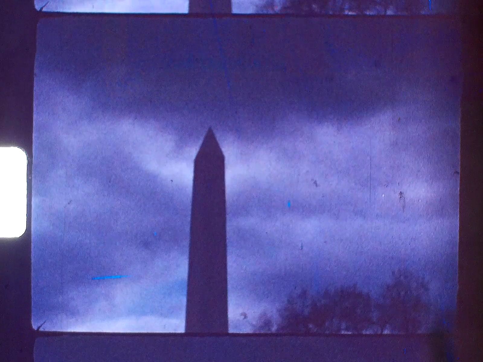

So difference between the frame is hurting the quality.

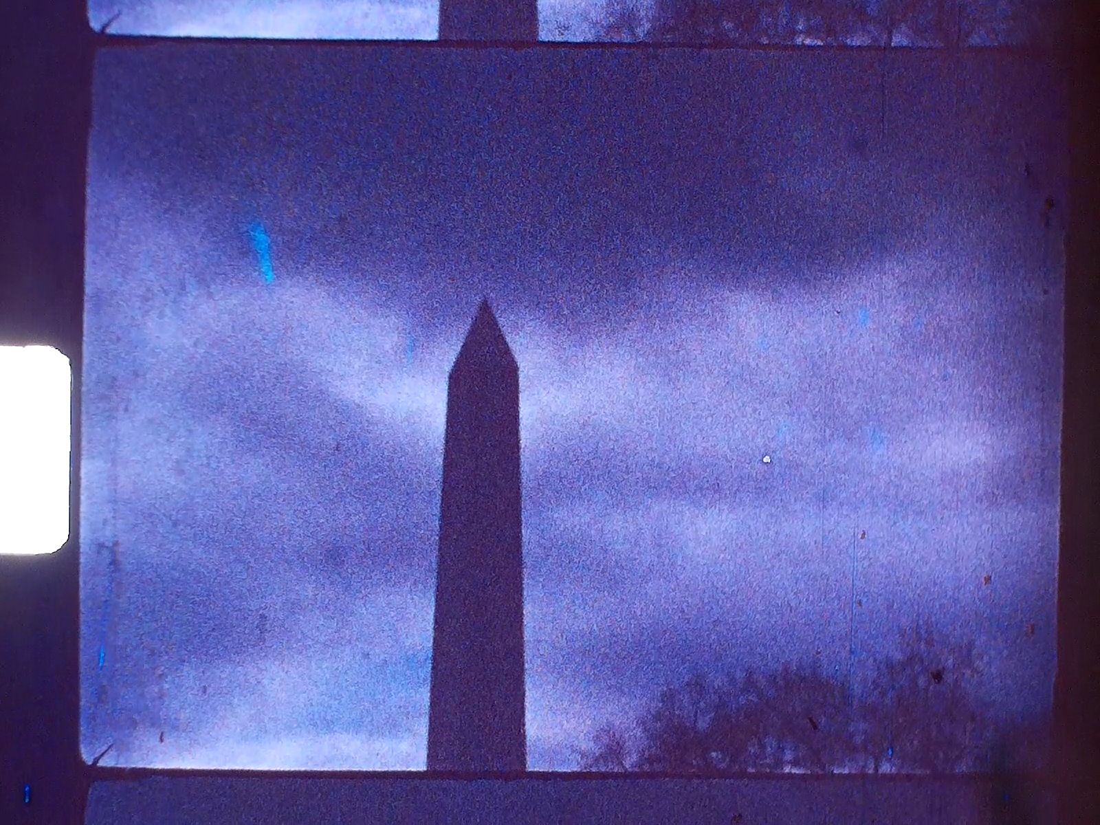

When the grain was different between compressed frames, the image is blurred, particular when the scene lack contrast:
But when the frame isn't moving, there is significantly more details (this is the grain I want in every frame.) View attachment 20270
This could be a QP factor for P frames? Any ideas on what this could be?

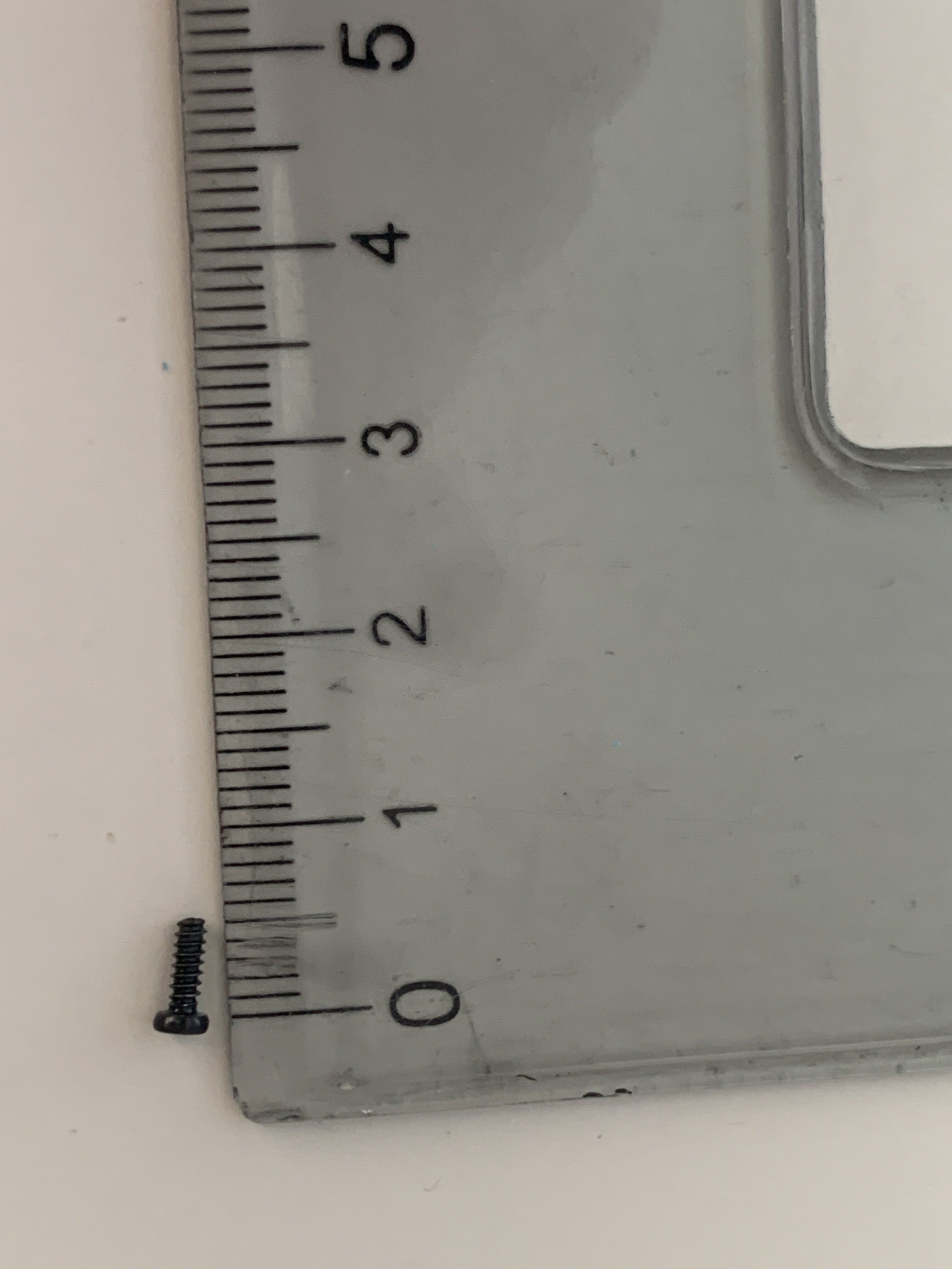

Hello 0dan0, can you please tell me the code of the new screws for the new height?
I've ordered the 3D Lens spacer. I guess they have to be 5+7 long, but I have no clue about the pitch and depth of the screw threads. Thank you.

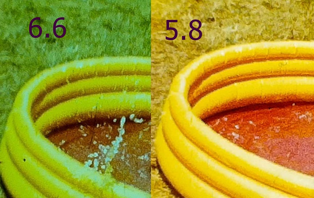

Of all the firmware versions here, I can't decide whether to use 5.8 or the latest 6.6. Both pictures are with the basic settings.
6.6 has a user controllable white-balance added to the menu, so you can set the look more as you need (5.8 was a fixed WB with aggressive red gain 1.75,1,1.)

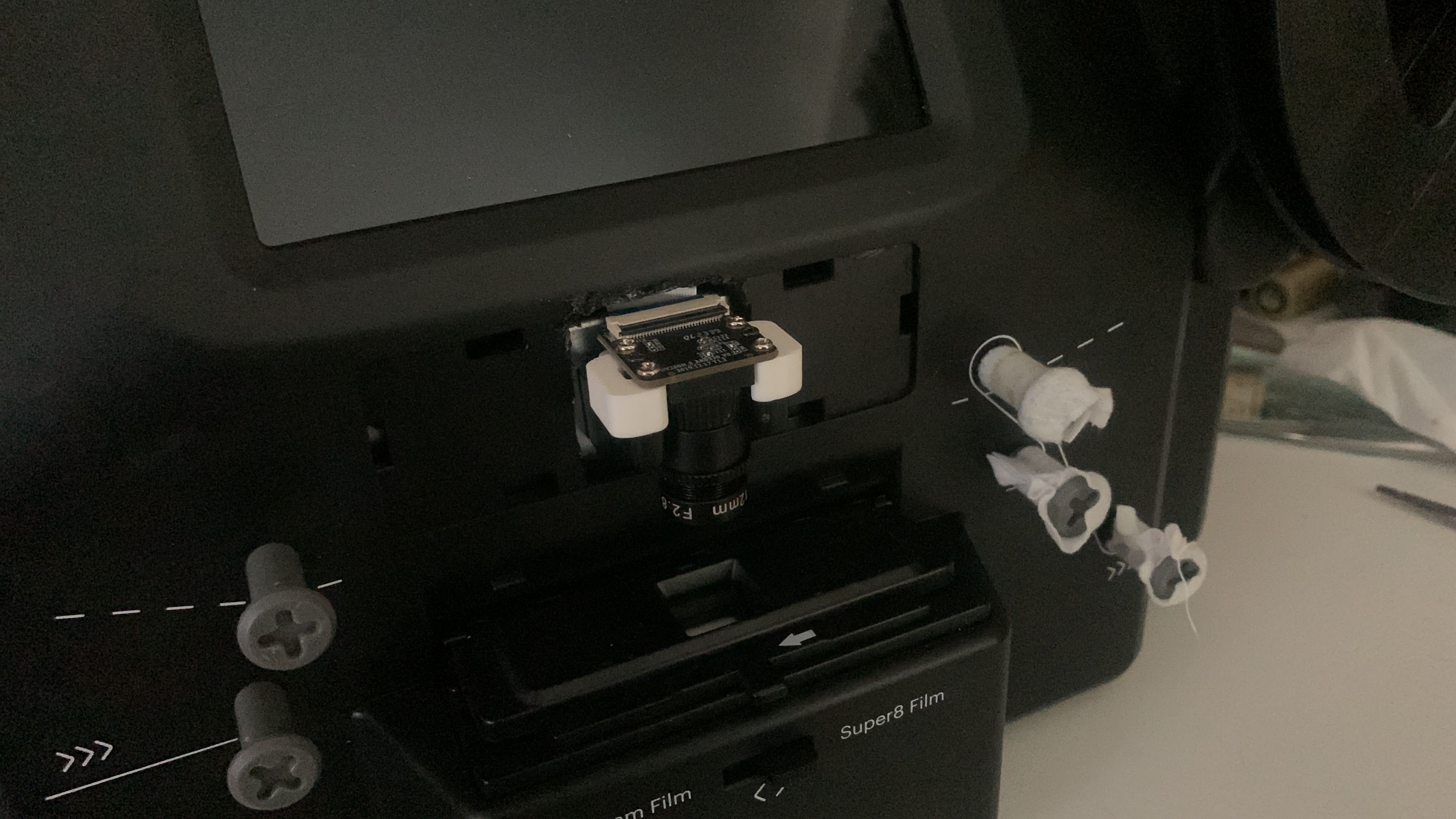

Mechanical observation:

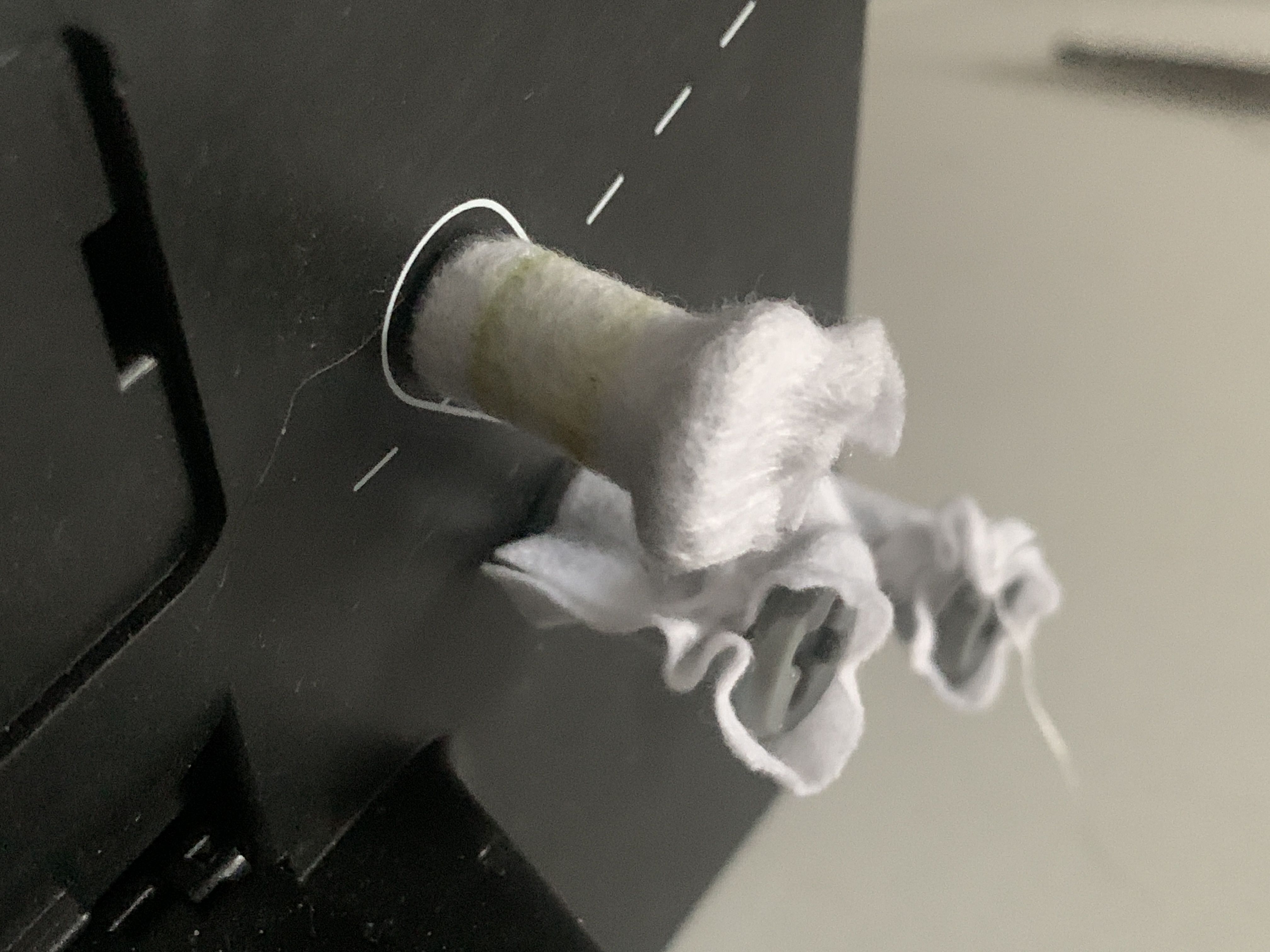

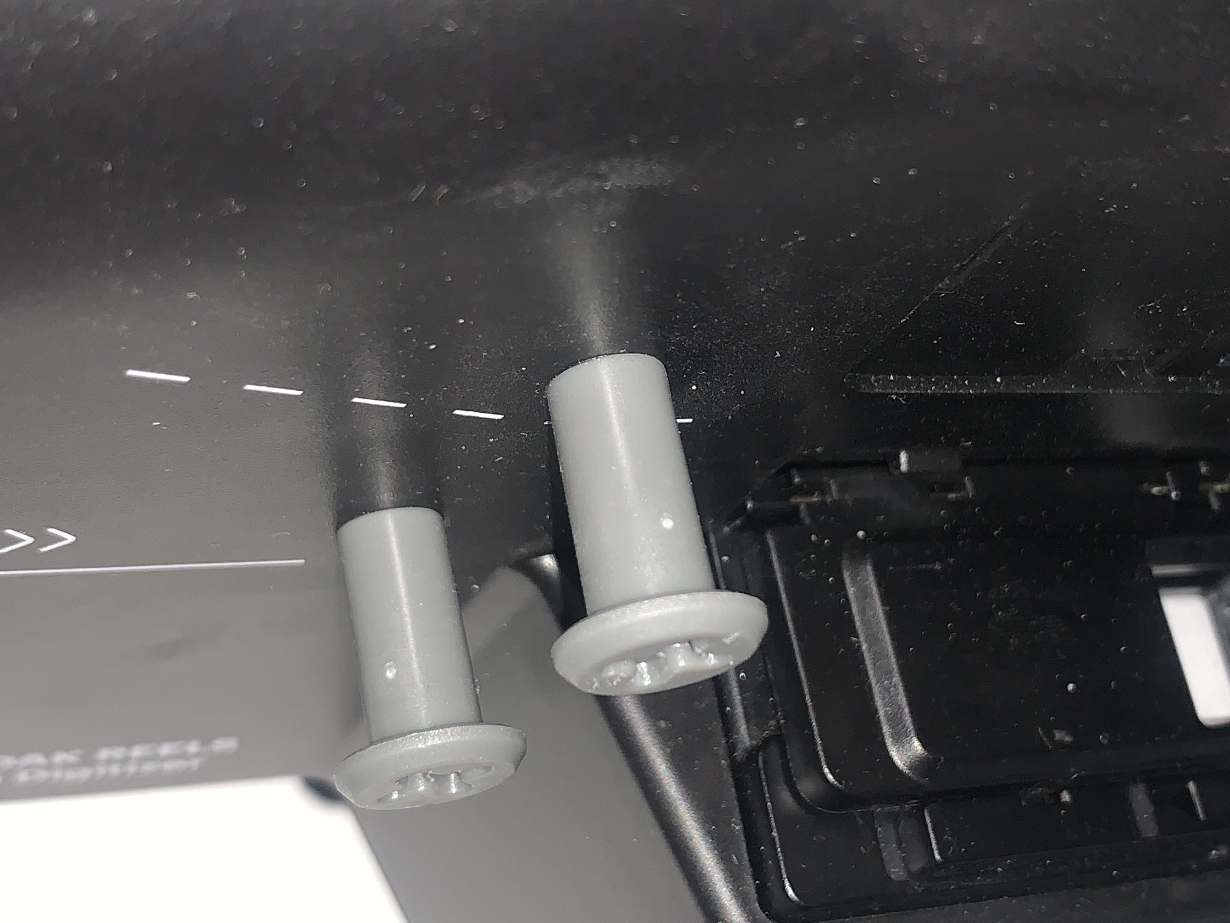

1. The pegs that drive the film have a fusion plug (they are made of plastic) that can cause scratches. I don't have the competence to dimantle the digizirer, so i opted to turning the fusion plug to the opposite direction of where the film gets in contact with the plug.
Then I sewed some PEC PAD tissue onto them, in a single layer (I'm not a Taylor :) , I know I can improve). Notice how much dirt It has already collected.
The take up motor has a significant strength and tension.
Now the film runs smootlhly.

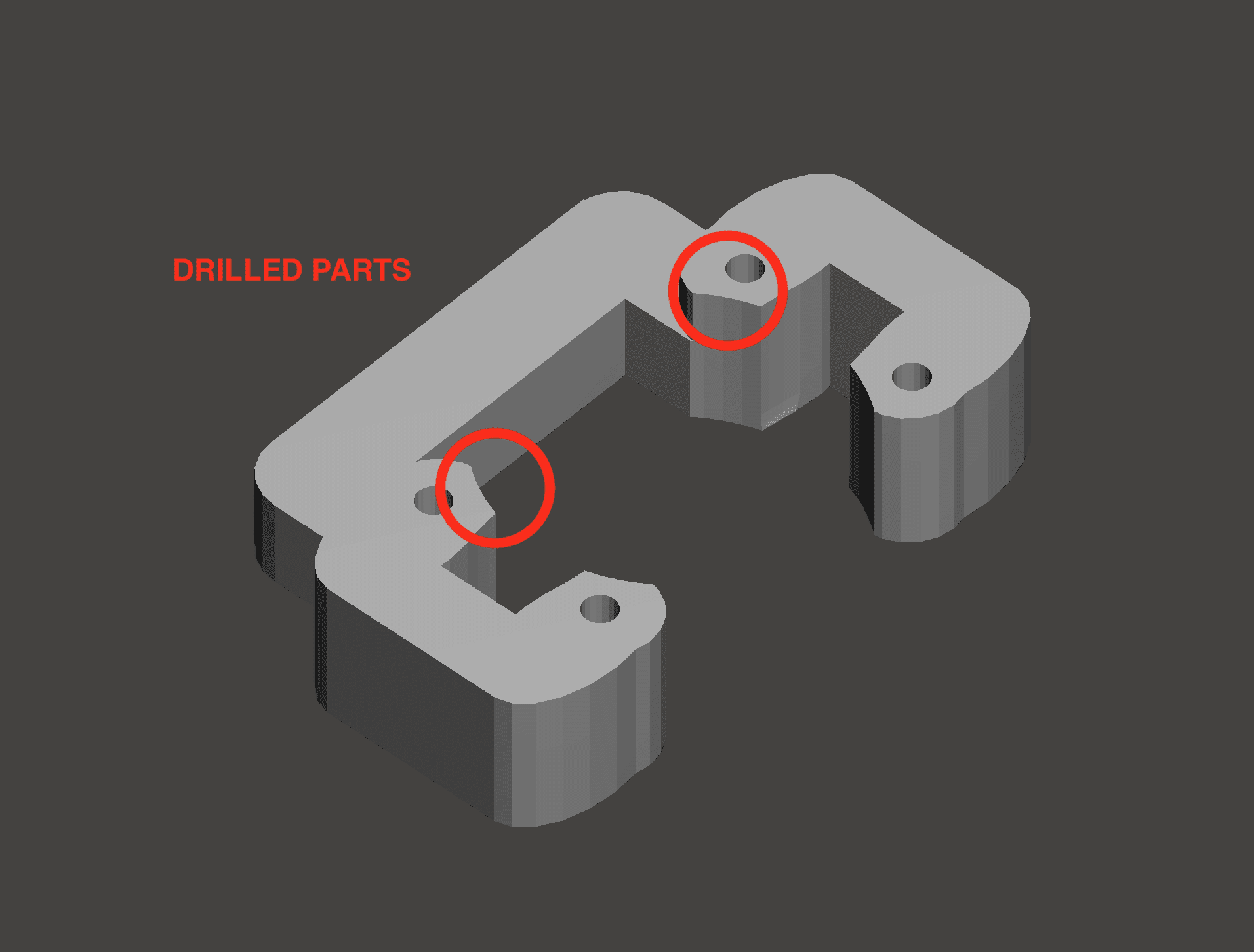

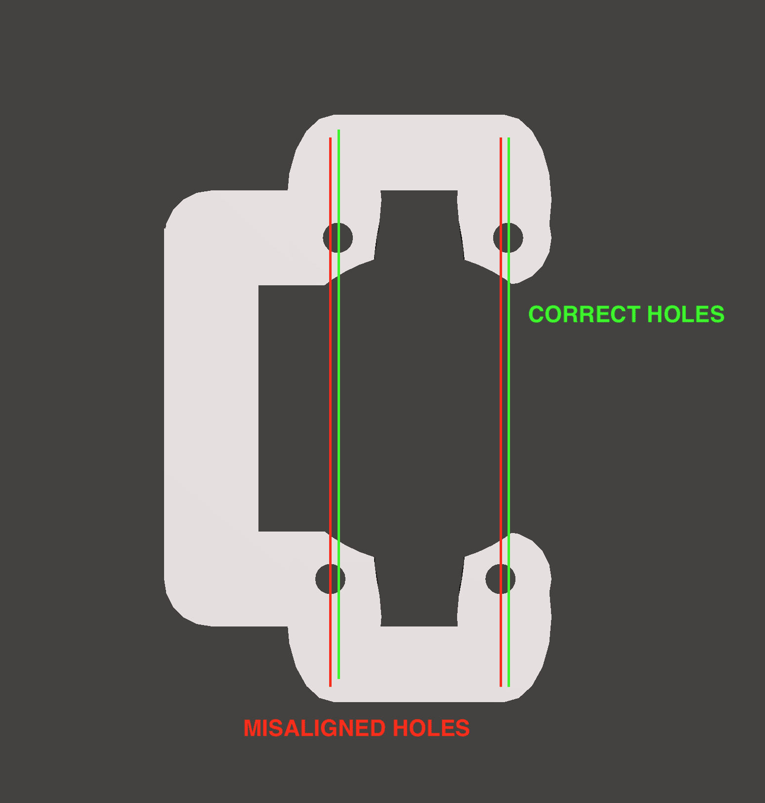

2. The STL file that 0dan0 kindly provided needs to be customized.
I drilled it a little because the two left holes are misaligned, and the camera was tilted to a side.

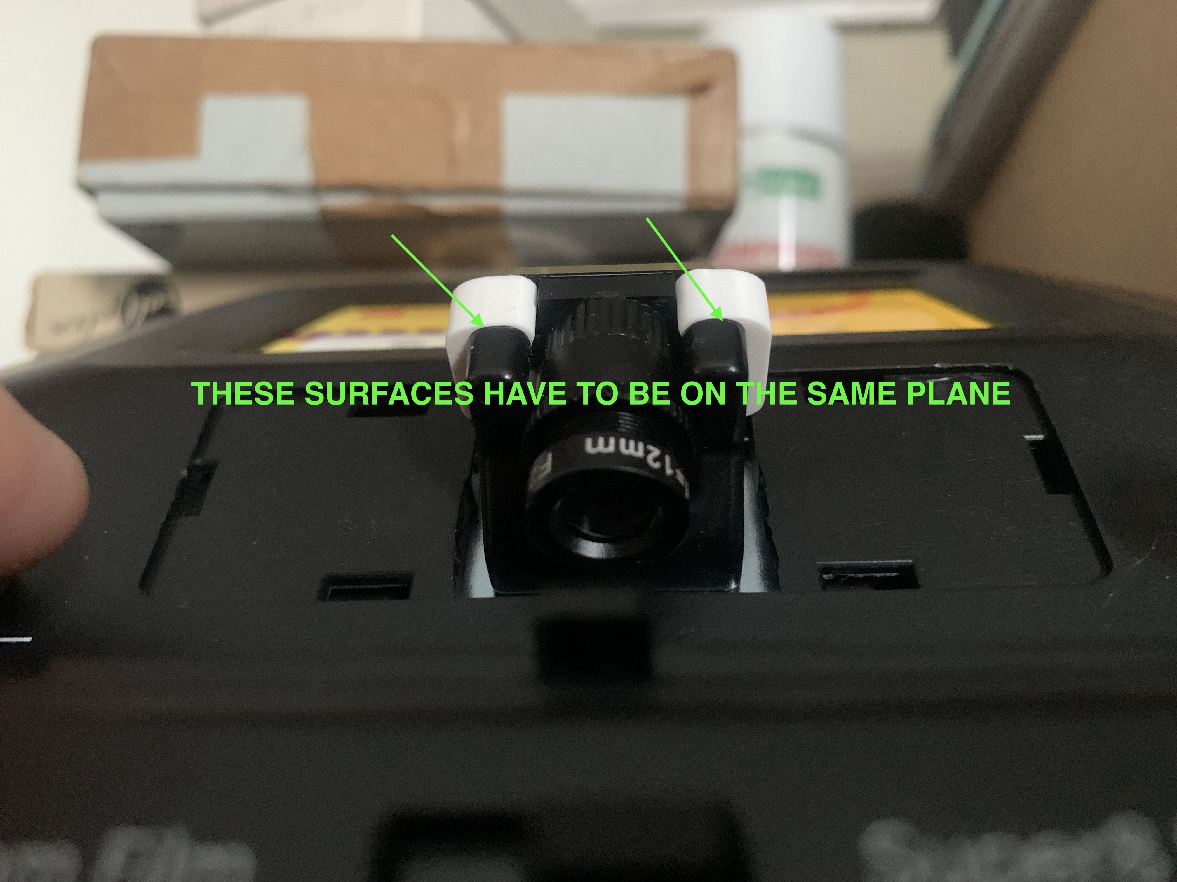

you can check the alignment, the surfaces have to be on the same plane
otherwise you'll get a tilted image

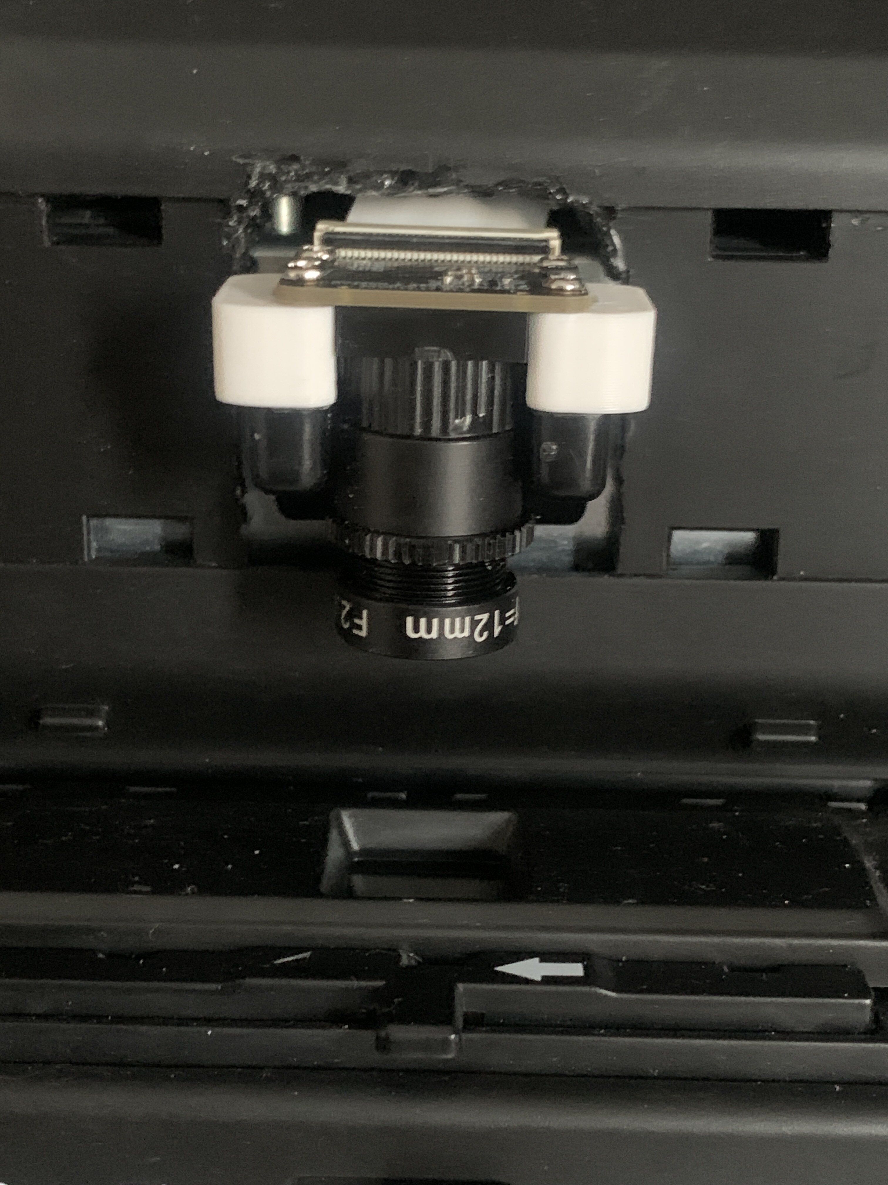

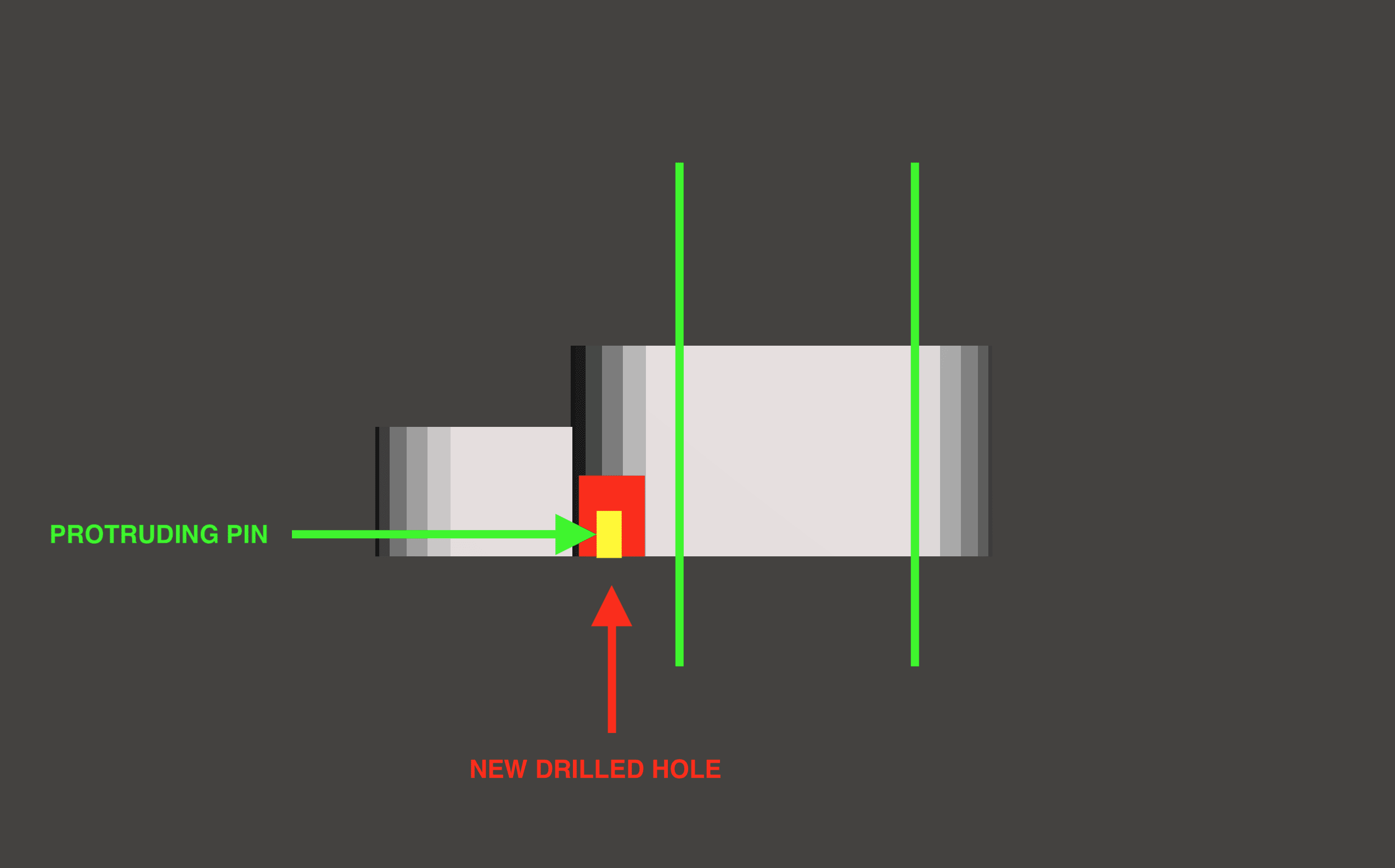

I drilled also the back of the spacer to make room for two little pins protruding at the back of the posterior screw hole
I also drilled the top of the posterior holes, because the camera lens mount has a square shape that interferes with the spacer.

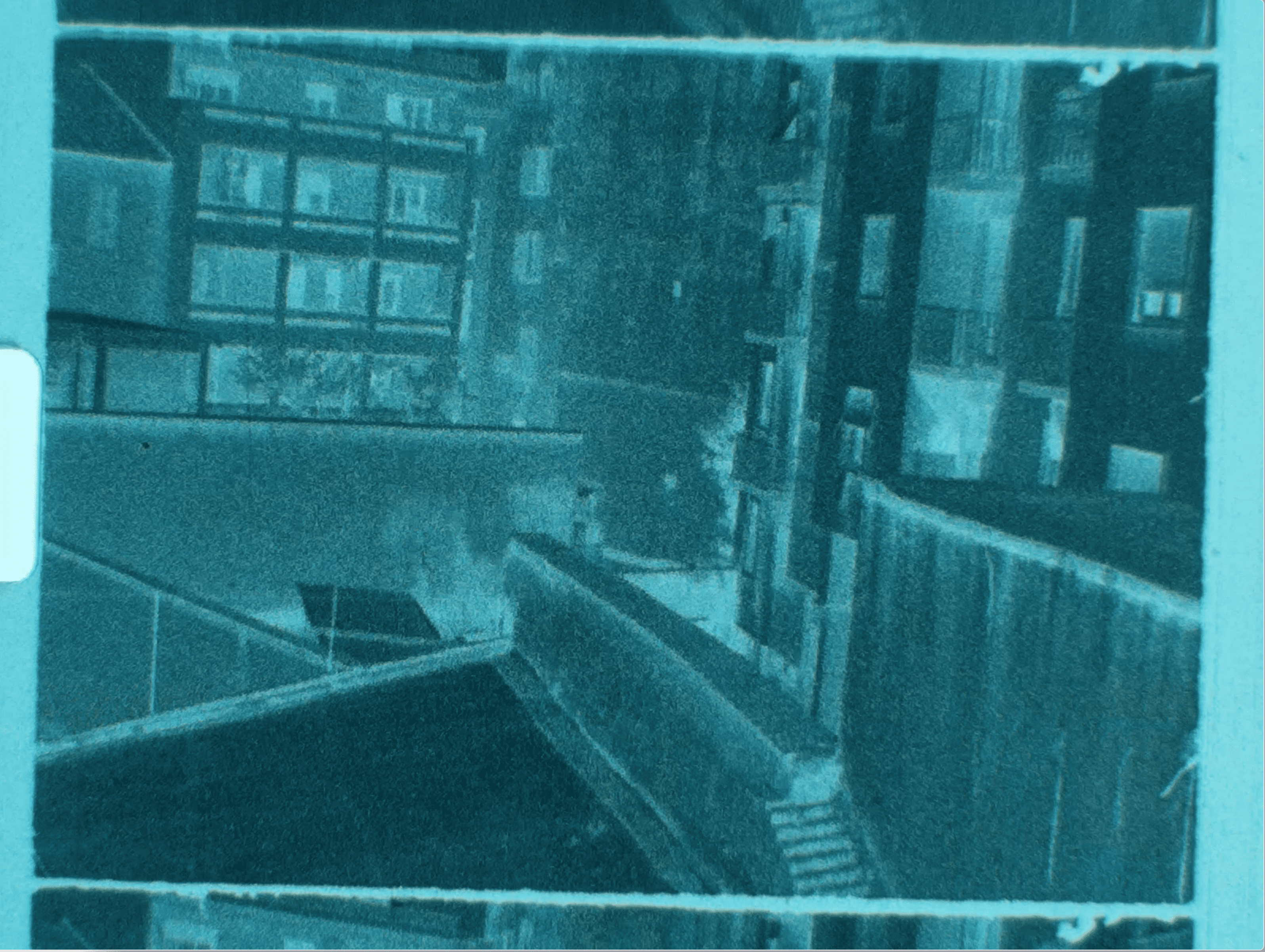

@0dan0 I uploaded a new scanned reel, a Kodak Vision 3 50D.
It is my first attempt at home developing, many errors are present (insufficient rem jet removal, inconsistent development), but on some frame you can judge the fine grain.
