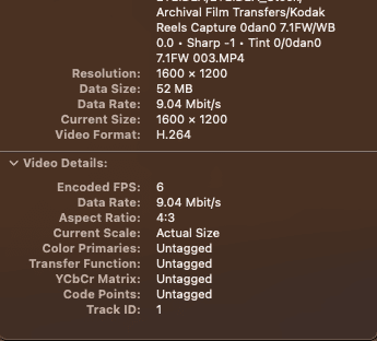

Movie specs - 0dan0 V7.1 on Type C ...

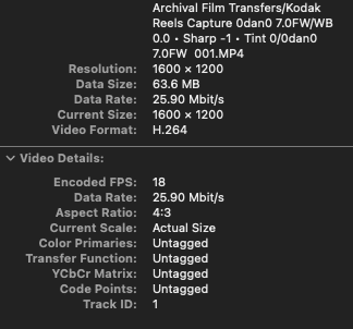

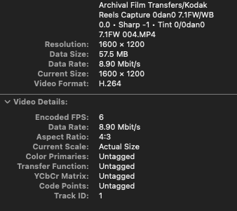

Went back to 0dan0 V7.0 on Type C and got this ....
Still getting some anomalies, FPS, data rates and also one capture stalled, the film was moving through, but the SD card just repeated the same frame for many seconds
Also I was seeing 464x224x256 in the WB values on this. Going above 256 for the first RGB value?

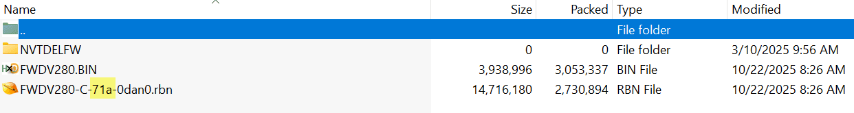

Seems you did get the update to work. You need to redownload v7.1
within the zip you will have 71a.
But otherwise would be hard to tell, also the file date is 10/22 not 10/21.
Opps, do I load both?
FWDV280.BIN
AND
FWDV280-C-71a-Odan0.rbn
... to the root or just the .BIN file?

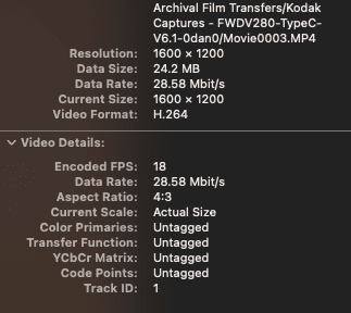

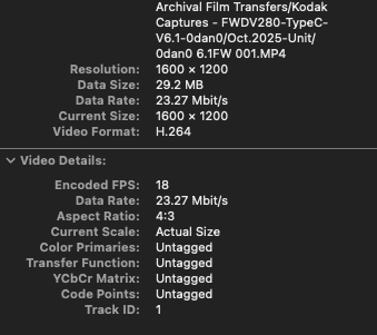

If its any help ... here is Quicktime data on capture from V6.1
However this was a different Type C unit from January.
I am gonna try V6.1 on my current Type C unit and see what the result is.
Here's V6.1 on my newest Type C purchased a couple months ago ... looks like correct data, same SD card, no stalled frames or captures issues. 10 sec clips plays all frames

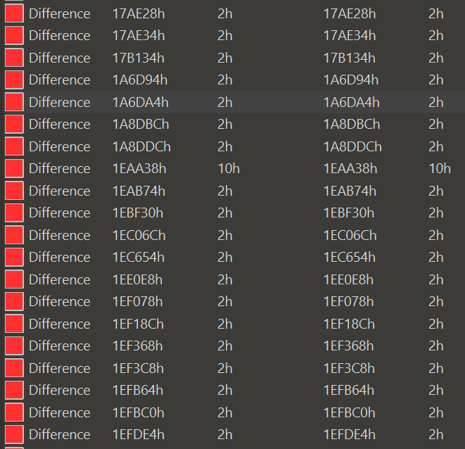

I did covered that the base timescale for the MP4 was hardcoded to 60000. To get the frame rate changes correct, a lot of code used 60000 directly at the assembly level. When fixing the 20fps to 18fps, all I changed was the numerator in the frame rate setting. But for 24fps, the numbers exceeded 16-bit, so I need to change the time scale.
This are all the locations I have found that I believe are timescale.
While the is unlikely to be useful information for others. It is here to keep a record. If something else breaks, one of these changes might have been wrong. I was searching for uses of 60000 in MIPS assemble code. Hoping these are all the timescales. I'm now using 20000 for the timescale (solving the 3x error you may have seen.)
Both Mac and Windows users need this fix. All working well in my testing.

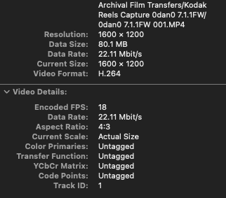

V7.1.1 working great on my Type C, no longer hangs (stalls) at 0:17, Quicktime .MP4 shows 18fps and ~22Mbit/s, picture looks very good.

QuickTime info:
Sample from V7.1.1 on Type C

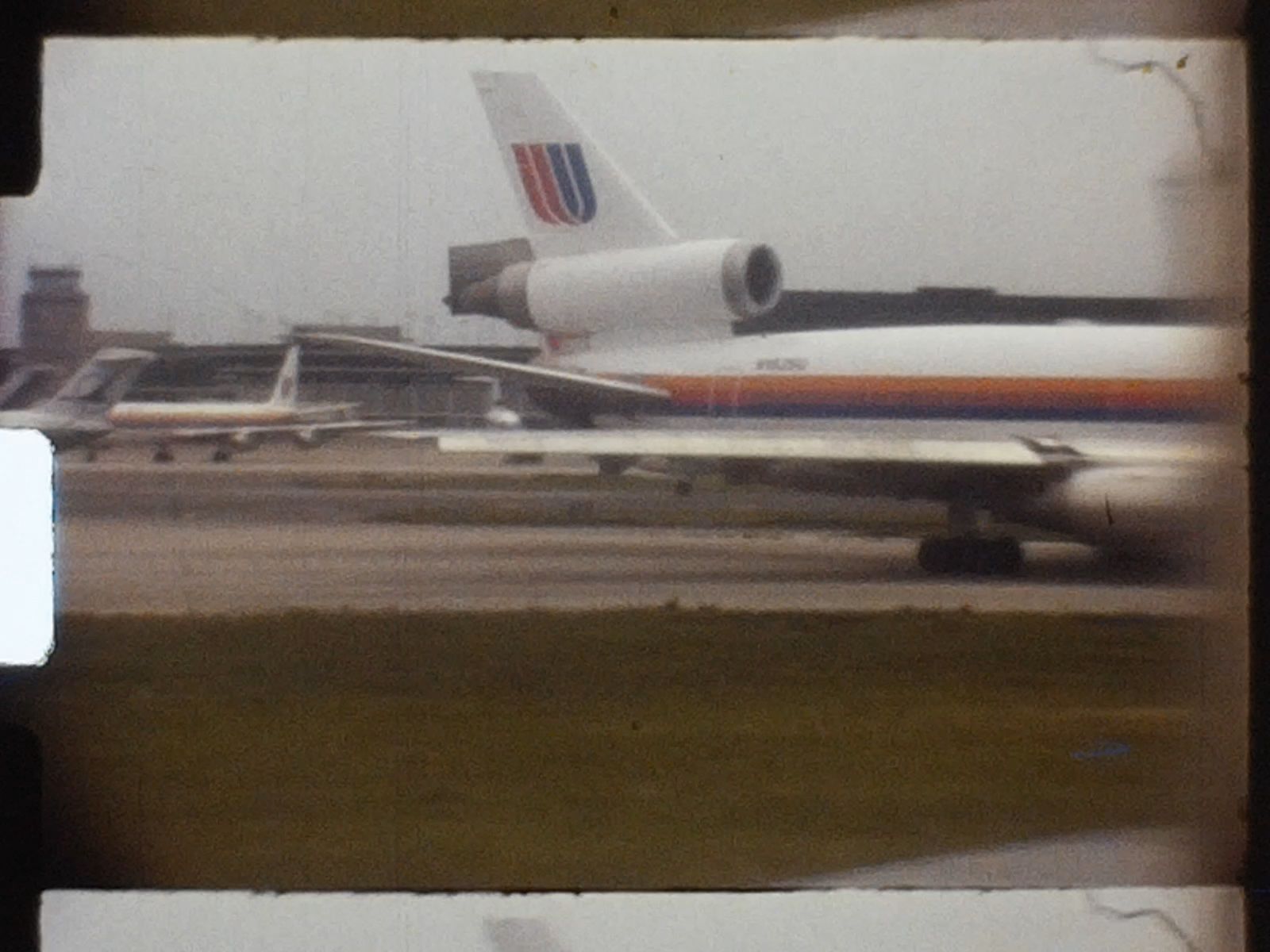

Stock Lens + Settings: Exp: Default WB: 0.0 Sharp: -1.0 Tint: 0.0 Frame: adjusted to a sweet spot

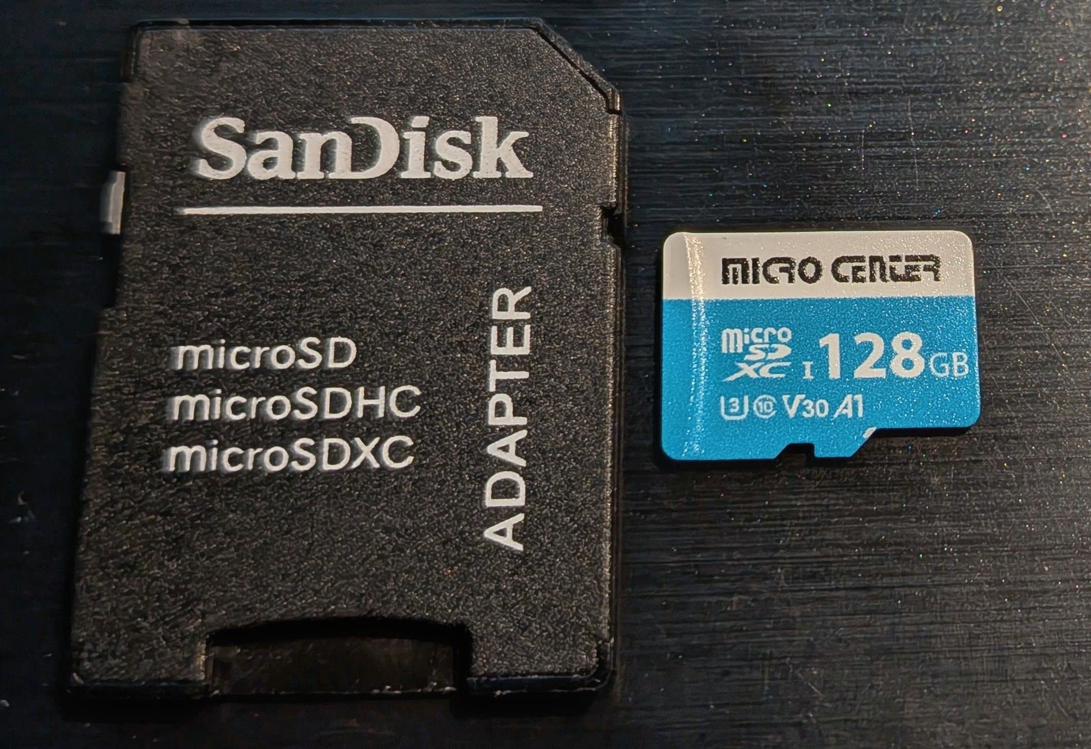

FWIW, I am able to save an MP4 file of ~4,000 frames (50-ft roll) created by fw v7.1.1 on my Type B device using the 128 GB SDXC memory card formatted as FAT32 in the attached photo. After the last frame has been scanned, I press the 'OK' button, then select 'Close', and finally turn off the unit before I eject the memory card.
Surely I'm not the only person who is able to save an MP4 on a memory card larger than 32 GB?
Reactions: eyeidea and 0dan0
It seems than that it is exFAT, not the media size that is the issue. These units do not support files greater than 4GB, so formatting larger media as FAT32 is of little harm.
Reactions: eyeidea and sheider
Sticking to FAT32 with these units doesn't bother me one bit. That said, I believe that other folks have reported that the firmware (stock and presumably all mods created to-date) formats memory cards as exFAT when someone chooses to use that feature on the unit. That is why I suggested trying to disable that feature in the firmware and/or the UI, to avoid user questions / complaints.

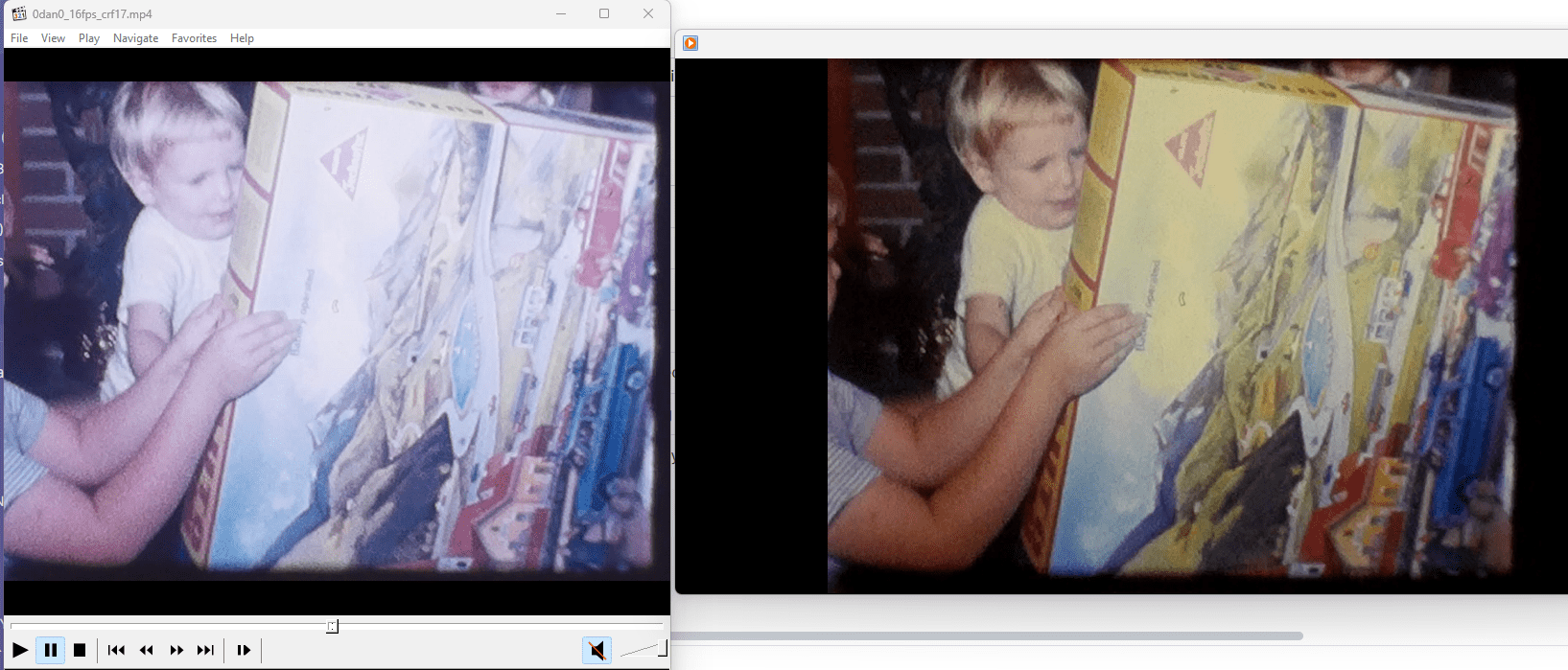

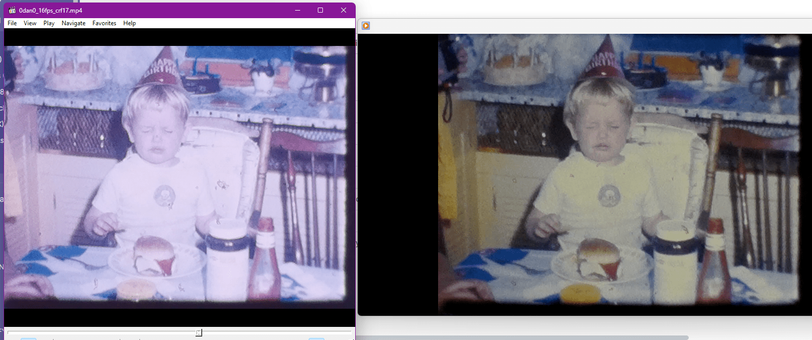

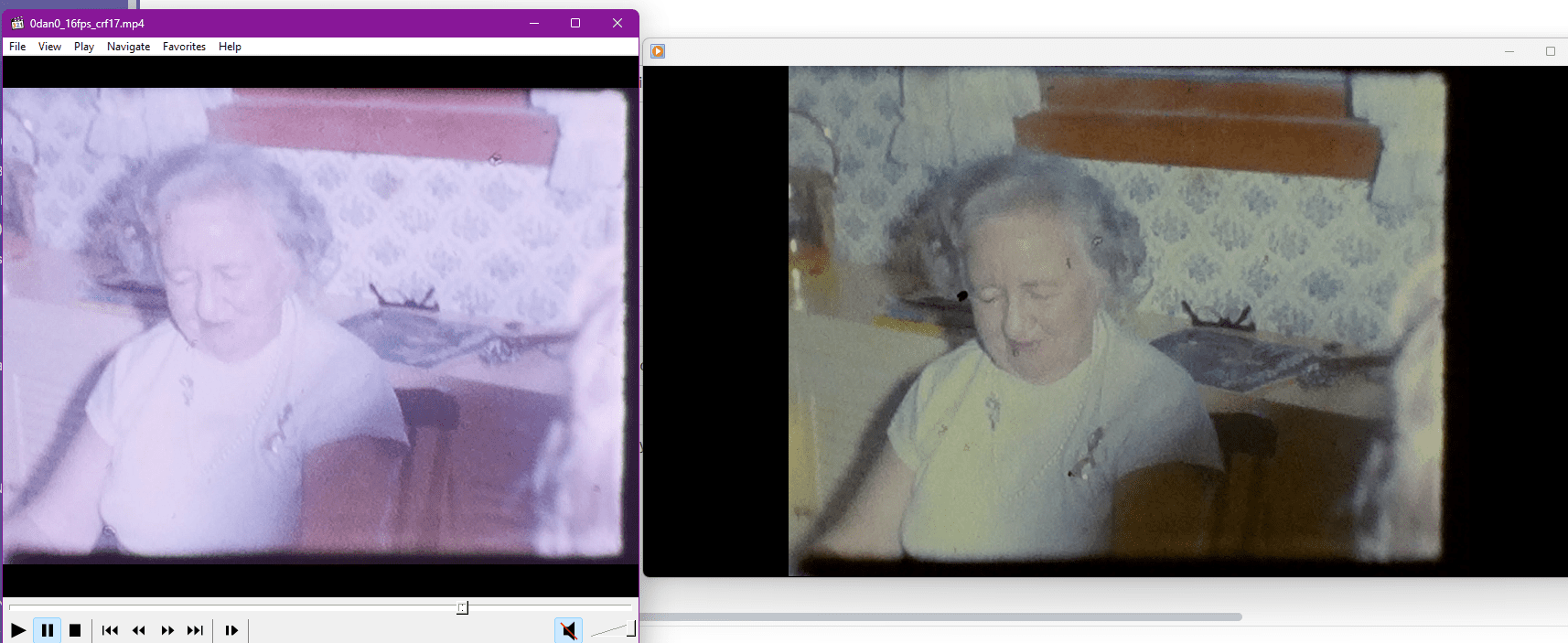

I went back to the MAC84 firmware because i was getting frustrated at the colors I was getting with the newer FW. I scanned about 15 reels and they look great aside from the AWB causing tonal shifts. However using the 0dan0 FW, I am finding that every time the scene changes it looks blue-ish or washed until I go back into the settings and tinker with it a bit. I think I understand why Kodak went with the AWB to begin with, I have found on a lot of my old reels that they are changing locations a lot, causing the white balance to look great one minute and wildly inaccurate the next. Is it possible to get a FW with ll the upgraded settings but with AWB enabled? I love the upgraded resolution and bit rates of the newer fw, but the white balance controls don't seem to work nicely with my reels. I have tried all suggestions that you have given me 0dan0.
Edit: I'm going to post another side-by-side of the 0dan0 fw and mac84 fw to give an idea. Stand by
I wasnt able to do video because im currently at work. The side by side comparisons look close, and I do prefer the look that the 0dan0 fw has, but something definitely happens in overexposed scenes that shifts the highlights and blows out the whites. I am not a professional by any means and this is all new to me. I'm just reporting what im seeing. The Mac84 config seems to work great albeit the auto white balance changing the tone in the scene. I plan on doing my best to correct that in post. I prefer using the 0dan0 fw because i like having fine control and a visual histogram, i just cant seem to get the hang of it.
