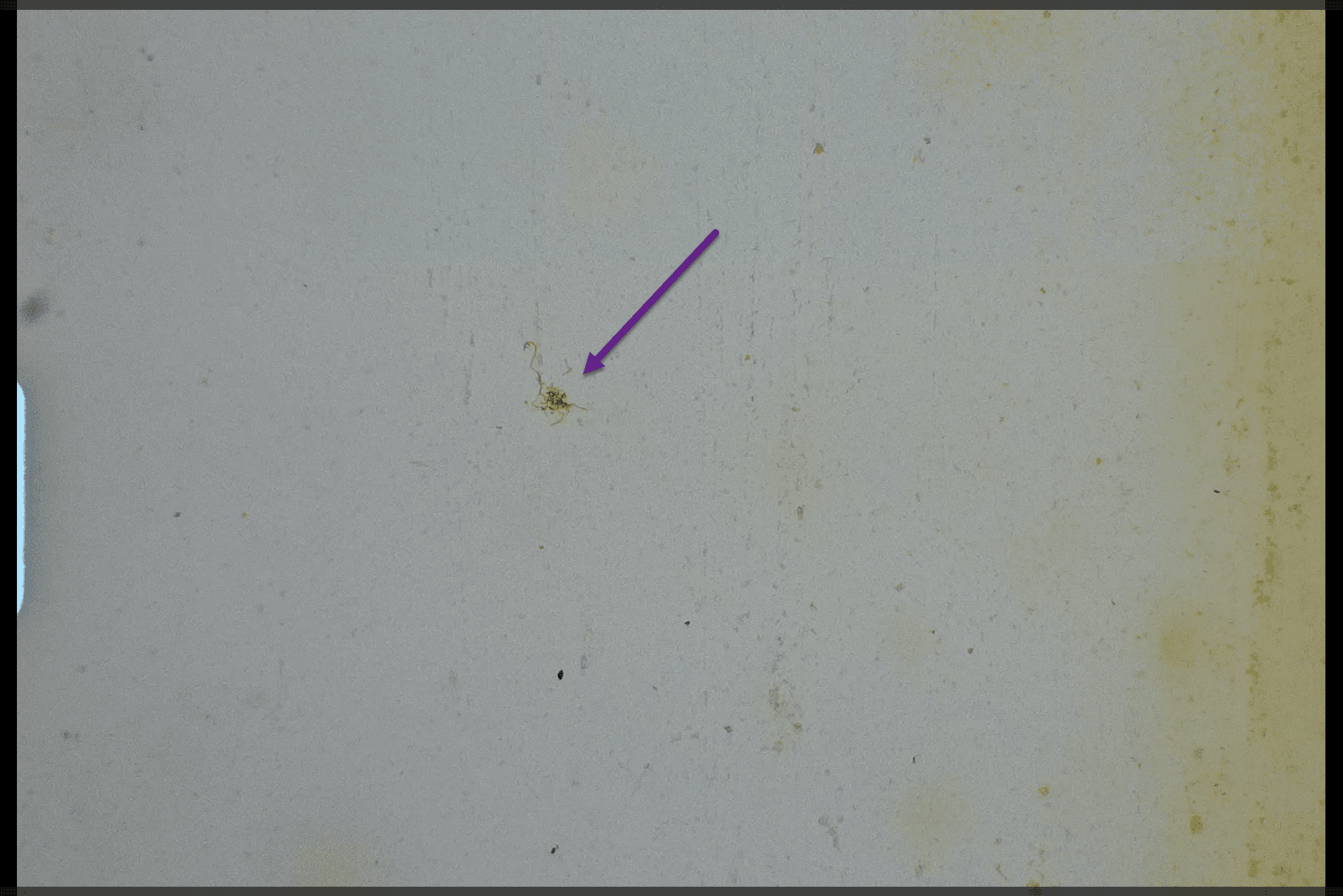

With a Model C on v7.1.1, I started scanning a 7" reel of Super8 film yesterday. Started off going well for about 7 minutes of resulting footage (with no issues on the resulting file). And then I had to stop the capture to re-frame the image. I restarted the capture and it automatically ended after about 17 minutes of resulting footage (the MP4 file is 4.2GB in size). When it ended capture, the scanner's on-screen display'gave me the typical poup message about closing or playing the file. But the scanner seemed to be frozen because it wouldnt' respond to button pushes. I was able to power off the device and the most recent captured file was okay. I am curious if the capture ended because of a 4GB filesize limit. On previous scans of 7" reels (about 9 months ago), my files never exceeded 4GB, even with Mac84's increased bitrate firmware.
Also, I'm sad to report that the entire 17 minute long video had some jitter on the bottom of the image (where I had only previously seen it on the top, when it would occasionally manifest - but that was on a different scanner, with Mac84s firmware). Here's a sample from it:
Still not quite sure what triggers that from happening sometimes, but not other times on the same footage.
Reactions: Umba67 and eyeidea
@ThePhage Sorry to hear about your issues scanning 7" reels. I only have 3" reels to scan, so I don't have any 4 GB file size concerns. However, I also had the device "freeze" during a 3" reel scan once... I can live with that, because it hasn't done it since. Regarding the random jitter issues, I can think of a few possible causes:
1. Dirt/gunk accumulating in the gate path during a long scan
2. Not using all of the "rollers" on the right side of the scanner bed
3. Film not under all 4 tabs in the scanner bed
4. Hardware glitch such as a motor hiccup
5. Perforation tear or bad splice on the film
6. Takeup (drive) reel hub not fully seated on the drive spoke
7. Friction: Film stuck together or rubbing against the sides of its reel
Good luck, and don't tolerate faulty hardware if your unit is still under warranty!

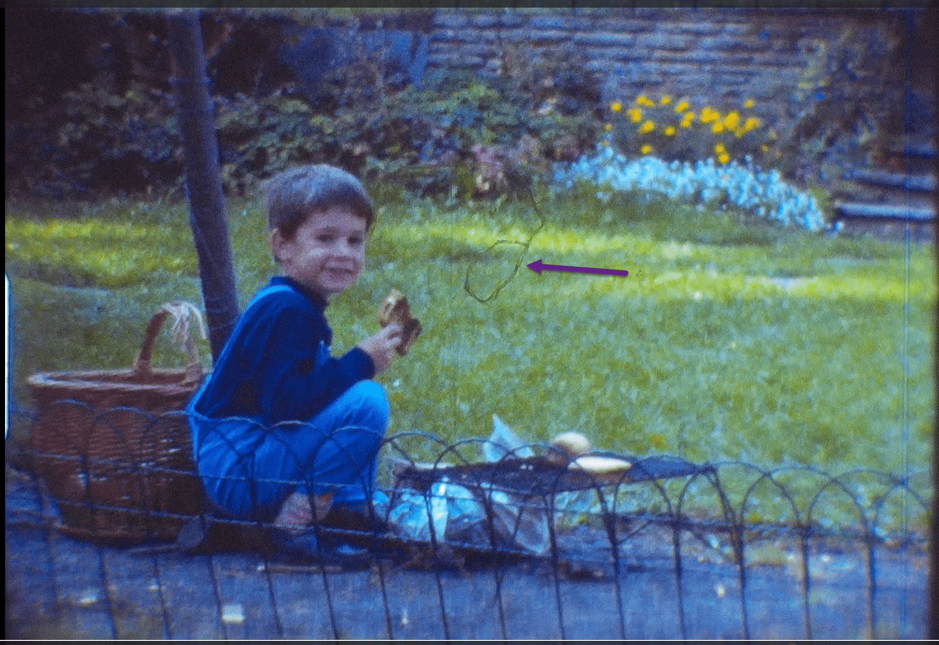

I use @0dan0 s V7.11. I recognize sometimes flickering, but this I could resolve in a second scan with one or two steps down or up in framing depending on the location where the flickering occurs. The flicker is not dependend on the software but on the frame located in the scanner.
Now that the days are getting shorter (and the evenings longer), I'm finding time to read here again...
I've now converted my C-scanner to a Scorpio lens.
However, I'm still struggling with the quality of my images...
The preview on the scanner display shows sharp images (the preview is - well, not that big...) – but in the film produced, I think the resolution is much worse.
Firmware: odans0 7.1.1
My settings:
WB: -1
Sharpness: -0.5
Green: 304 (432, 304, 320)
ev: 0
FPS: 18
The scanner shows:
- ISO 100
- Exposure: 2891
Yes, I know about this “video compression” – but is it really that “bad”?
Does compression also depend on the image content?...
I think that the image quality is quite good in the white opening credits (deepl, are you sure about what you've translated... :-) )...
But when the images start, it somehow becomes “mushy”.
Is that really “grain” – even where there's another bit of fluff – and it seems to me that it's not reproduced very sharply.
(Admittedly, the image may not be really sharply focused...)
I also took a series of shots with sharpness settings ranging from +2 to -2.
In my opinion, the videos with -1.5 or -2.0 look best. But I think Odan0 once said that with the 12 mm lens, a sharpness setting of -0.5 (or 0) would be okay...
Am I doing something wrong?
Thanks & best regards,
Thomas, who is still impressed by what has been happening here over the last few months. :)
Reactions: eyeidea and 0dan0

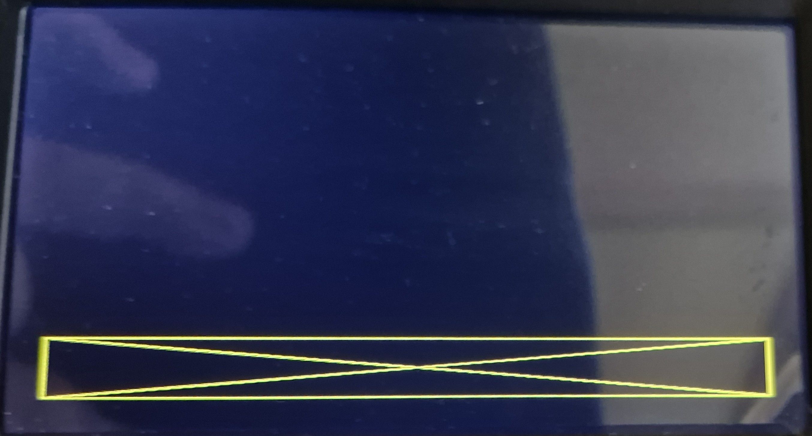

With the now modified lens, I have started to “unwind” my film rolls :)
I have the odanO 7.1.1 firmware on a C-model and have noticed something that I never noticed in the earlier versions in the summer of 2025 (but maybe I didn't scan long enough back then...).
Issue 1:
The scanner simply stops – sporadically – with no apparent connection so far.
Sometimes the frame counter on the display continues to count, but sometimes the frame counter also stops.
The file has different sizes (e.g. 1.6 GB, or even only 45 MB – there are still x GB free on the 16 GB card...).
When I then “cancel” (so that I return to the main menu) and continue scanning from there, the scanner often stops again after a few images. I then switch it off and on again.
In the files, I can't detect anything unusual when playing them back (on the pc) in such situations (but I haven't really looked at them in detail yet...).
This is not a problem for me – I am simply sharing this information with the developers (as a possible hint for other issues :giggle: ).
Topic 2:
When I let the scanner ‘run empty’ (i.e. the film has come to an end), it stops after a few moments (thanks, OdanO (y) ).

I had to use a new and empty 32 GB SD Card, well formatted. The scanner shows a yellow rectangel with a yellow cross in it when I wanted to start scanning.
I put a text-file on the card an scanning was running. Just to report the behavior.
Hello TheElk,
I can't reproduce your findings.
My 32GB card isn't recognised (as soon as I try to start recording, this yellow St. Andrew's cross appears).
I can start recording with a 128GB card, but nothing is written to the card....
so I'll stick with the 16GB card for now... :-)

I don't follow. Attach pictures
I have to correct my expression. I formatted the ard with 8 k, showing the cross with and without a file, 16 k showing the cross with and without a file, 32 k was today workig without additional file.
Hello TheElk,
so I'll stick with the 16GB card for now... :)
Kind regards,
Thomas
What Blocksize did you use ? See my answer on post ( #859 ). May be try to put a small file on the card when attached to your PC.
