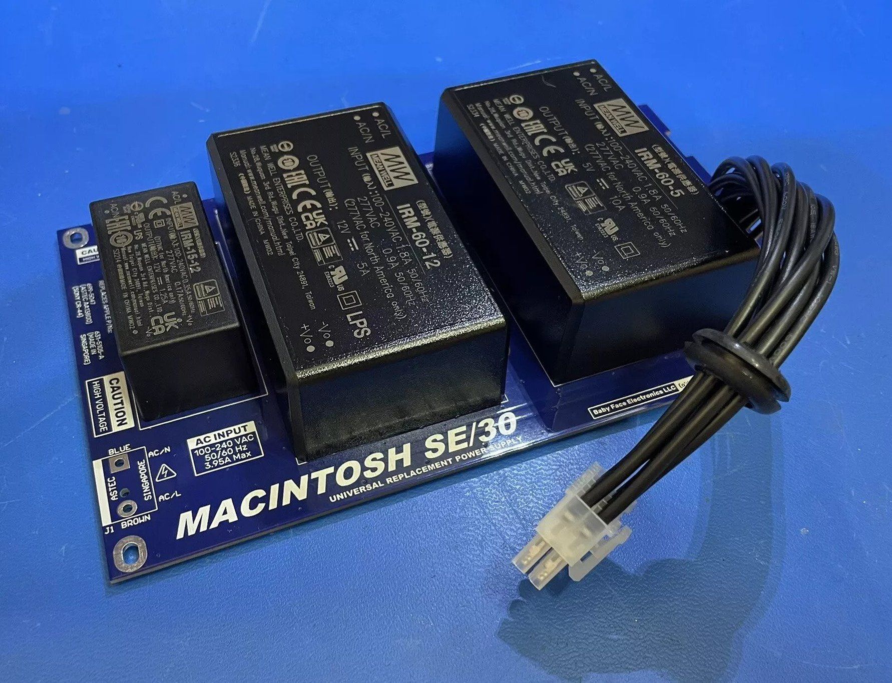

Does anyone have experience replacing the stock power supply (Sony/astec) with a modern build? I am in the process of recapping a PS but it’s a step up from even the logic board in terms of of difficulty. If I botch it I might either send it off the Amiga of Rochester or try one of these units.
I have one of those units in a working SE/30, and I plan on buying a similar one for an empty shell of a power supply for another build. Pricey, but works and keeps the original aesthetic.
it is a good alternative when capacitor leakage has wrecked the original PCB.

Baby Face in mine, works well. only thing not to like is all the text is upside-down.
will try the TT Design when (if) they become available again.
Don't know if I'd ever want to use one of those replacements.
They seem quite noisy.
80mVp-p for the 60-5 module 120mVp-p for the 60-12.
Would be interesting to know what the Apple specification is for ripple for the original power supply.
In my review of the BABY FACE, oh yes. I had a lot of noise on the 12V rail shortly after power on, such that it even appeared on the CRT. I show that in my video with scope measurements following, starting at 23:29 below...
Reactions: iantm and muse
That's interesting, thanks for sharing.
Those things are designed for modern applications that can tolerate some ripple but generally don't play nice in our vintage machines.

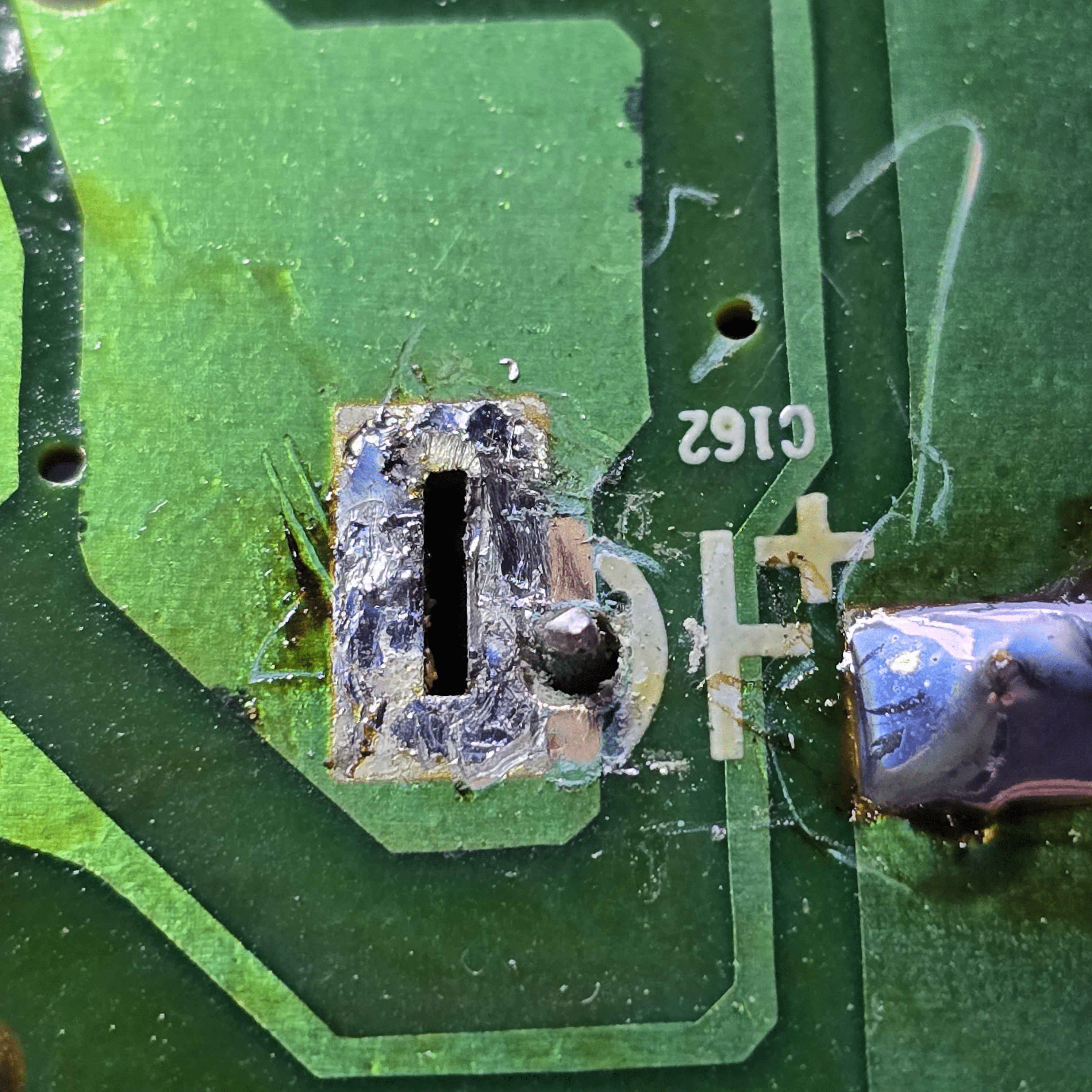

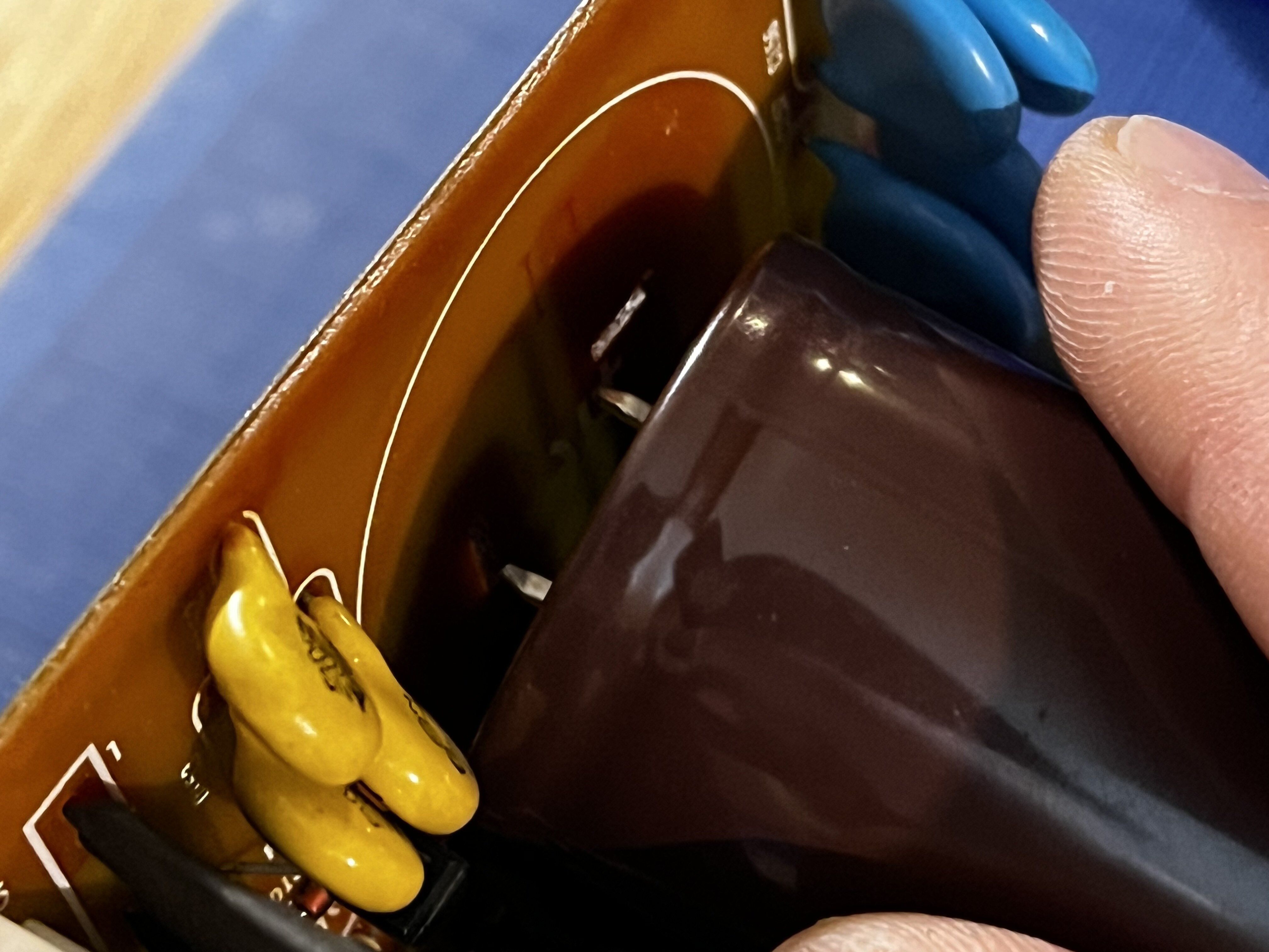

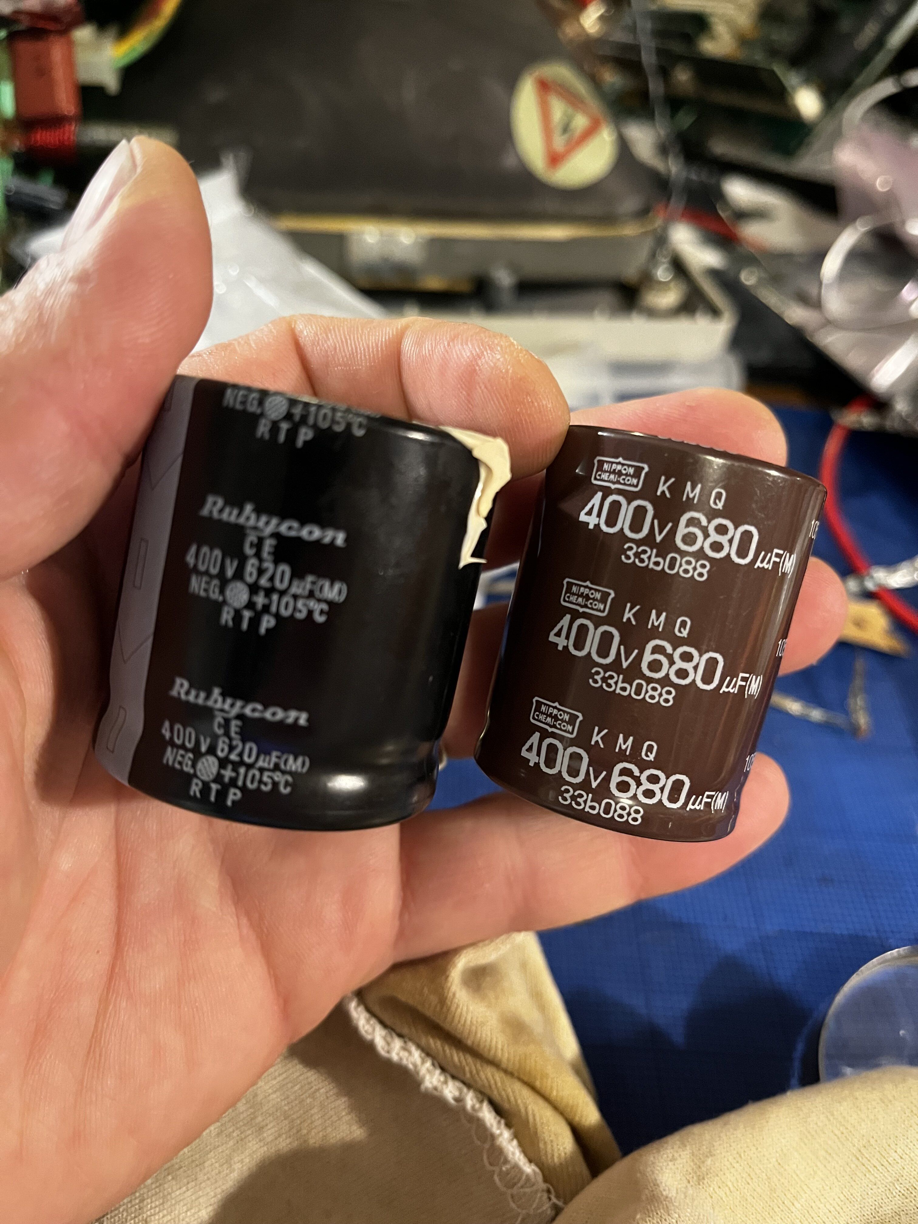

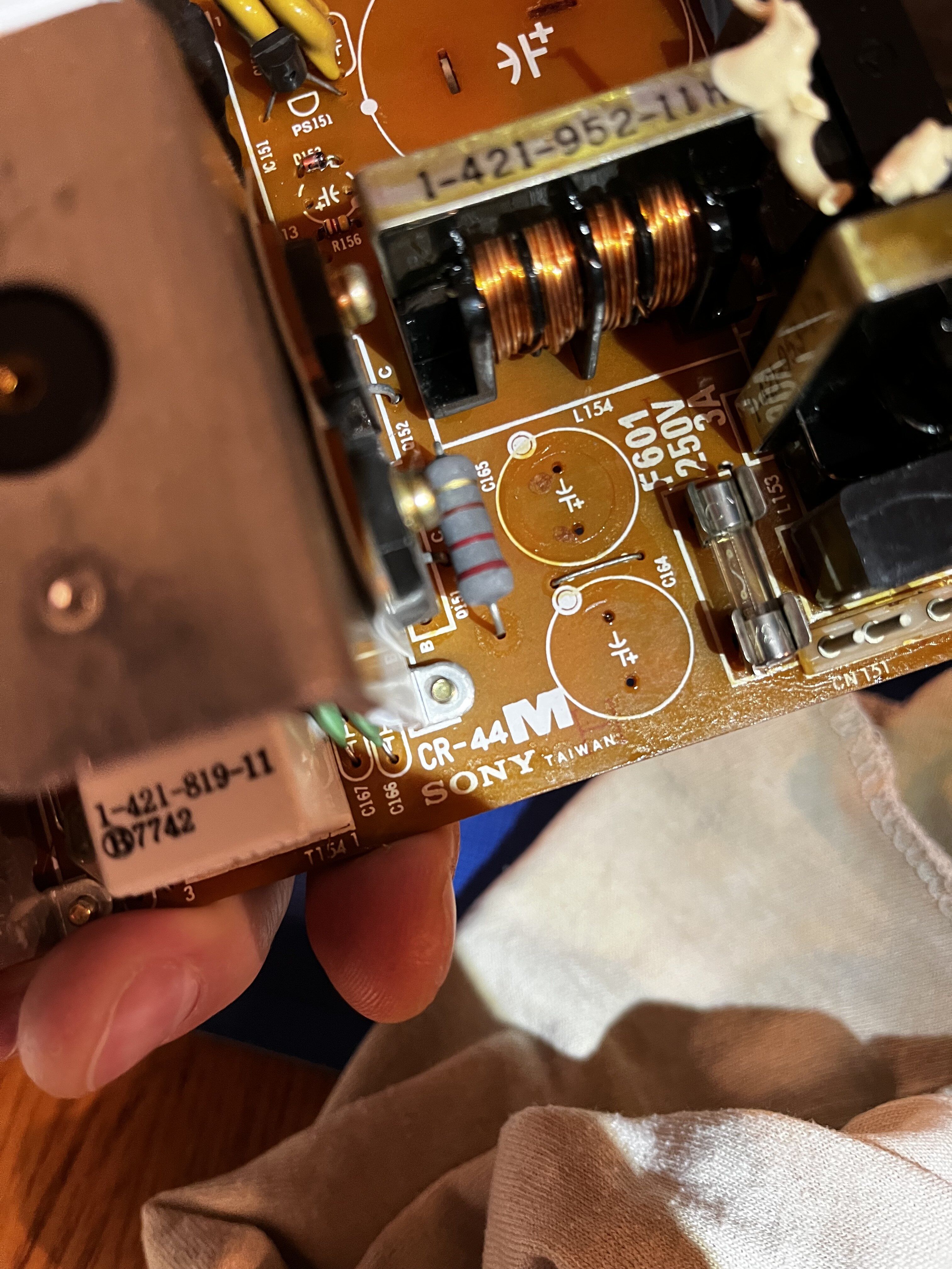

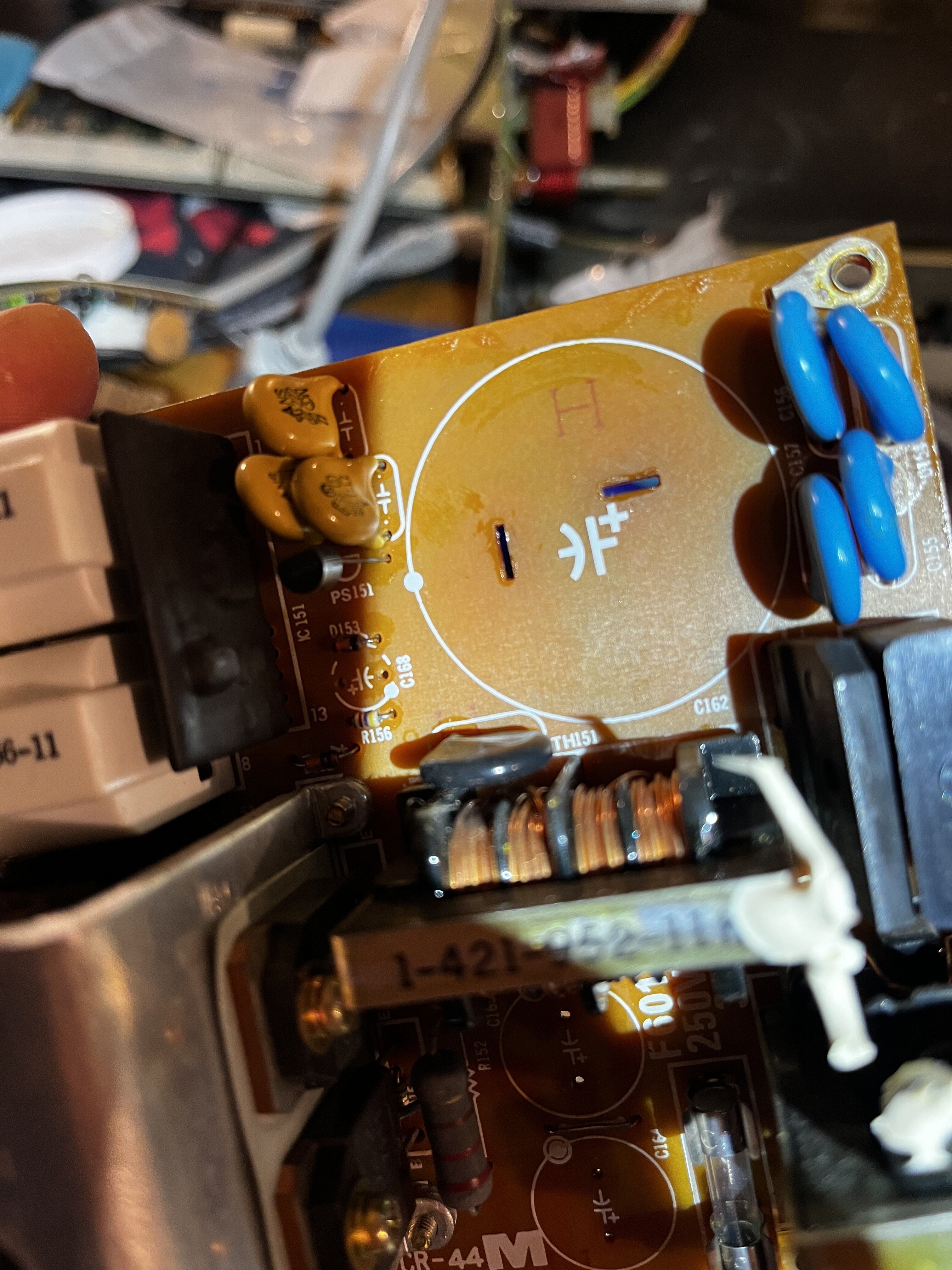

I’ll get more photos later. I don’t know what to do with the big cap. The perpendicular leads don’t exist on the new cap I have.
Re: Citrix acid. I didn’t know that was safe for the PSU? I’ve read it’s ok for the logic board but not thought it was not for the analog/psu.

You'll need to drill a hole with a small drill bit and then expose the copper with a blade either side for the solder to adhere to.
@JDW has a great video on it.

I generally measure those buffer caps, and its exceedingly rare for them to fail, you can very likely re-use the old one. (that is my experience with hundreds of repairs under my belt) about the citric acid bath, you can use this, especially if the board is in a bad state. I use an ultrasonic cleaner, add water + citric acid until the level is just over the PCB and then turn it on. alternatively you can make the solution and just use a toothbrush to clean the board, bubbles will indicate pockets of alkaline substances.
Don't forget to rinse it afterwards, so you get rid of the acid when it has done it's job.
